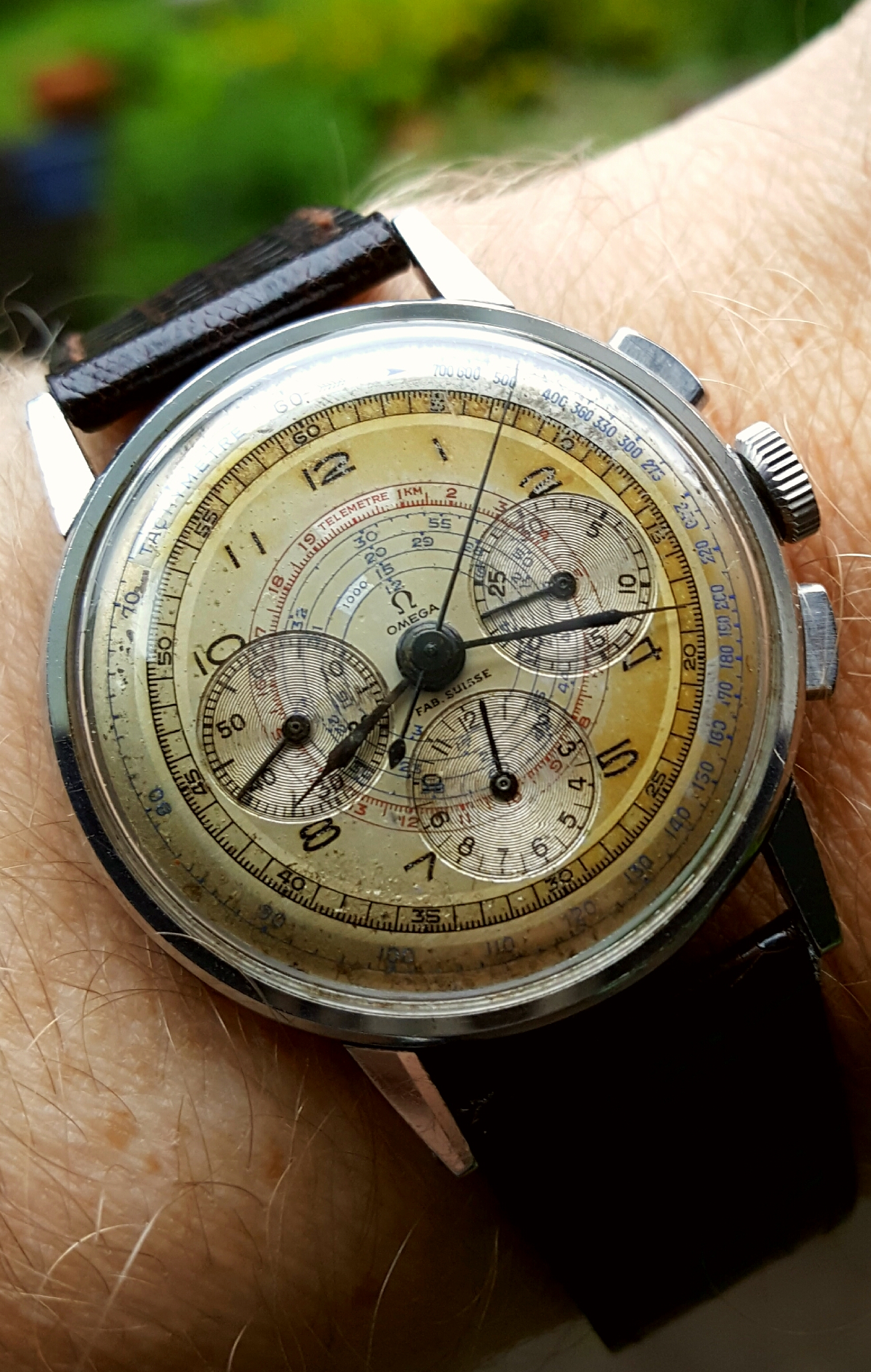

https://clocksavant.com/products/om...dial-circa-1942-fully-serviced-by-clocksavant
I'm going to call that one out as a re-dial. The OP's example is much more original. That said ... you'd still need a good look at the dial to establish the market value. I always think that, with watches of this ilk, it's worth what two people are prepared to pay.
You are right, it is a redial, and a very awful one.

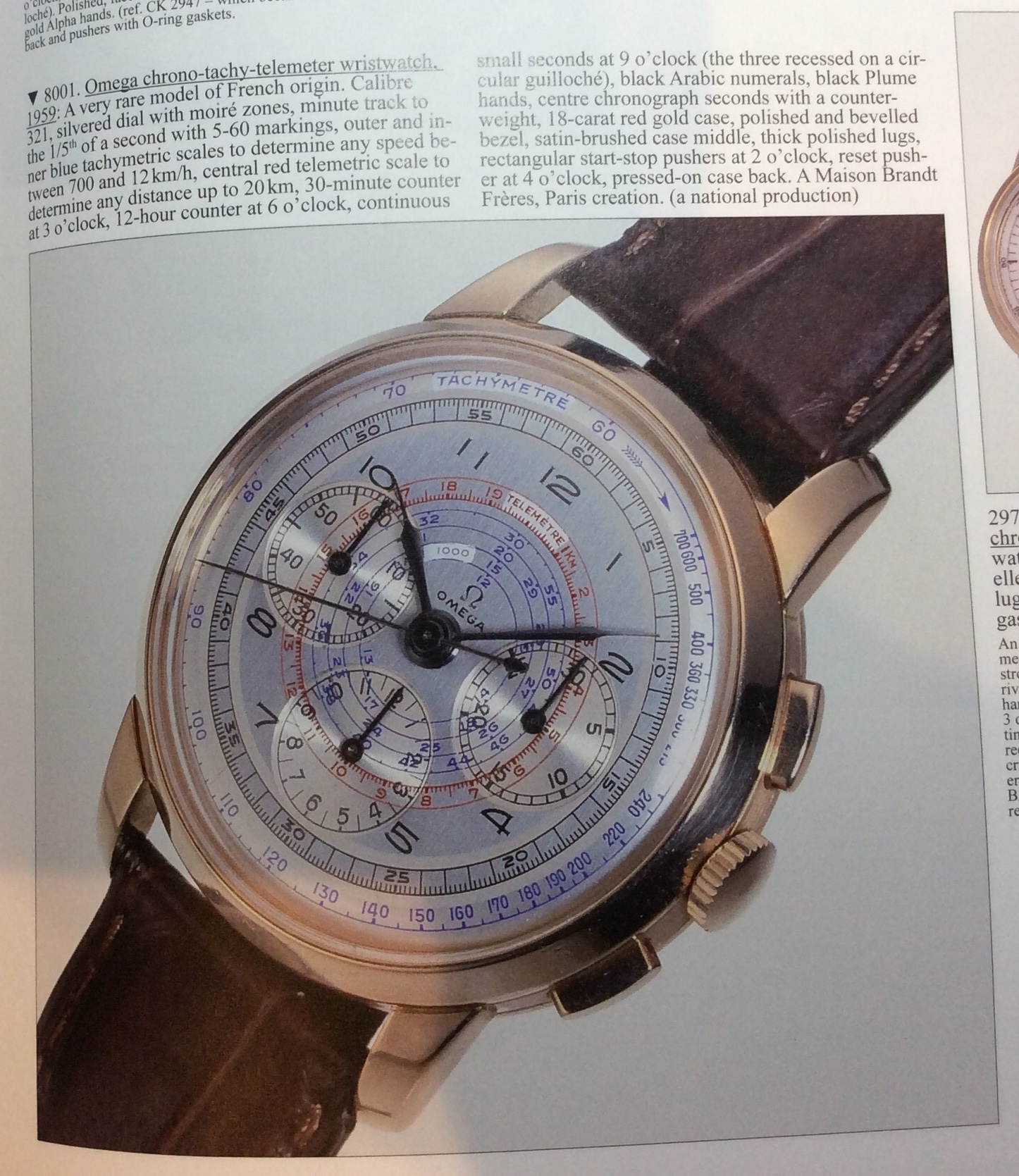

What a fantastic family heirloom. Unfortunately I cannot add to the already expert advice you have received but thought I would take some snapshots of similar watches in terms of case style, dial design and hand types from “a journey through time” for you to compare to.

You should not mix up pears and apples.
Several of the watches you show are the much larger ones with cal. 33.3 - its a different world...
1,561
3,670
Apologies if there was any confusion as I wasn't trying to indicate that these were all the same as the OP's watch. and if that is how my post was perceived I failed to explain myself properly.
I was trying to show a similar case style (photo 1) OR similar dial (photo 2) OR similar hand types . NOT necessarily all 3 in any of the watches.
