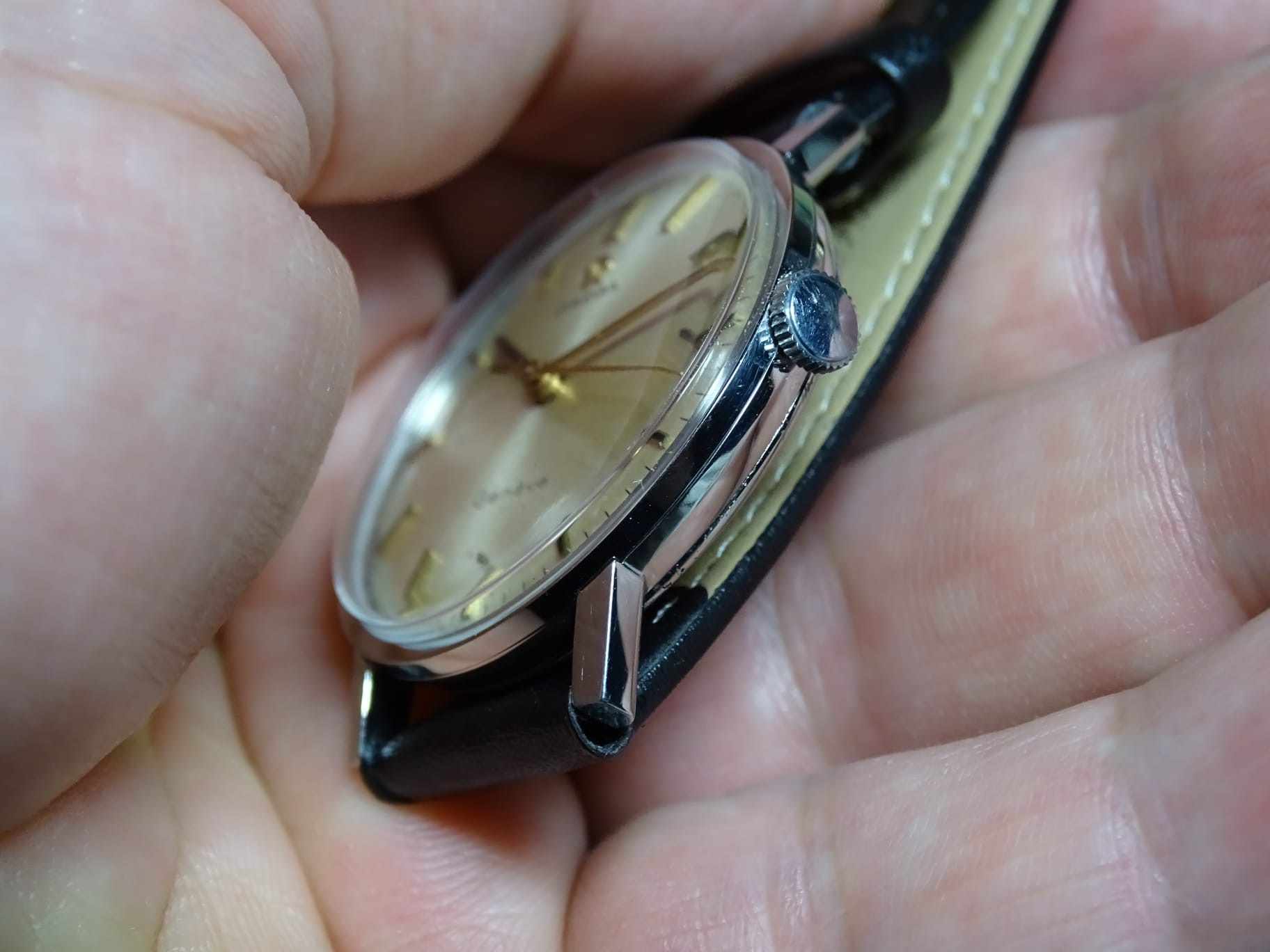

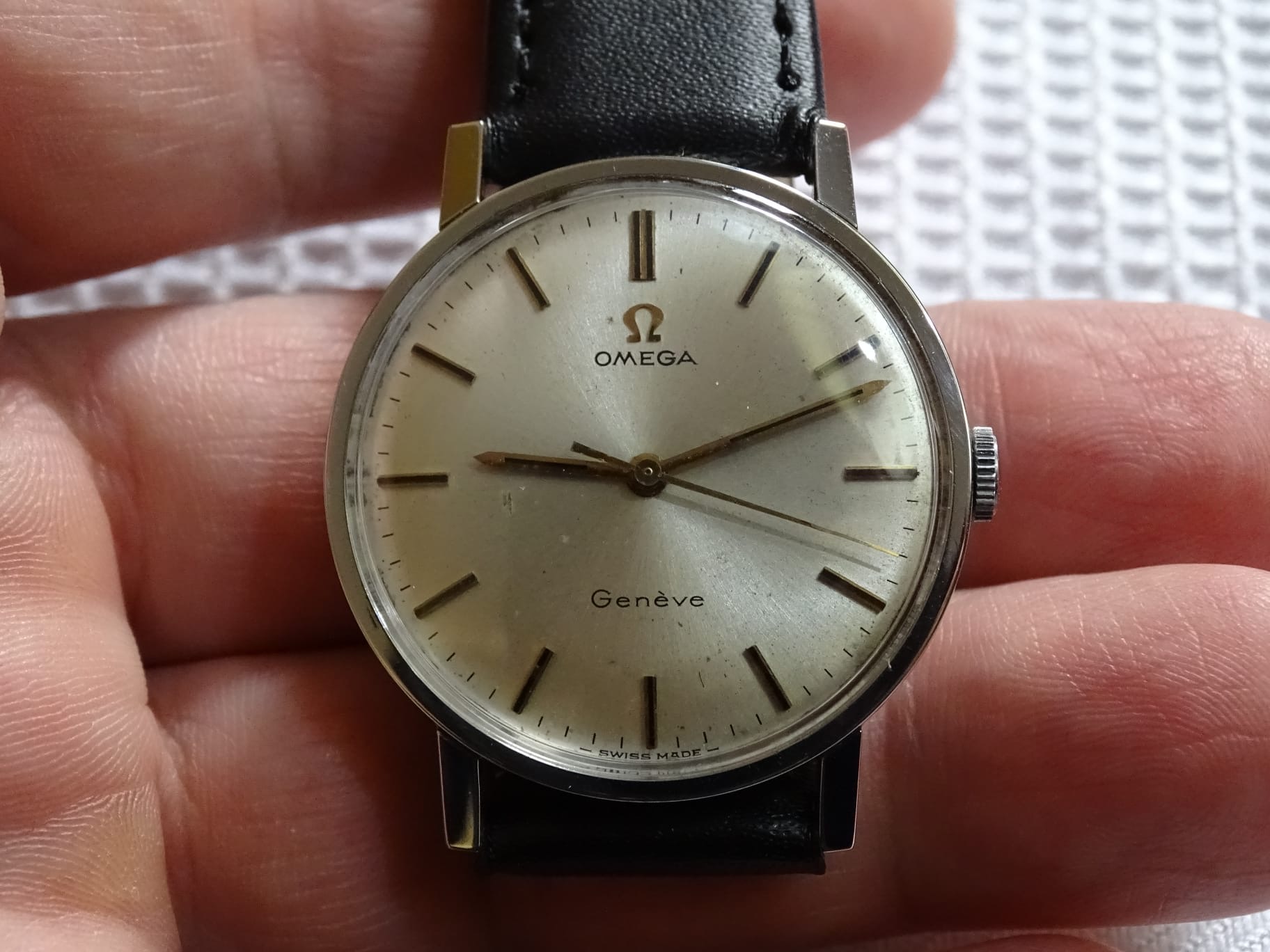

Hi Everybody,

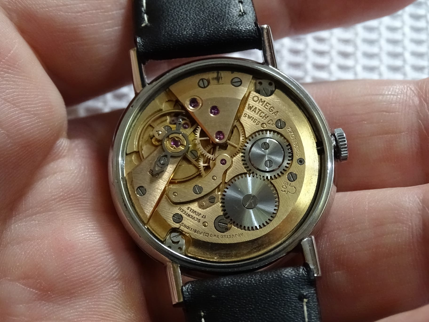

I´m new in the the vintage watches. I have been reading quite a lot, and i think I´m ready for my first purchase. However I have a few doubts about this Omega Geneve watch, specially if it is or not a frankenstein Watch.
The seller claims its 100% original, except the crown and the strap. However I have a few concerns:

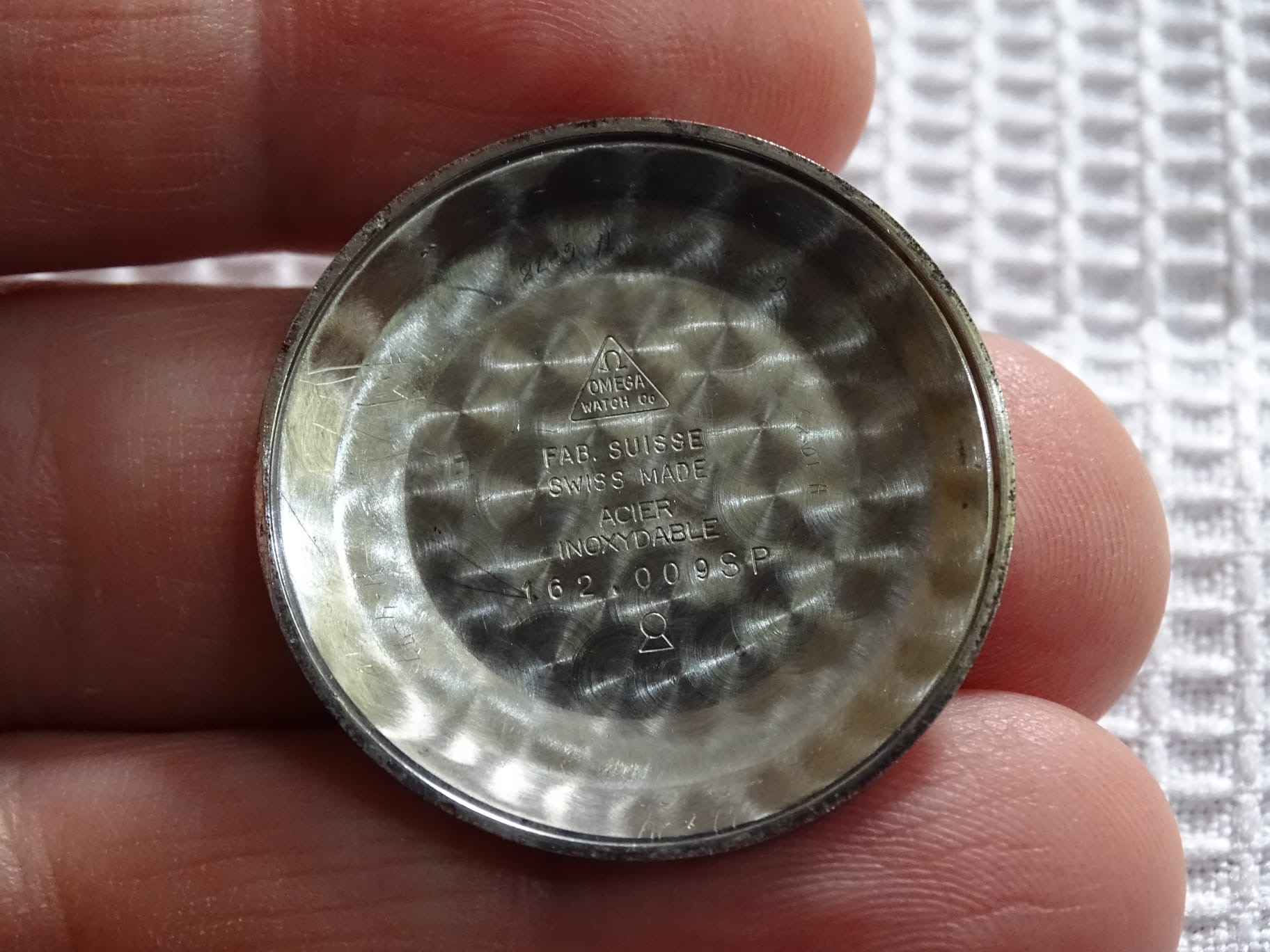

1) Looking into OVDB, the Number of the caseback 162.0009, does not match with the caliber 601, neither with the year of the movement serial number, 1962 (27016025). I dont know if it is the caseback that does not belong to the watch or if it is the OVDB that is missing this data?!
2) It´s quite difficult to me to understand if this Geneve model (dial) belongs to the movement cal. 601, and if it´s orginal

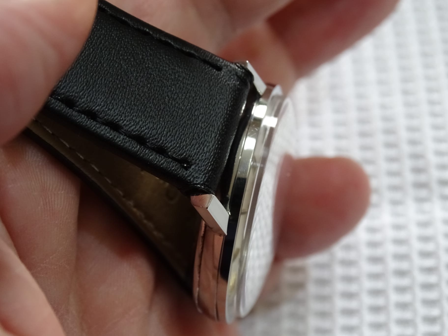

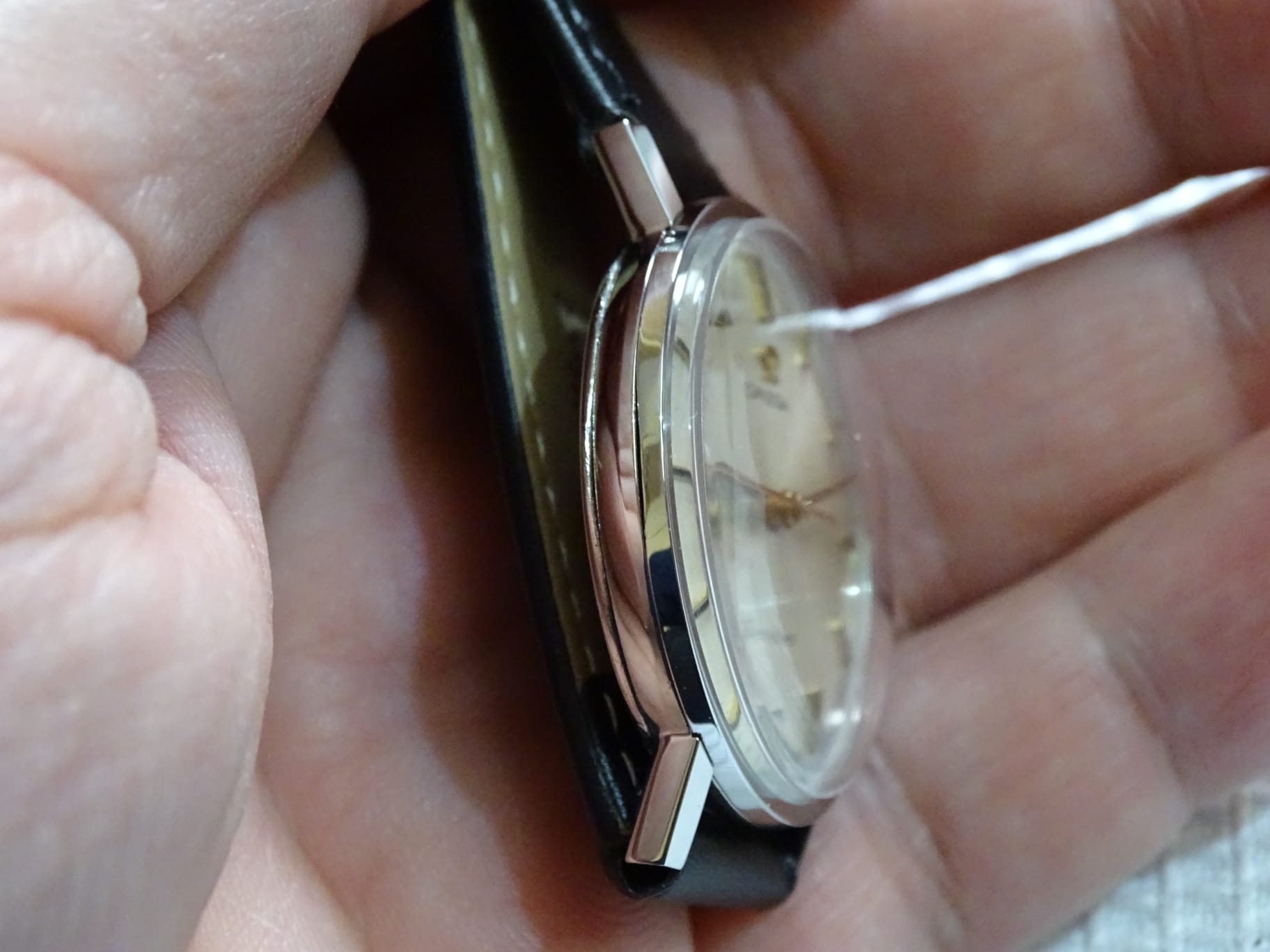

3)On the left side of the watch, there is a small opening, i thought it was a damaged, however the seller told me that is from where the watchmaker opens the watch to fix it, is this true?
4) Do you see nay issue or anything wrong with it? what is your opinion? please help me.
Besides, I would like to know what are your opinions on this watch if i should or not buy it, and if you spot any other issues with it. I really appreciate all the comments, knowledge is everything and mine is very limited. Thank you and Merry Xmas

cool you're getting into watches! she's a vintage watch and sometimes things like crowns and crystals get replaced. the watch looks alright for it's age and I guess it's just a matter of price.

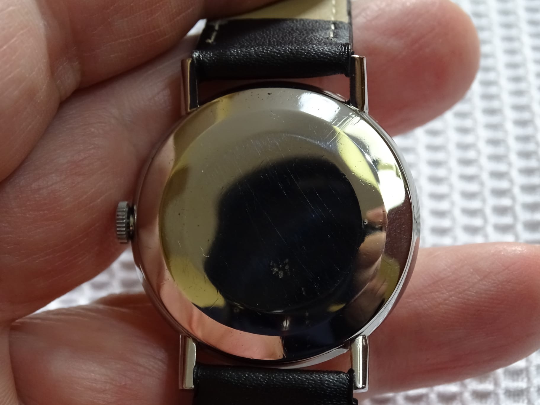

Caseback belongs to automatic watch, not manual like this one. Crown not Omega.

I have been thinking, if the only issue is the crown and caseback, maybe I could buy them as NOS, so then I get the watch in perfect conditions. However I’m not sure what is the right caseback for this dial and mechanism, do you know? I could figure it out looking at the Omega database..

Another thing is if this dial is right for this mechanism?

It's always sad (and disappointing) when people cobble up watches which is what this might be.
It kind of seems to be a bit of a franken watch...
You can add 100-200 more euros and buy a proper fully genuine one.
Makes little to no sense, since after buying those parts NOS and installing them the total cost will most probably exceed the price of a fully original watch.

I agree with what has been stated above. There is too much wrong with the watch to make it a worthwhile investment as a restoration project: scratched and moldy dial, polished case, incorrect case-back. Given that it's an entry-level piece, there is not enough upside potential. Research would be required even to determine the correct reference and finding the correct case-back could take a long time. If you are looking to buy a vintage Omega watch to start a collection, this is not the watch for you. Save your money and buy something better.
However, if you don't care about originality and are not looking to collect watches, and you just want to wear a vintage-looking watch on your wrist, then offer the seller 100 Euros and wear it for fun, especially if you have a watchmaker who can service it very inexpensively.
