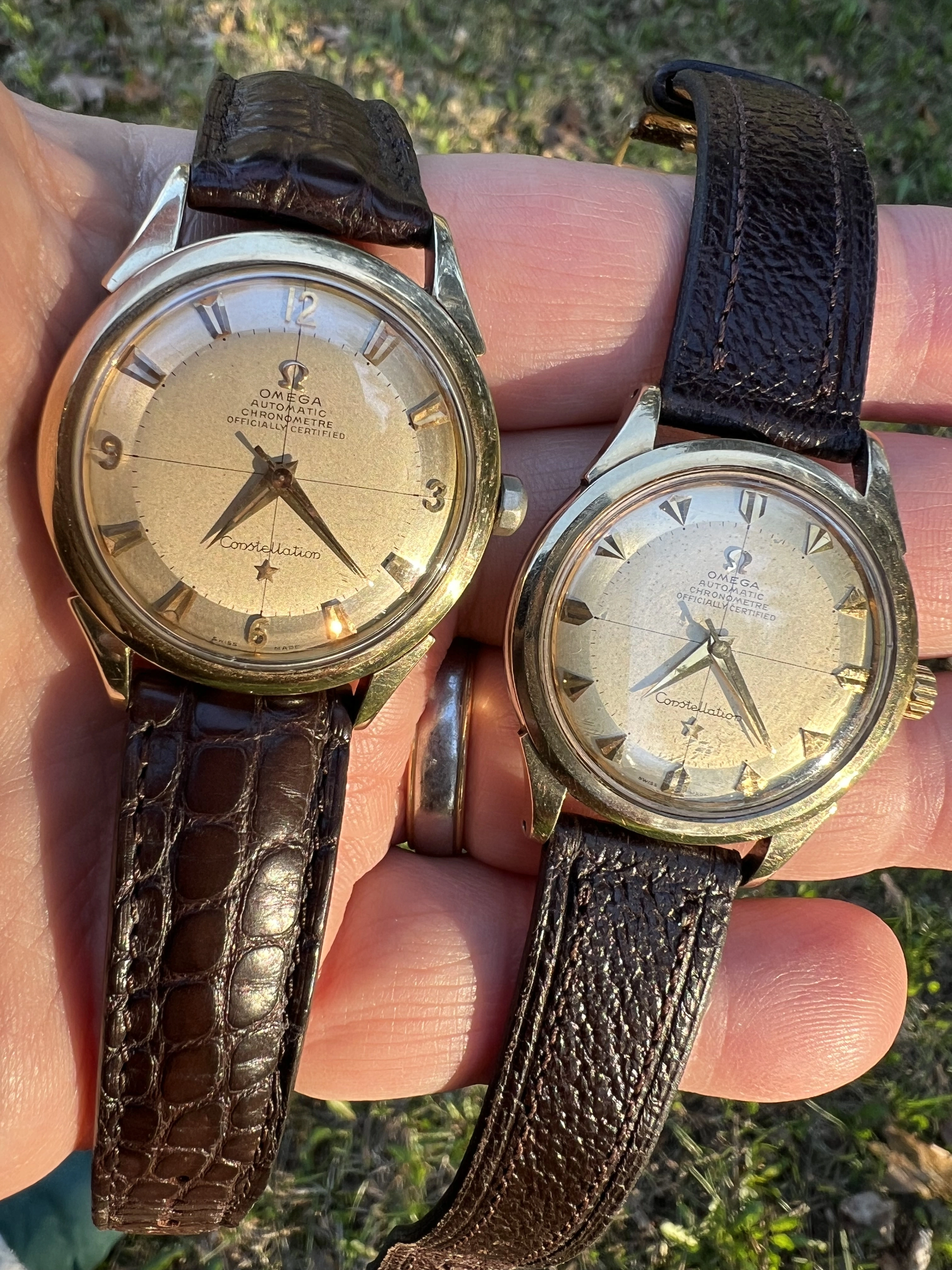

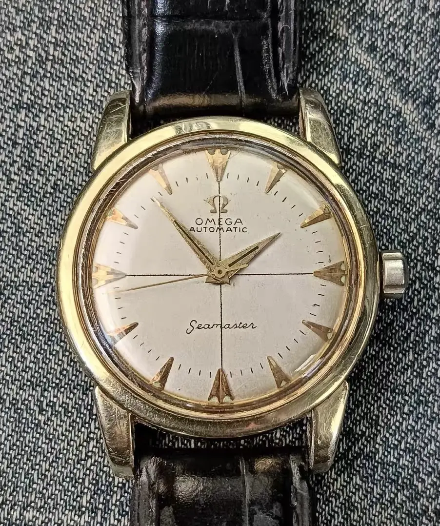

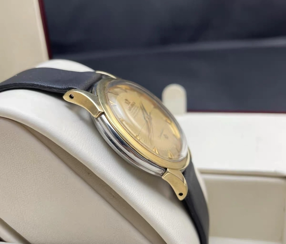

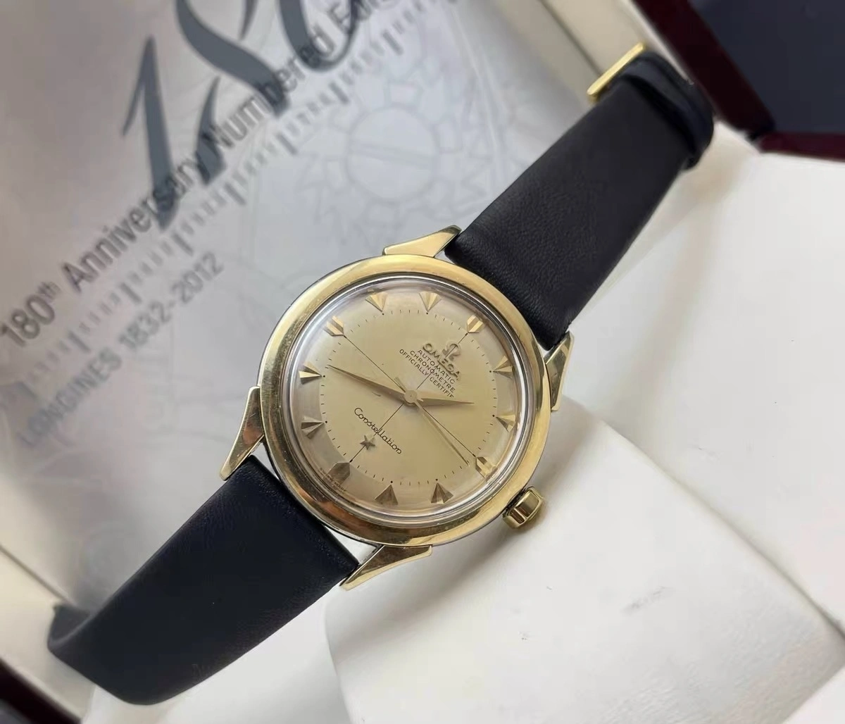

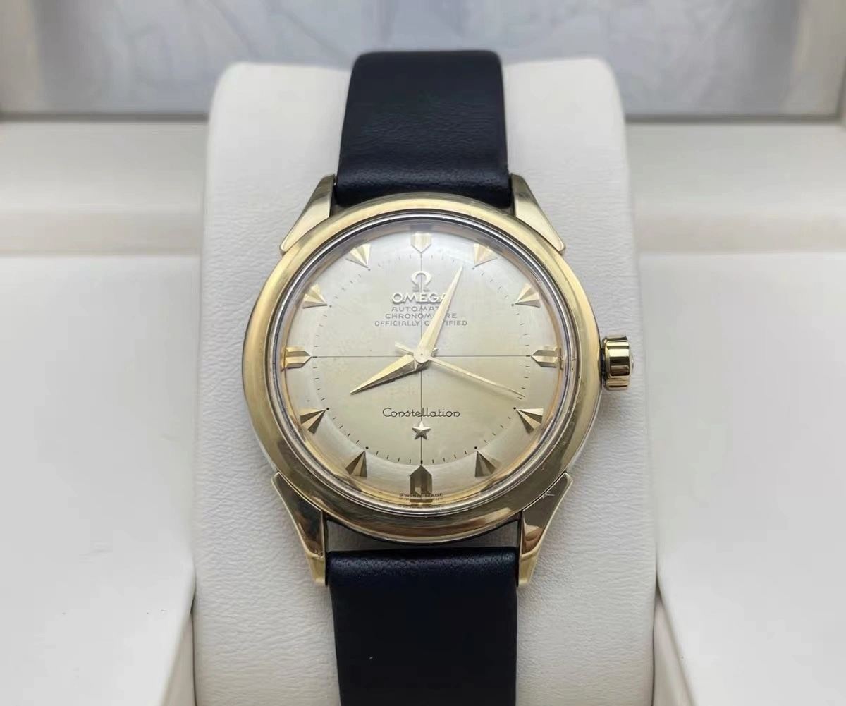

I am new to omega and would like to get one for myself, there are a lot of fake ones in the market and I could not really tell. Can someone kind enough to see if these watches are legit and worth buying it?

They both appear to me to be the real thing. As to are they “worth” it, there I can’t help. Add to the purchase price of either, 300, 400, 500 for professional service (for either of them), plus necessary parts, then you’ll have decide if they are ”worth” it. If you have Omega do the service, then double or triple the price! These are the economics of venturing into the collectible watch hobby! The money might be better spent buying new.

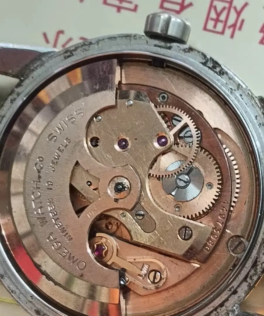

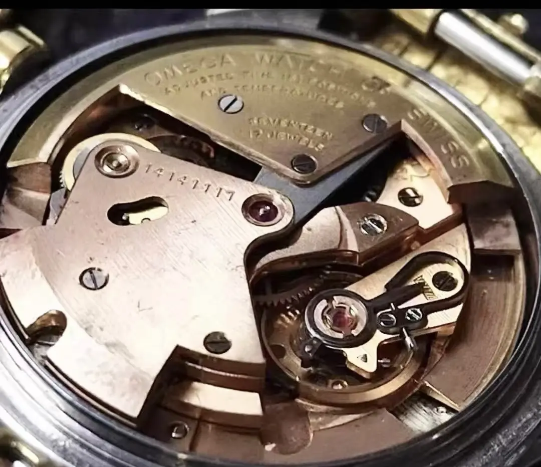

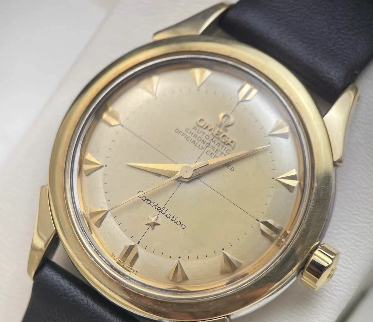

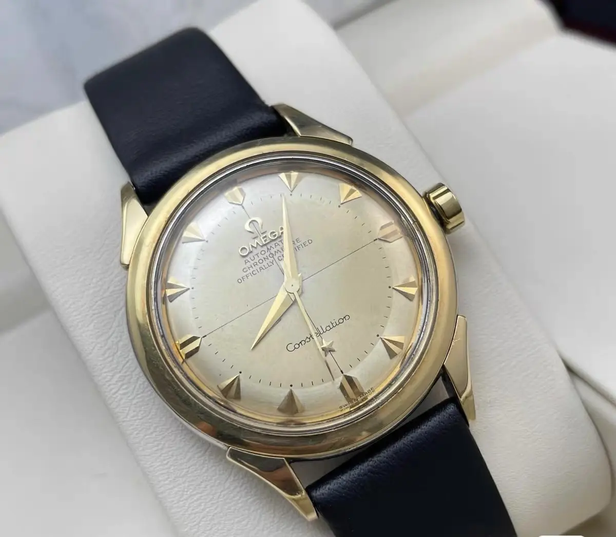

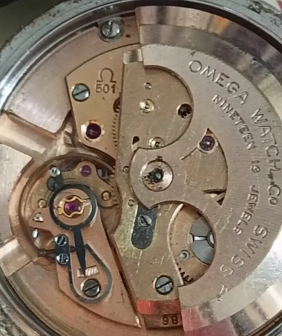

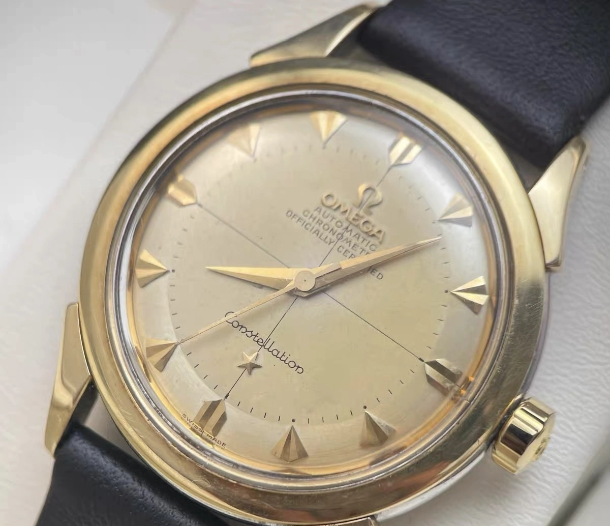

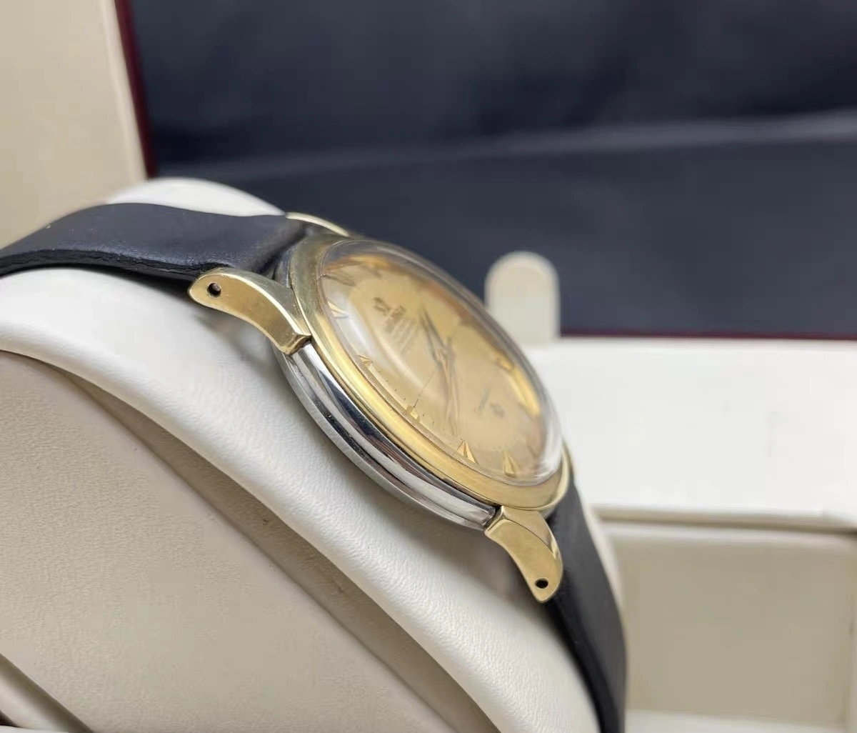

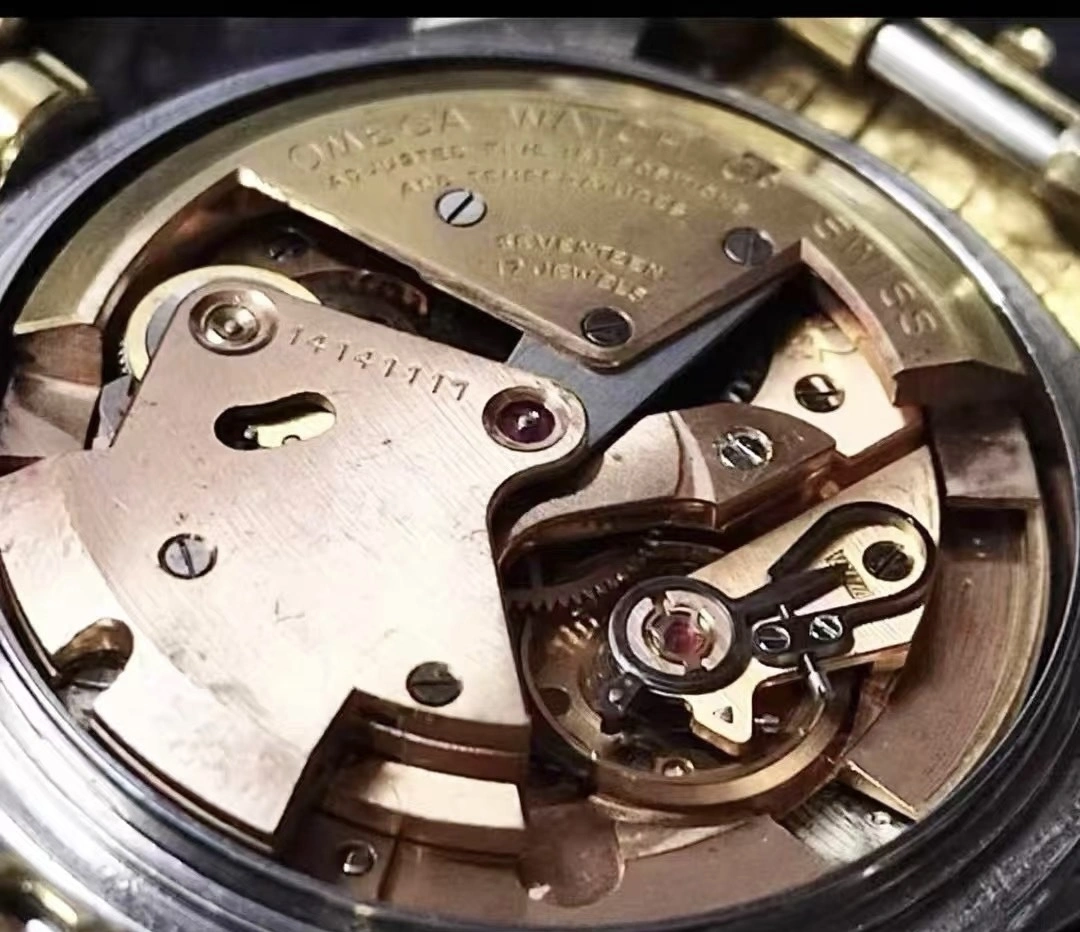

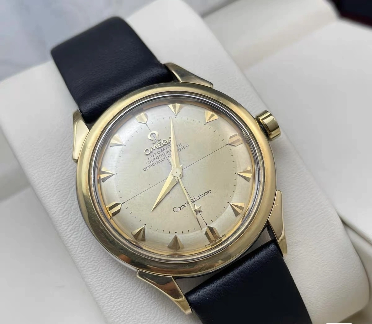

I think the Constellation is worth buying at the right price, it's generally in decent condition. I looked very quickly through the photos, and the only real issue I noticed was some replacement parts in the movement.

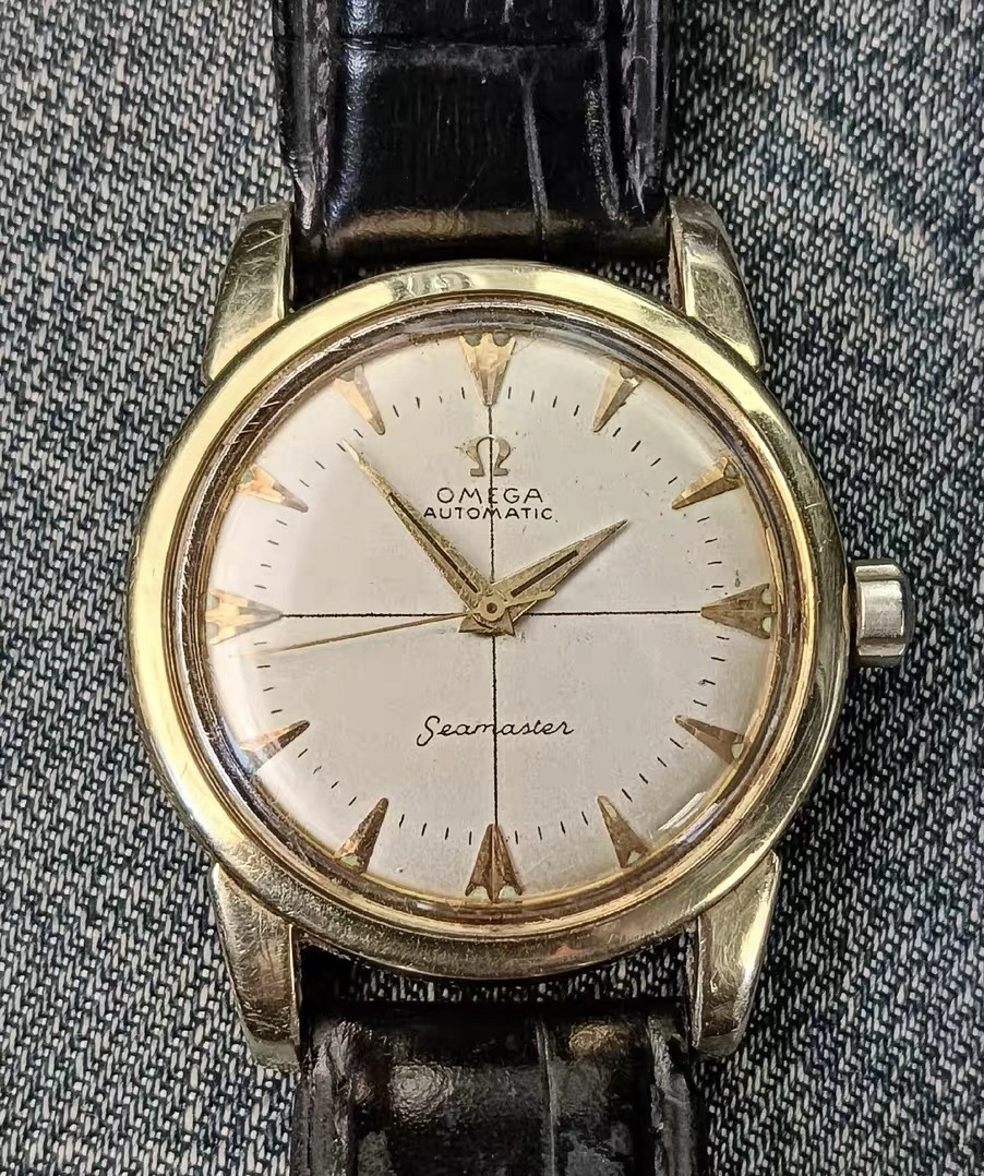

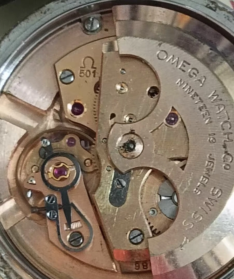

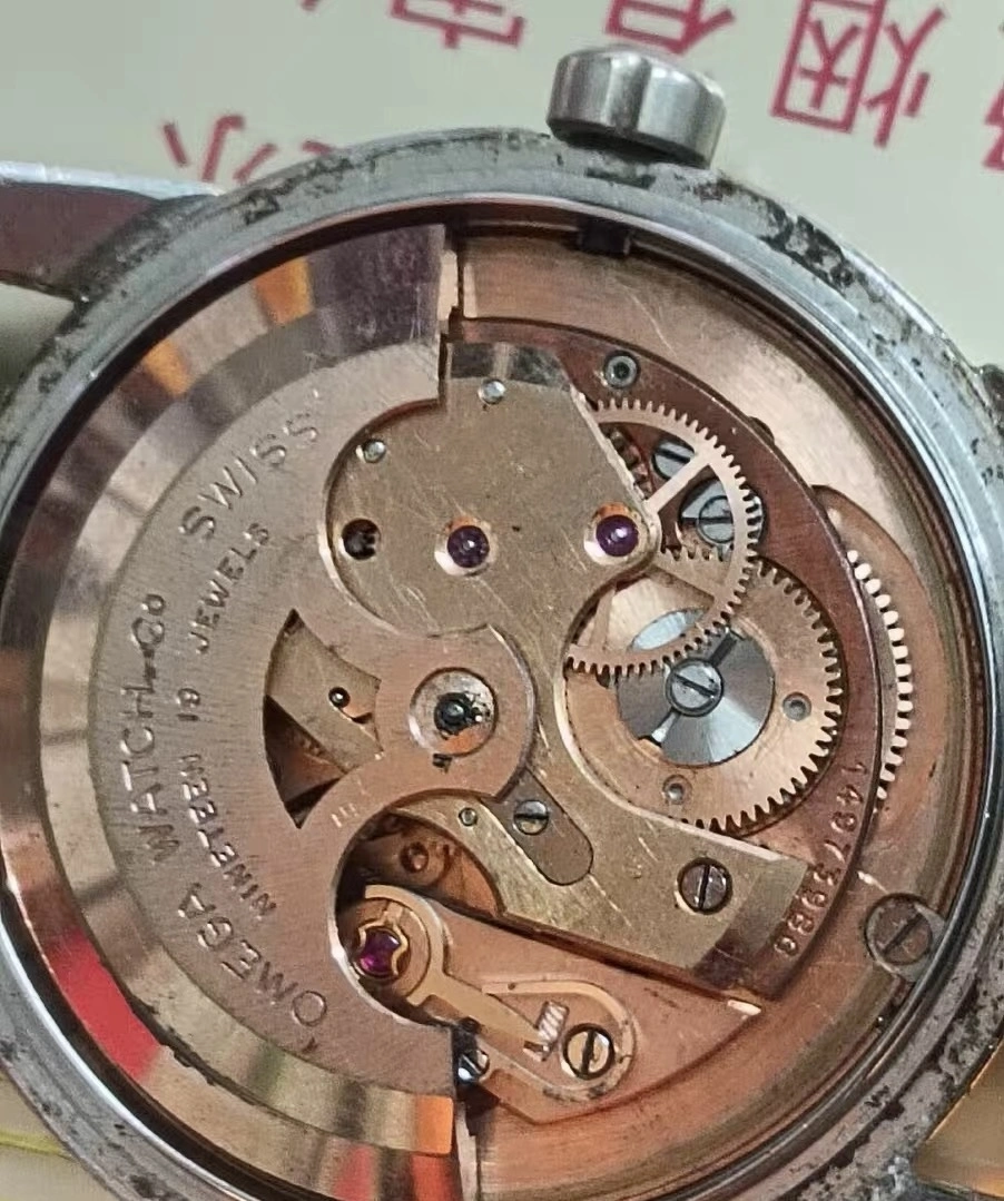

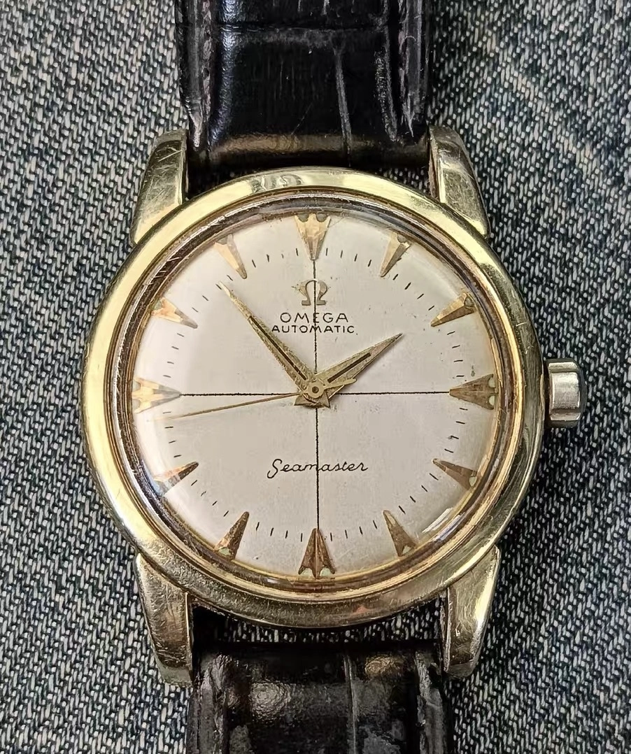

The Seamaster is no good, the dial is horribly repainted and the movement is a real mess.

I agree with Dan. Don’t bother with the Seamaster. How much is the Constellation and has it been recently serviced?
Sorry all, I missed to include the price. Constellation is selling at $1200 USD whereas Seamaster is at $600. Is the Constellation ref 2652? Thanks all!

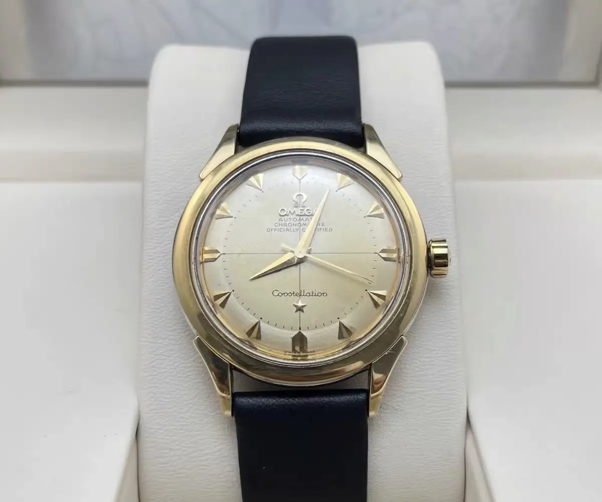

I like the constellation but the price isn't probably a bargain, gold capping is ok but I suspect for a little more dollars a nicer one might appear.

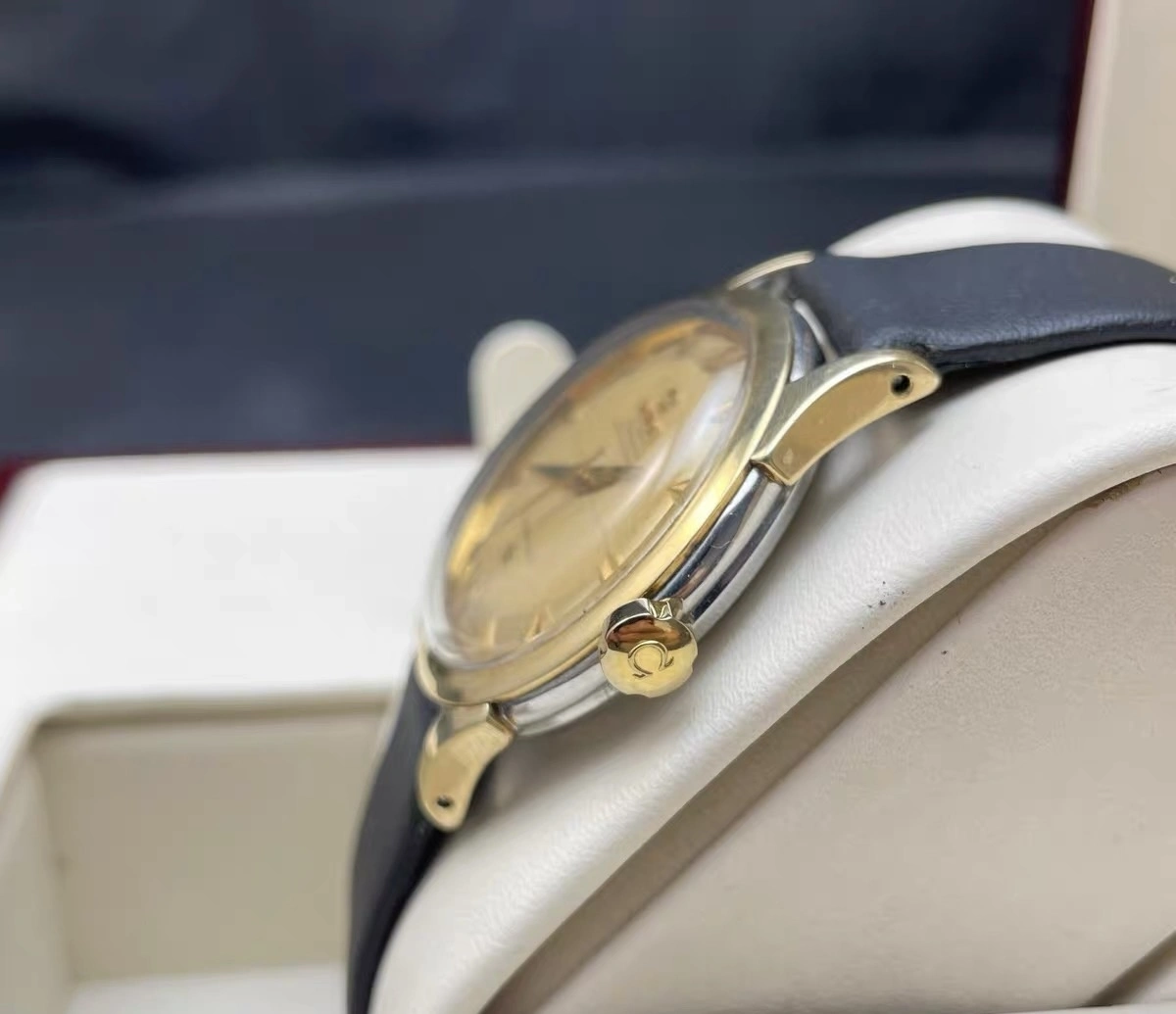

Based on recent prices I've seen $1200 isn't crazy, but the condition of the Constellation just doesn't get me overly excited. The case in particular. The dial has a subtle mottled appearance, but it's still appealing, and if it's exactly what you are looking for and you really love it, I don't think you're being ripped off at that price.
Honestly, I think the Seamaster is a terrible watch and you should not buy it at any price. I can't even see it as a parts watch because of the terrible condition of the movement. If you're required to buy both, that would honestly be a dealbreaker for me.

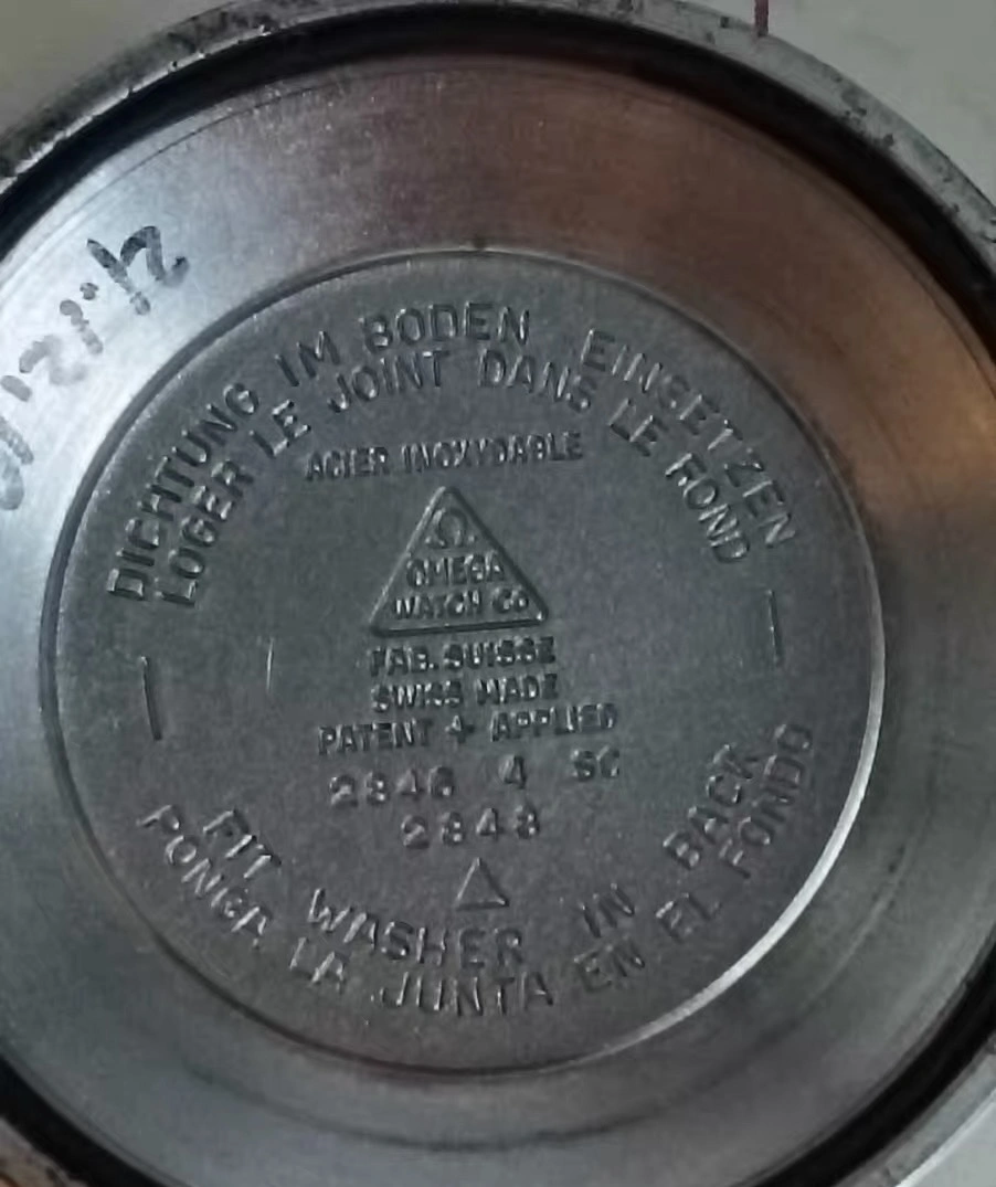

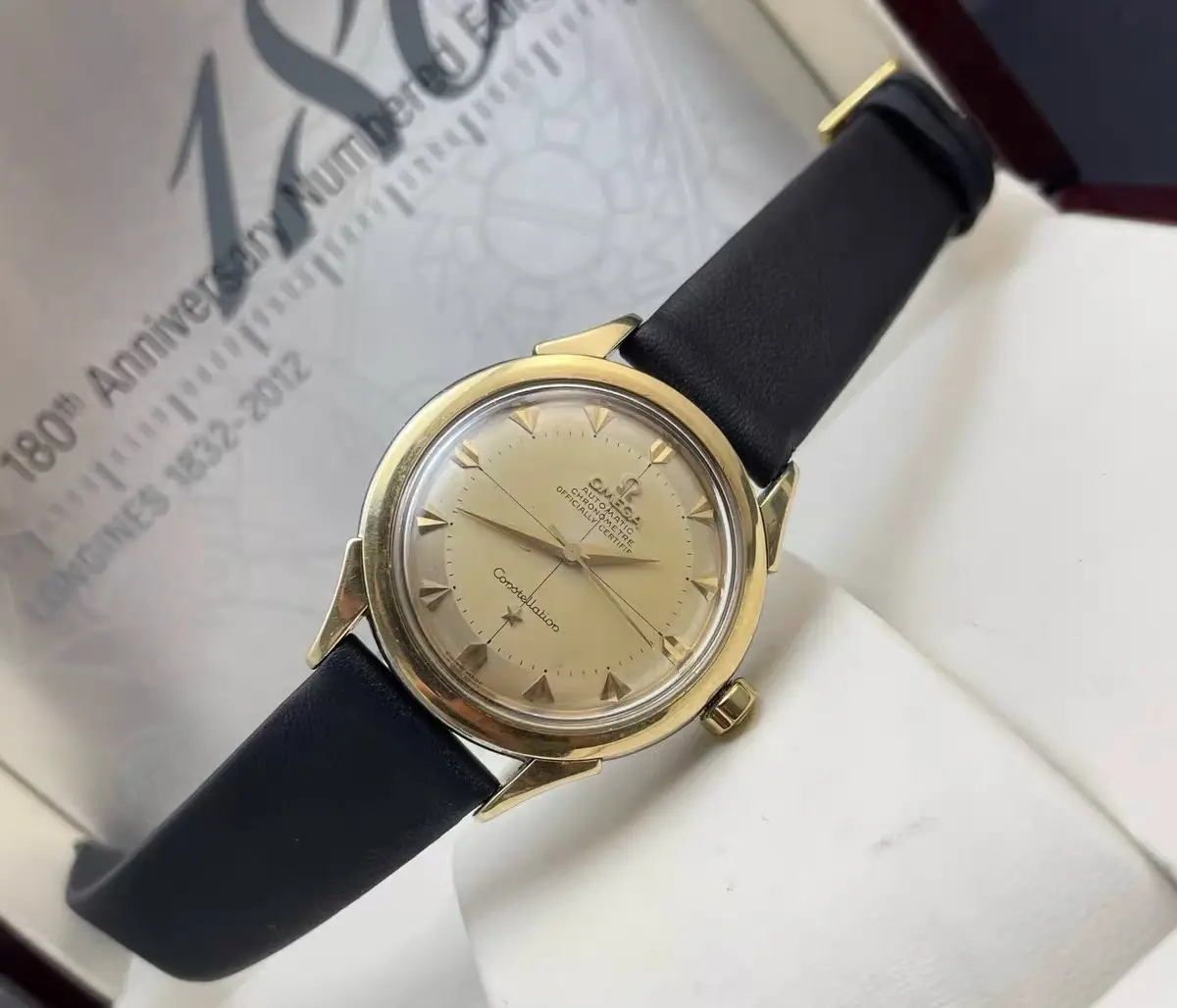

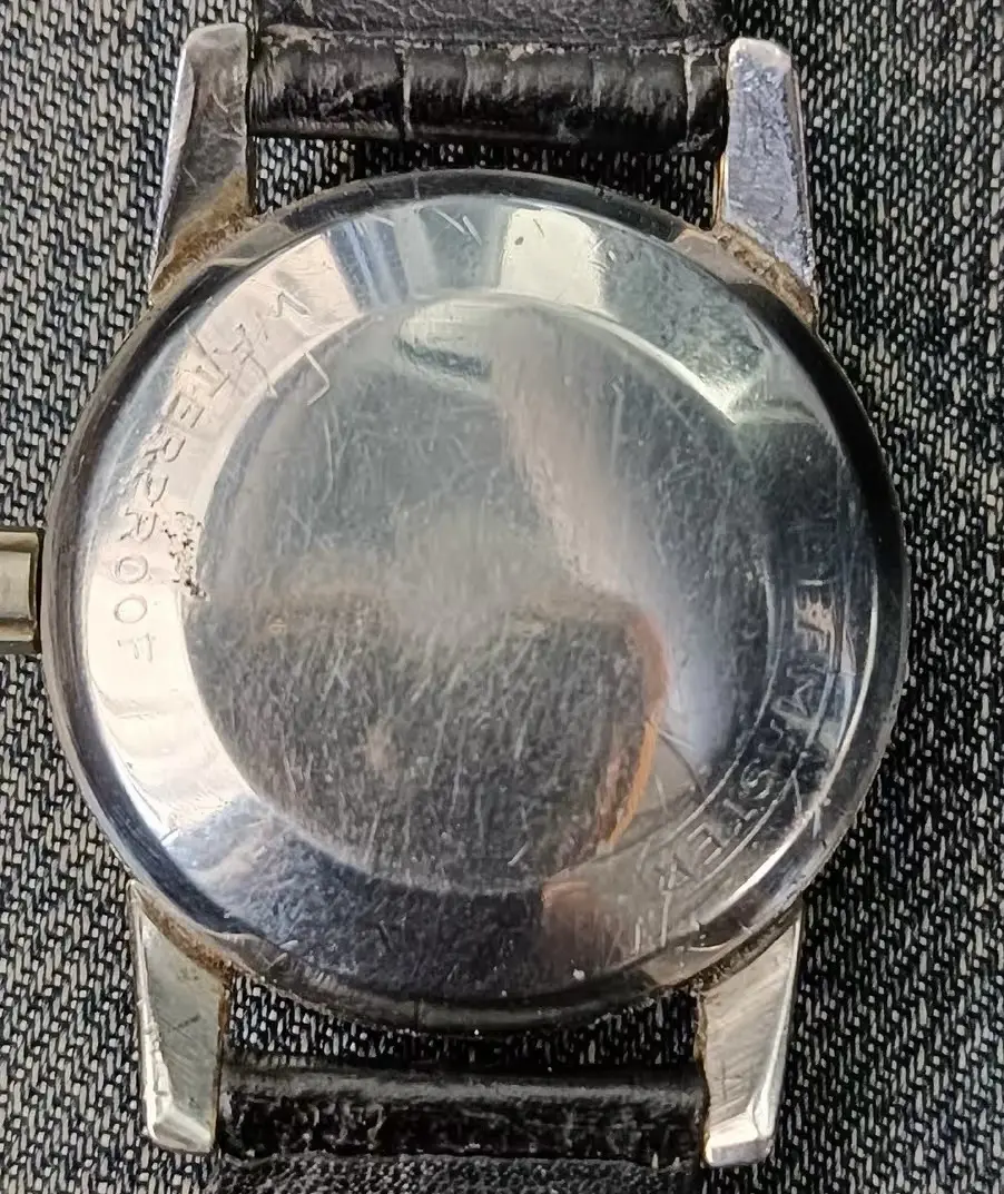

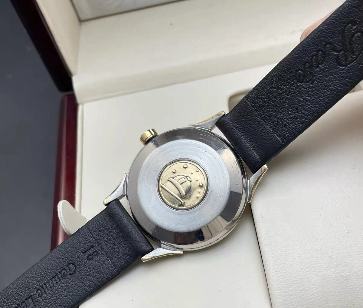

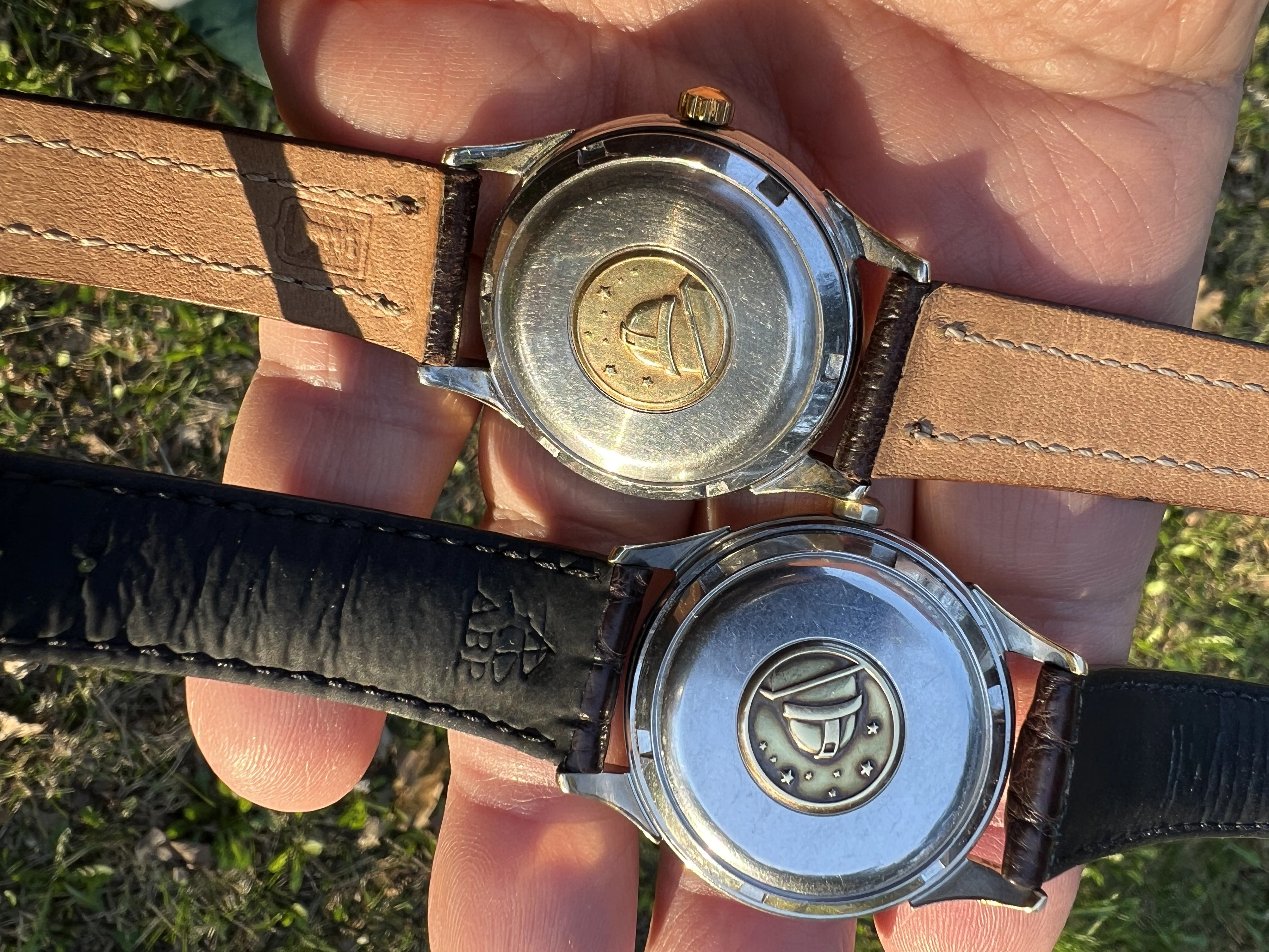

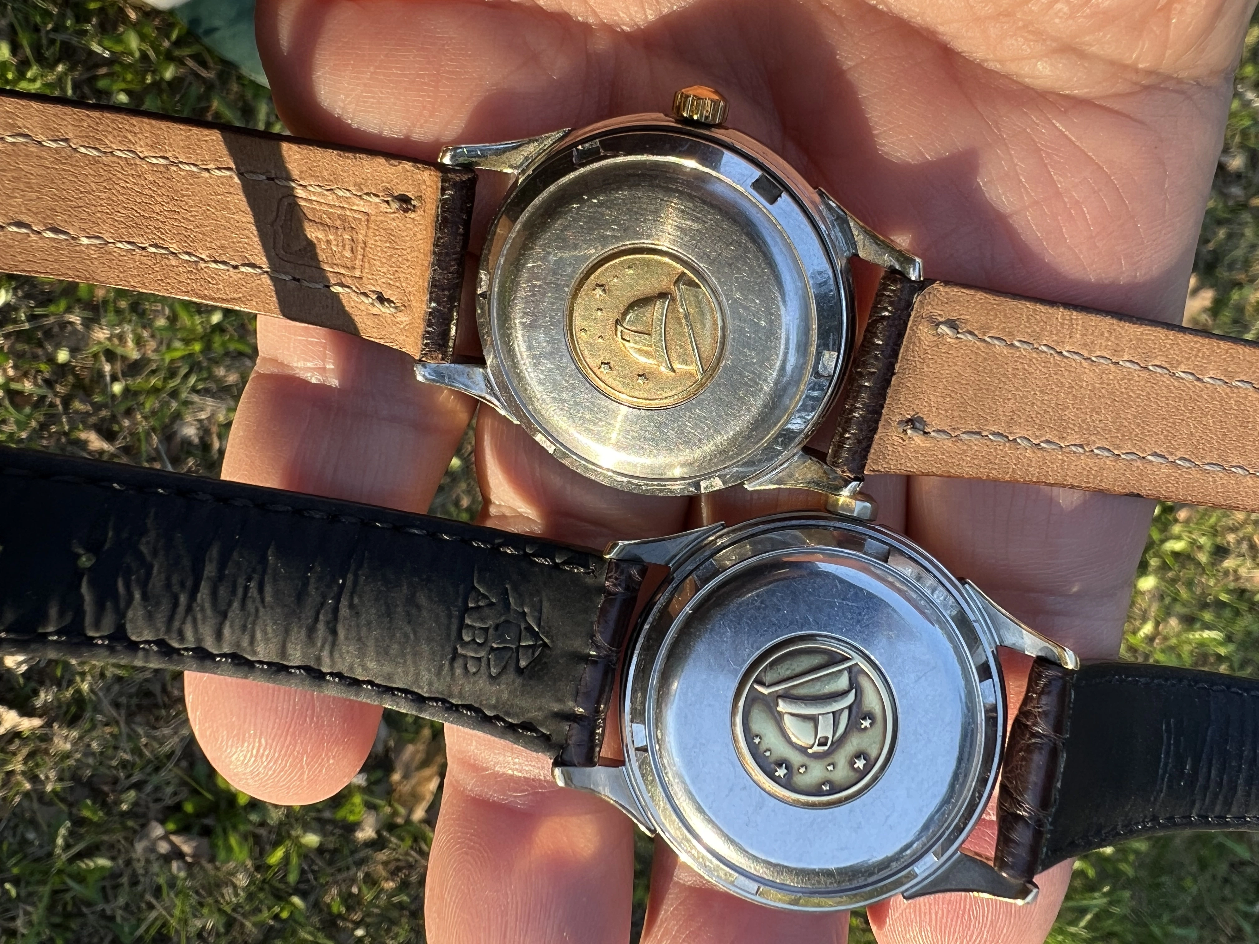

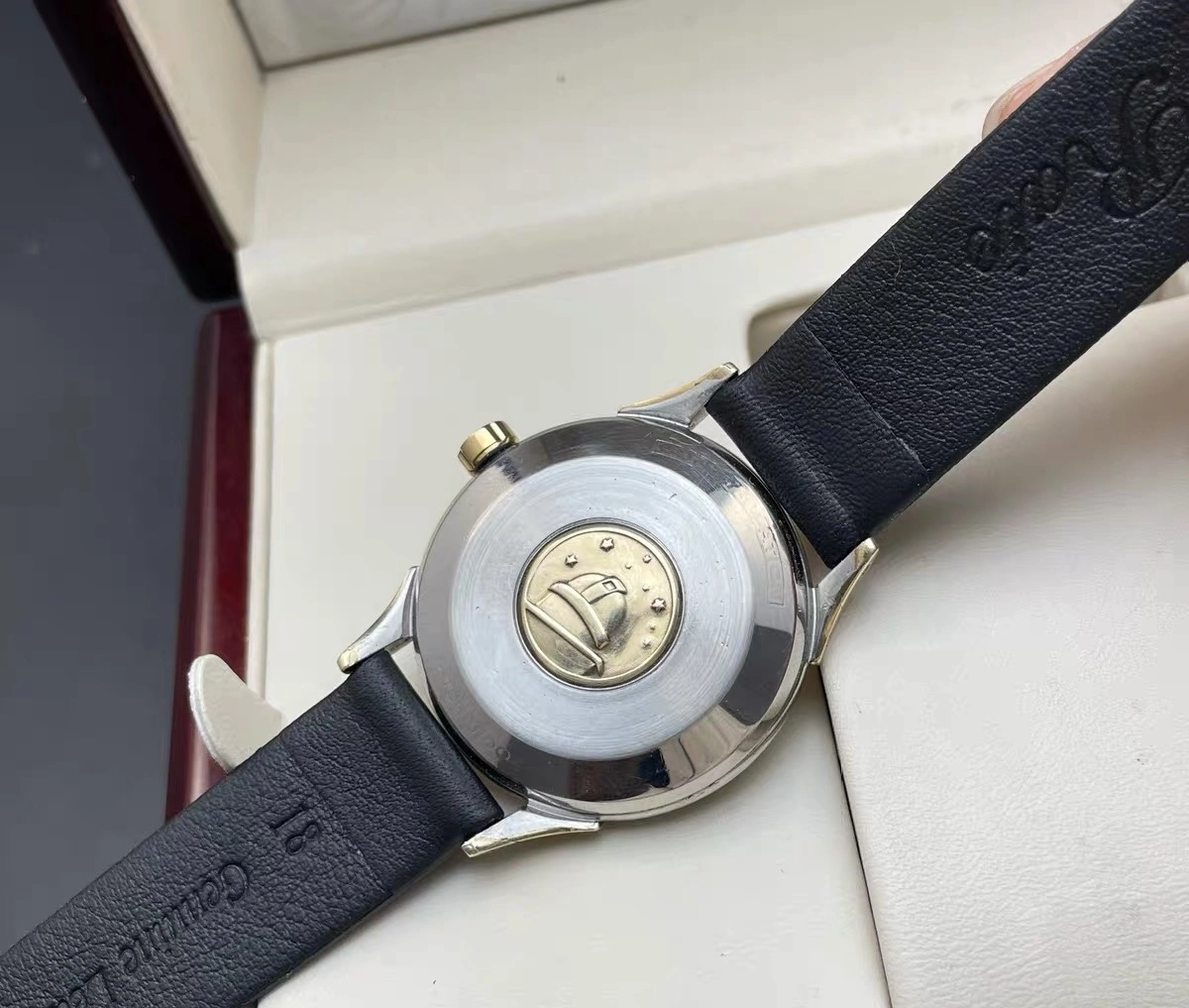

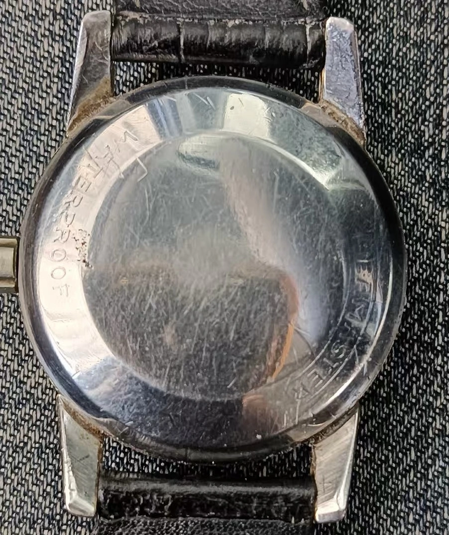

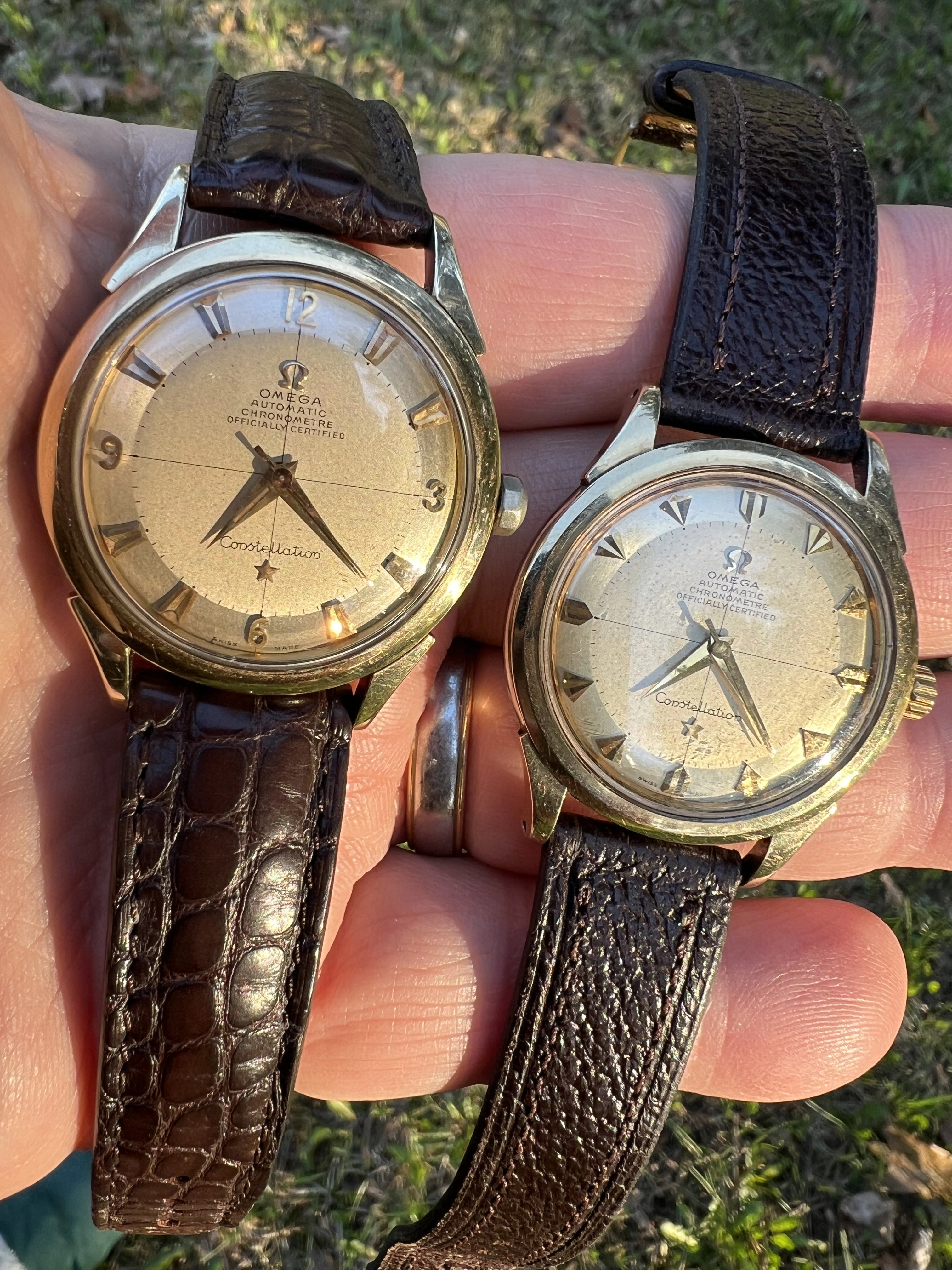

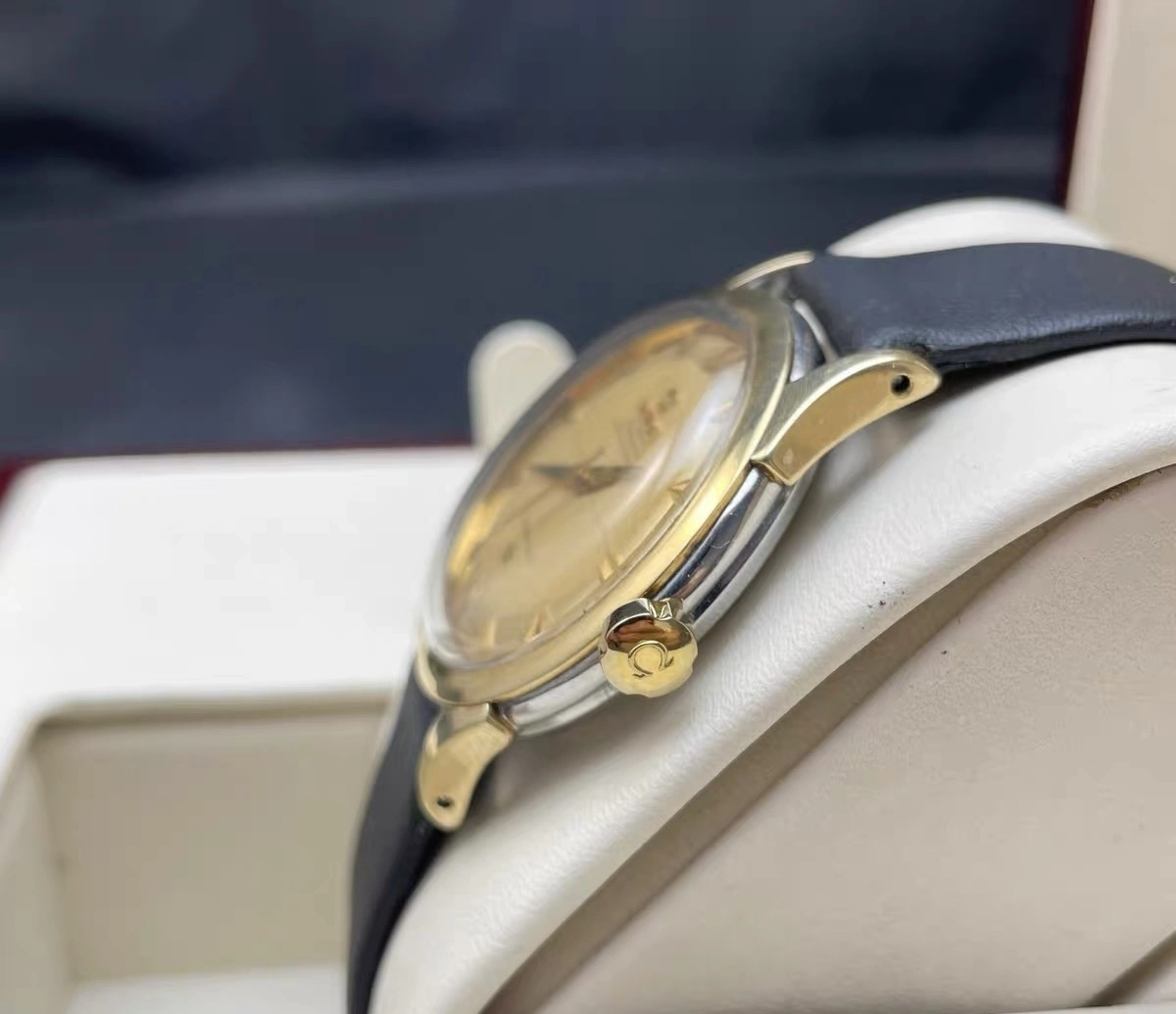

This Constellation has snap on Caseback. 2652 has screw down caseback. Movement looks like 354 bumper which would go with 2652. Need to see inside Caseback to resolve this discrepancy.
2 2652s:
