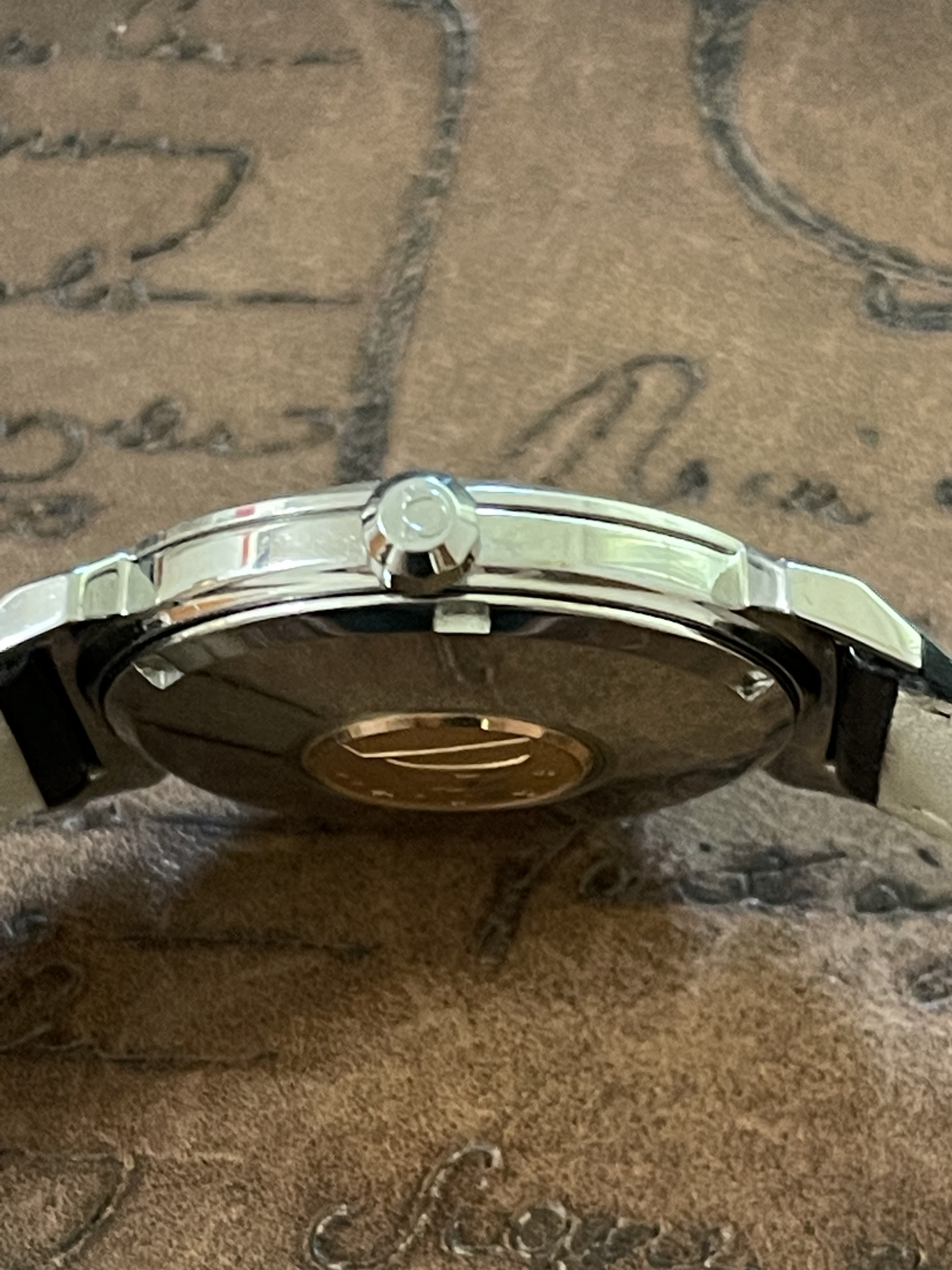

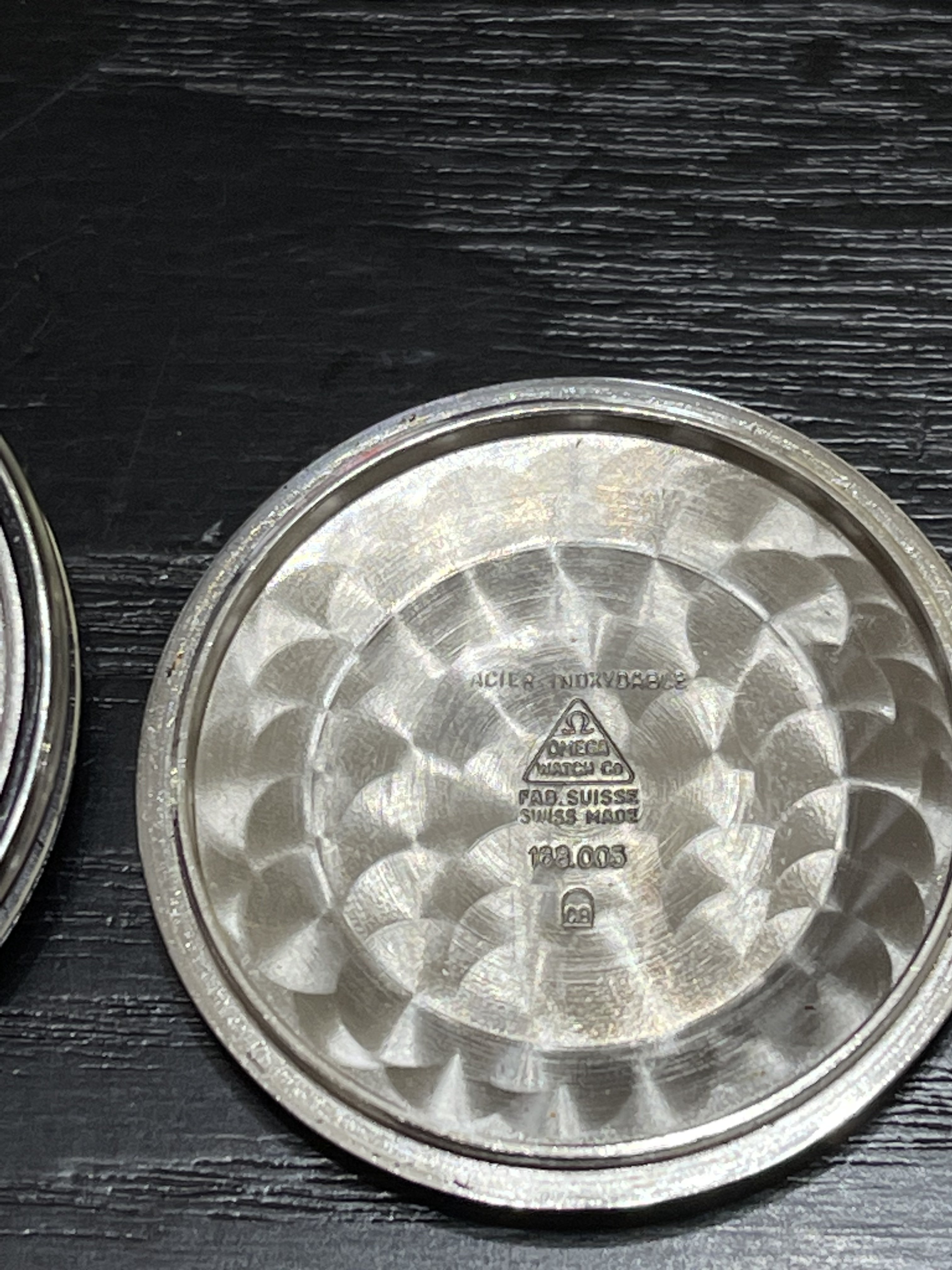

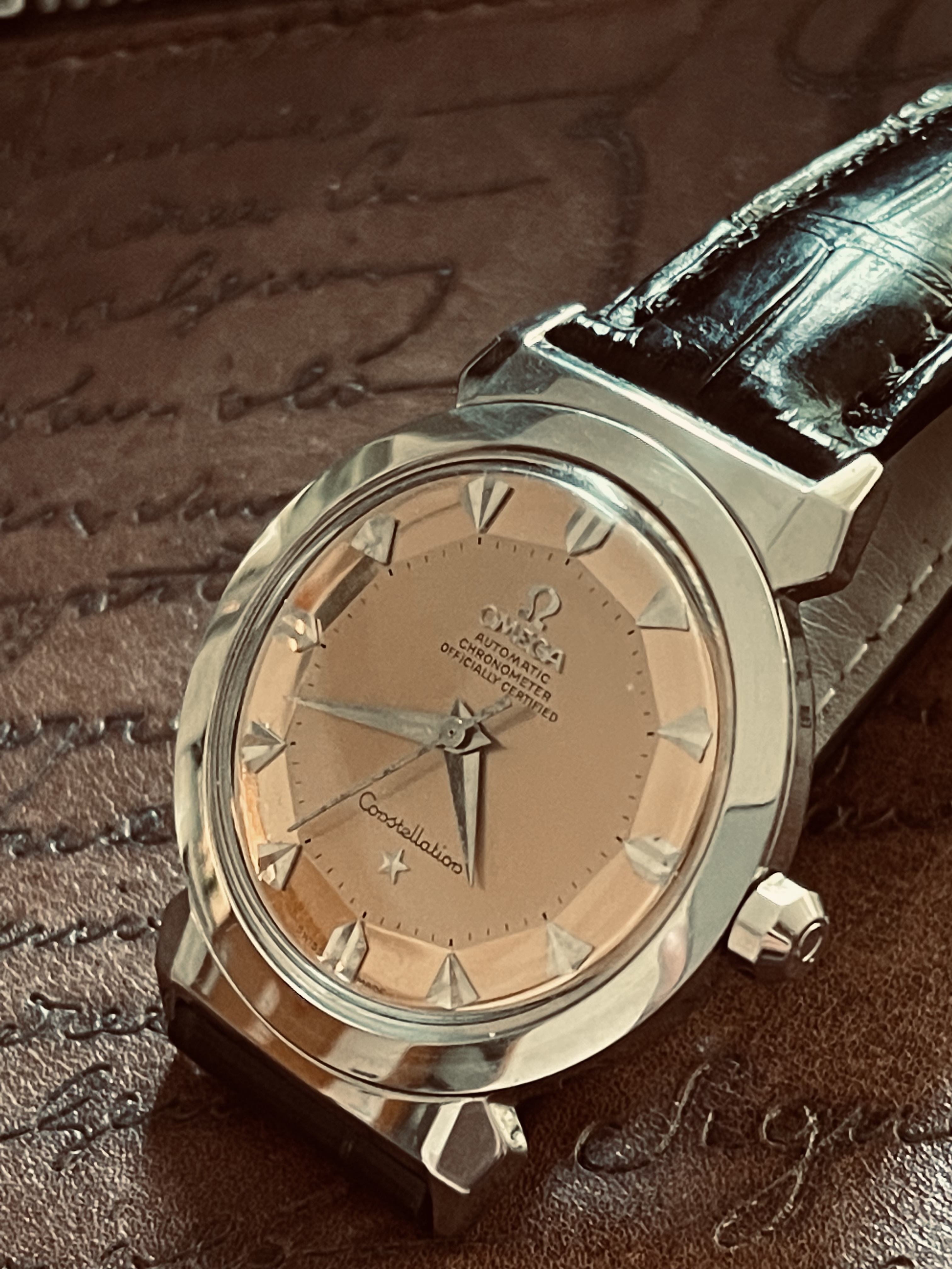

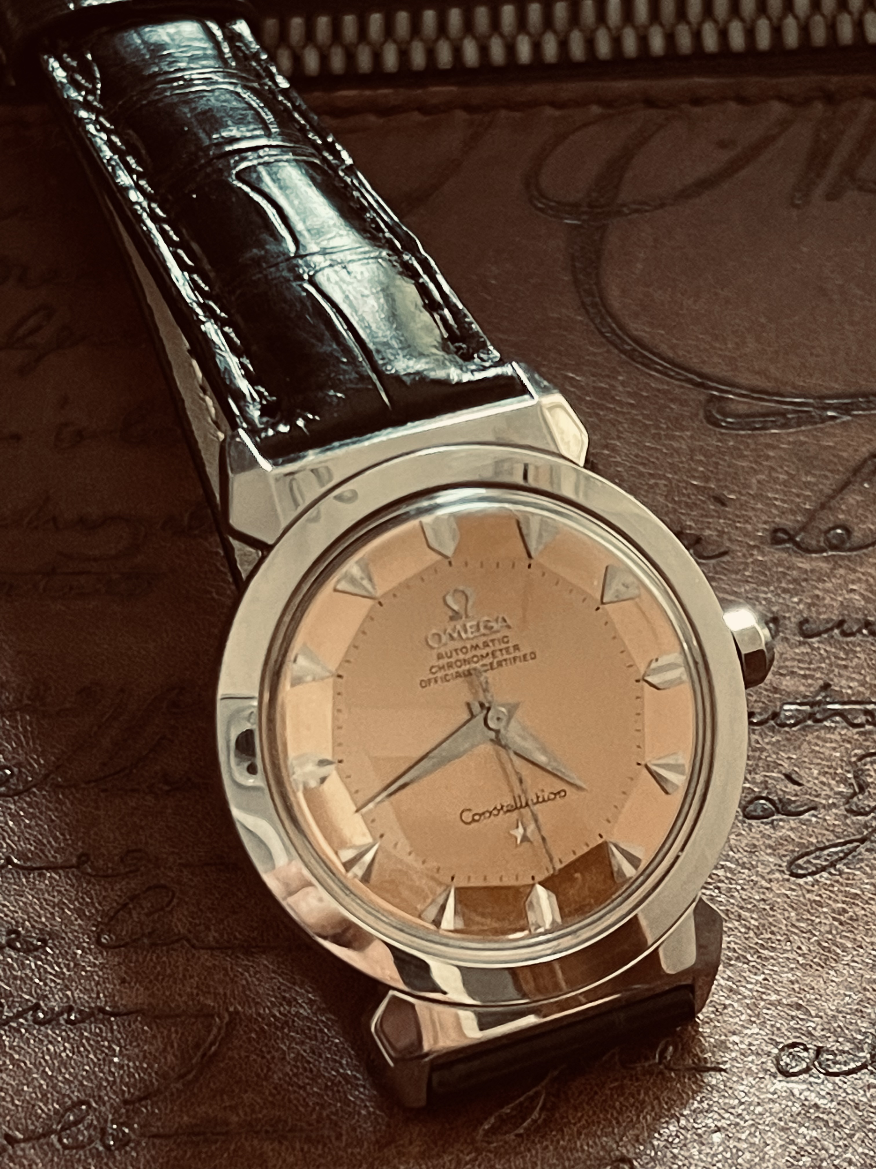

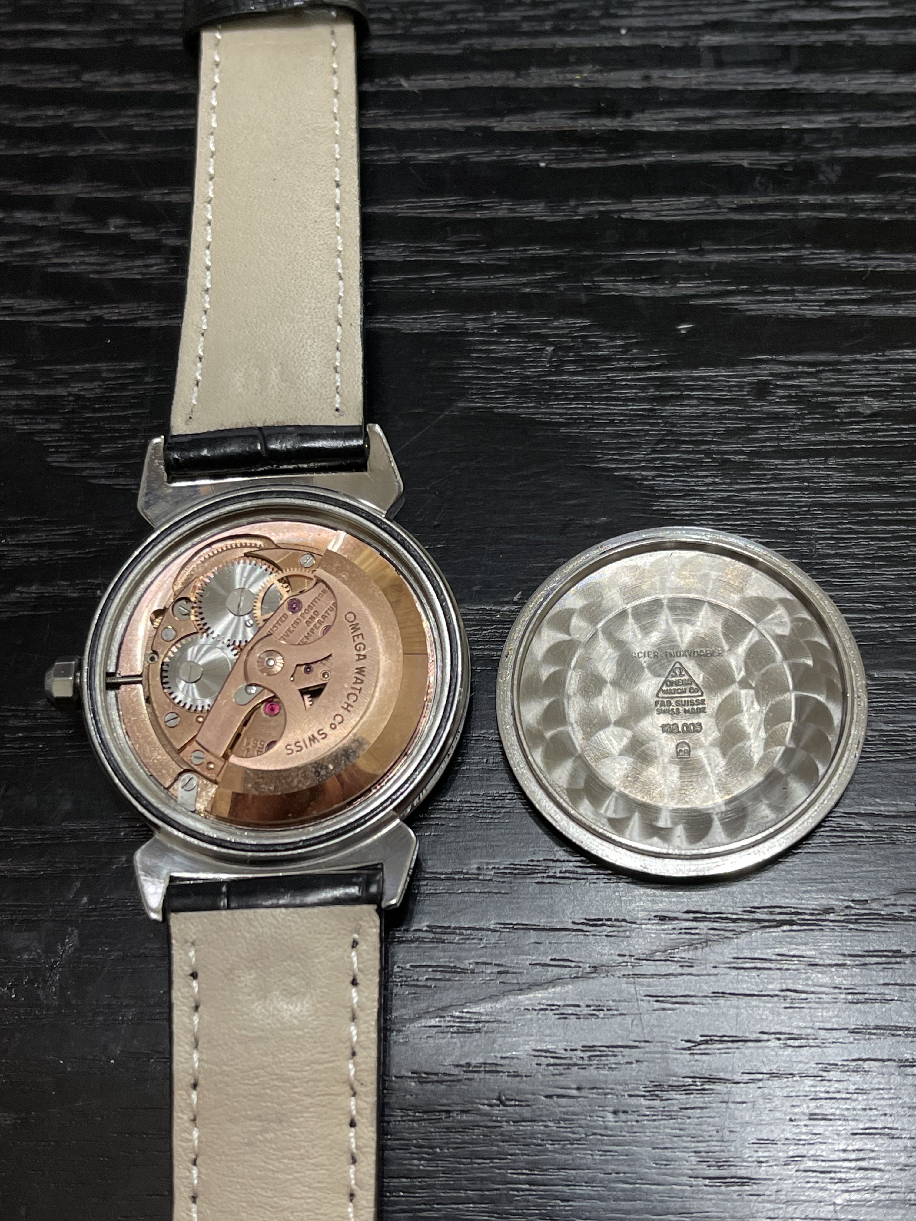

That’s definitely not a 168.005, its a lot of combined pieces from different sources
2,270
15,731
Is that a solid gold dial with silver indices?
10,125
57,953

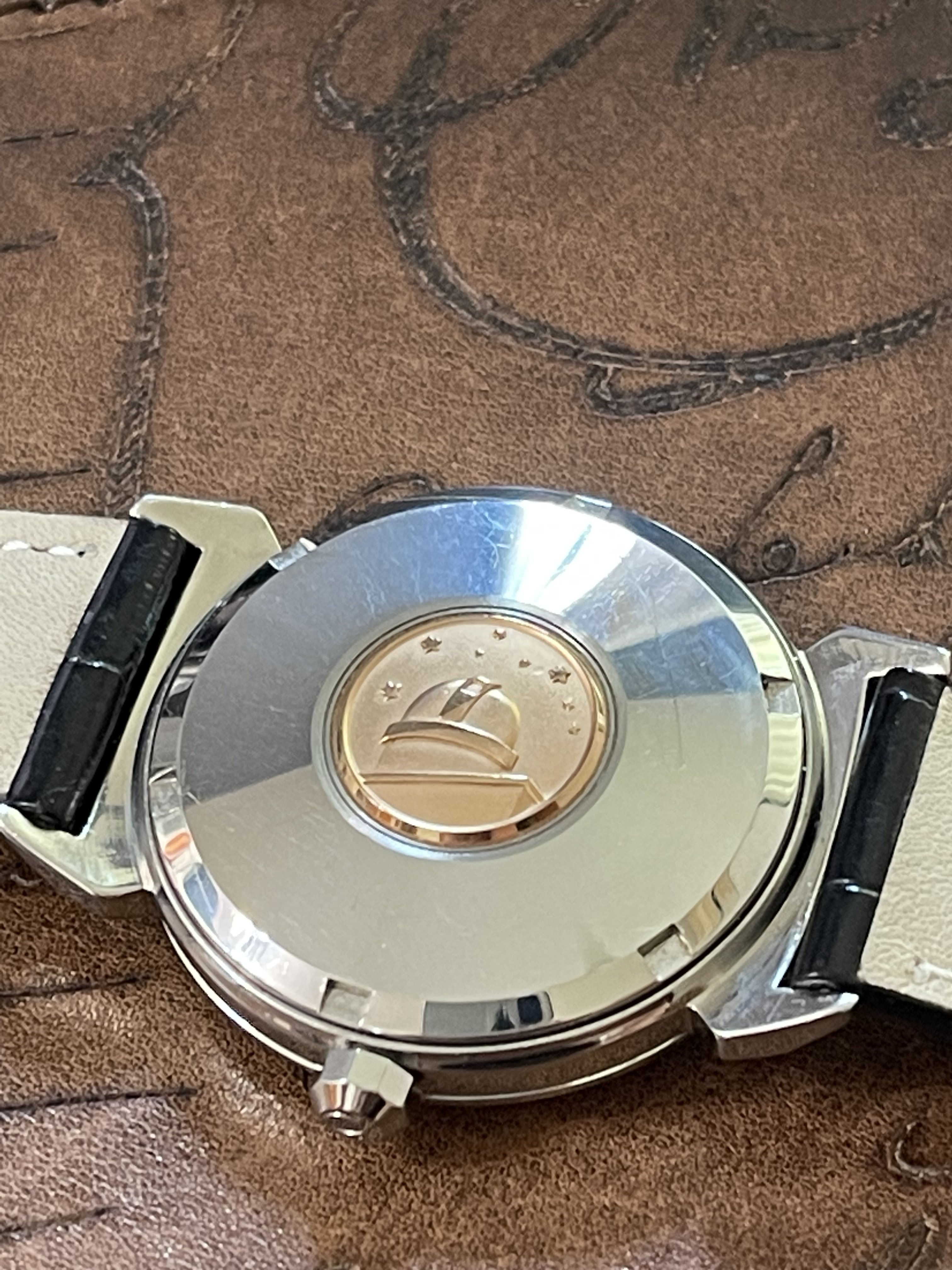

As dsio said, definitely not a 168.005. It looks like a put together of design elements of different vintage Constellation references, but I have to say that it's pretty well done. I'd like to see photos of the inside of the case back and the movement.
2,683
3,166
I think there are variations and combination for the pie pan dial
Send the rose gold C-Case to me please and thank you 😁
35,766
40,045
Btw my best guess at the first watch:
Early Constellation Deluxe dial and hands off something like an OT2799
Seamaster 14363 case
Late Constellation dogleg 168.005 caseback
Service replacement Constellation crown
Cal 551 movement out of a 168.007 / 14900 or similar
10,125
57,953
Indeed, you have some very nice pieces there, but the watch in question puzzles me. It's certainly not any dial variation of the 168.005 that I've ever seen (no date window and a caliber 551 under the hood) and I'm not aware of any Constellation reference 188.005. I'd like to hear from the OF vintage Connie experts on this, but I'm voting a put together.
2,270
15,731

But did it ever existed a deluxe dial with silver indices and hands?
Or was it ever made an dial in solid white gold and this is just patina making it look golden?
4,593
10,813
It's a factory prototype snuck out the back door by a technician.
Seriously tho, I like it and see no problem with it. Put togethers can be fun.
35,766
40,045
Or was it ever made a dial in solid white gold and this is just patina making it look golden?
It just looks like a gold or rose gold deluxe dial, its not uncommon for the hour markers and hands to end up paginating at a different rate from the dial on these especially if the its been exposed for a while as there’s that celluloid layer on the dial but not the hour markers, I’d guess the case was melted at some point for the gold content and the dial ended up getting saved.
2,270
15,731
So you are saying these indices is yellow or rose gold?
Maybe just the photos thats playing a trick but I have never seen gold hardware on Omega dials aged to look silver.

What puzzles me: 14363 and 14350 had snap-in case backs. The 168.005 is a screw-in. That must've been some work to make that fit.
10,125
57,953
Agreed. I like it.
35,766
40,045
The threads might just give enough friction for it to hold on as a snap back but they’re probably so fine that if you just put it on and used a watchmakers press the threads would just shear off or bend enough to work.
I think it was grand master watchmaker George Daniels who once said “if at first it doesn’t fit, use a bigger hammer”.
