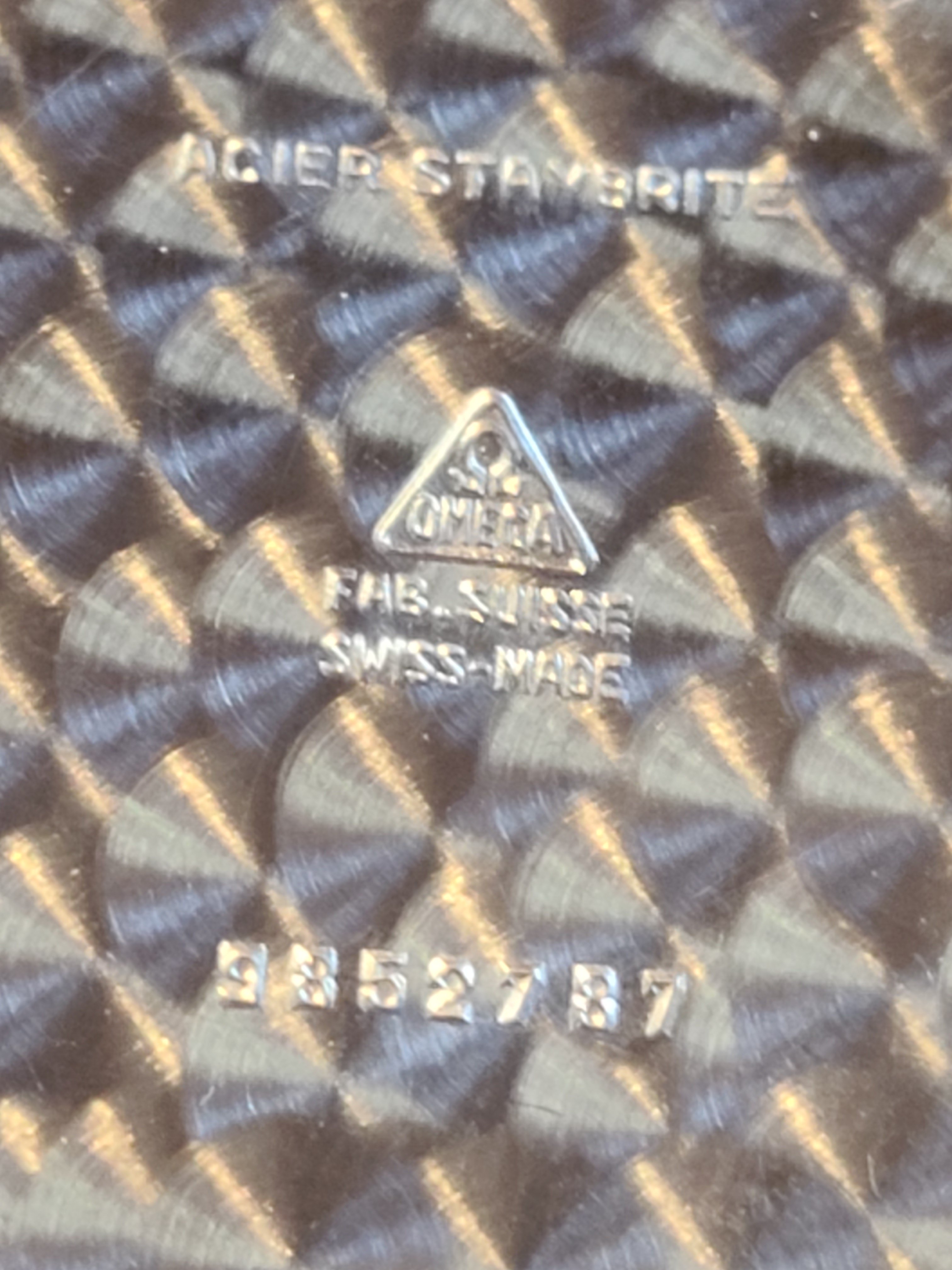

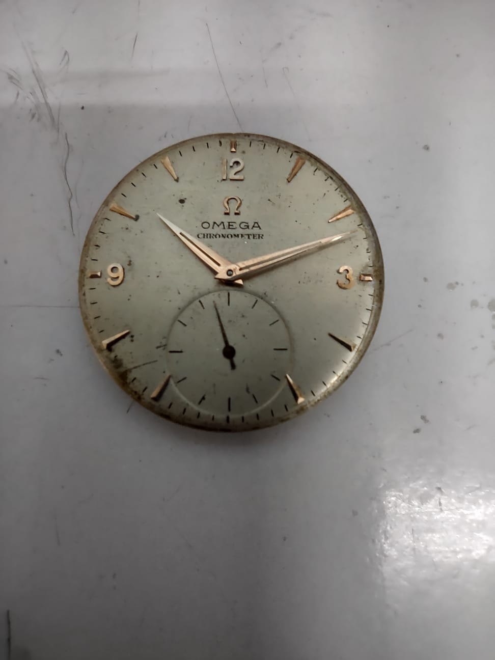

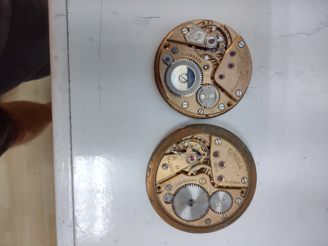

Hello to all,
Im trying to make my first Omega project. It’s an Omega chronometer that belongs to my watchmaker. He already started servicing the caliber even do I don’t have the right case, there is where I need your help. Does anyone know what case reference will suit this caliber , it’s from 1946, also what hands should fit, he already add the ones he has but don’t think are the right hands. Sharing some pics .
Dial measurement is 31,5 mm and seems refinished, let’s see if I get enough patients and lucky enough to find the right parts
Thanks to all
David

It will fit a ref 2366 case. The dial is the correct size for the 35,5 mm case, steel or gold. Dial is totally an old redial.
Personally would think leaf hands would be appropriate.
Do not understand what’s the meaning of the movement below.

Thanks a lot, the other movement got nothing to do with this thematic, sorry about it.

Movement of course is a 30T2Rg, also called 262 after 1949.
2,346
1,475
Fact is. The 30T2rg cases are pretty rare to find and expensive. As your watch won't be original (numbers in case won't match s/n of your movement)
You might be better off buying a case designed for 30 mm sized movements which are easier to find and use one of those

But 2366 cases in steel do not have serial numbers. If it was me trying to rebuilt a correct watch, would:
1- ask an extract from Omega, checking that it was indeed a redialled 2366, rather than originally in a 2364.
2- then look for a 2364 or 2366 steel case, accordingly
3- look for an original dial
4- look for original hands
5- look for original crown (unsigned) and a low domed crystal
6- get it serviced
and last, start paying the rates for the mortgage I had to take.
