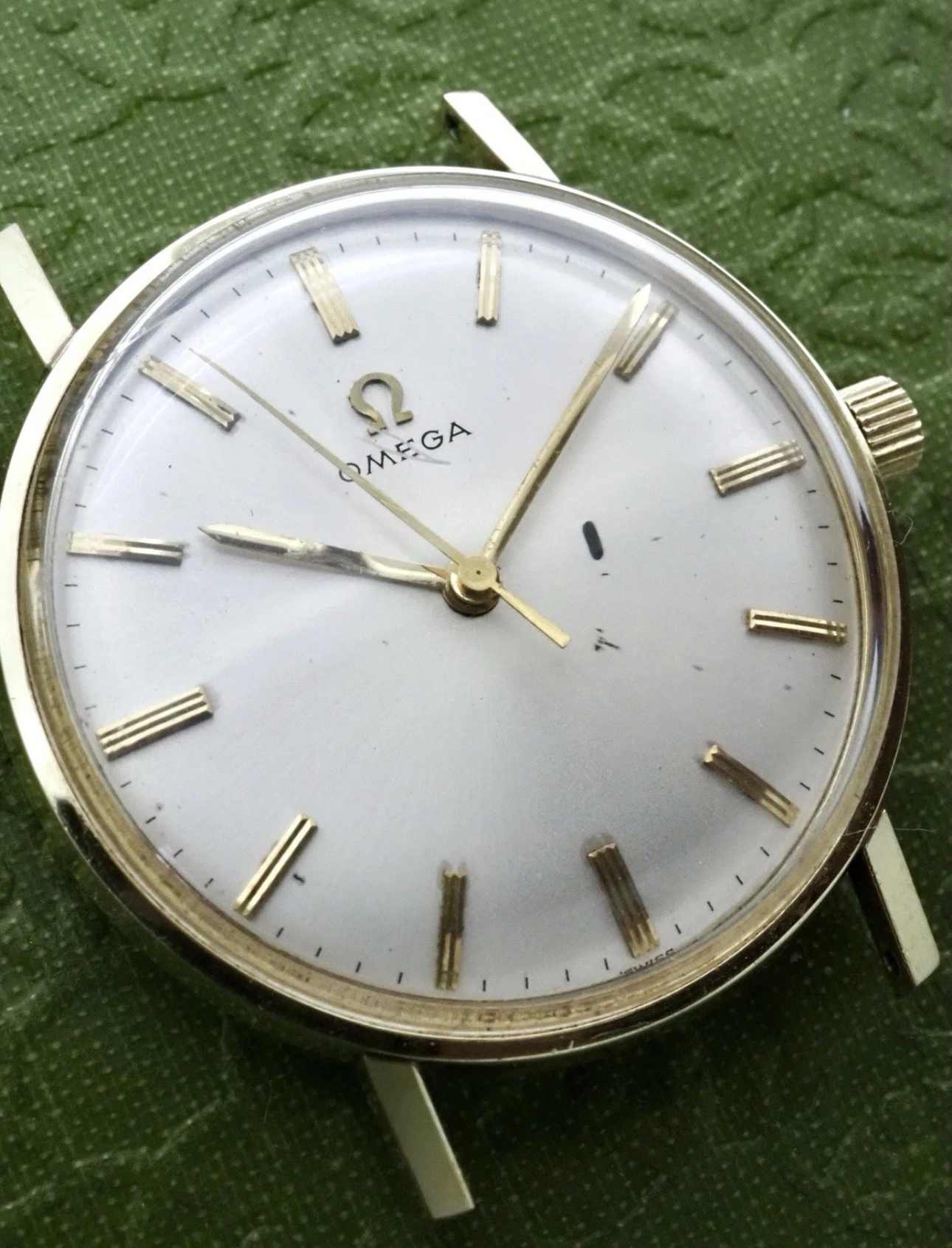

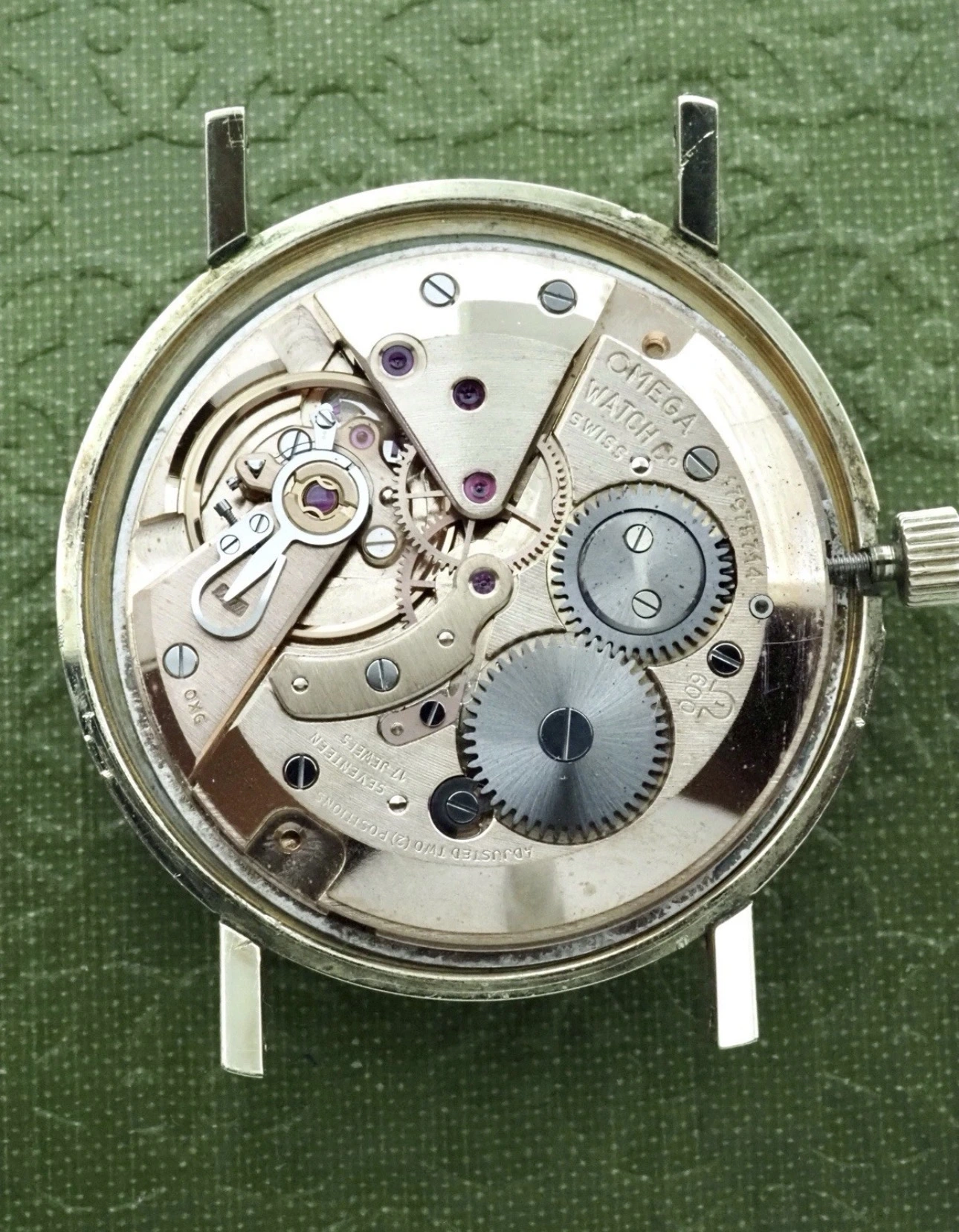

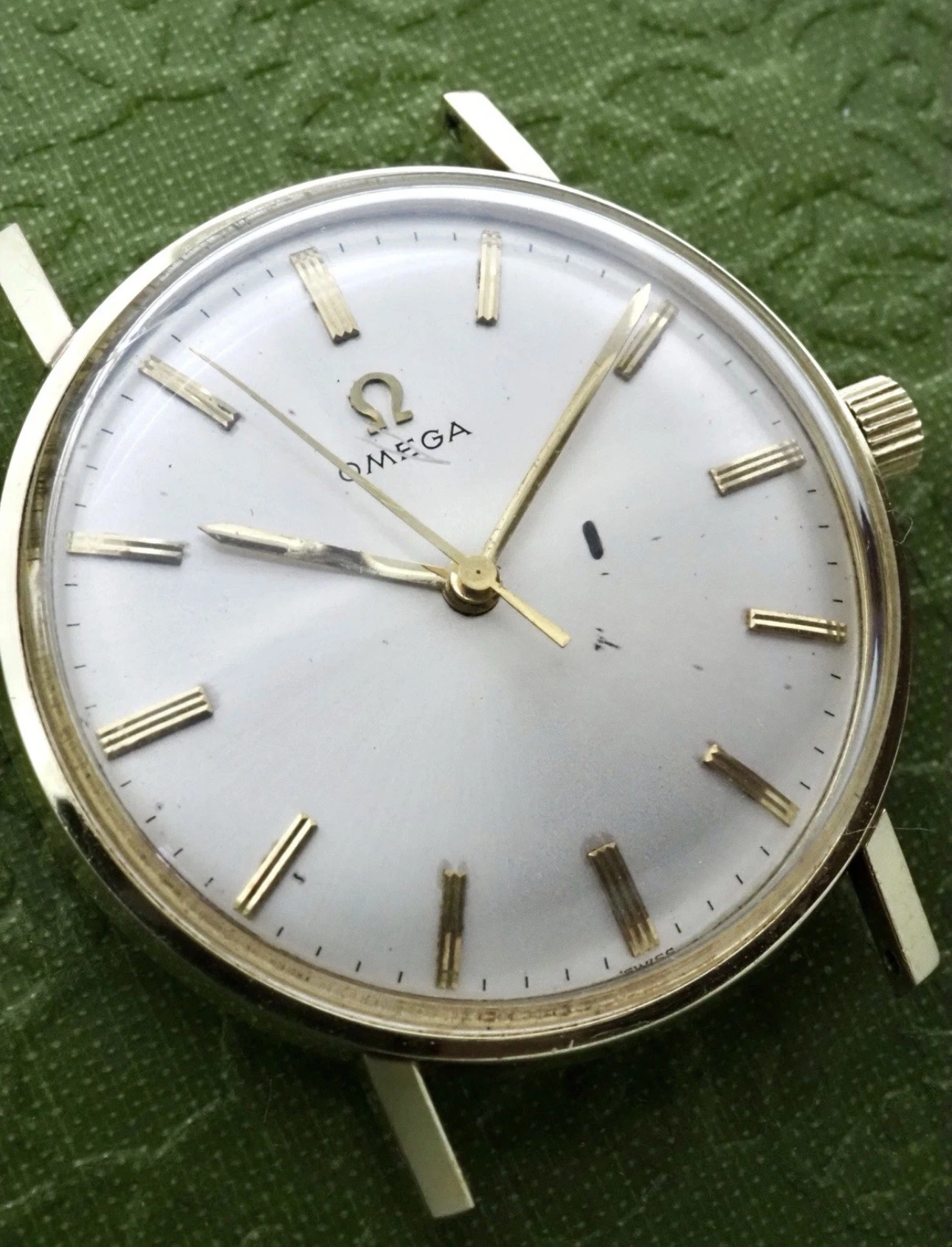

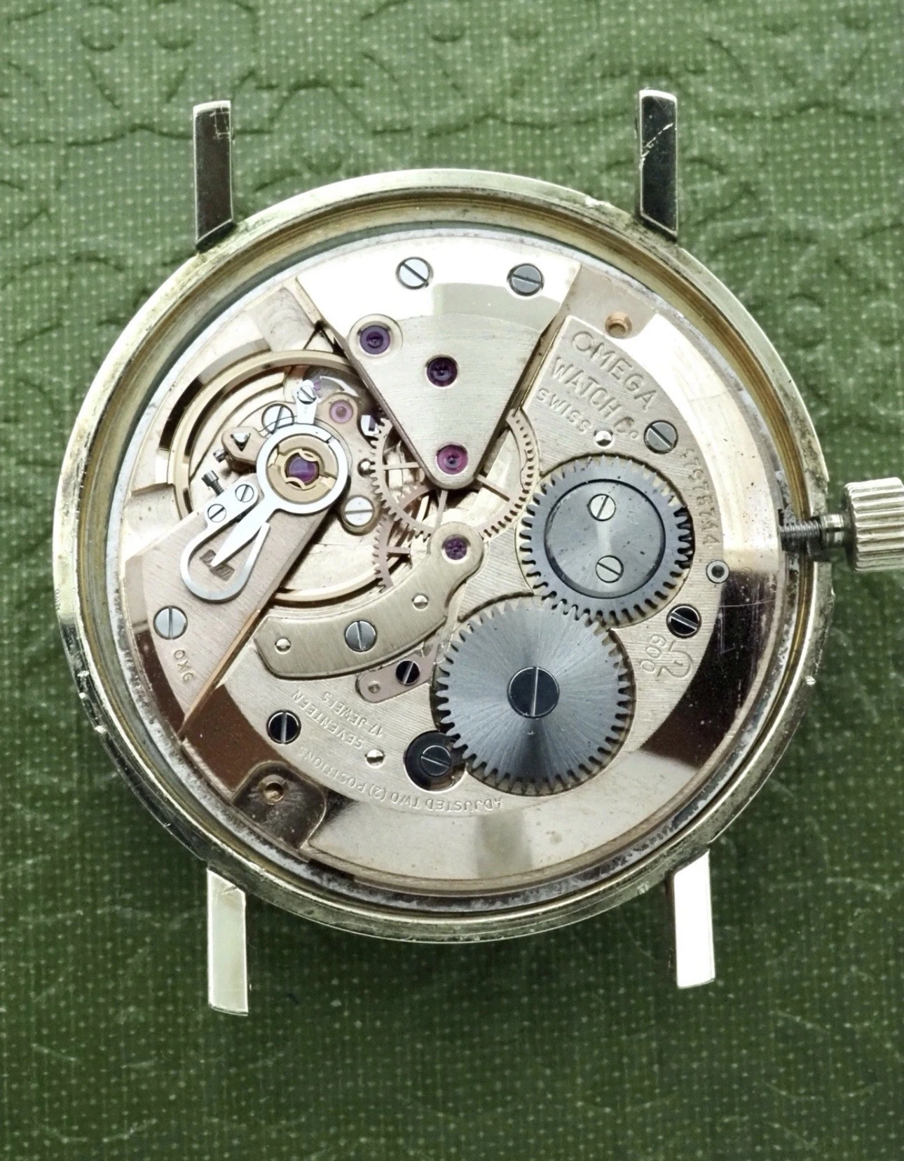

Paid 325$ for this vintage omega based off other examples online I think I did alright on this omega as long as all parts are genuine
24,815
55,164
The watch appears to be legit. US-cased 14k gold-filled gents watch with cal 600 hand-winding movement.
If the dial were not damaged, it would have been an ok price, IMO.
3
Thanks ! I’m not too worried about the dial damage as it’s all part of the story of the previous owner to me but glad to hear everything else seems to check out thanks for the expertise

What do you think the big black mark is? It's unusual, and almost looks like someone drew on the dial with a Sharpie. It's true that it's part of the watch's history, but it's not normal aging and I would find it very distracting, TBH.
3
Not 100% sure, interested to see what my local watchmaker thinks it is when I get the watch. Luckily I’m a weirdo and stuff like that doesn’t bother me too much haha

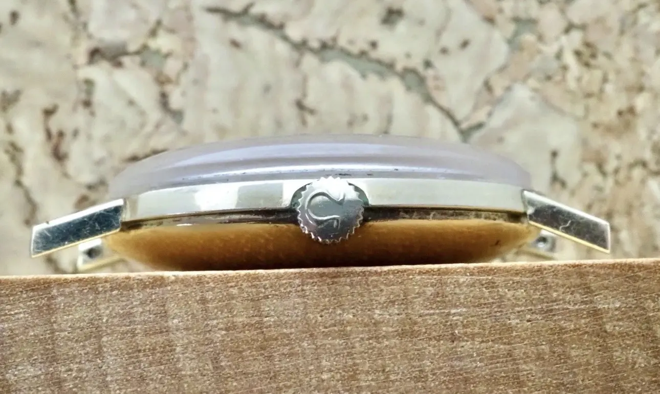

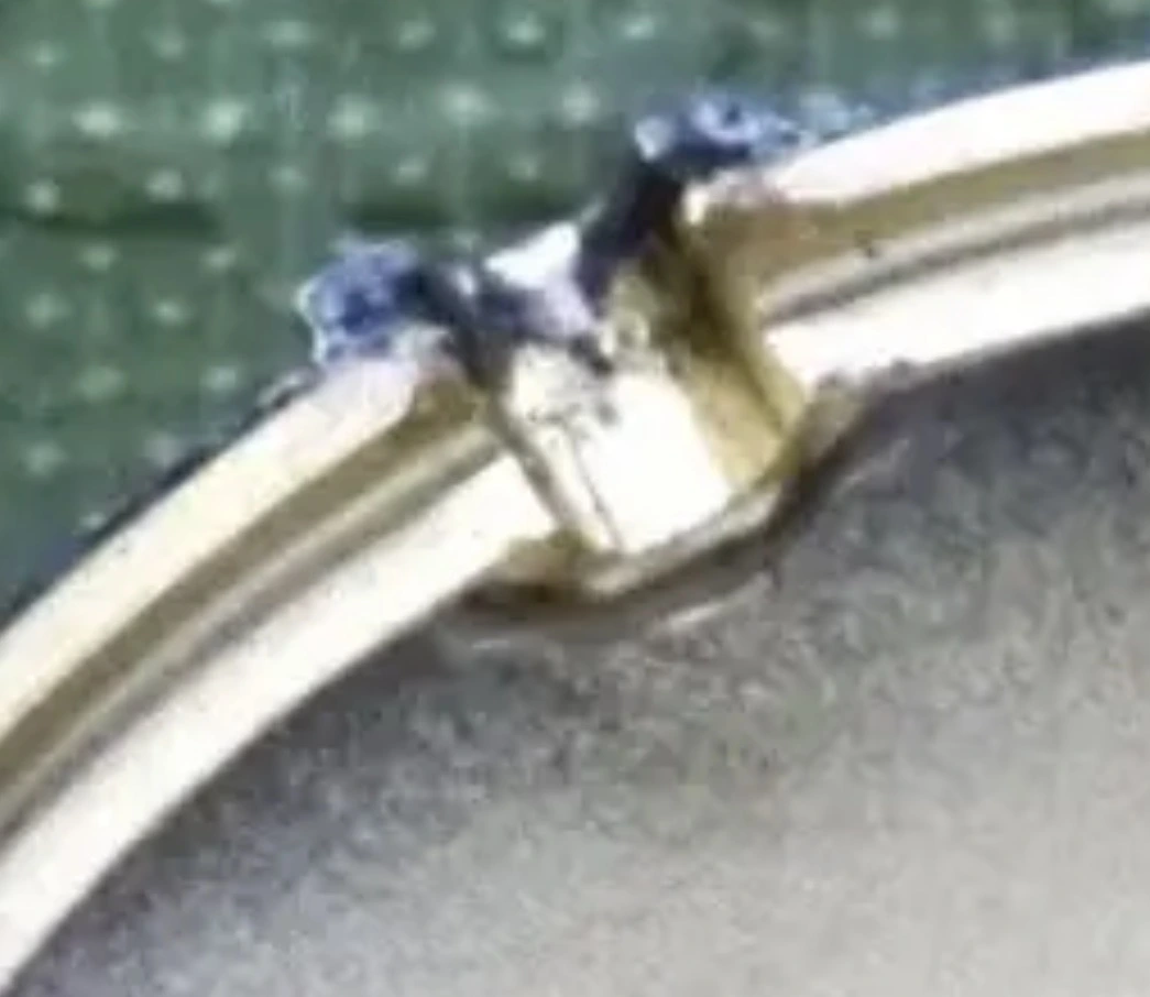

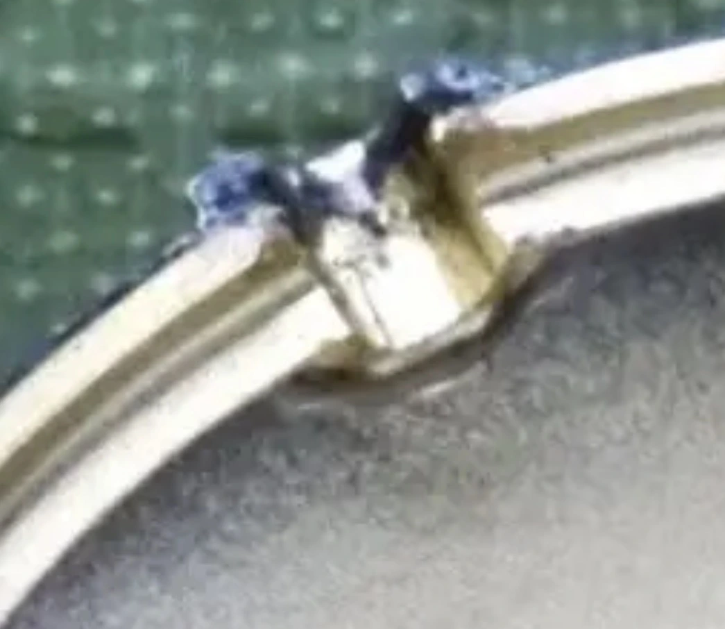

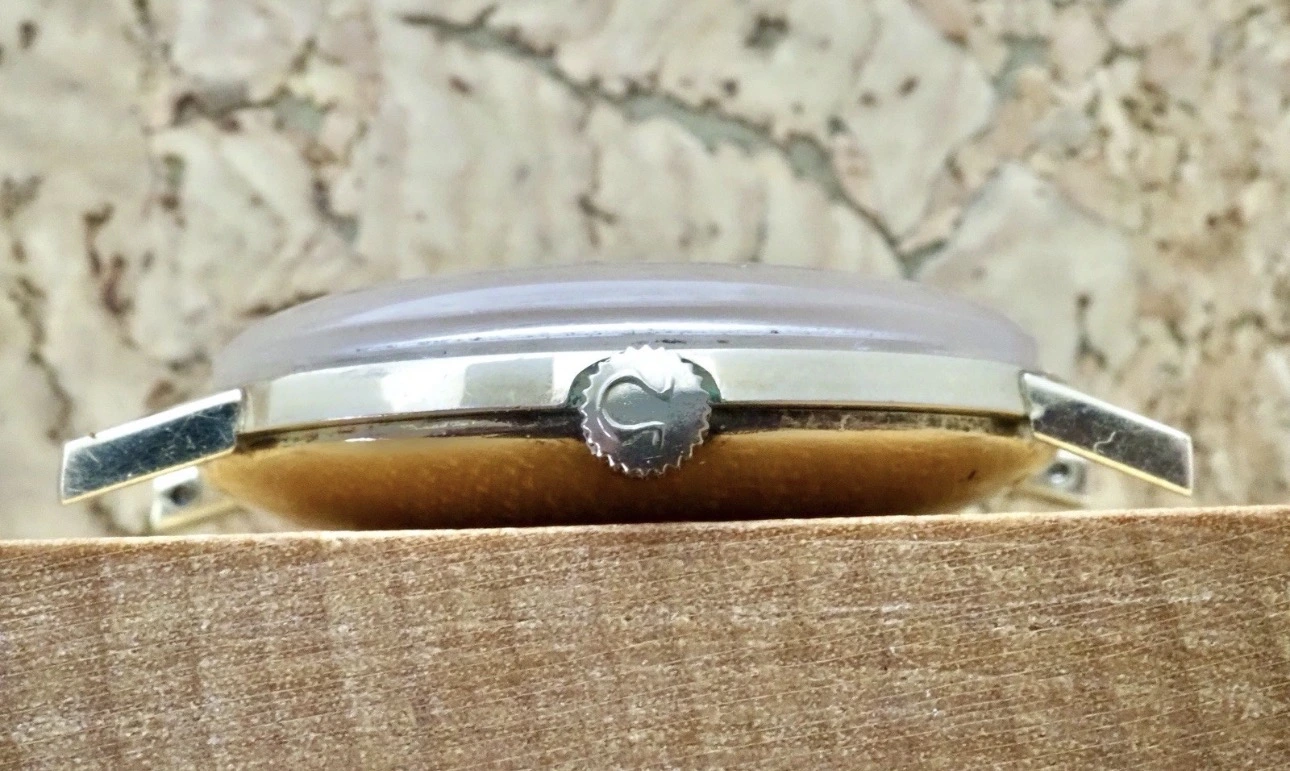

case tube looks broken I do believe
it protects the crown and makes the watch a bit more water resist
the main question is the movement parts
sometimes you can get cheap vintage Omega but many movement parts needs to be replaced

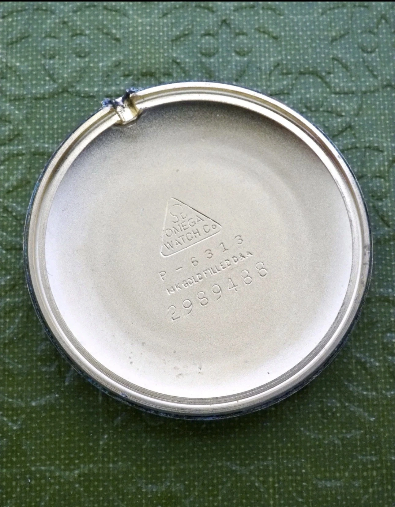

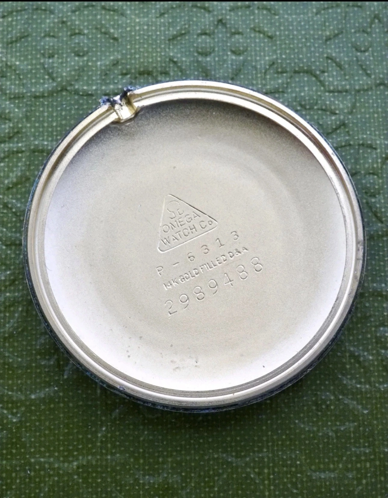

Case screws and clamps missing, no gasket, movement adaptor ring missing. You likely would have had to pay more if you had bought a COMPLETE watch! No deal, as I see it!

Here is hoping that the black on the dial is a Sharpie. The ink used in Sharpies is light sensitive and will completely fade over a few years in light.

jumping on opportunity’s sometimes isn’t the best’s thing to if you’re new and leaning or just purchasing it because it was slightly cheaper then others. 9/10 times it’ll be cheaper for the reasons listed above this reply, especially if it’s from a watch dealer or someone selling multiple watches they have the tendency of knowing value. in this situation you didn’t overpay in my eyes and definitely worth more if them marks come off the dial and can find some cheap mounts and screws , case is 14k gold filled with is good better then plated versions and looks to be in good condition lugs look nice and sharp movement looks relatively clean no rust ext but it’s all leaning. I stay well away from all the heavy trafficking seller websites but opportunities do arise often but they get snapped up very very quickly I’m all for jumping and impulse purchases if you know what to look out for and yes it’s a gamble, sometimes that doesn’t pay off but a win when they do. with waiting researching and a little leaning you can pick up stuff cheaper and better with little patience

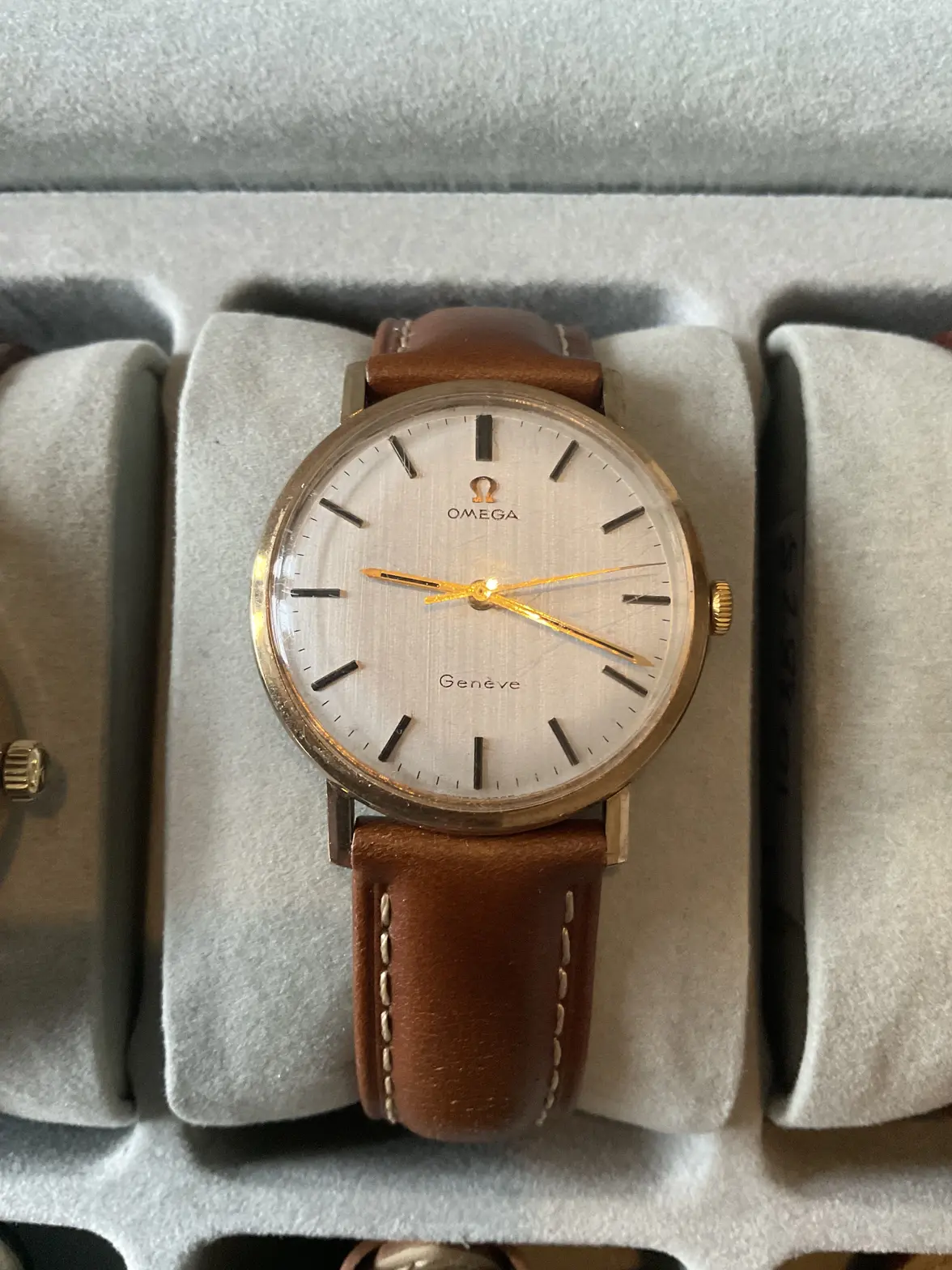

similar watch this is my 9ct Geneve 601 needs the crystal polished paid $316
Ps all vintage omegas need a home and we should love them however they look 😂😂
Tho the dial isn’t my ☕ 😉 Enjoy

Well now you can wear it stress free. Only these die hard collectors will see the flaws.
The mark on the dial?
Hum, the previous owner was a gunfighter. He killed one person. That mark was his notch.
