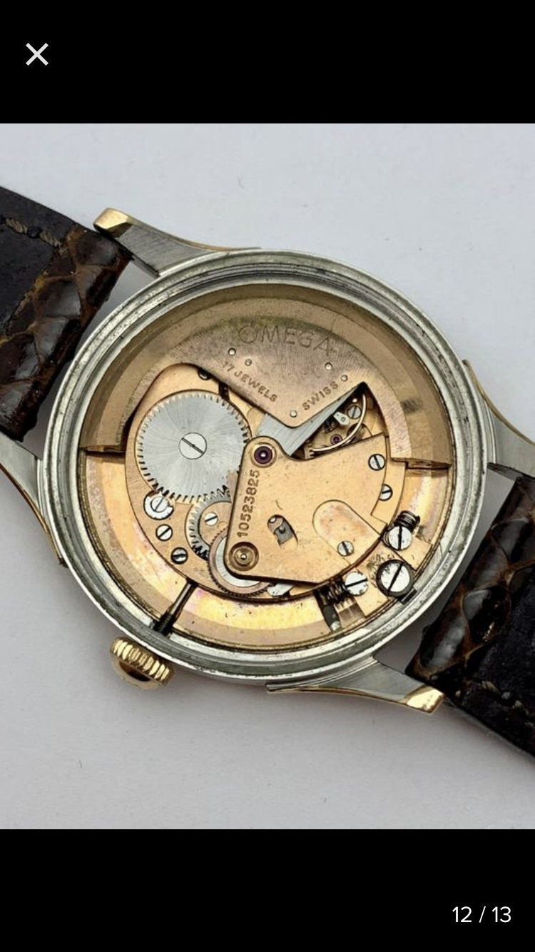

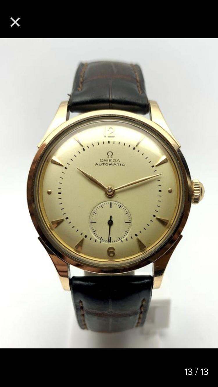

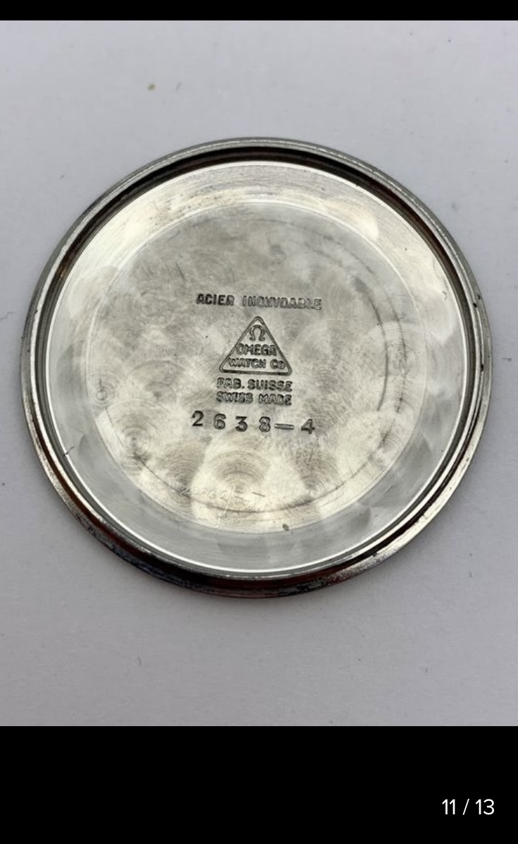

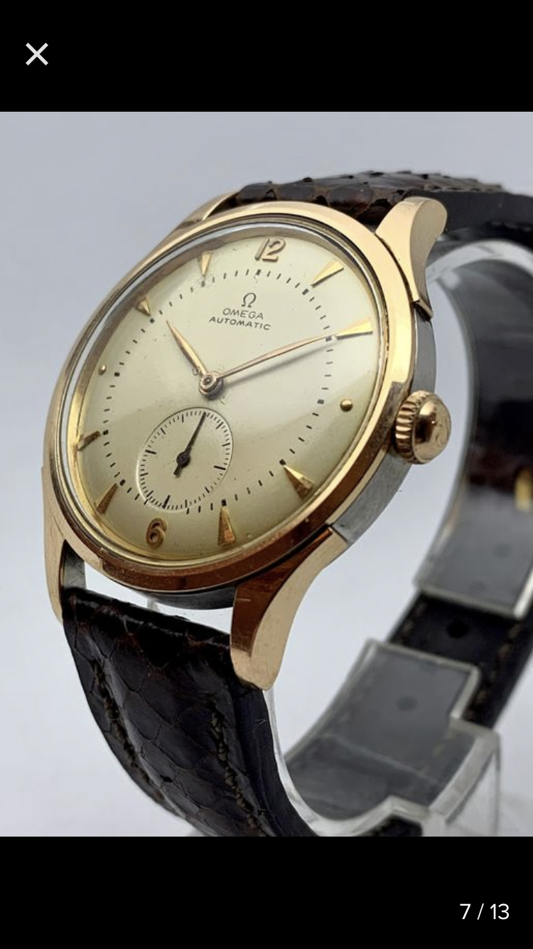

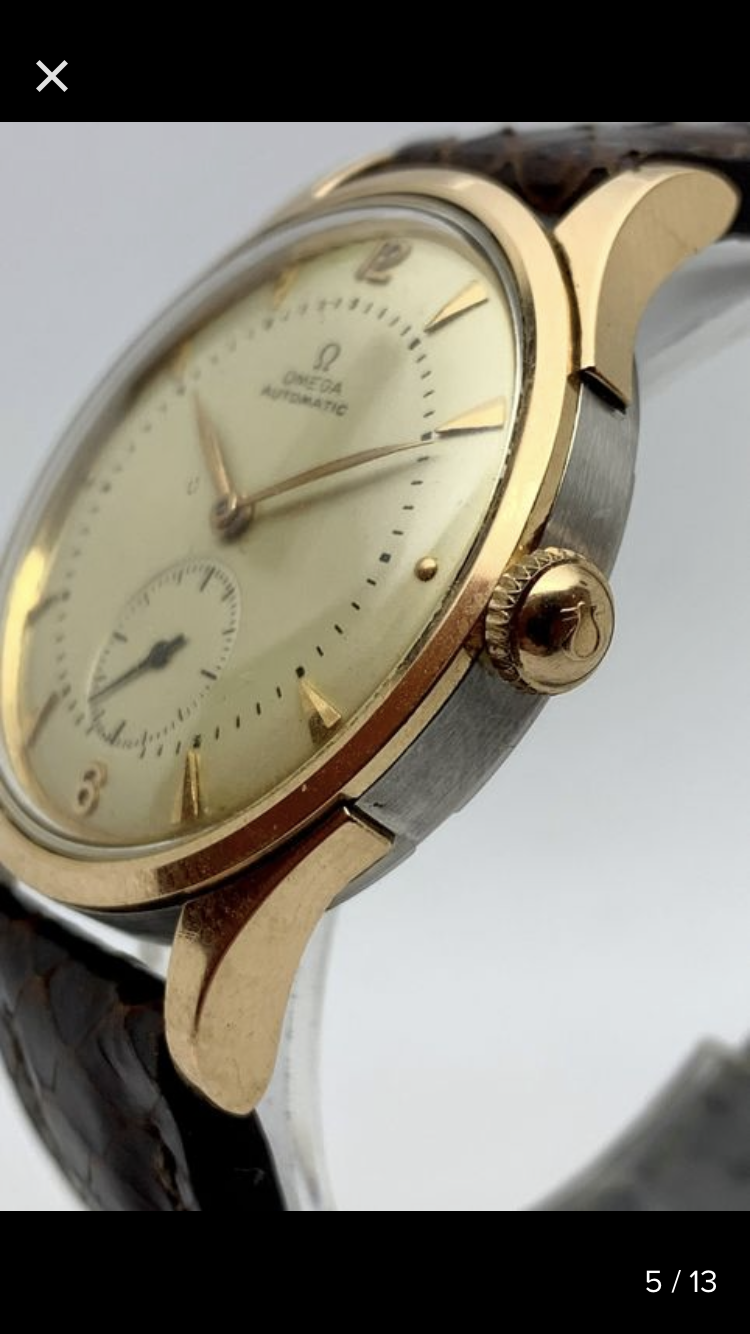

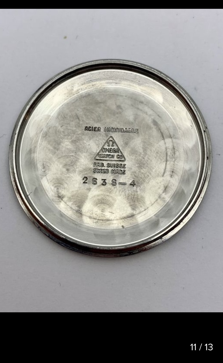

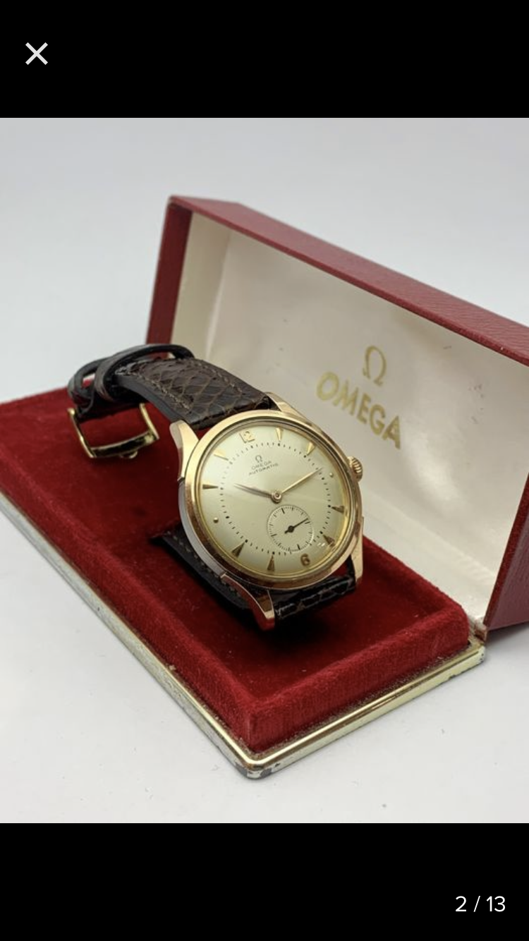

Dear all,
I was wondering if you could help me with the following. I bought this Omega (2638-4) from 1944 based on the serial number. I looked on the internet for a similar one but couldnt find one, and other Omega’s with ref 2638-4 look different. I was wondering if the ref is correct and in general if the watch is genuine. Thanks in advance for your reactions. View attachment 1459122

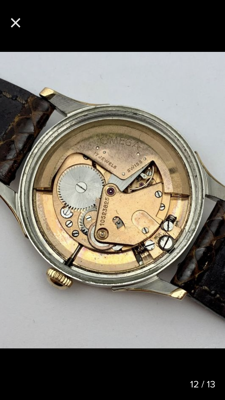

The answer is obvious when you compare the condition of the movement to the look of the dial.
I suspect the watch has had an external beauty makeover, including a facelift, to present it for sale, but the movement was ignored.
10,134
58,070
Agree with JimInOz. OP, where did you buy it? Can you return it?
24,843
55,270
The seller should have disclosed that the dial was repainted, because it was not a very professional job IMO.
10,134
58,070
My thought as well. If it was an eBay purchase and the redial wasn’t disclosed, the OP should be able to return it for a refund.
3,601
13,568
+1 - they could’ve at least tried to center the second scale in the subdial. And where’s the Swiss Made… return if you can.
Thanks for the replies. I bought the watch on Catawiki (auction site) and the watch was estimated to be worth 800-1000 euro. Is the watch a ‘frankenwatch’? The seller didnt say anything about a redial / repainting.
3,601
13,568
The Catawiki evaluations are best ignored. They can be anything between 1000% too high to 10% of the actual value.
Don’t know if your watch is a Frankenwatch, eg made of parts from different refs, but it certainly is a redial and that should’ve be disclosed, as it reduces the value significantly (to parts value, basically, if you ask collectors).
Original dials are around 50% of the watch value. So : Repaint = minus 50% .
That's the problem with catawiki. The so called experts there make a estimate, which gives a item credibility, while the auctioneers know jack shit about watches.

The seller and I came to an agreement and the transaction is canceled. Next time i will post my potential buy on the forum. I want to thank you all for the advice / sharing your knowledge.
