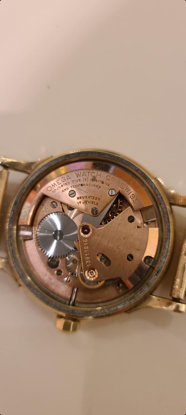

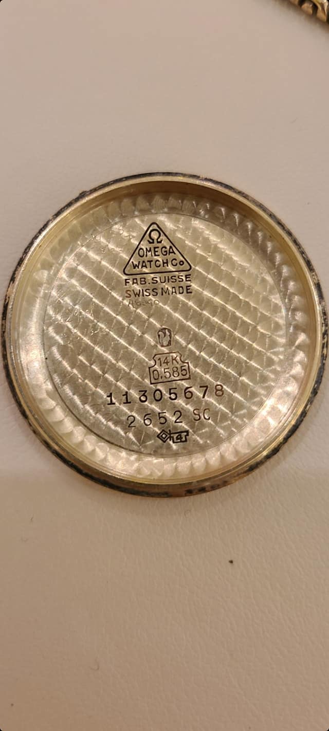

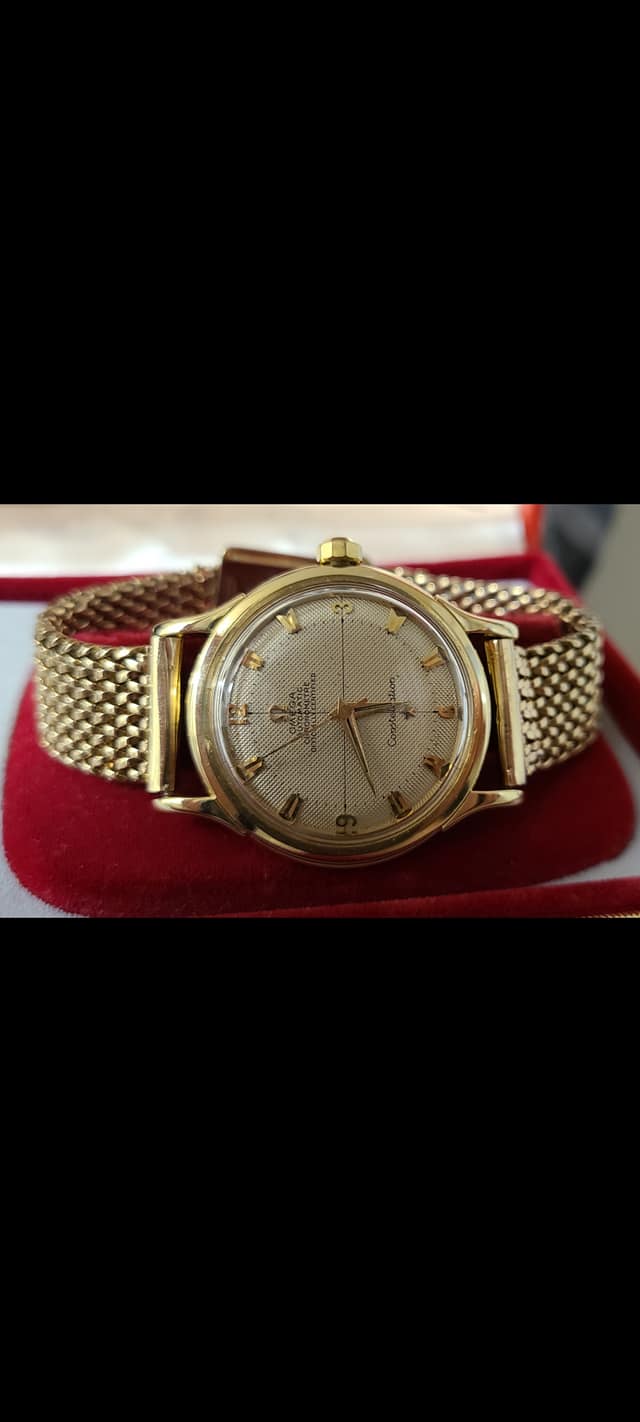

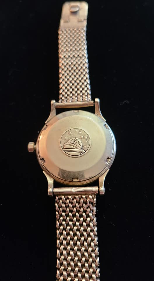

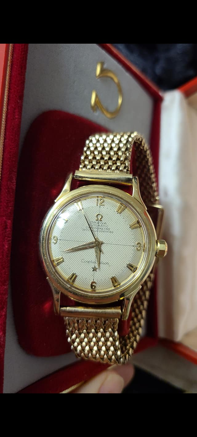

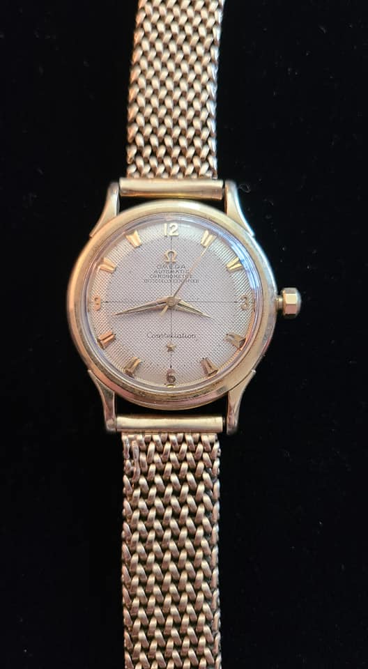

Hello everyone!
I acquired this watch from an estate sale in Vancouver BC Canada. I don't know much about these watches other than that they gained popularity with the show Mad Men.
it is a 14k Case, the band is not Omega, it is a Birks 10k band.
What can you tell me about this? i know its from the 1950's but not sure what specific year.
I would like to get it appraised as well, to know its worth.
Thank you any information is greatly appreciated!

You have an early Constellation with a textured dial and a bumper movement.
in good condition these are very desirable watches.
Looks like the dial has been cleaned and possibly repainted - but we would need clear, straight-on photos of the dial to assess it properly.
The case has seen some polishing.
Unfortunately, the premium value of these watches is heavily affected by the quality of the dial.
It will always have intrinsic value due to the gold content but if it has been redialled you won’t realise top (collectors’) dollar for the watch.
you would probably be better off selling the gold mesh bracelet separately to the watch head.

hard to tell with the images, but it's possible the "swiss made" is being covered by an oversized rehaut.

If that is a redial, it is the best I ever saw. I would gladly pay $ on the basis of the pictures supplied. Everything is correct: MOY, crosshairs, minute markers, two-tone (which in itself is extremely hard to get right).
Agree, the bracelet must go on its own.

Nice watch and all correct as far as I am concerned. If you'd like to sell bracelet please get in touch, I might be interested.

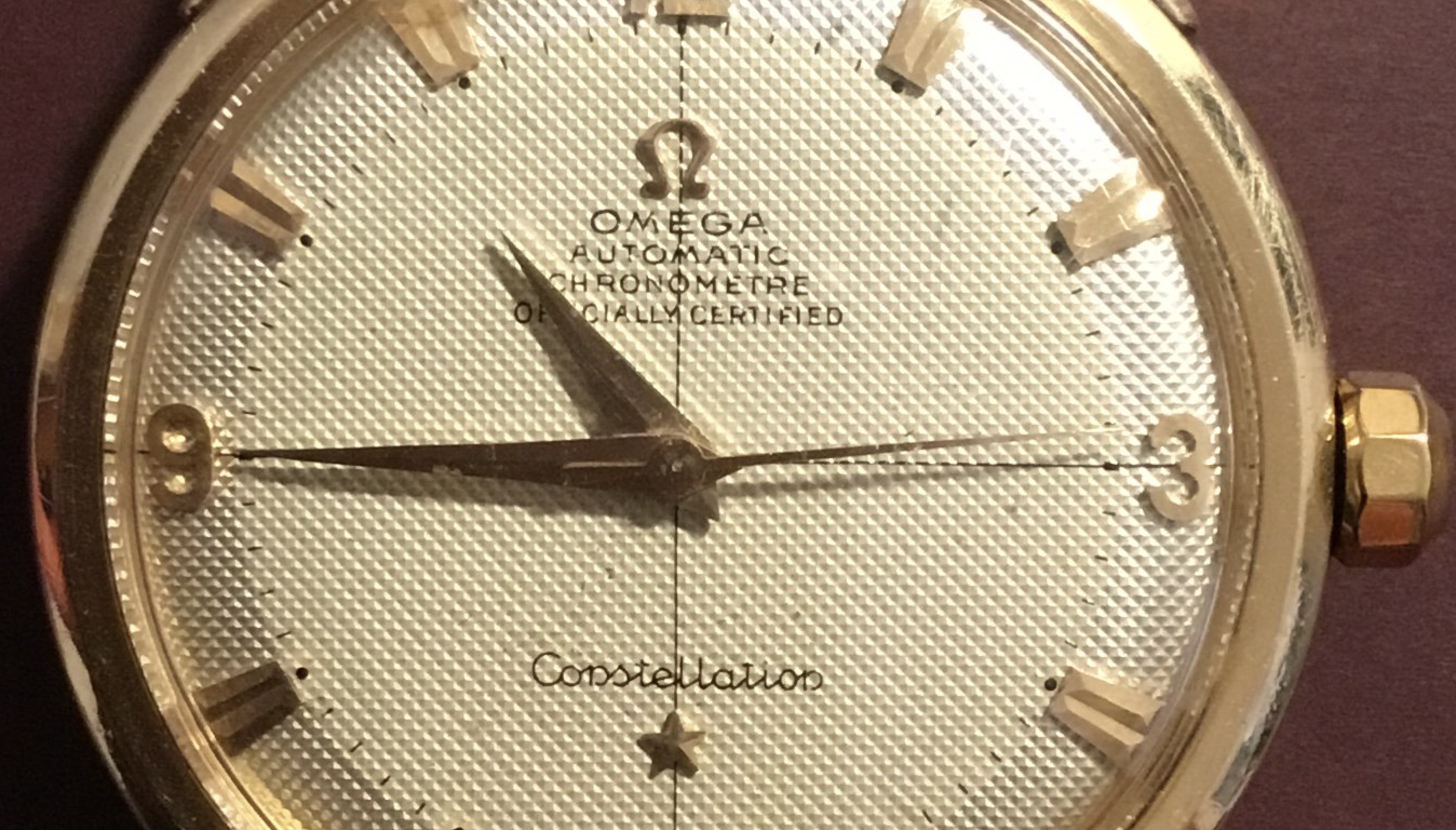

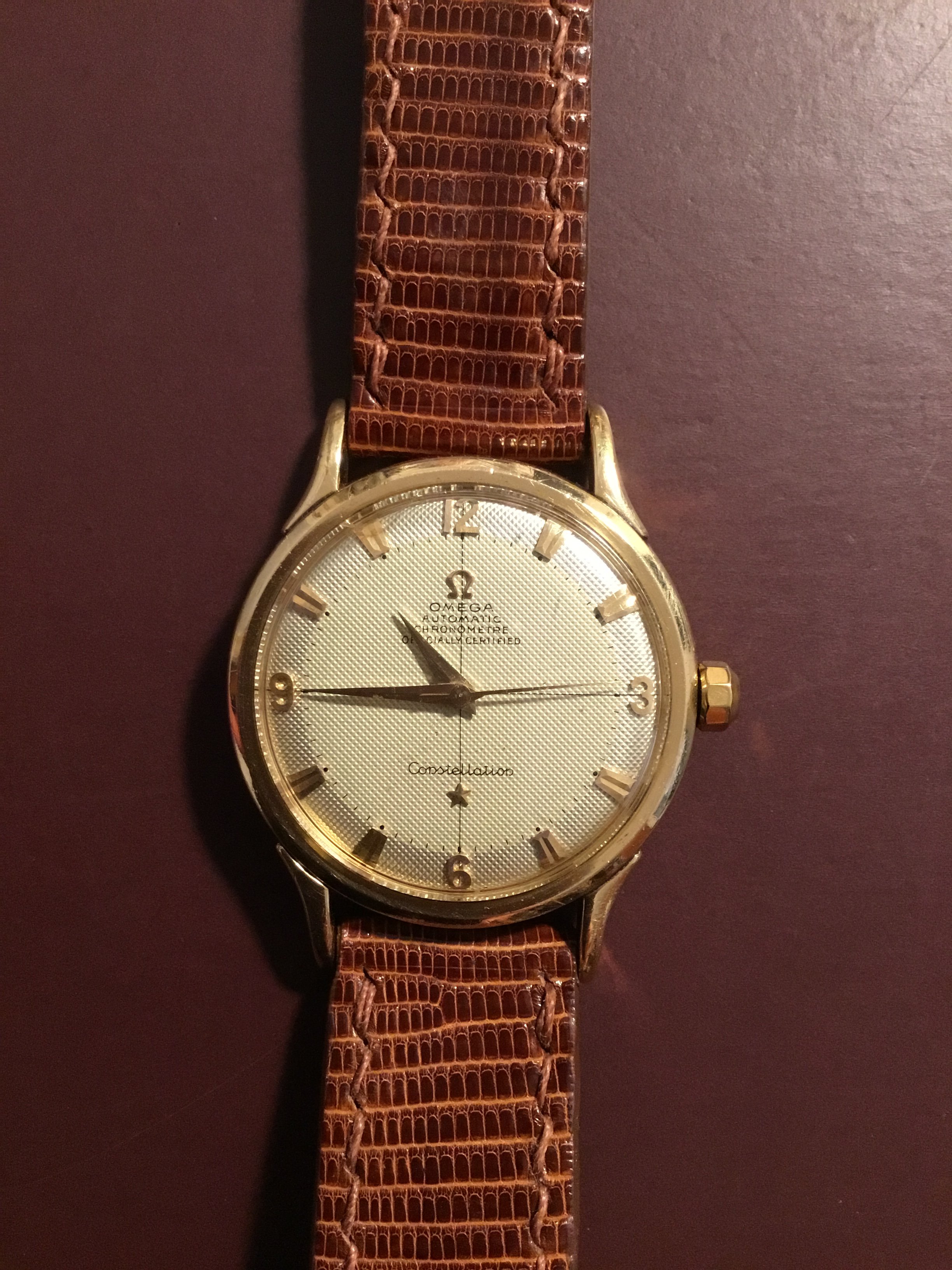

The dial seems original to my eyes. Here’s my 2648 snap back for comparison. The 2652 offered a variety of dials and had a thicker bezel/smaller dial with screw back. Can’t tell from the movement picture what the caliber is but the serial number dates this to approximately 1953. Could be a 352 caliber but seems to me that a 354 is more likely.

The picture you've re-posted is the 2648 from @KAP and not the OP's watch in question.
The 2652 dial looks fine to me, I'd like to see another picture of the seconds hand to decide whether or not it is the correct length

Thank you all for your responses, I tried to take a closer photo of the dial for you to assess. I don't see a "Swiss made" under the 6.
However I do know this watch was put away for a long time and only taken out last year after 30+ years, so I am not sure how much wear it has seen.

I don't see a swiss mark, but yes my husband was looking at information on FB marketplace. Here is a new photo of the dial in question.
