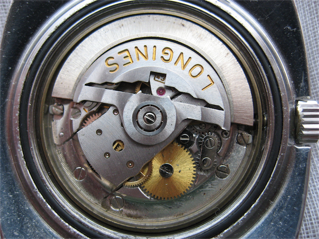

    A while ago, I got a Longines 8484 diver with hummer movement:
    Looks nice, but half of the bezel was stripped of teeth underneath and was very loose. The crown gasket melted onto the winding tube. The bracelet and end links were atrociously polished and bent beyond recognition. And of course, the date would not advance. I got lucky and the seller refunded my money.

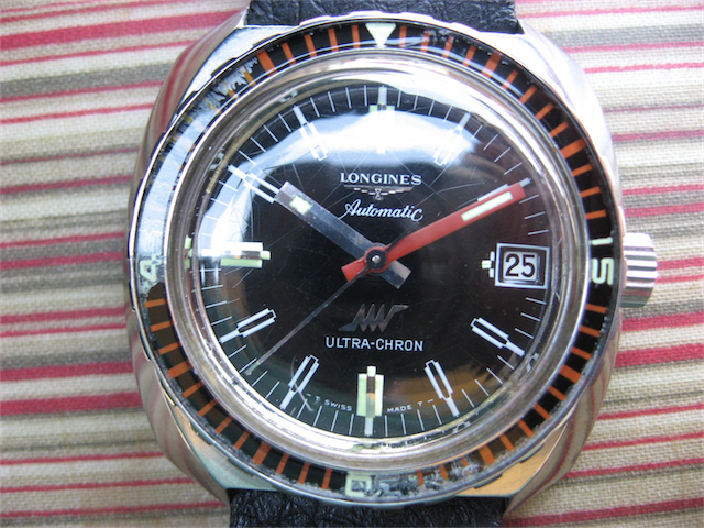

    Thinking it might prove a better piece, I recently got this 7970-3:
    Looks nice, yes?

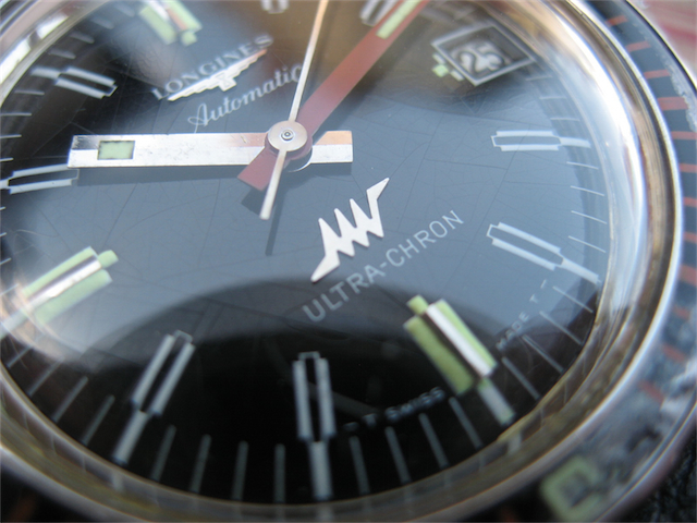

    Oh wait, move the watch a little in the light and the dial's condition becomes apparent:

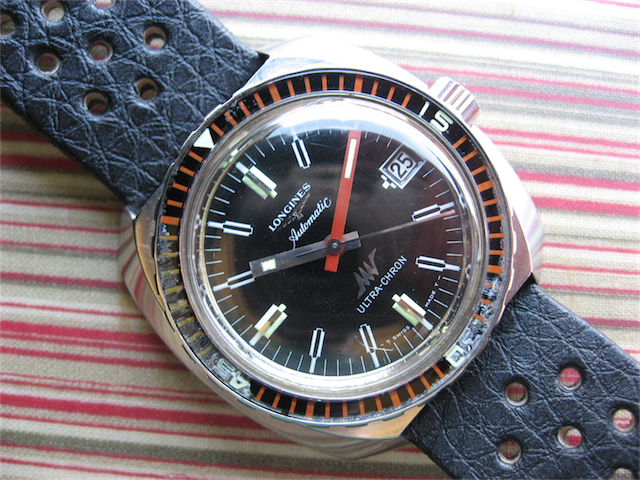

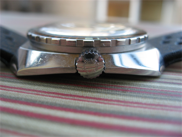

    I knew the bezel was cosmetically rough. No problem. The case is in decent, perhaps good condition.

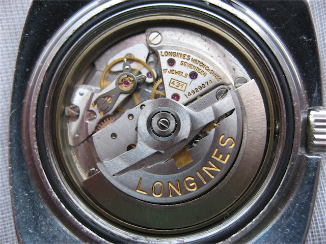

    The movement, however, appears to have bits of oxidation all over. Or else that is graphite lubricant making a mess.
    Something got messy on the caseback and will not come off. Moisture damage?
    All said, however, I like the watch. The size and shape suit me. I am worried about the movement, though. It seems to keep time well enough, but the sweep seconds hand moves erratically, especially between 12 and 6.

    The movement does not look bad at all in those photos - yes there is some debris there, but that's not unusual for a vintage movement that would need servicing. The sweep hand might be a little irregular, but that should be an easy fix at service. This movement uses an indirectly driven sweep hand, and has a friction spring like many of these designs do - see here:
    [​IMG]
    The spring is the gold coloured flat piece at the red arrow - usually adjusting the tension of this spring (on a properly serviced watch) will eliminate any jittery hand movements.
    Swatch Group no longer supplies parts for these watches, so you would be relying on the open market for the parts - for example these use a sealed mainspring barrel that is intended to be replaced as a unit, and I was able to get 2 from my local material supplier, so parts are out there, just not sure if the supply is good for all parts.
    Cheers, Al

    Many thanks, Al. That helps assuage a few of my fears.
    I noticed yesterday that the winding rotor weight was loose on its carrier. This is visible in the movement photos above—the gap between the "Longines" carrier and outer weight. I gently nudged it back in, but once again, it makes me wonder if this is a keeper.

    Ah yes I missed that as I was too busy looking for rust. Although I can't say for sure with this movement, typically they can be fixed quite easily. Here is an example on an ETA 7750 based watch - PAM104 - where you can see the weight came completely off:
    [​IMG]
    It snapped back in place quite easily:
    [​IMG]
    I suspect yours would be the same, but it's something that should be done before you wear the watch much. along with a service.
    Cheers, Al
