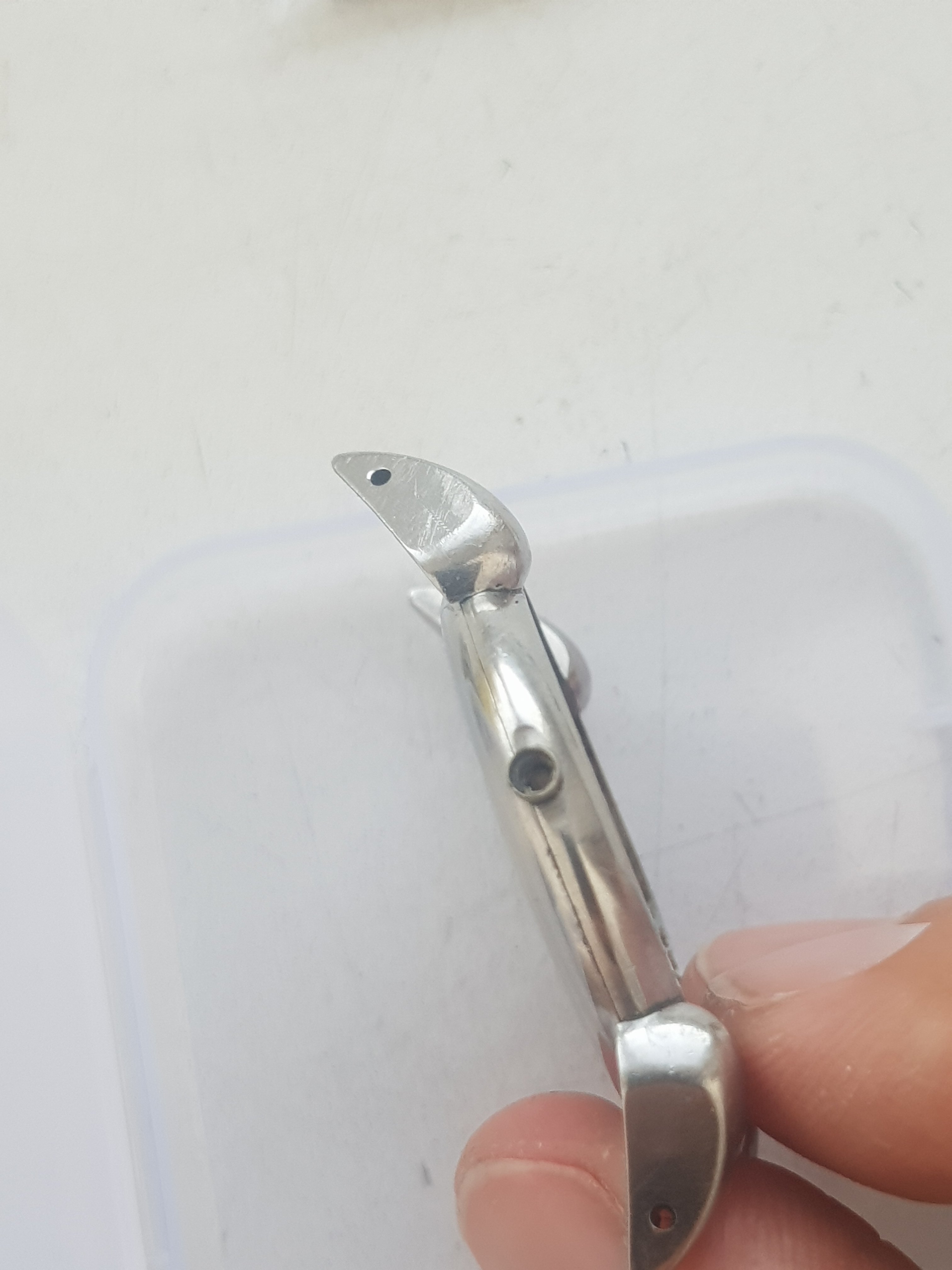

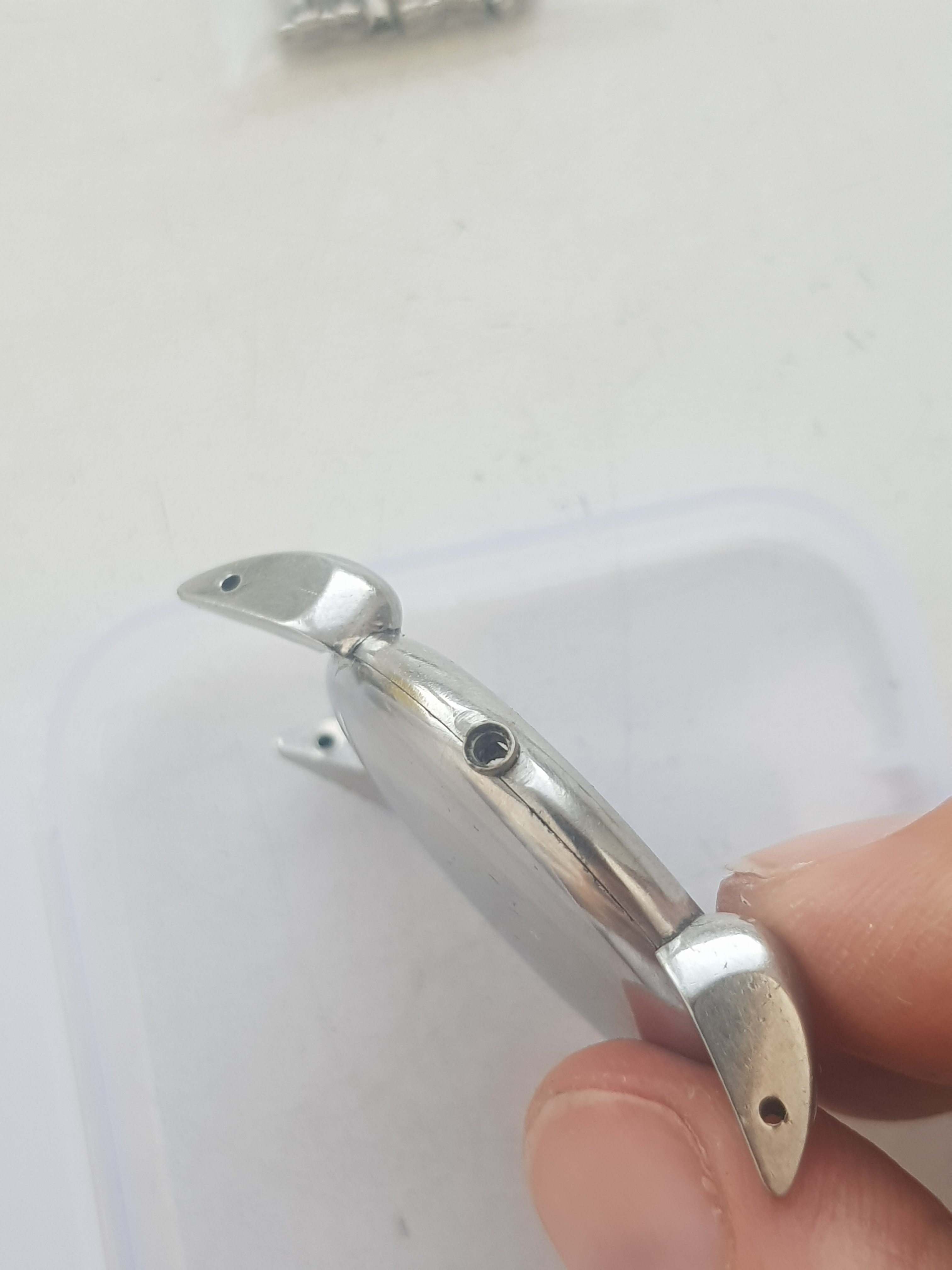

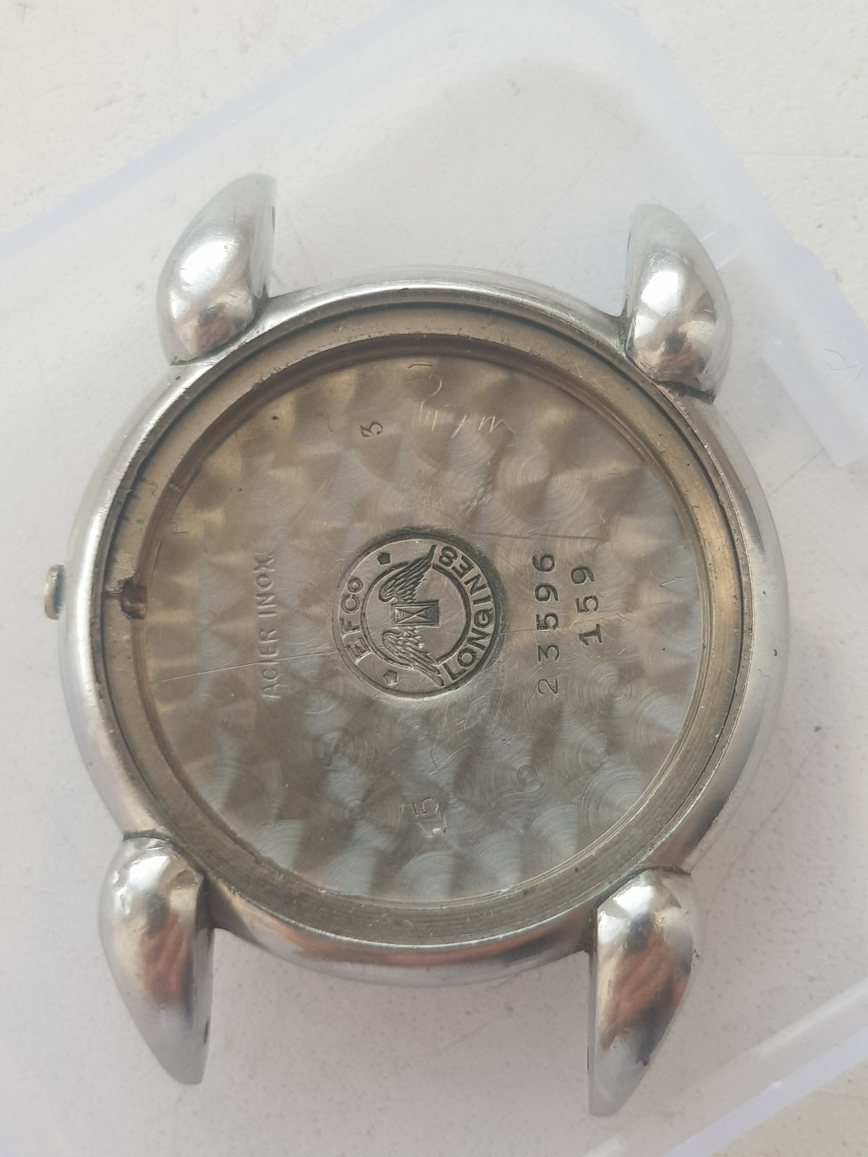

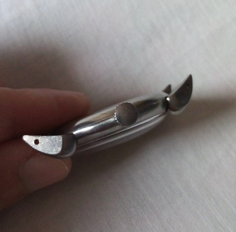

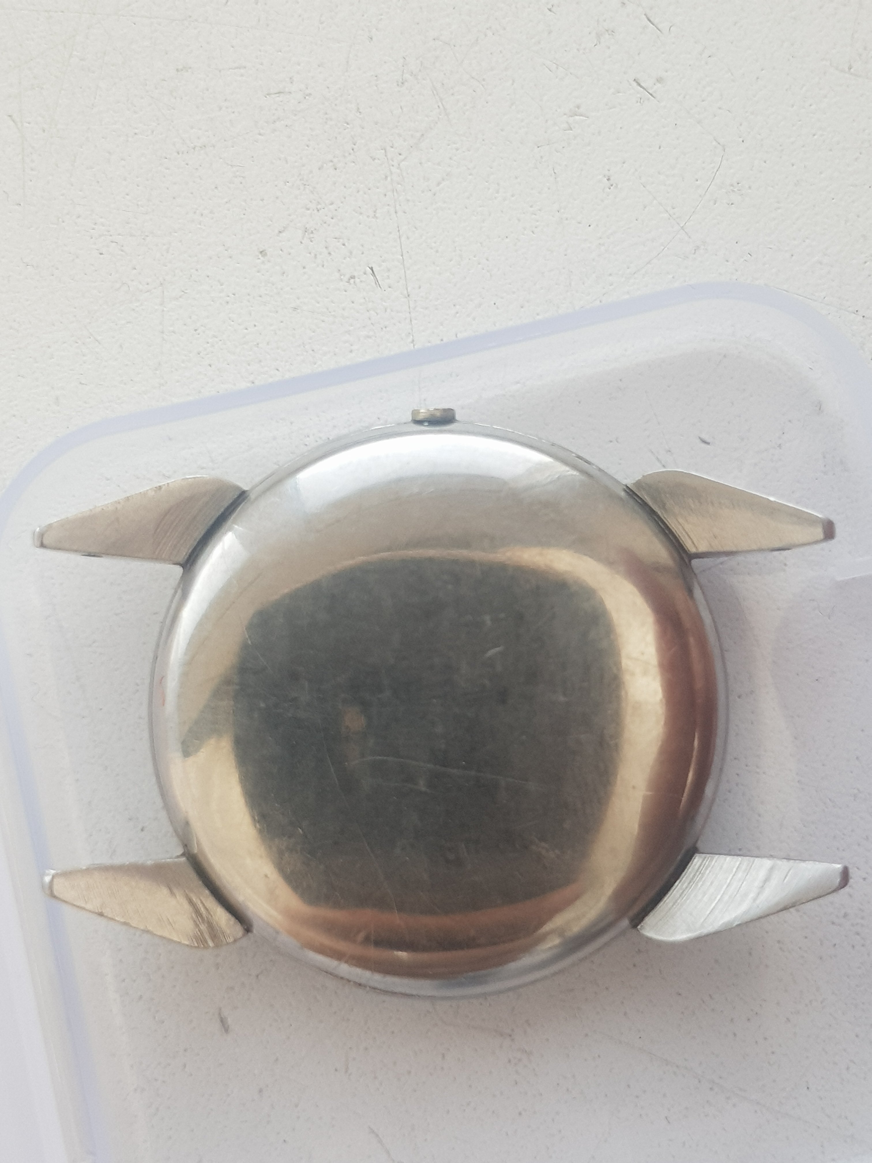

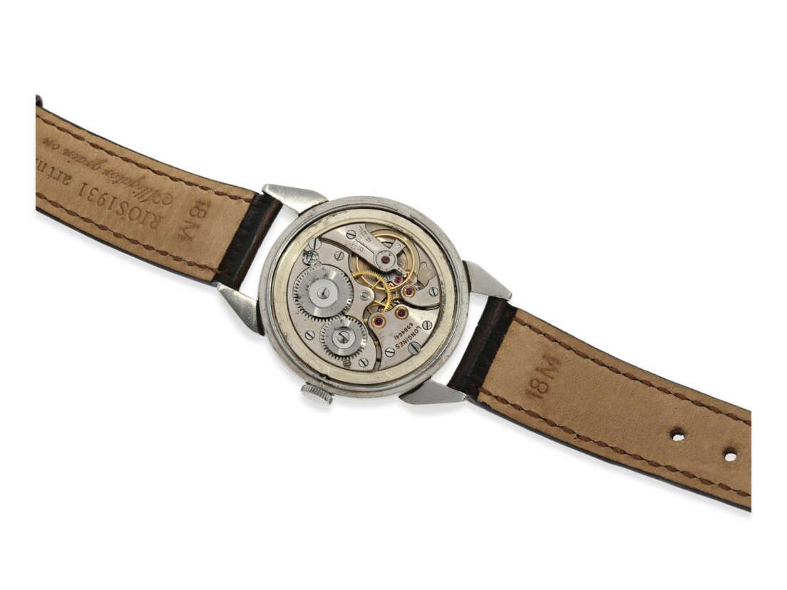

Greetings dear forum participants!
I bought spare parts from Omega, and in addition received this case from Longines. Can anyone share information about what model this is, what movement was used in it?
Thanks!

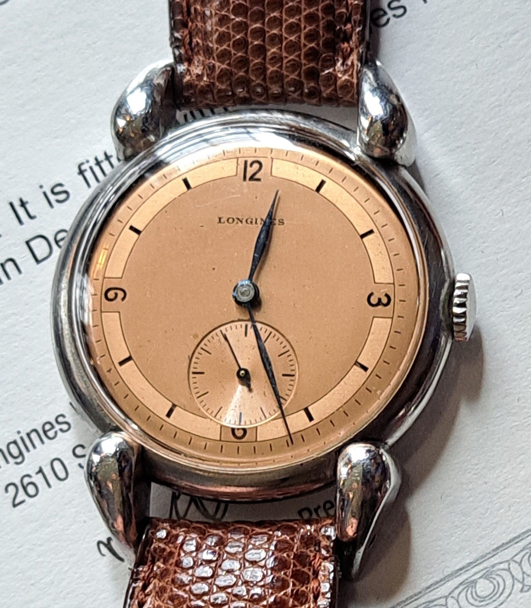

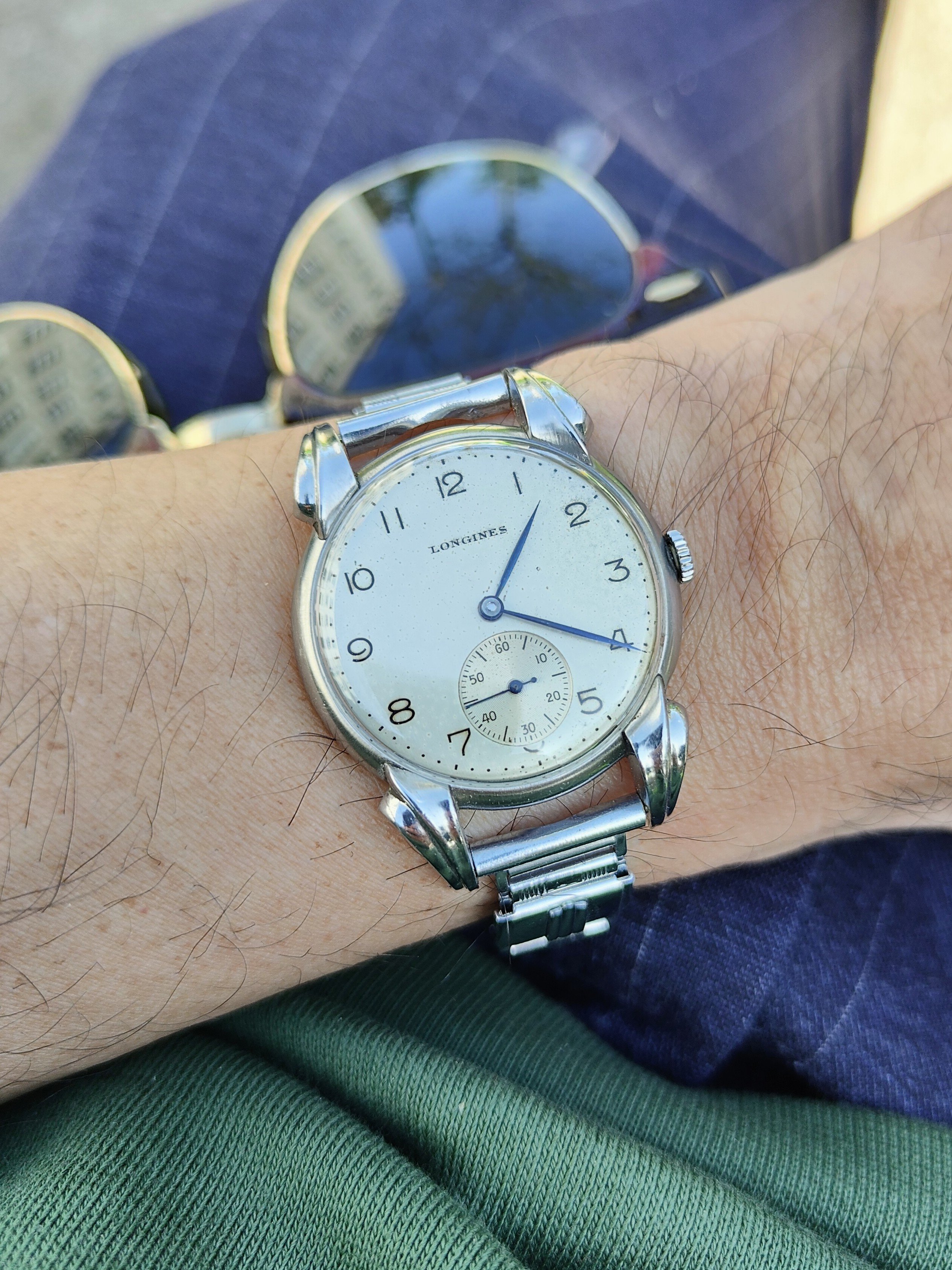

I believe a caliber 12.68z would most probably the one for that case... Similar to mine

Hello, thank you!
I think I know what I want to do with it)
These funsy case lugs inspire you to find a mechanism for it and use it)
(Your watch is beautiful, I love the Art Deco style)

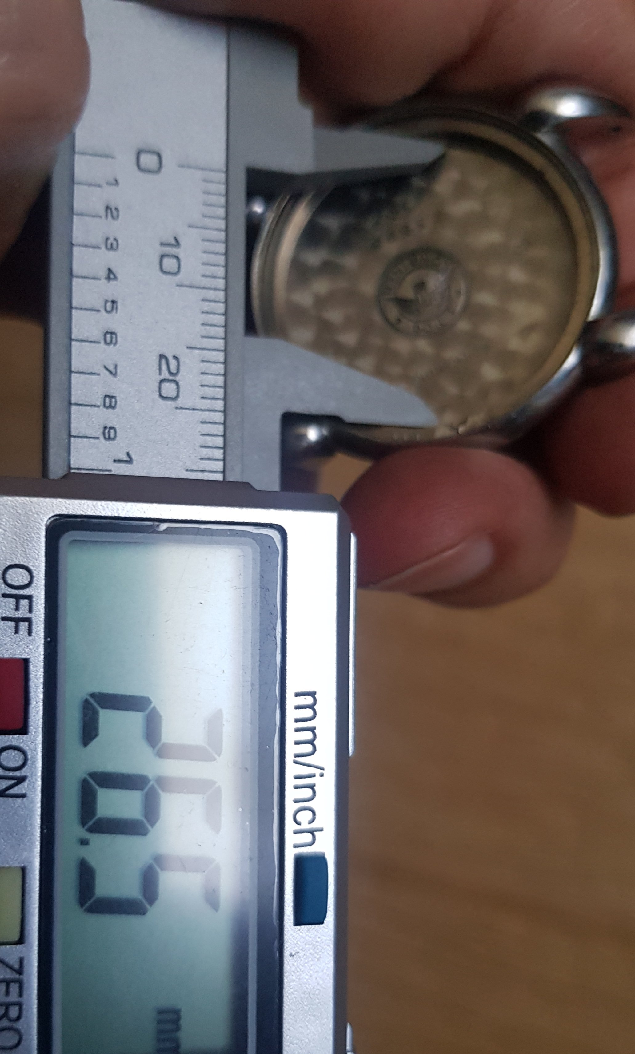

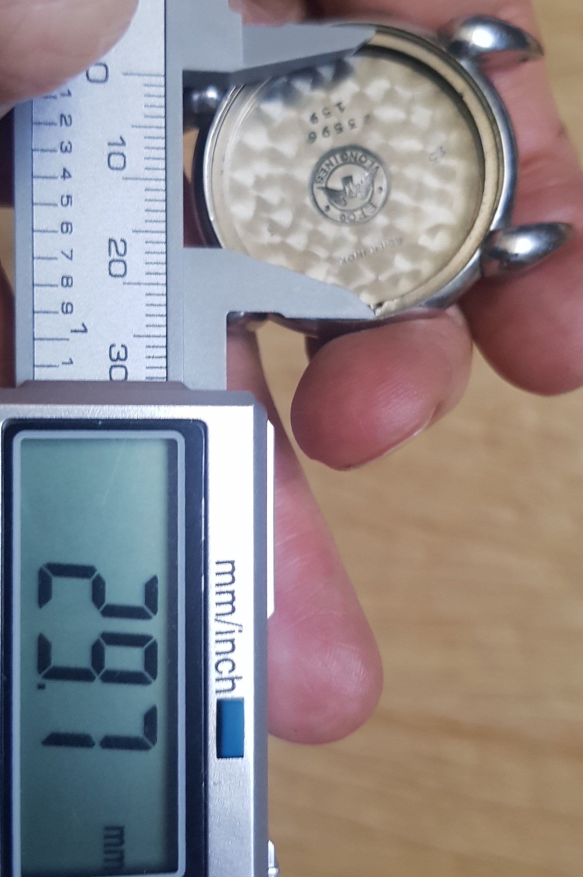

I measured the inside of the case as 26.5mm, but this may not be an accurate measurement. The diameter of the 12.68z caliber, as far as I found, is 27 mm, which, in principle, corresponds.
I found a similar case on ebay, but I couldn’t find exactly the same watch or case.
https://www.ebay.ca/itm/295536901496?itmmeta=01HYJC8ABCNMGVTJ6EFXV4XBCG&hash=item44cf5f3d78:g:6Y4AAOSwTcZj86ZX&itmprp=enc:AQAJAAAA8DawLJCn9YzkFc040BLUVZZ7qkpJBSy2Oto8mpvlu19zPYPAUMyt9SEDNvPnvDhfVQhxN97fKxS7ZdWJjrRj5Hh2Xcm/j6iv6mGAzLikMmFsvRj8pc65NwTq/n/VuPuqHQaooCbhfYnFUsiZ0u9FN9H2wtx8yvVxVMACDAt0bemgQv/+nZxCA1gDDSlz+bP7b8SCjK+pTtw1JguE1JuwqjLNxVg5mzxyr5tlLo2oW0bgQRf14Ps9JjFtx20BQmhzg4hEkE09YqQ84ReGm3pF1rE4HRdX9Hm9mBd/qNXIlOfHDAxPA7mSA+TGvhPPql0LqQ==|tkp:Bk9SR-Slocz0Yw
Does the serial number inside the case under the Longines logo give information about the year of manufacture, or does it not correlate with the date?
Do I understand correctly that this design is from the late 30s, early 40s?

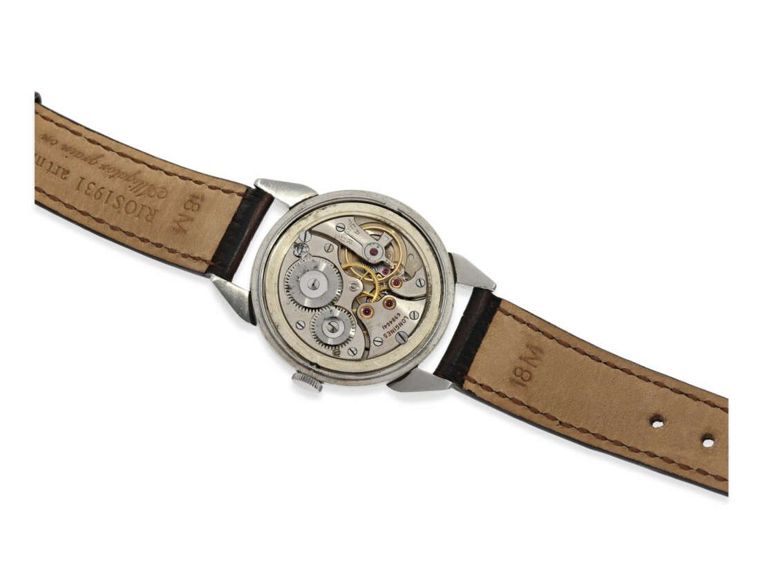

I would expect this case to be from the second half of the 1940`s based on the order number. Can be a nice little project and the movement is possibly 12.68z as already mentioned.

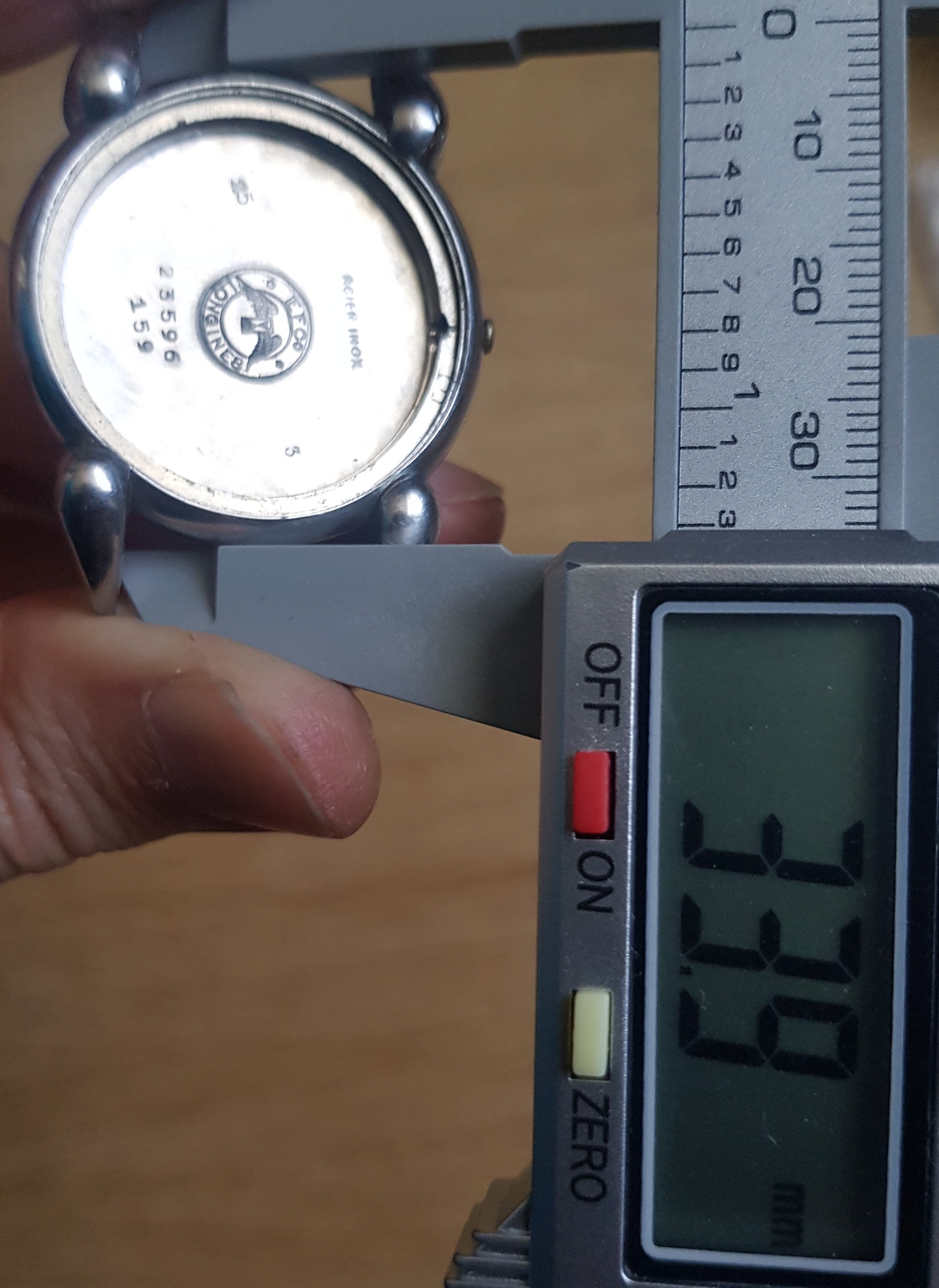

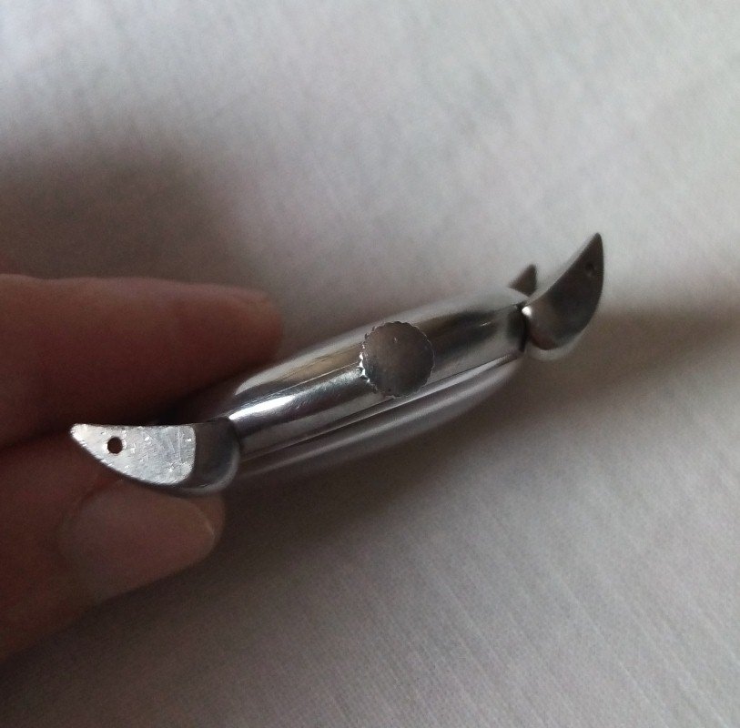

Judging by the size, 33.8 mm, was it a men's watch or a women's? They are small, but then watches were made smaller...
4,046
45,750
Thanks!
They were gentlemen's watch, as it was a standard size for that period.

What size is your watch? Can you please take a photo of the crown, is it with a logo or just flat?

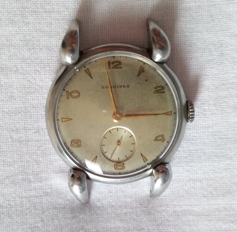

70
254

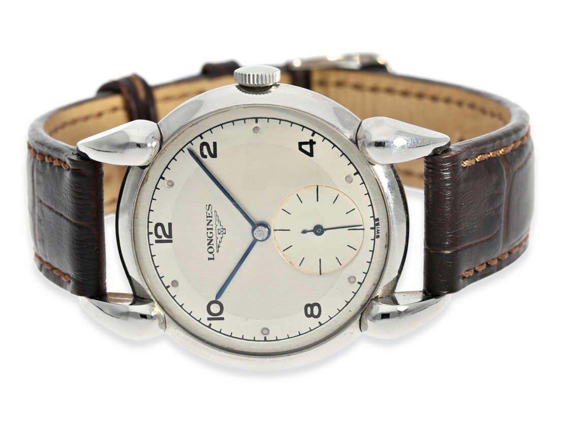

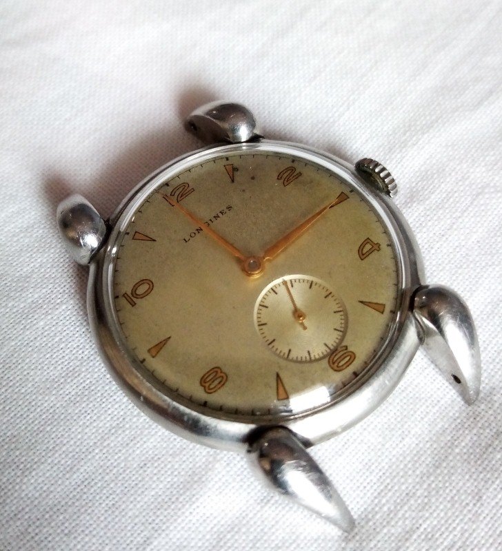

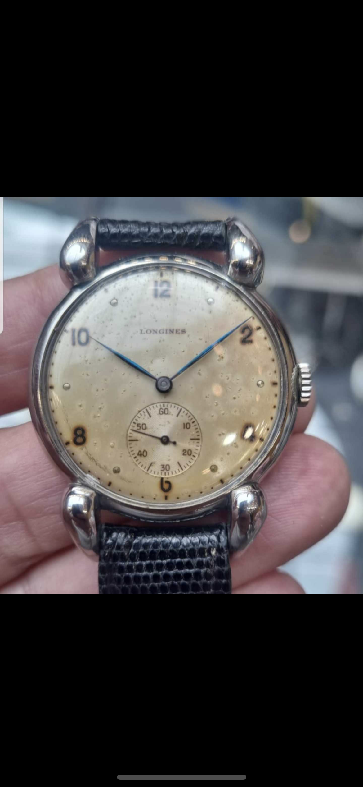

Someone locally was offered me this for sale today (extremely ambitious price ).
Similar dial configuration as one of the above, but slightly different
