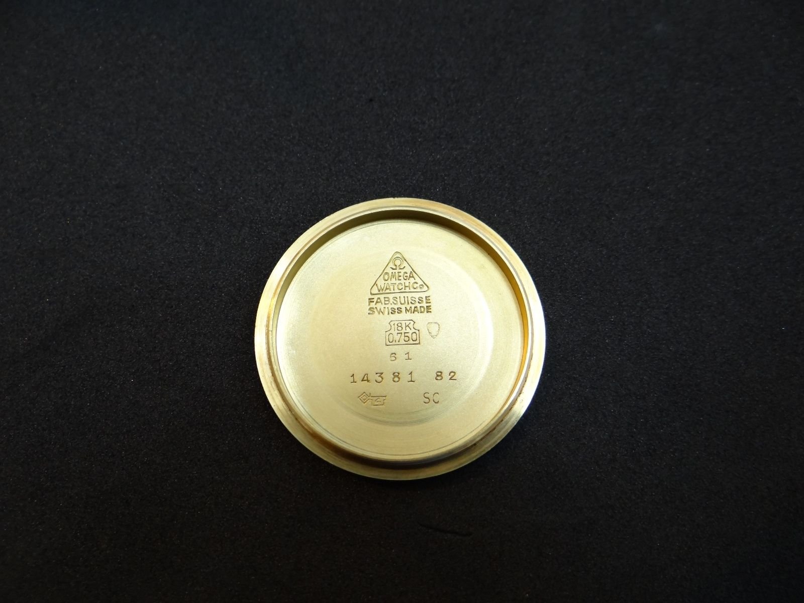

To clarify
If the watch was Swiss and non-precious, it would have 14393 as a reference inside the case back.
If solid gold it would have 14393 94 or sometimes it might have 14393/94. (Although the latter version is usually on later references)
The last ‘4’ would denote a deluxe version with gold dial.
A gold cased watch without a gold dial would still ‘only’ be a 14393.
My (no date) watch above has 14381 82 in the case back and is a 14382 because it is a deluxe with a gold dial.
As the OP watch is likely English cased, I don’t think they had a dual reference in the case back for deluxe watches.
