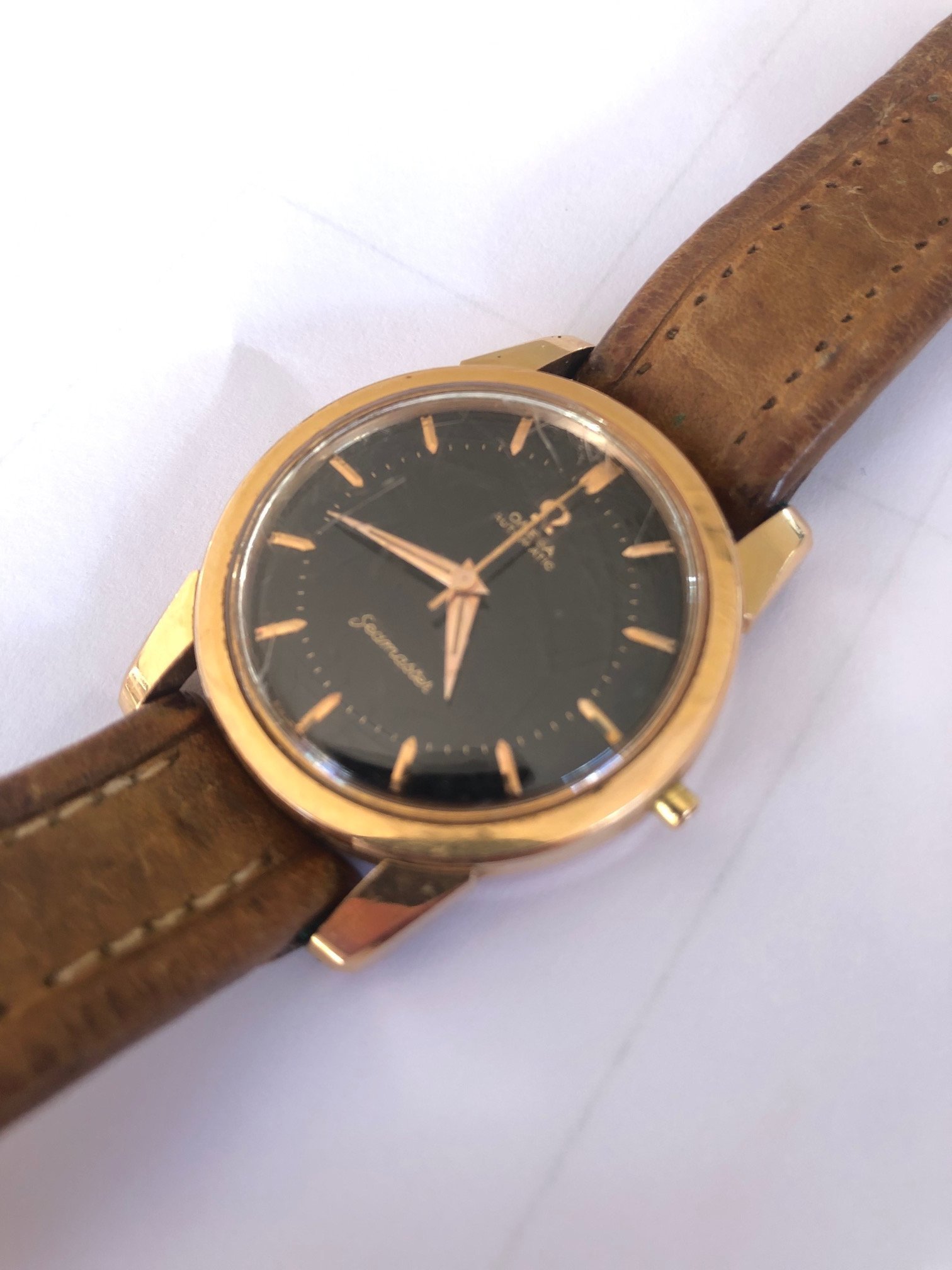

I recently asked my Grandma if I could have my late Grandfather's old watch as a reminder of him. She handed me a piece of paper with "2 OMEGA watches for repair" written on it. Inside were an old seamaster and constellation in what appeared to be fairly rough condition.
I took them to an independent vintage omega repairer to get an idea of how much they'd be to have restored and he seemed to think the seamaster was quite the find so I thought I'd share it with you.
What I know about the watch:
Date of Manufacture: 1955
Black dial which appears to be in good condition
Solid Rose gold case
All parts original and believed to have never been opened previously
Some scratches to the glass and case
Crown stem snapped, but still have the original crown
Appears to be working and no obvious signs of internal damage (According to repairer)
I'd like to get the watch restored so I can wear and potentially pass to my children if they're interested (They're still very young), so it is absolutely not for sale.

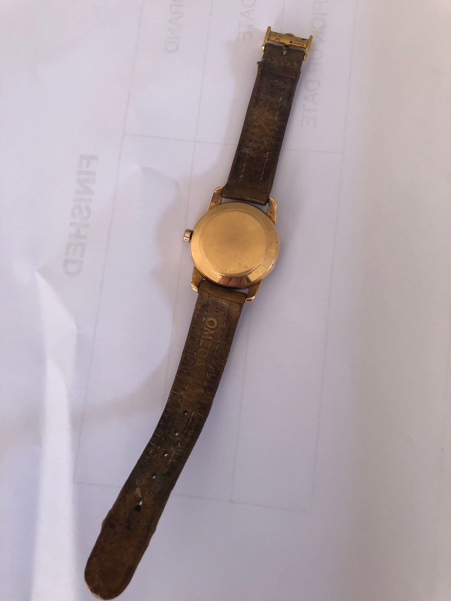

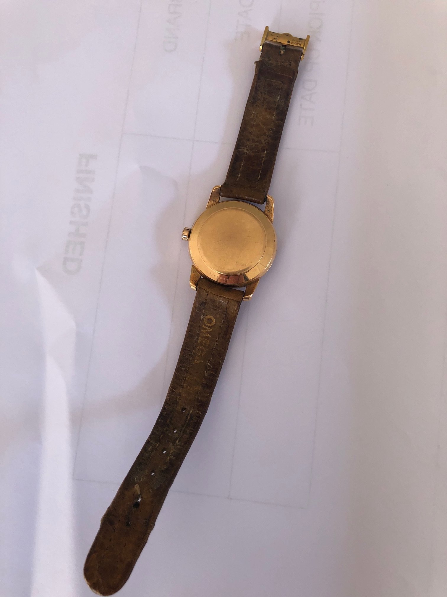

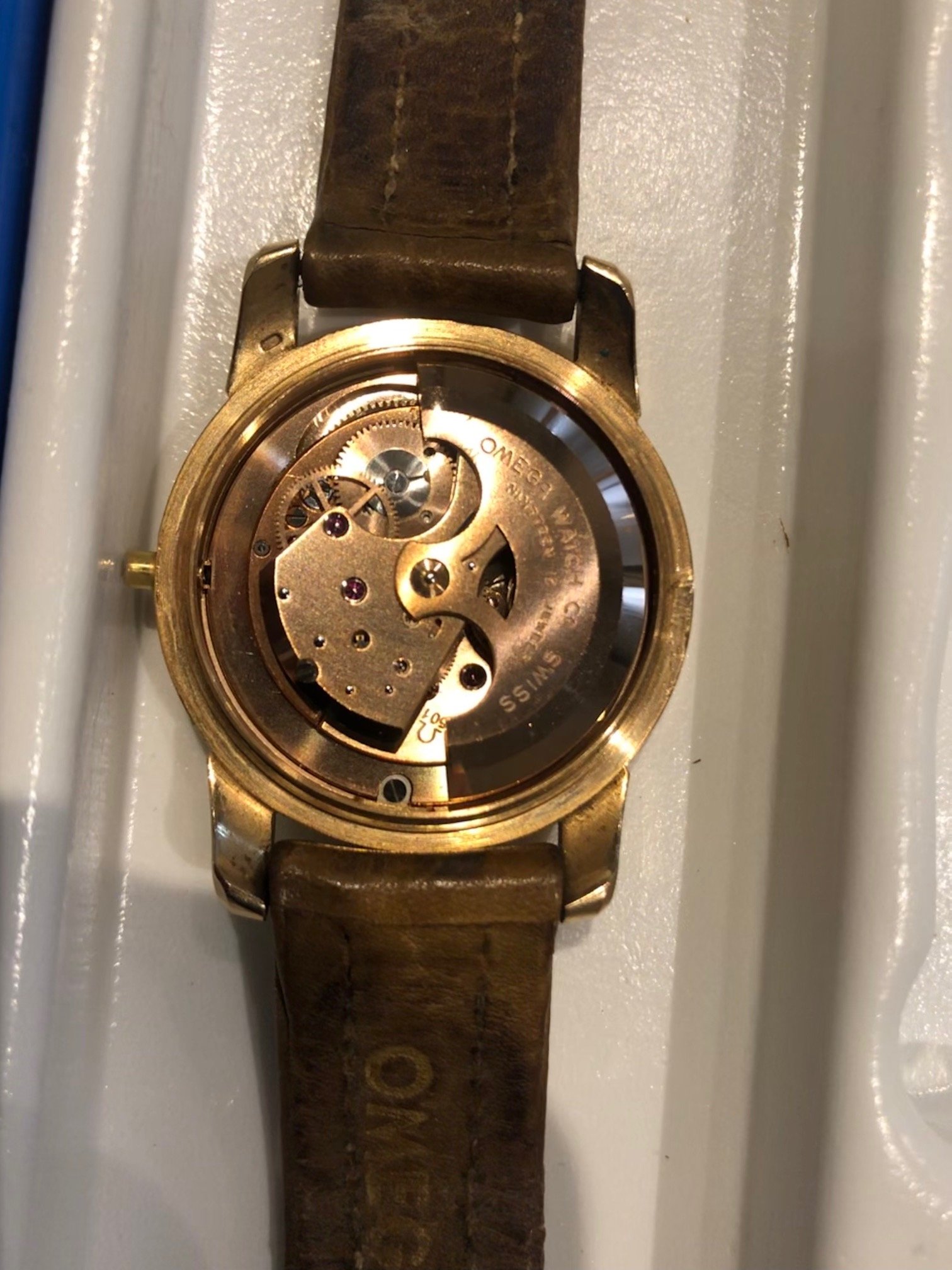

I've attached some photos, but currently only have my old iPhone camera on hand and also managed to obscure the movement number with the rotor - doh. Happy to try taking more pics, but will not be taking the case back off myself.

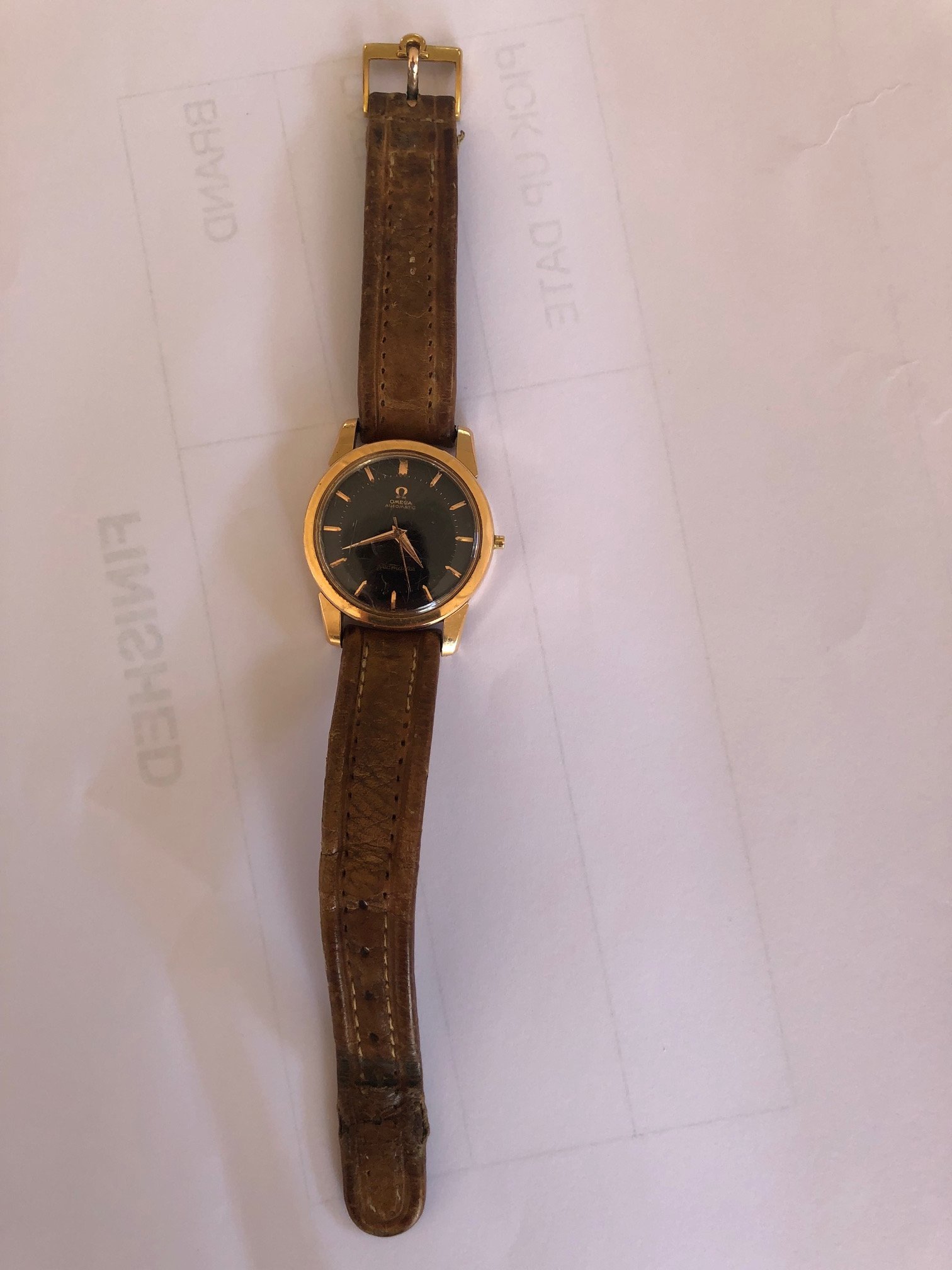

Really nice watch, with orig bracelet and buckle. I would be very careful when servicing it. Pics are not great but from what I see;
Perform a movement service and replace the crown stem. Remove and replace the bracelet but try to clean it, give it some nutrition and save it.
The case looks sharp (bevels are clearly visible), make sure not to polish even the least.
If you need to change crystal, save the old one. Hopefully the current crystal can be given a slight polish if having marks and need no replacement. When doing so, mask the case metal to avoid polish hitting the metal. Gasket should be changed.
I would use this it as a Sunday dinner watch, not what it was built for back then but rather keeping it in great condition than servicing it with new crown, crystal etc in an attempt of making it water tight and using it as a daily wearer. Only my opinion.
Value is always difficult, but I would personally buy such watch for 1.5k (or even a bit more if it is nice in the flesh) if the dial is clean, whatever that is worth 馃榾

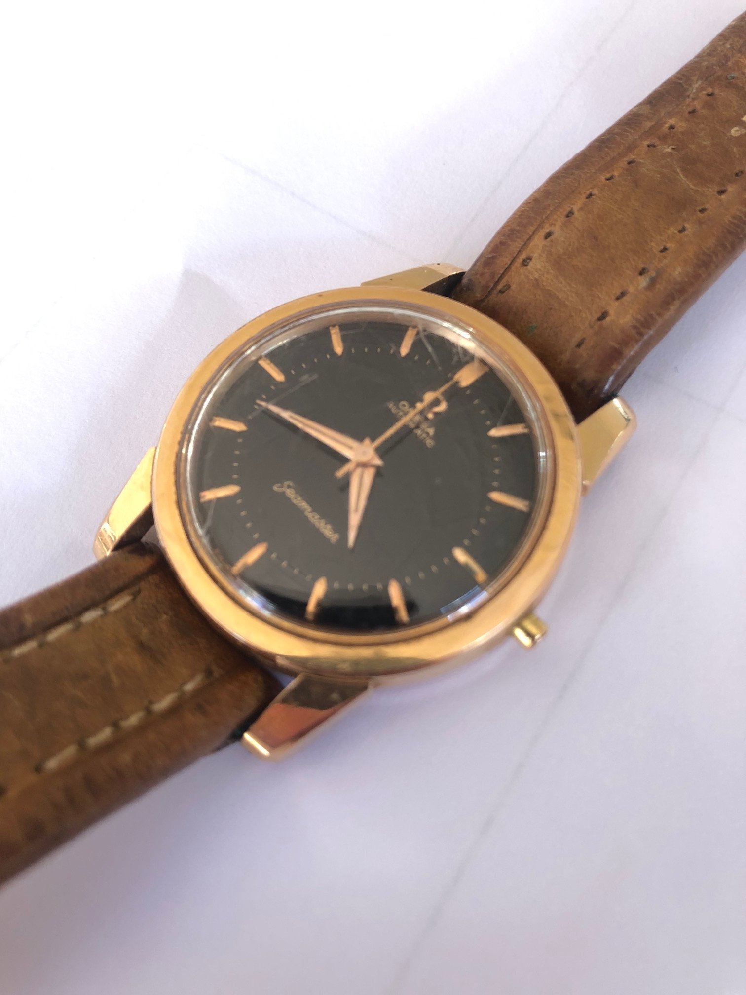

Can't really tell from the photo, but that might be what we call a waffle or honeycomb dial. If so, that's a very nice bonus, especially a black one in good condition.

Black dials were less common, so they are desirable to collectors. I usually polish the crystal instead of replacing it, unless it is cracked or badly crazed. A service might cost in the $300-$500 USD range, depending on what is needed and who does the work. Value is hard to say without seeing better photos, but assuming everything is legit and correct and in good condition, it's well worth having the watch repaired/serviced if you plan to wear it regularly. TBH, a solid gold watch like this is not generally used for daily wear, but it would be lovely for special occasions.

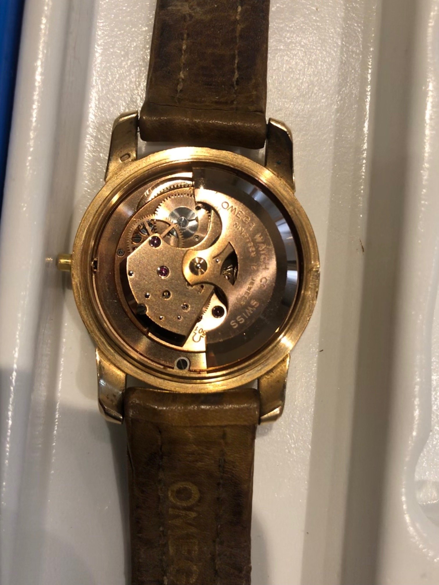

Unfortunately, we will need better photos to say much more about the watch. We can take some guesses, but it's better if you could put a little more effort into the photos. There are some real experts on the forum, so your effort will be rewarded. See if you can take some clear in-focus photos in good lighting from various angles. Your cell phone will be fine, it just takes some trial and error, and a little practice. It is necessary to see the reference number inside the caseback, the serial number on the movement, and even the caliber number on the movement is hard to read. It seems to say 601, but obviously that can't be right. If you think the buckle might be authentic, please post good photos of that as well, from both sides, showing any engraving clearly.

Looks like 501 if zooming a bit which would be correct for a 2846 ref tbc by inside back pic
Would be great to see if there is some texture to the dial
Very plausible.
Thank you all for your excellent responses. I'll get the big camera out and try to take some clearer shots this weekend, although I'm not really comfortable taking the caseback off myself. I can confirm that the dial is smooth and un-textured. I'll also put up some pics of the constellation, it too is in gold, so perhaps I should look to buy a daily stainless one to wear as a surrogate...
