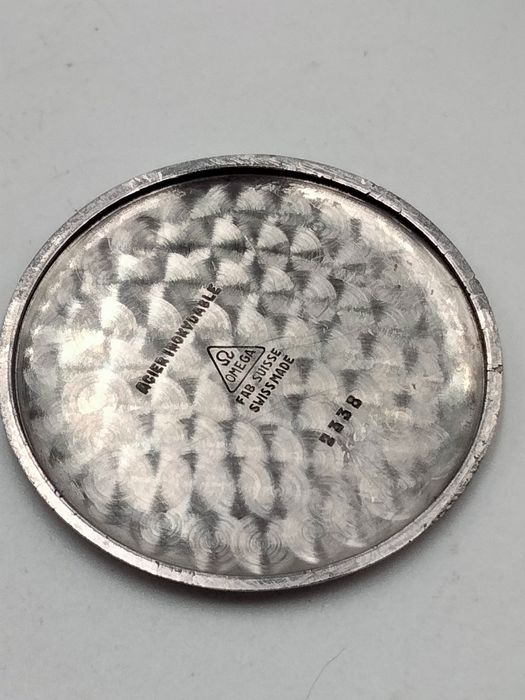

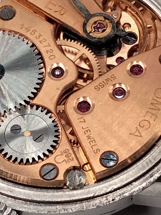

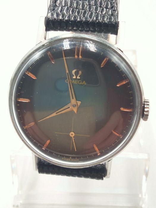

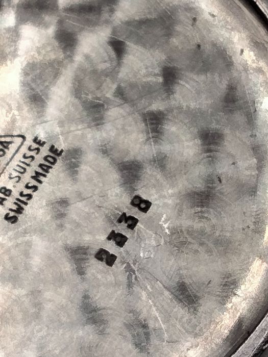

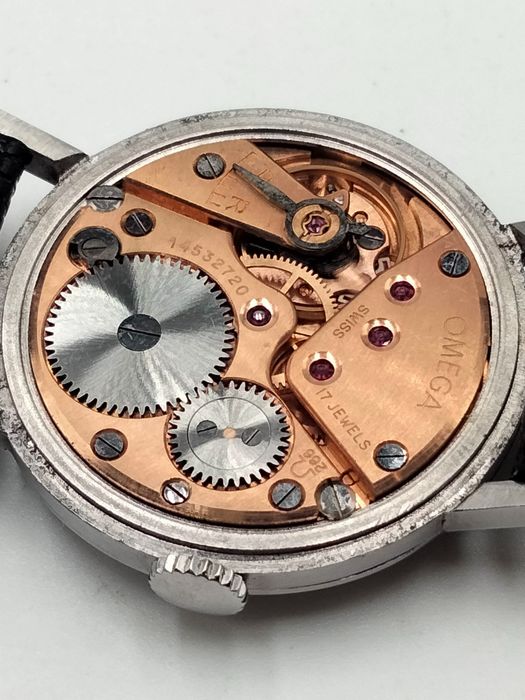

T Posts 1 Likes 1 TooTaa ·Jan 6, 2023 Long story short, I got this as a gift and I just wanna be sure it's a real one. If not, I'm okay with that, not a big watch guy anyway. I'm aware the crown doesn't have an Omega logo which is a red flag I assume. Thanks in advance. Edit: The cases back is plain.
Posts 8,881 Likes 62,897 TexOmega ·Jan 6, 2023 Welcome What has your research shown with ALL the information on the watch one needs to Google?
Posts 3,653 Likes 7,770 mac_omega ·Jan 7, 2023 👍 and don´t bother about the crown, its perfectly fine for this era
Posts 13,676 Likes 19,045 gatorcpa ·Jan 7, 2023·ΩF InvestiGator The parts are genuine Omega, but the movement has likely been replaced with one about 10 years never than the case. The dial has been refinished also. Here is a Ref. 2338 example from the forum: https://omegaforums.net/threads/1943-fab-suisse-omega-ck-2338-30t2-with-two-tone-radial-dial.125249/ Hope this helps, gatorcpa
