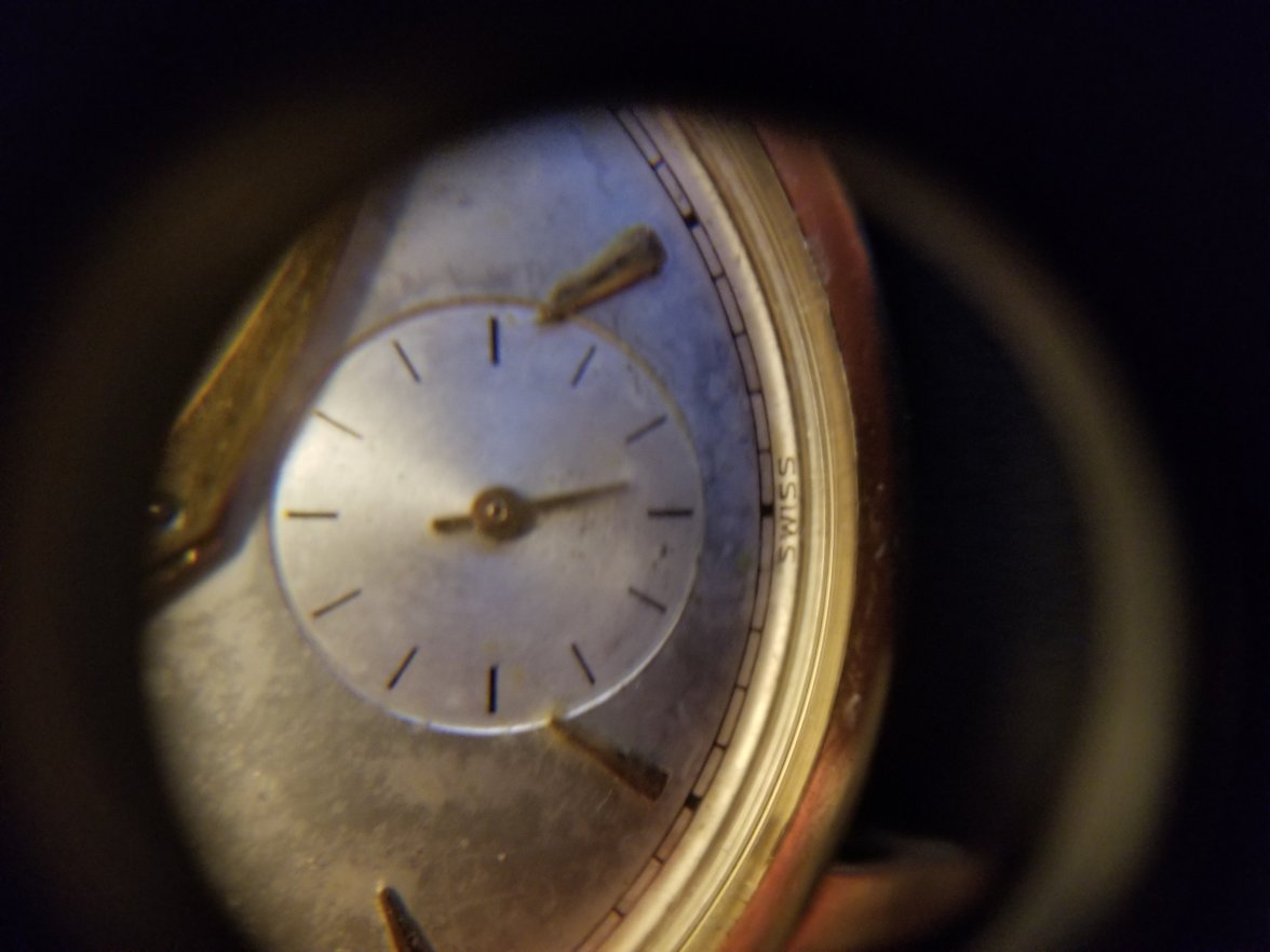

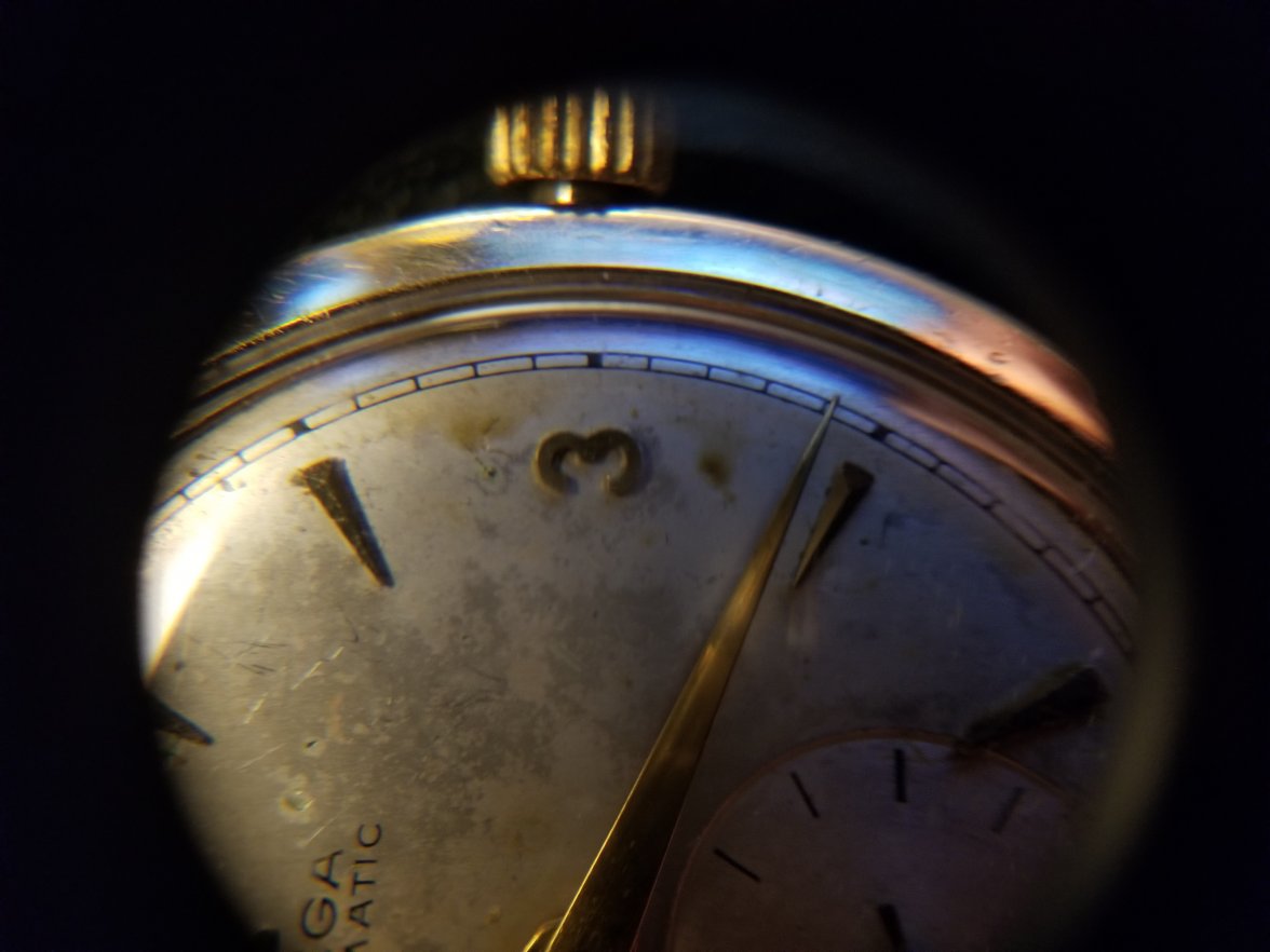

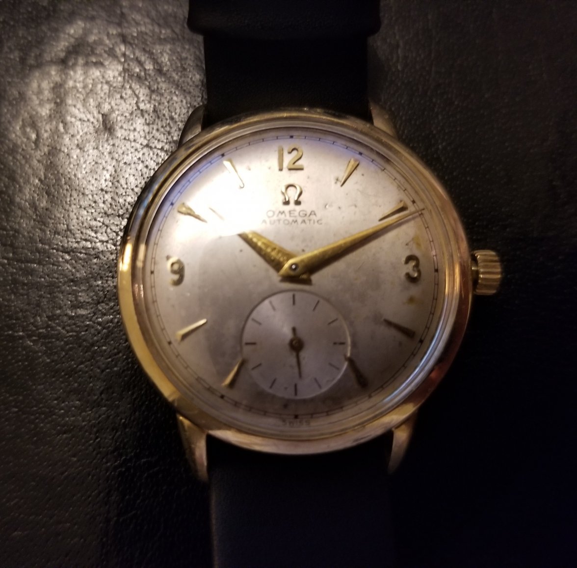

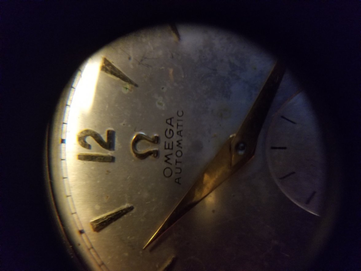

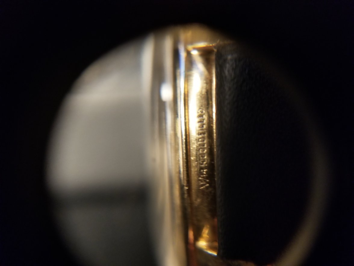

Greetings - watch novice here seeking wisdom regarding an Omega watch in my collection. Last year, I got the vintage watch bug which I admittedly know very little about. Rather than buy an expensive pie pan Constellation chronometer before I was sure if I would like the old school 34 mm size and relative lack of water resistance in vintage watches, I decided to test the waters with a modestly priced 342 bumper with a 3-9-12 dial with the seconds sub-dial at the 6 o'clock. For what appears to be a 70+/- year old watch in fair condition, it keeps time and has old school charm. I don't know what model the watch is, or if it is even a frankenwatch? Could anyone point me in the right direction to ascertaining the model number or any thoughts in general? What I can glean: the bumper works beautifully, it is marked as 14k gold filled on the case at 6 o'clock and the dial appears to have some sort of residue or sun damage perhaps. Also, the seconds hand possibly looks unoriginal as it appears too long, and the hour markers at 5 and 7 o'clock seem to impede upon the sub-dial. Thank you.

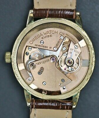

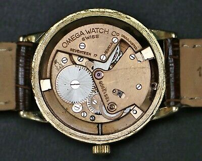

Unfortunately not. The movement pictures are the ones the previous owner provided me, I never opened it - I don't have the tools.

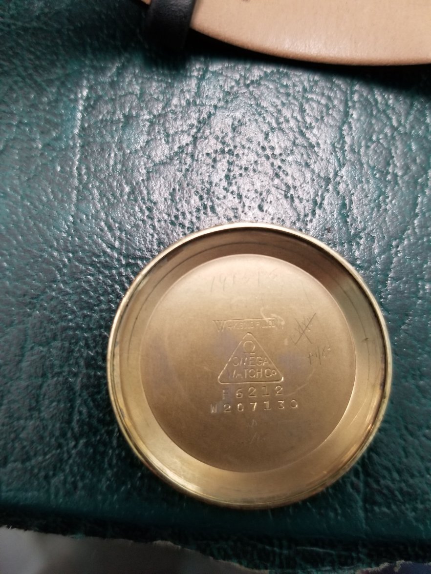

Others will chime in but it is from the early 50s. The caseback will hold the information you need.

This is clearly a US market watch. The hallmark on the outside of the case and the word “Unadjusted” on the rotor give it away.
It was common practice for Swiss watch companies to ship unadjusted movements to the US and purchase US made watch cases to correct specifications here to save customs duties.
The model number would be on the inside of the case. Once you have that, Google is your friend.
Omega lists very few of these “US Collection” models on their vintage database.
Hope this helps,

Hands don't seem to be original. About 1 mm too long and small hand not correct

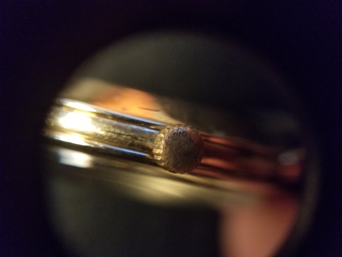

Non Omega crown
Movement not bad
DON
Hope this helps,
gatorcpa
I am going to get a caseback opener kit, take a look, do some research and hopefully have an update to post soon then. Thanks.

Take it to a watchmaker. It will be easier and cheaper. He can then inspect the watch and let you know what needs to be done.
gatorcpa
792
845
Also to echo what @gatorcpa said, this looks like it has a friction fit caseback and they aren't always easy to get back on without a case press. Save yourself the headache.
