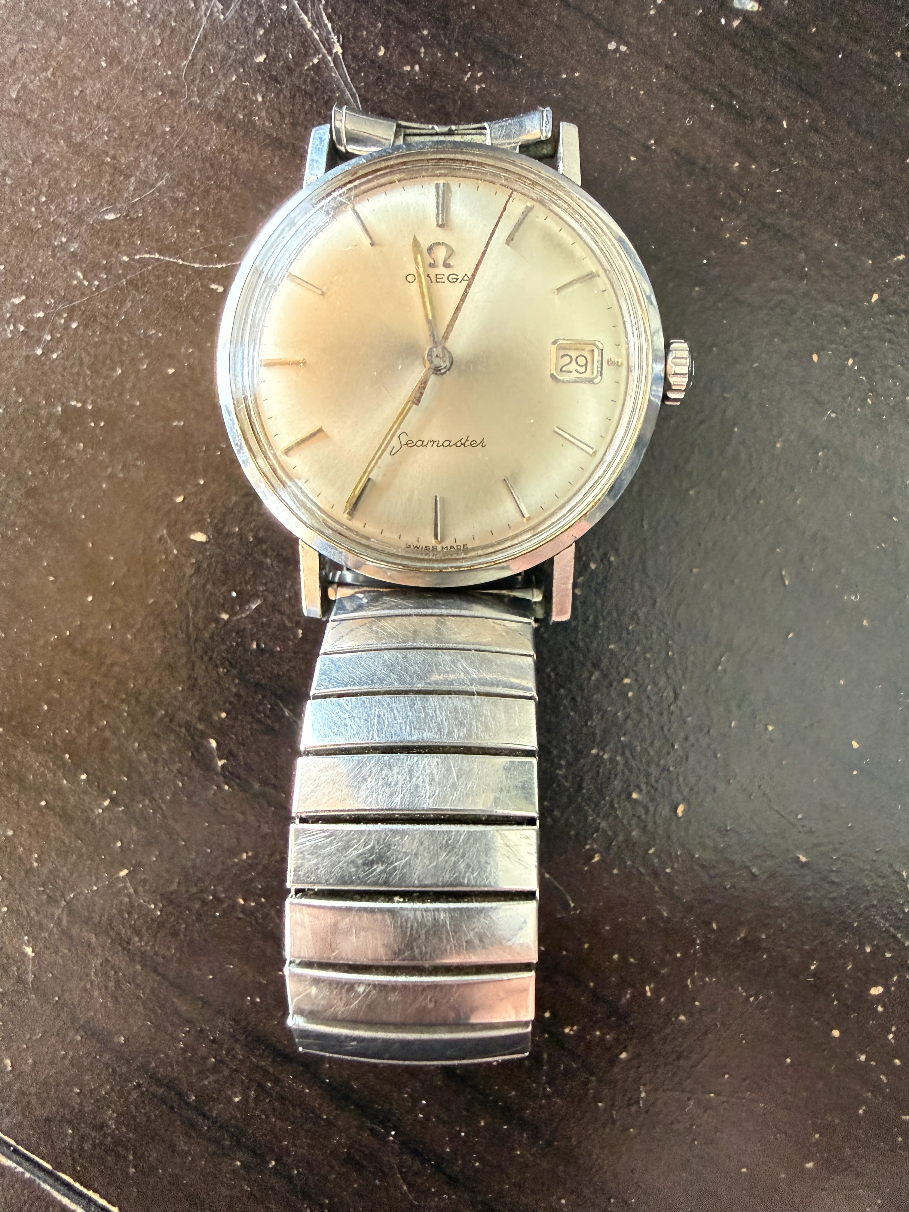

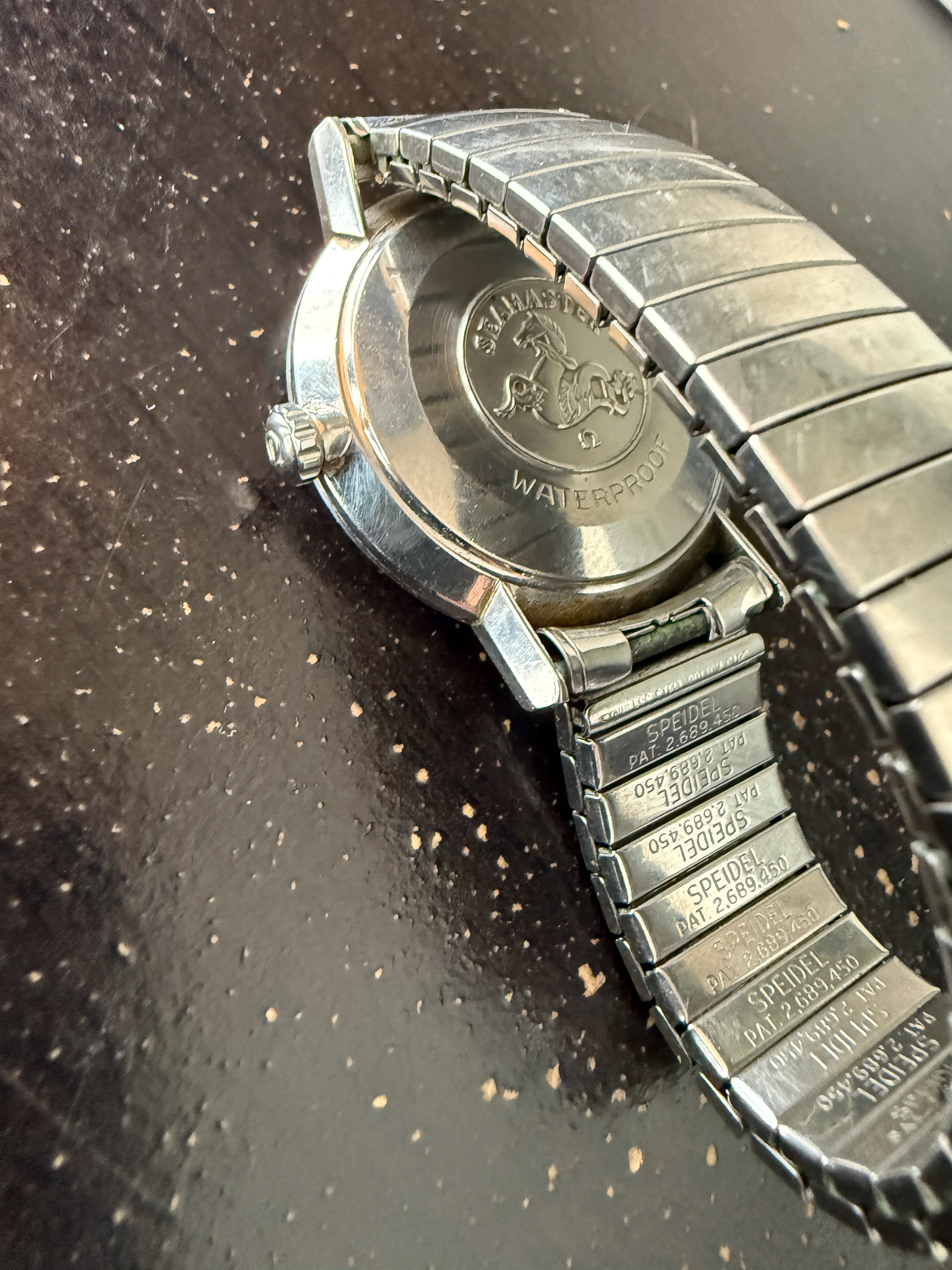

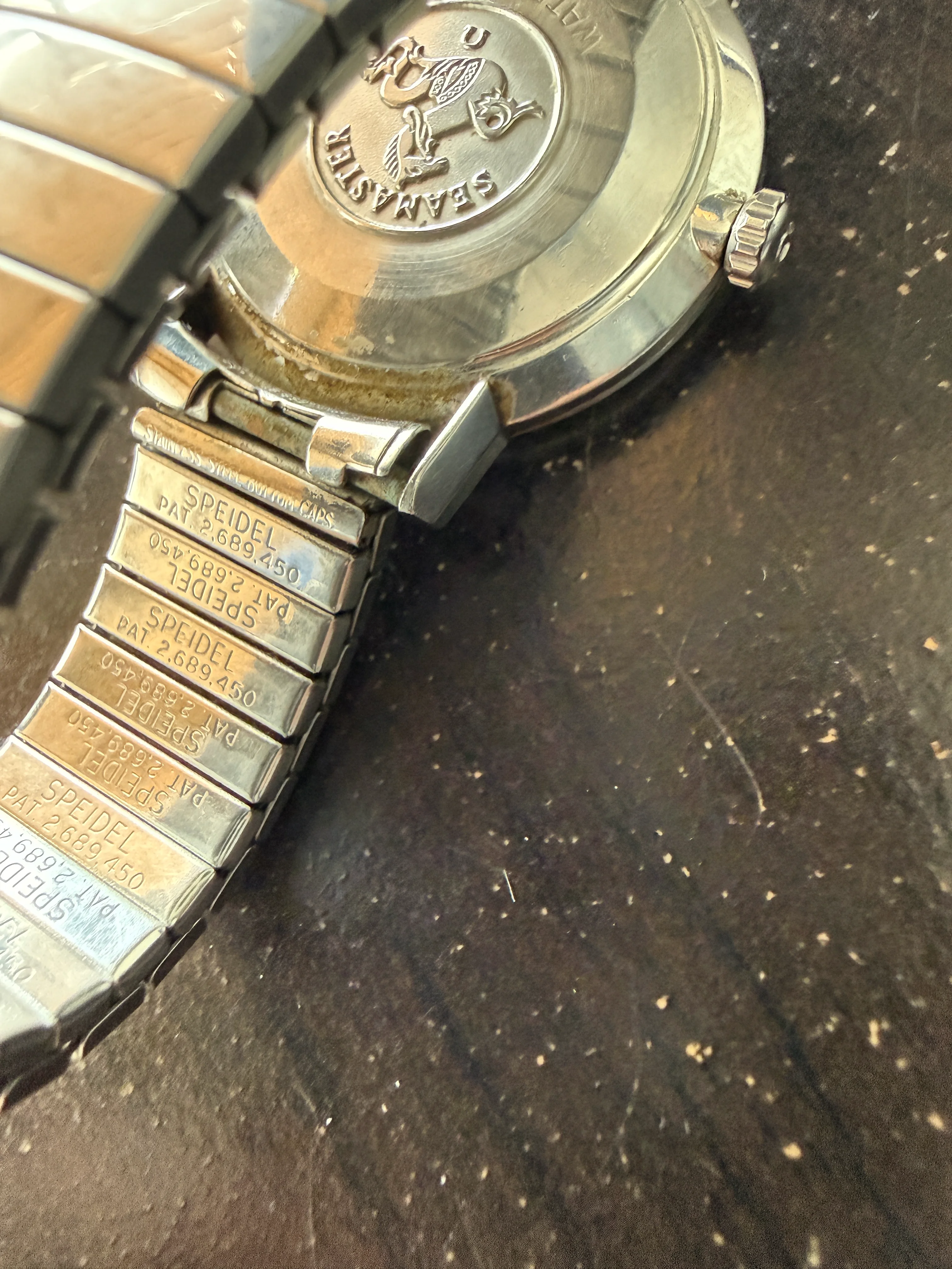

Hi - I've got this old Omega Seamaster that my grandfather wore. It's been in storage for years, (maybe decades) and I'd like to start to wear it, so I need a bit of a crash course in what the heck I need to do.
I did wind the watch. The dial appears to only pull once and that moves the clock hands and changes the date. I turned it only clockwise (away from me) I noticed that the date changes when the time reaches about 1:15. While it seemed to keep good time initially, after about a day the watch did seem to lose some time.
Can anyone help me identify the possible year of production of this model?
Does it need to be wound daily? How much?
Is there any service or anything I should do, to be sure it keeps good time? If it needs service, anyone have any background as far as what that goes for.
I'd like to get a new band, this elastic bracelet bothers my arm.
Any other tips? Ideas? I don't really know what other questions I should be asking in order to get this thing in good working condition again.
Thanks

Get the wrist scum off the case and clean that up. Replace or polish crystal. Service movement. Replace sweep hand
Mid 60’s
At the AWCI SITE. If you find someone. Check credentials to see if they’re more than a battery changer.
Get an estimate and then ask here. Maybe about $250-$300 for cleaning now. Crystal replacement will add. Polishing original less if just scuffed

I'd say early 60s because no "T" on the dial, but when you have the watch serviced, ask the watchmaker to take photos of the inside including the serial number on the movement and the reference number in the bottom of the case.
A hand winding watch like this is traditionally wound every day. When you wind it, turn the crown clockwise until it won't turn any more. That's how you know it is fully wound.
I agree to replace that bracelet, it will also damage the watch over time. A service is recommended for regular wear. The price depends greatly on where you live, who you choose to do the service, and whether any parts are needed. Maybe you can budget $500 for an independent watchmaker, and if it turns out to be a little less, you can be happy. If you take it to a high-end watch store, they might quote you as much as $750.

Lovely original Seamaster great family heirloom, it will clean up well and with movement service should be very wearable. Case opens from front, find independent watchmaker with Omega parts account for service- Try to preserve hands and tell watchmaker no polishing to preserve vintage character. There look great on leather or Beads of Rice bracelet.
