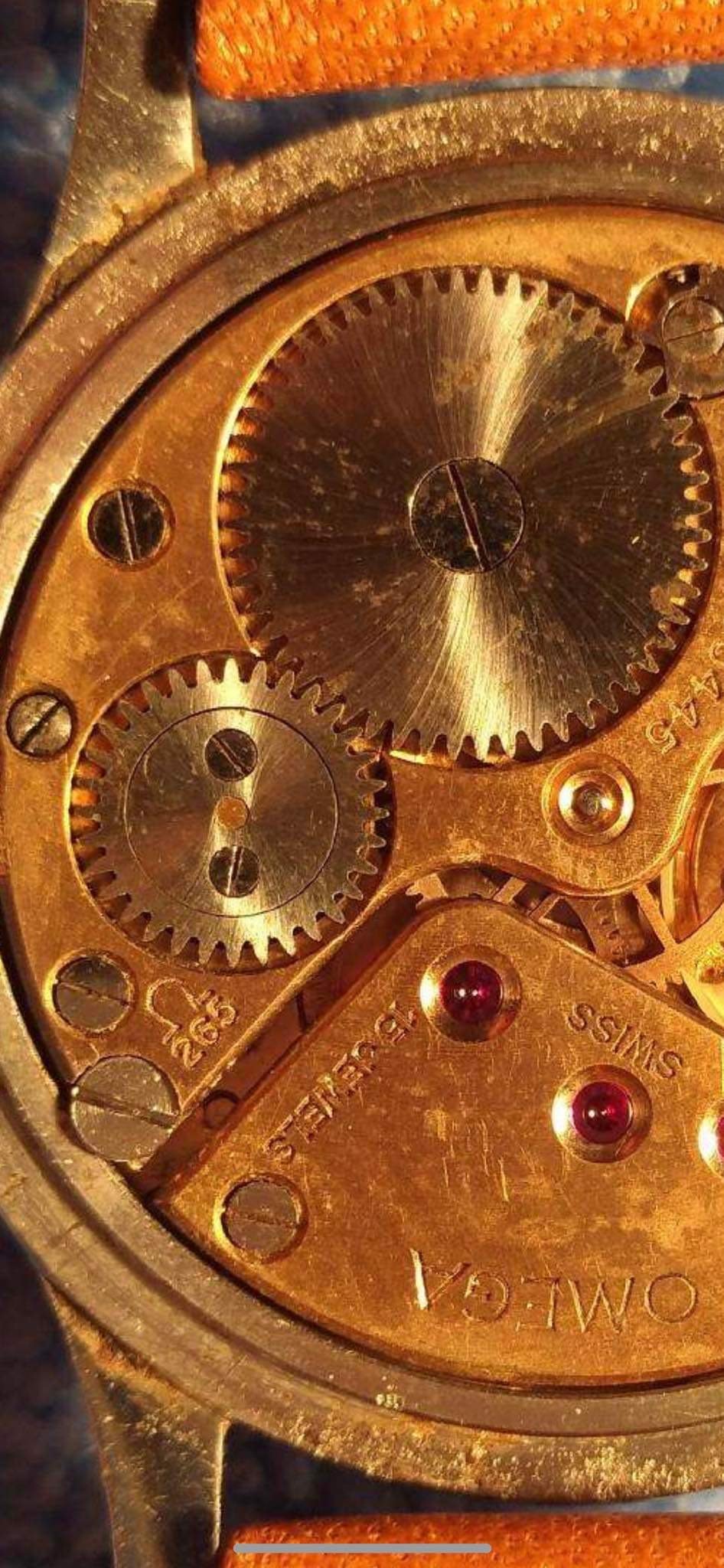

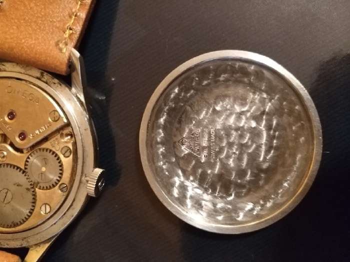

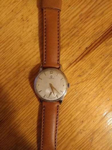

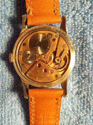

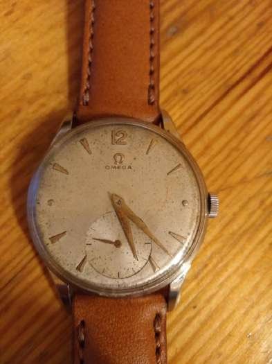

I am looking to buy this Omega watch for 220 Eur, could you tell me if it is worth that money? Seller said that it is in working condition.

Touched. Crown has been changed, was probably unsigned. Both dial and movement show signs of humidity and oxidation.

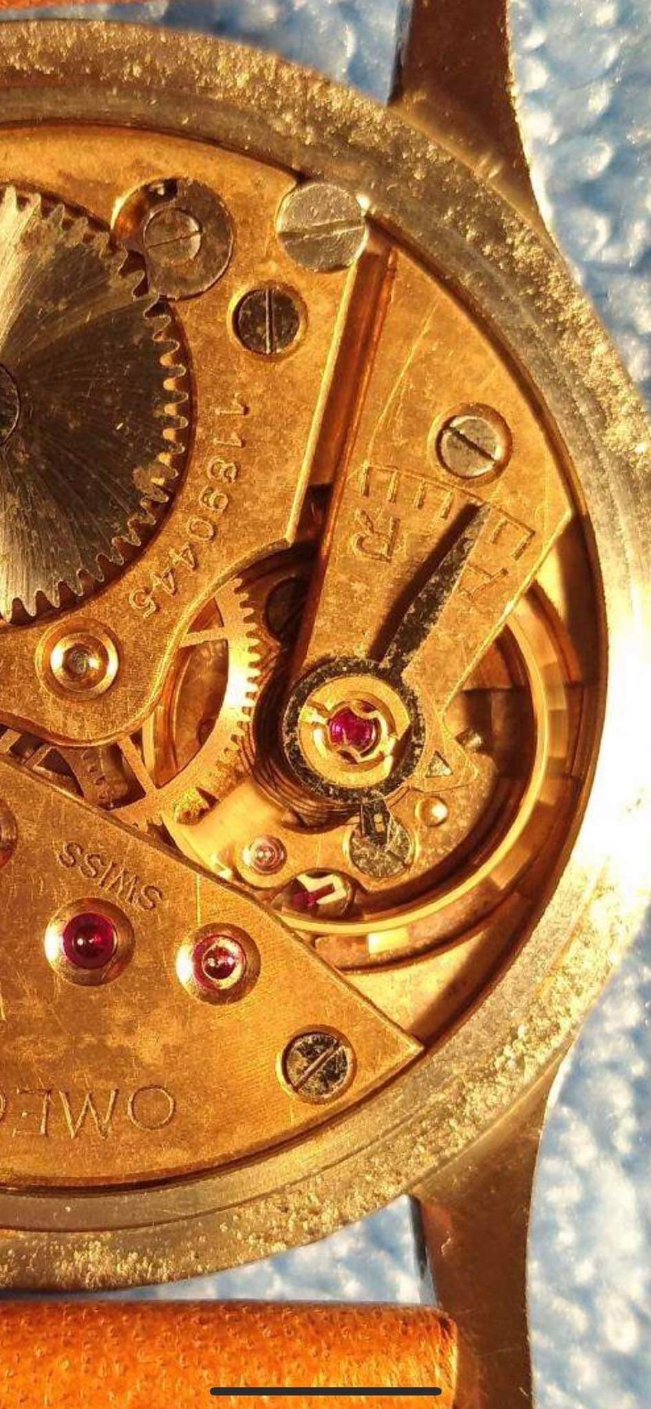

Date is likely to be in the 1950s, the inscription 26x was first used in 1949. What’s the movement serial number?

Thank you for the information, serial number is 11890445
