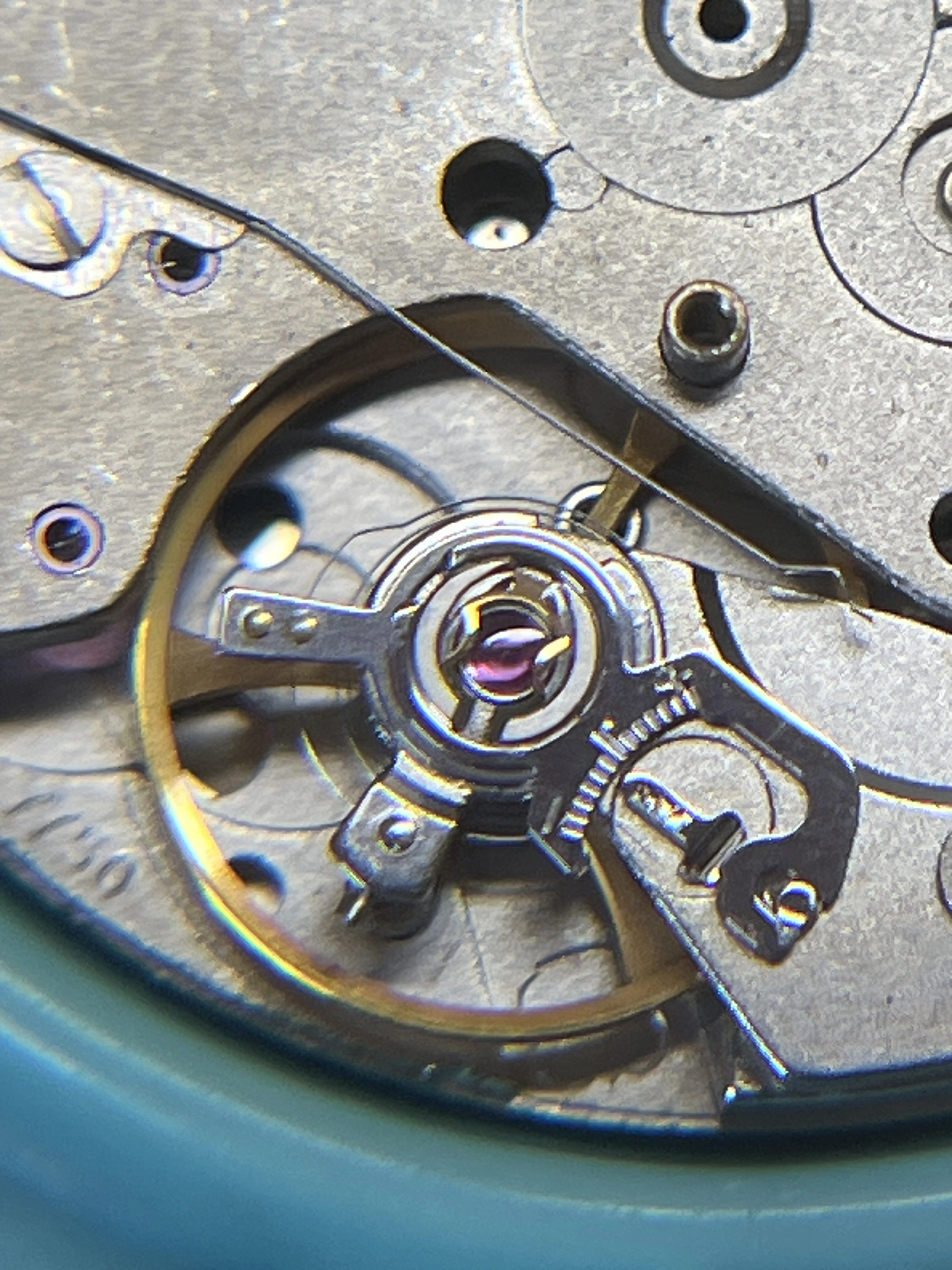

I’m servicing a Valjoux (not eta) 7750 in a Breitling Chronomat 81.950 (known as the plane Jane due to no branding) and have a few questions I cannot find definitive answers to on the internet orFacebook groups, so hope it’s ok to lump them all together here as one post.

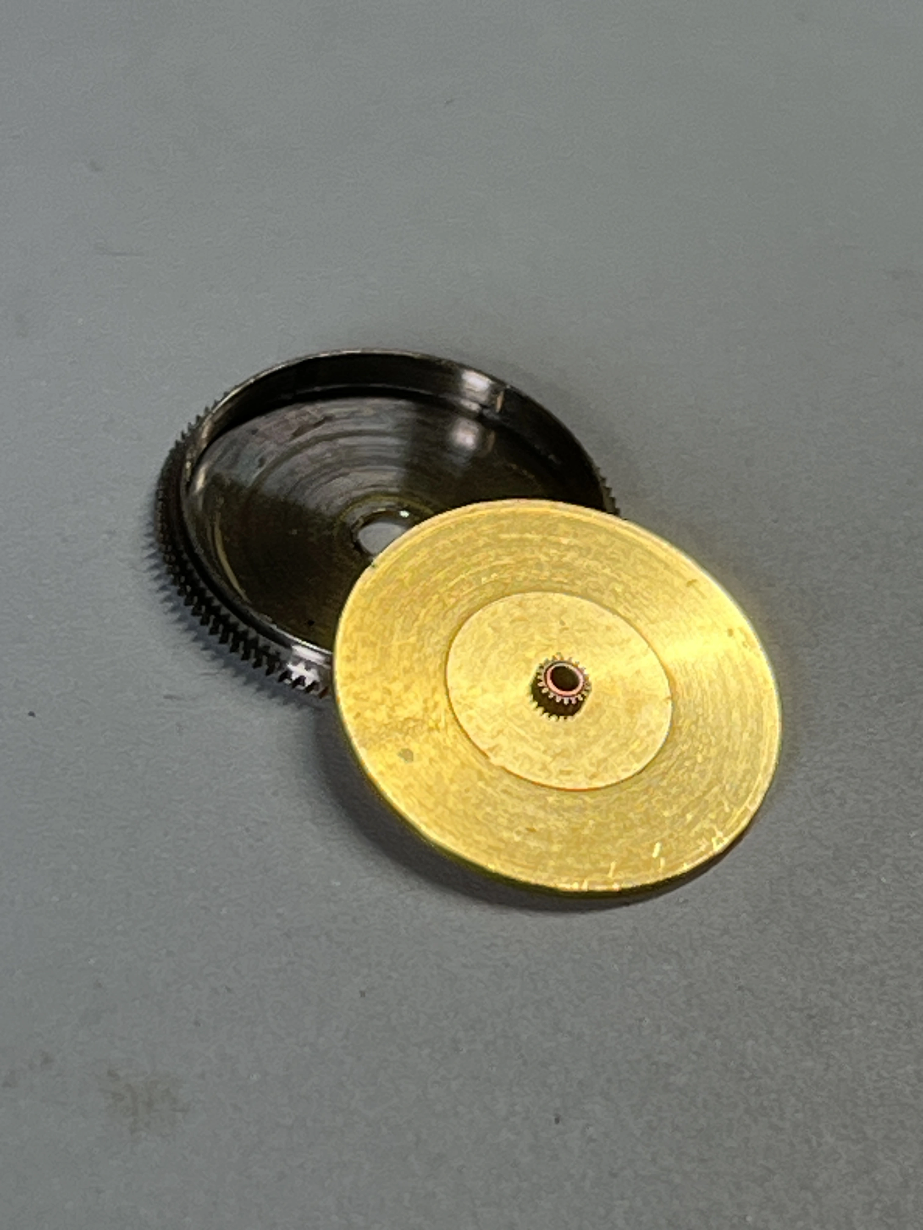

1. The balance is not etachron, (instead it’s a simple stud fixing) but all references I am finding on the internet say that the balance for val and eta 7750 are compatible? I’m now wondering if the movement is a fake, or were the val 7750 balances non-etachron? Also the barrel parts are differently coloured (barrel nickel, cap is golden). Not sure if this is correct or not.
2. I’d like to install a new mainspring. Cousins seem to change specs on a monthly basis possibly to use available stock. My question: is there a definitive spec (dimensions) for the val7750 mainspring?
3. There is an option to procure a mainspring and barrel complete. Are these fit to install from blister pack, or do I need to strip it down, clean and apply braking grease to barrel wall?
The old Valjoux versions didn't use ETACHRON, at least I've never seen one that did. The balances are not the same obviously, since the stud is completely different on the two designs. An ETACHRON stud will not fit on the movement.
The colour of the barrel is just a function of it being plated or not. I've seen both.

I would just order by caliber rather than size.
When using a barrel complete, the only thing you need to do is apply some 9104 to the spot where the barrel arbor meets the barrel drum or cover (so oil each side). There's no need to take anything apart.
