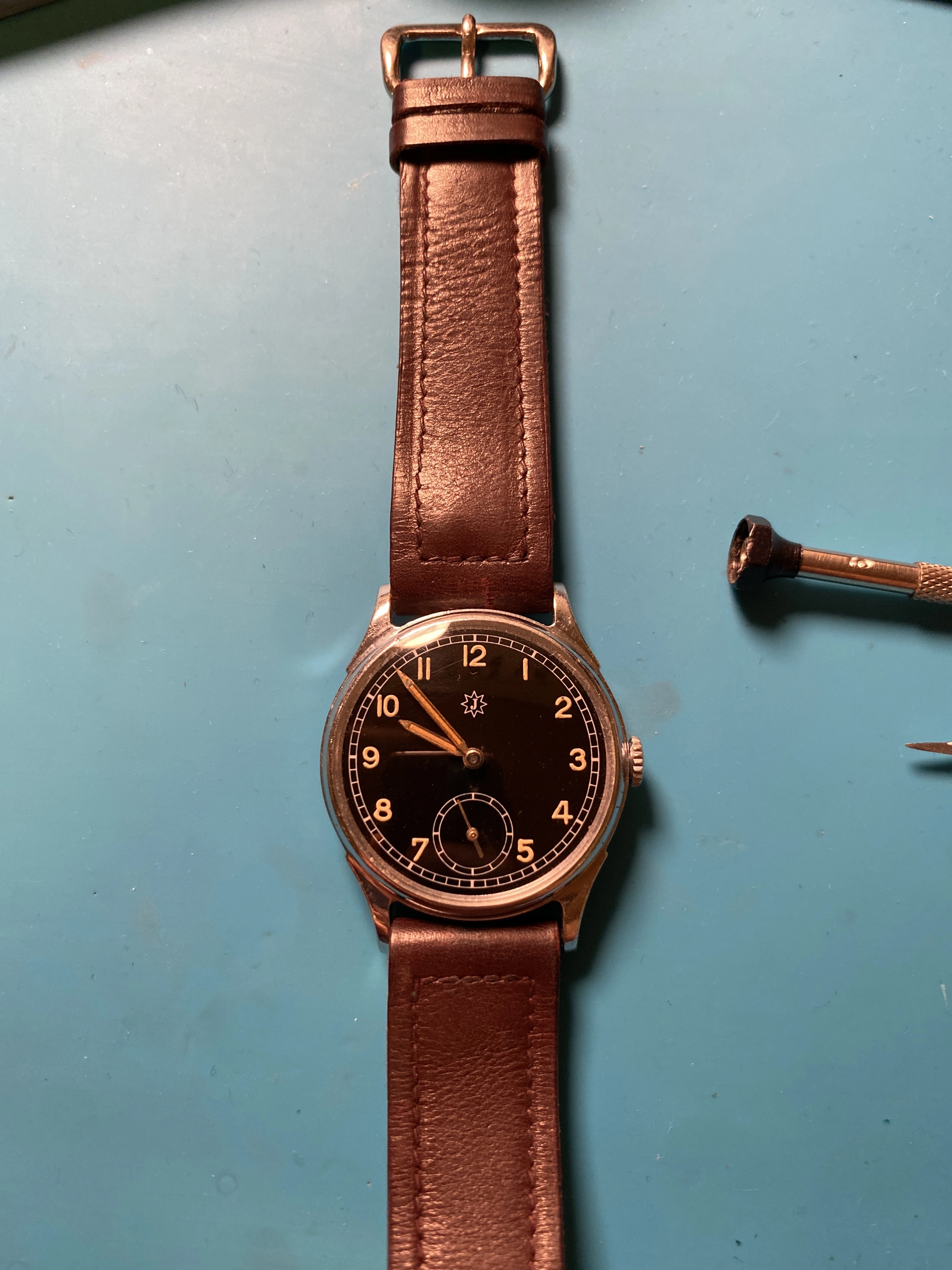

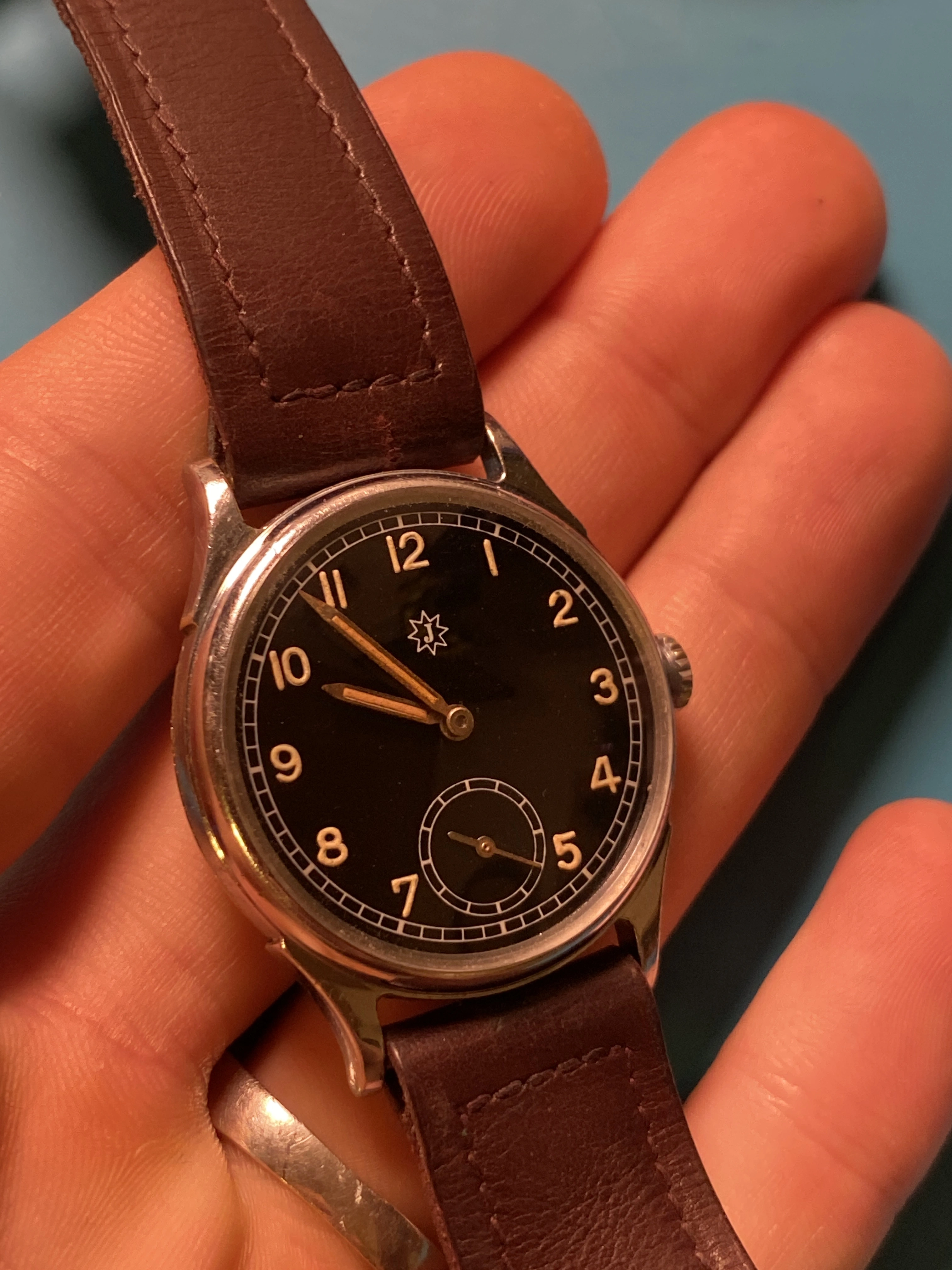

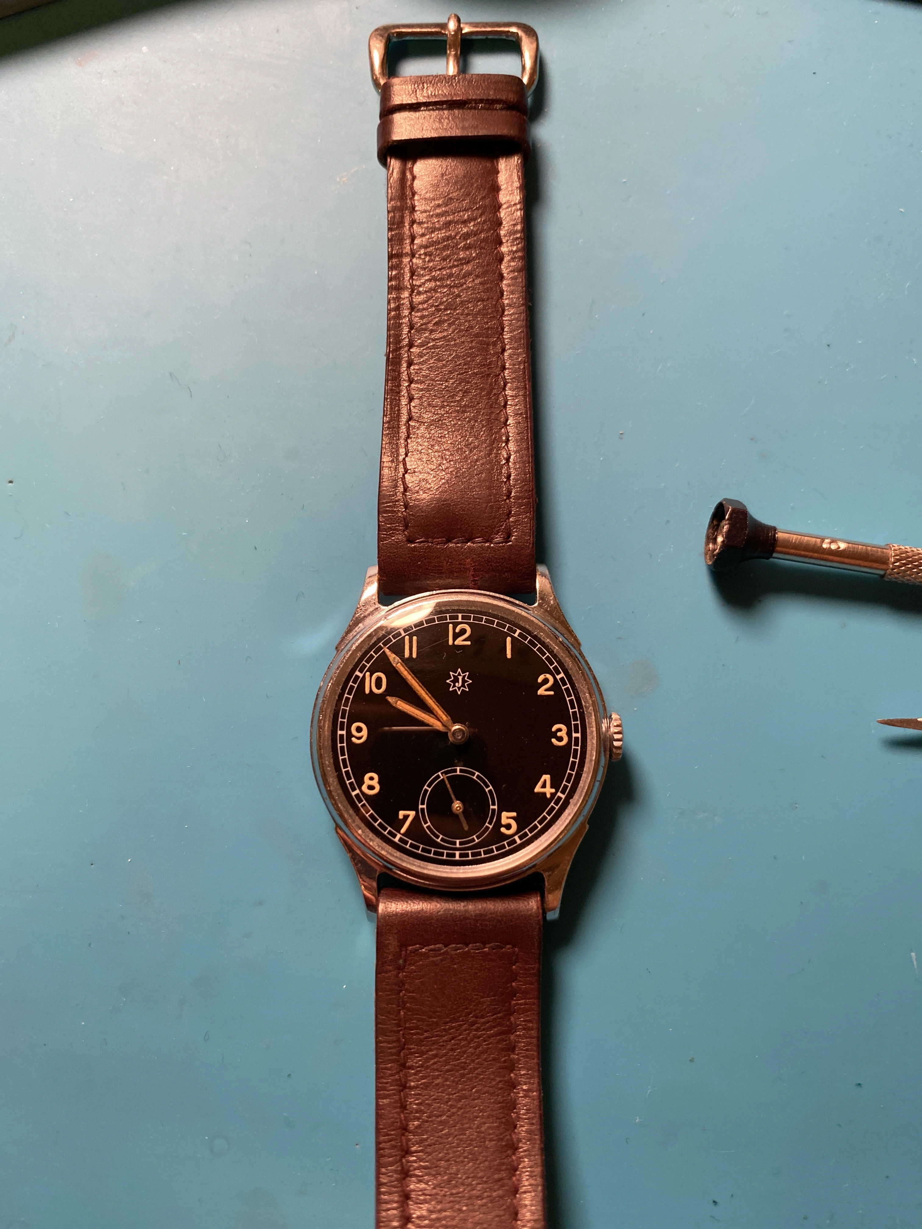

I‘m trying to restore an 1940 Junghans. And i would Like to install a new mainspring. An S shaped one. Do you know where i can get one an which messurements i need to take.
2,671
2,856
Emmy (https://www.emmywatch.com/db/movement/junghans--j97/) has a mainspring listing and suggests:
GR4915 (slightly thicker, slightly longer): Will increase amplitude... reduce total wind.
GR4906 (Slightly shorter, on a smaller 'barrel') Will reduce total wind only.
GR4907 (slightly shorter) Reduce total wind.
GR4895 (thinner, shorter, smaller barrel) decreased amplitude, reduce total wind
GR4933 (a bit thicker, shorter, smaller barrel) increase amp, reduce total wind.
source: https://www.emmywatch.com/db/mainspring/1_7-0_11-285-9_5-man/junghans--j97/
Note, smaller barrel just means the little aluminum circle it comes on will be smaller, so no functional difference.
IF it were me, I'd go for the GR4915. Cousins has it for ~8 GBP (https://www.cousinsuk.com/product/170mm-height?code=GR4915).

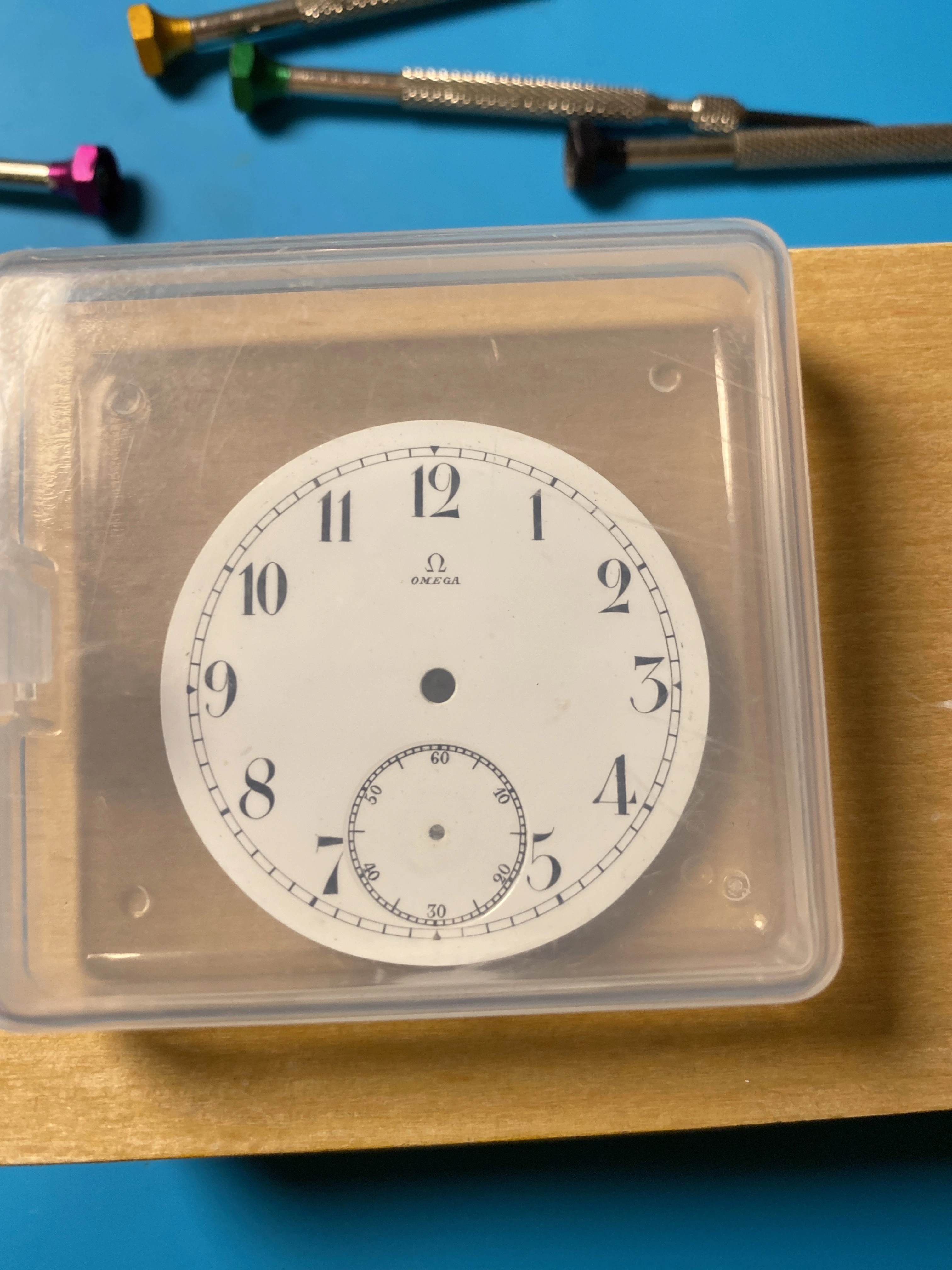

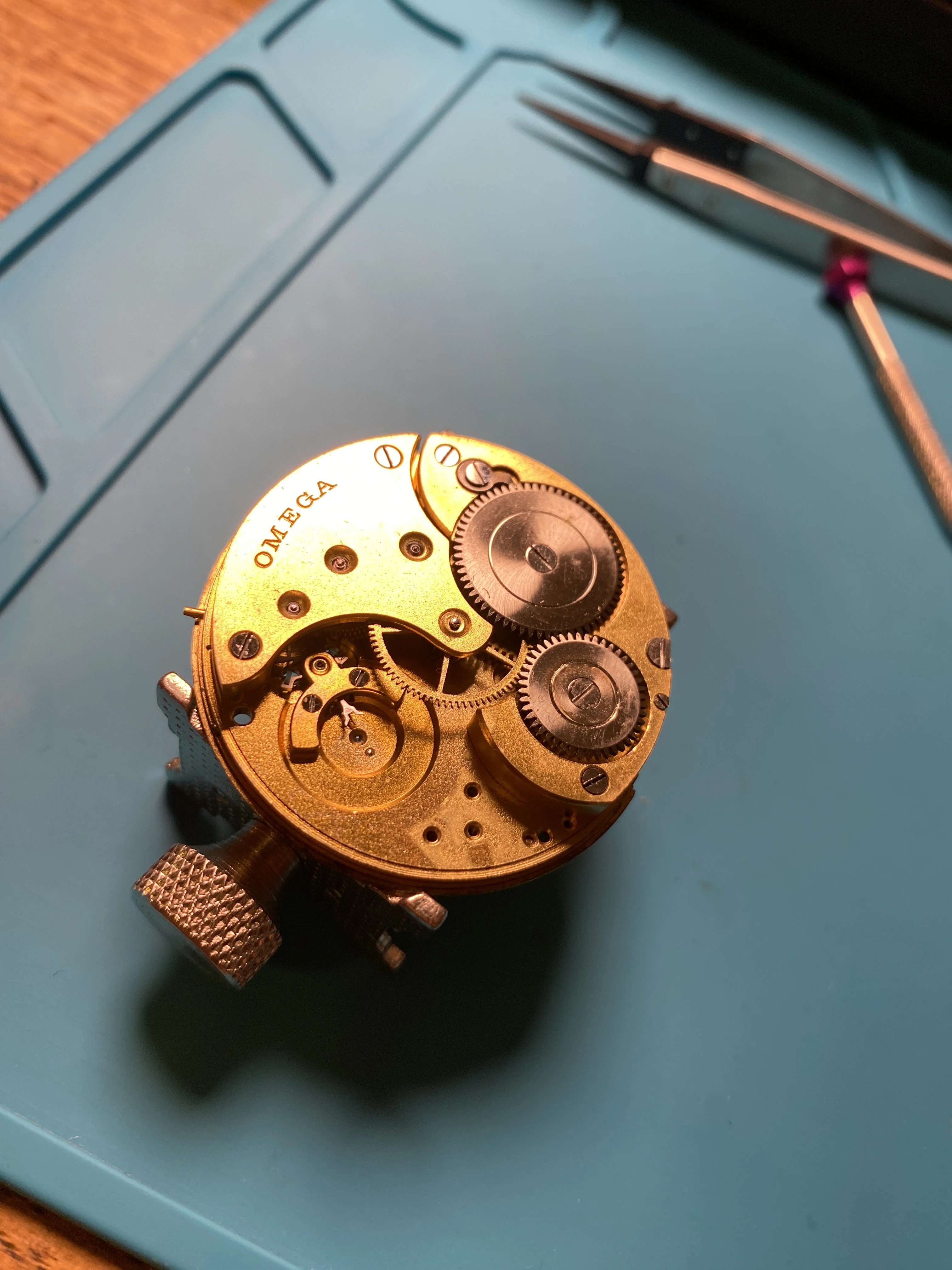

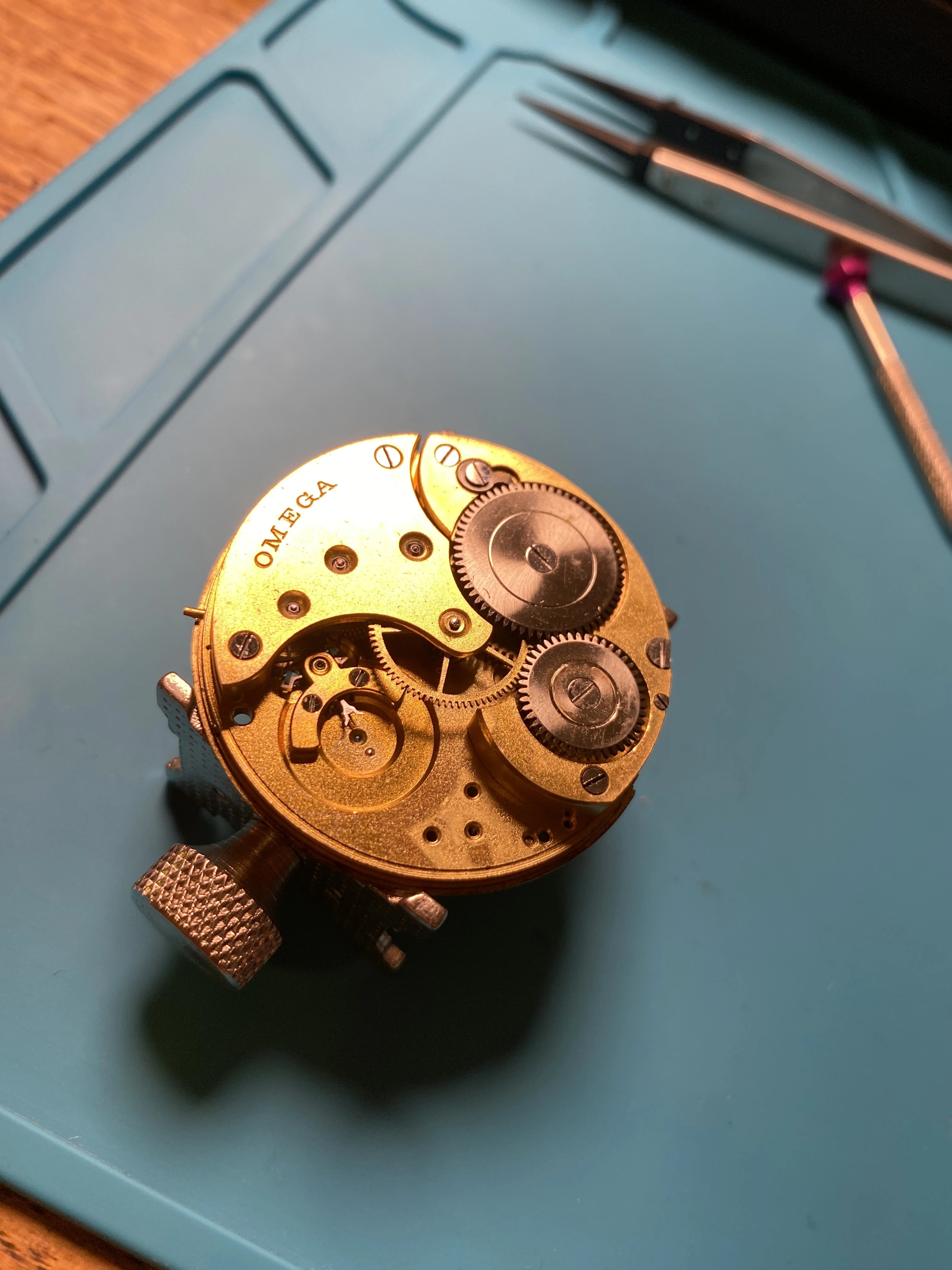

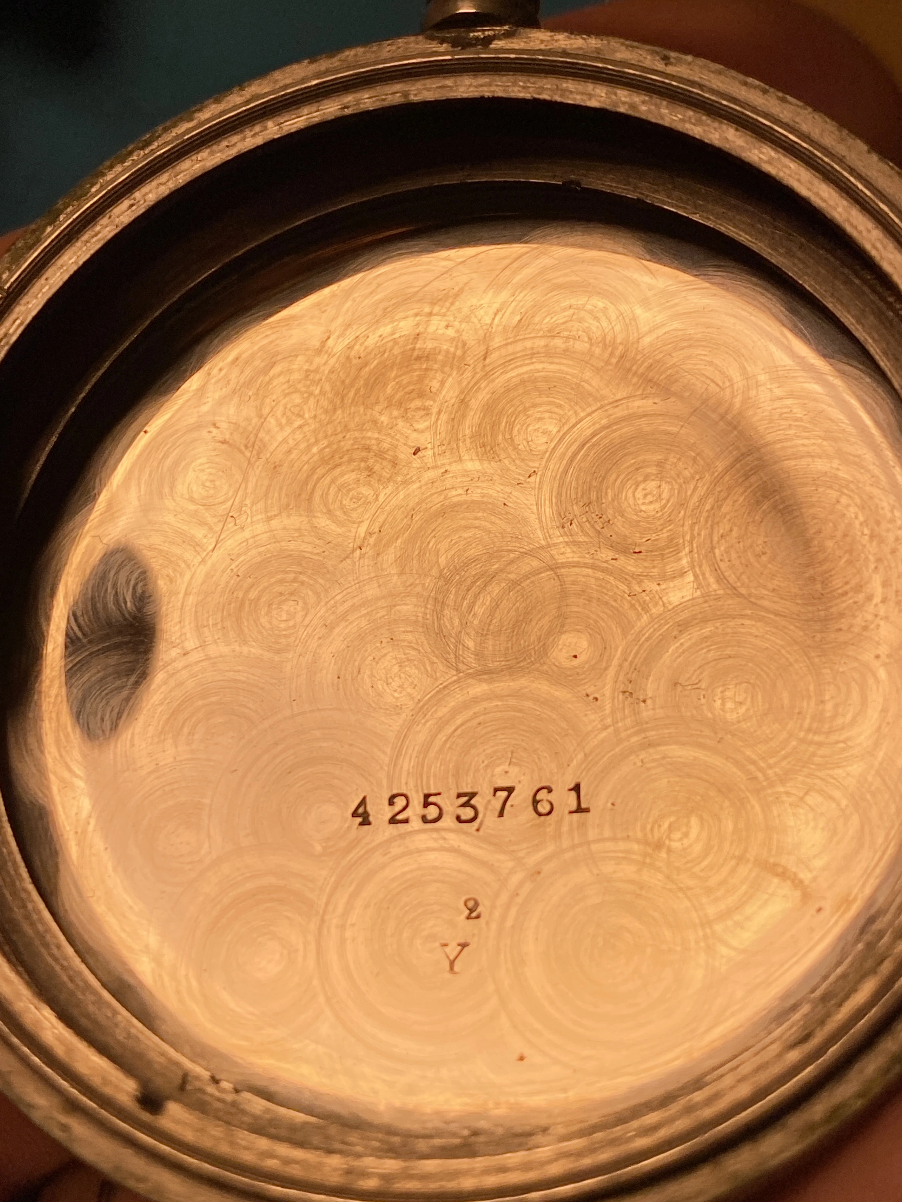

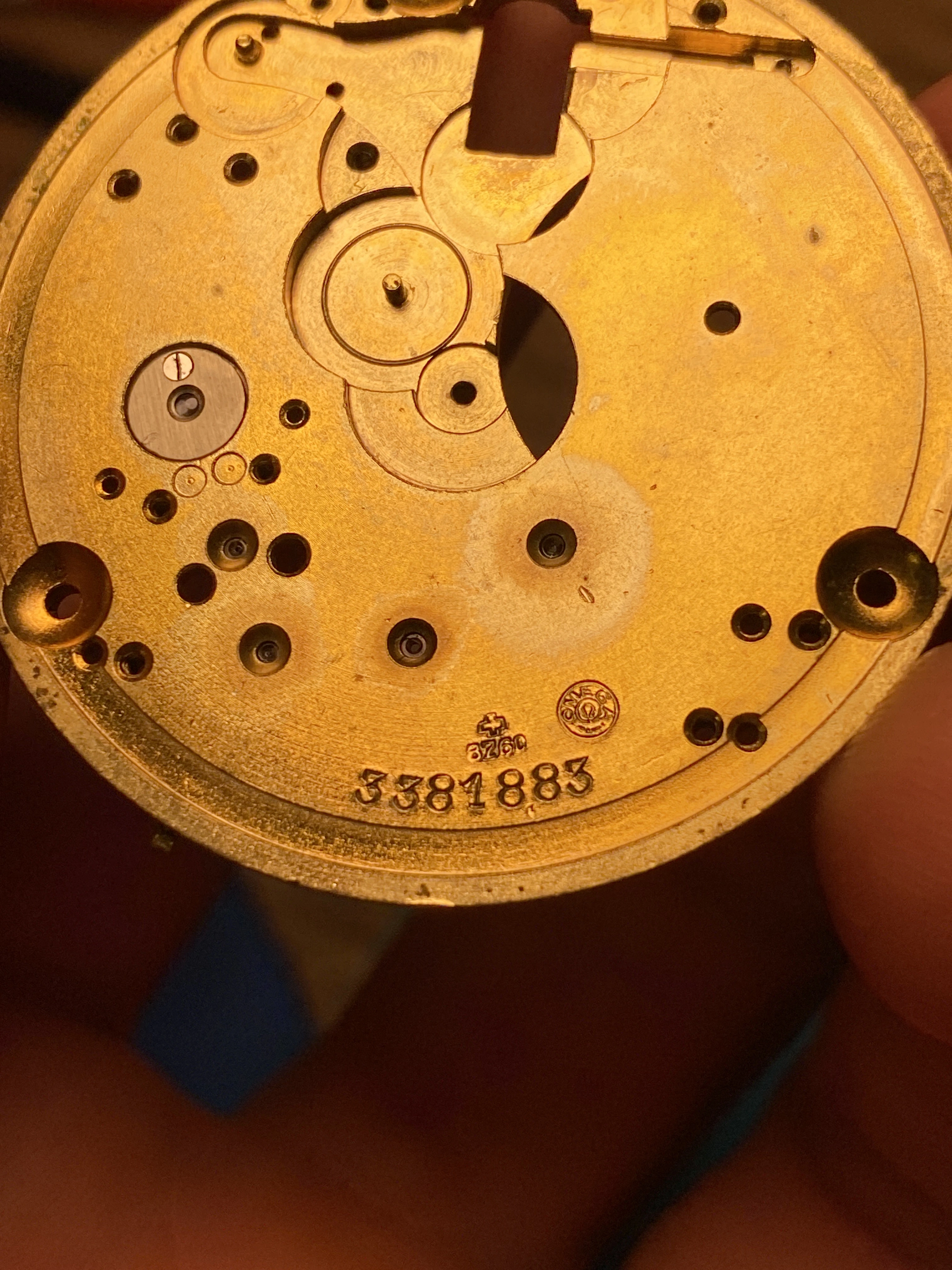

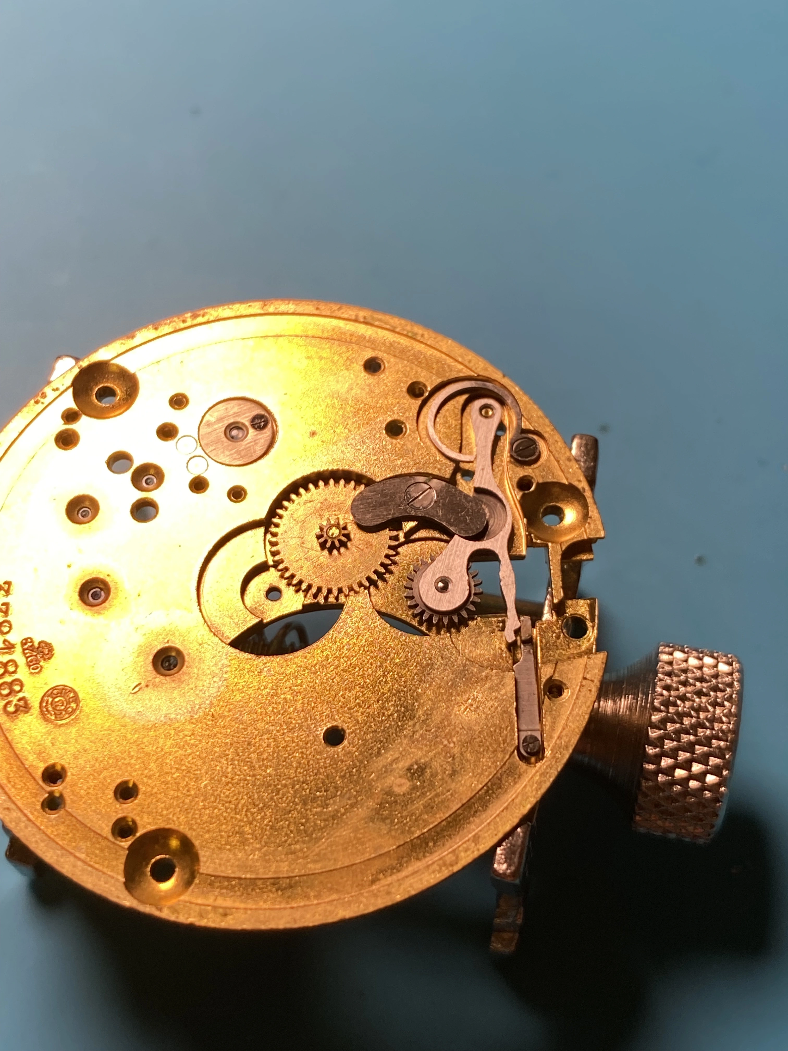

Wow Thank you verry much for the quick answer! I‘m also working on a old Omega Pocket Watch. But i dont know the caliber Name. I also need a mainspring for it. Maybe you can help me with that also.
2,671
2,856

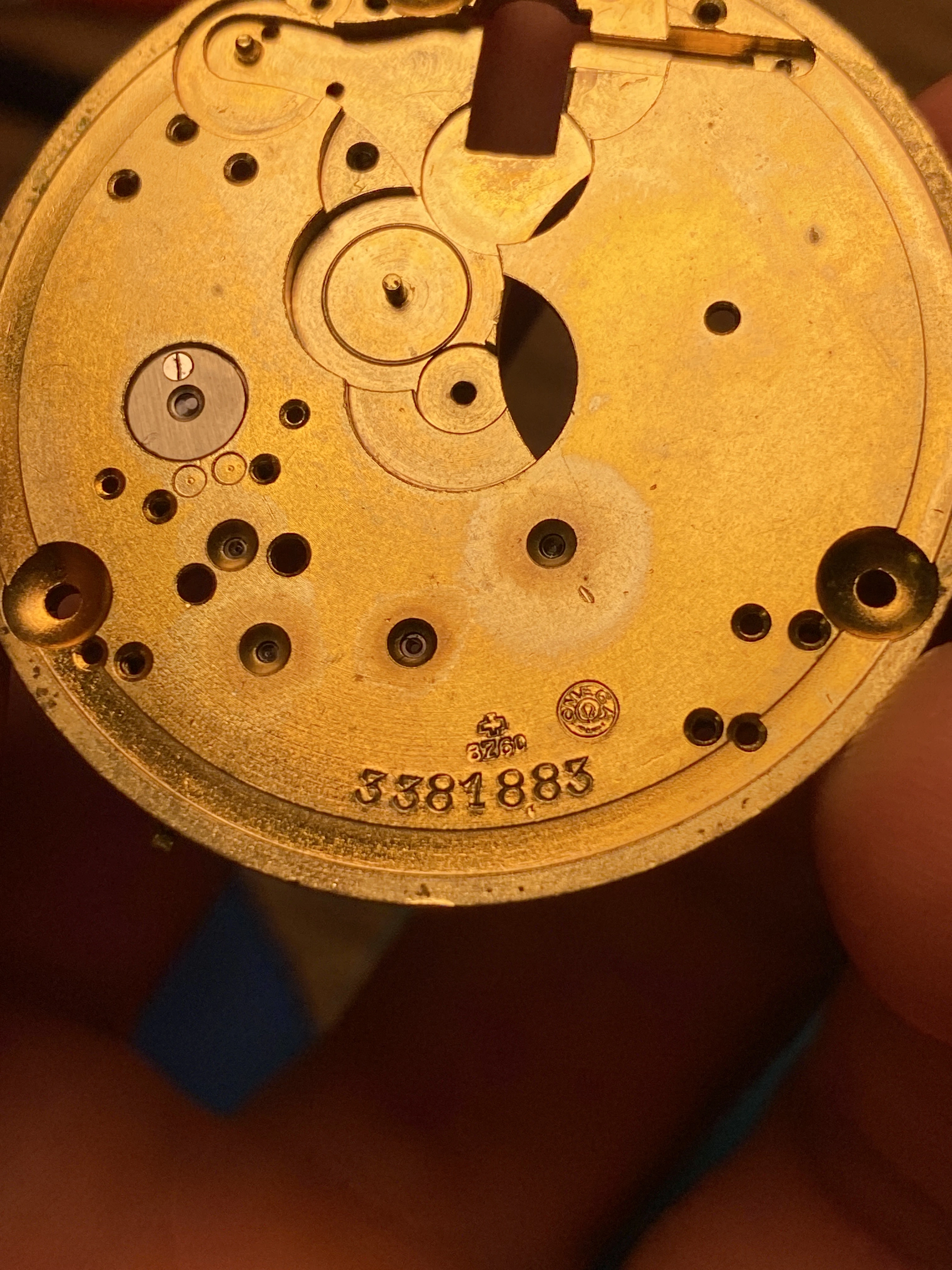

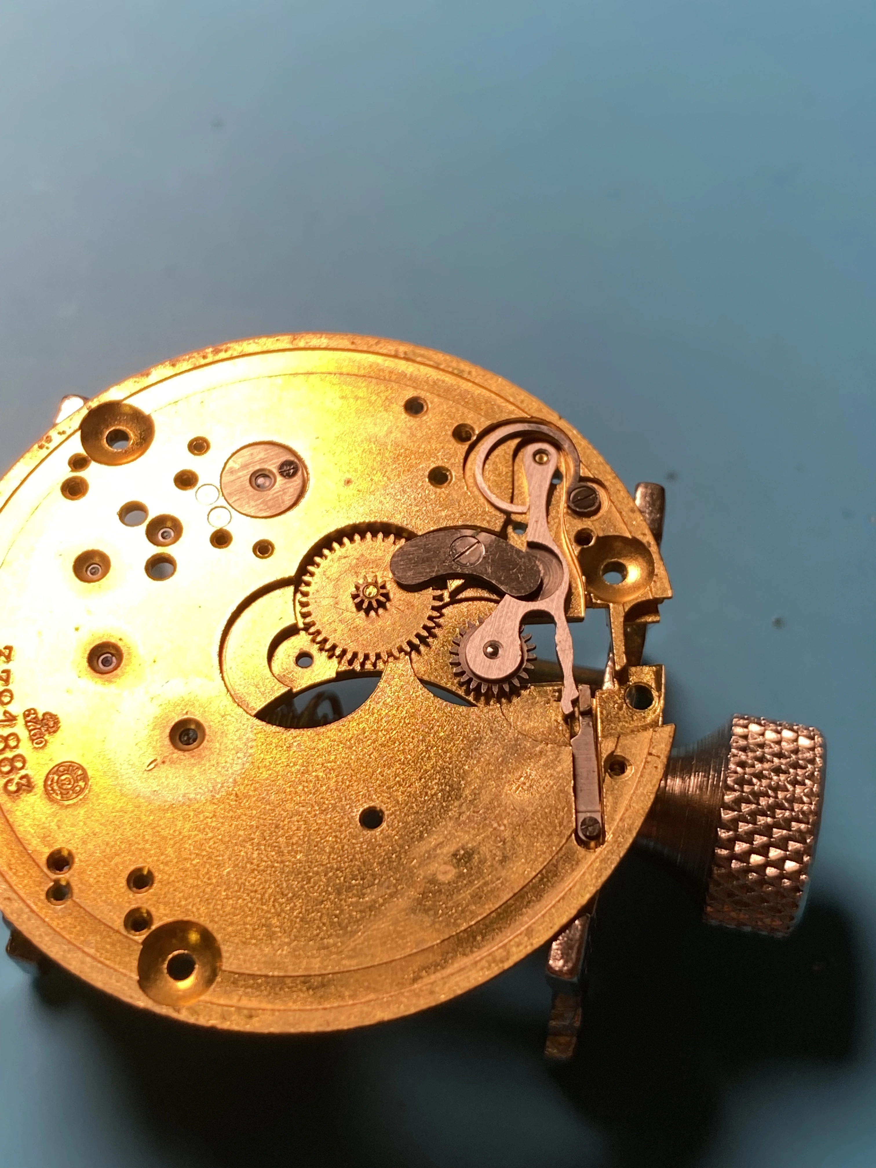

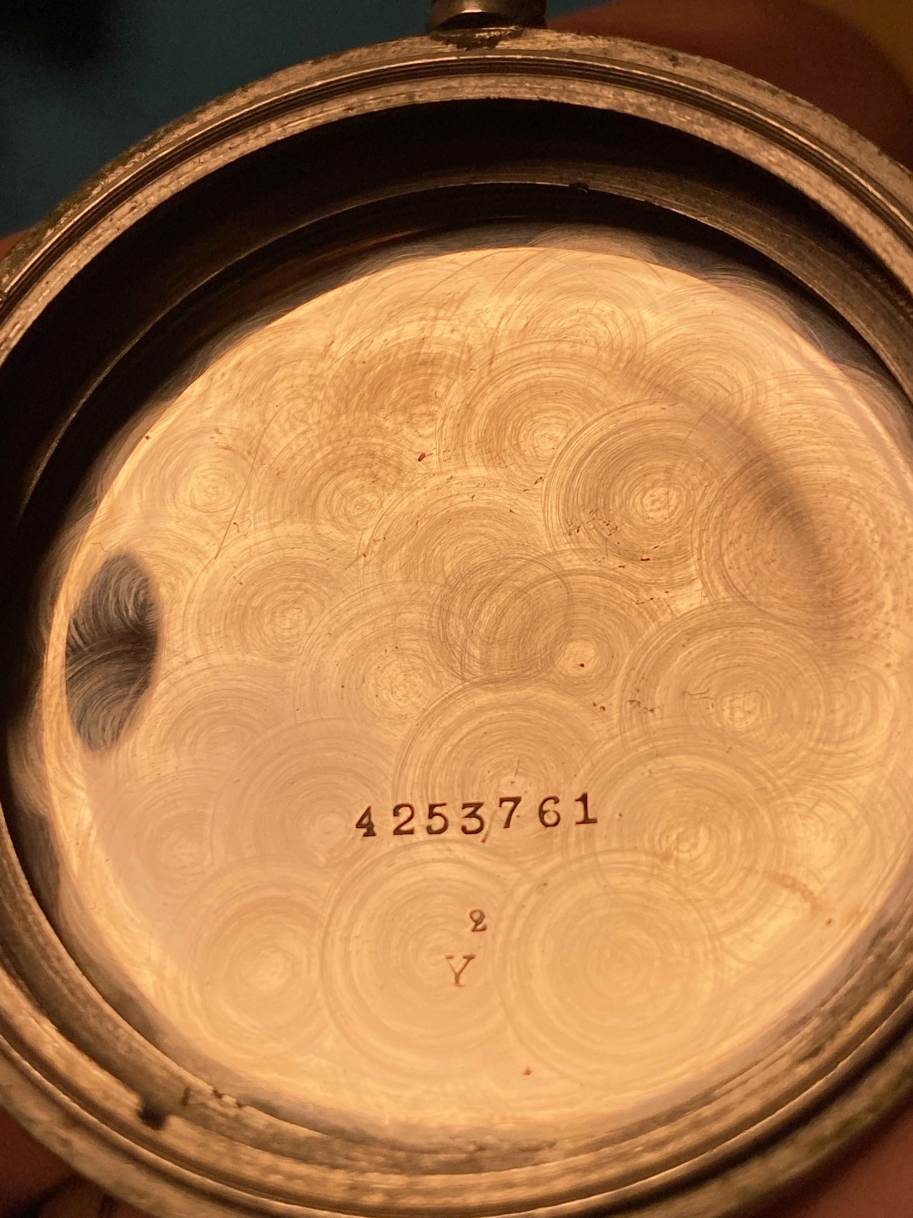

With old pocket watches, you can often tell based on the serial number what model it is, but you've cut off the serial in your photo!
2,671
2,856

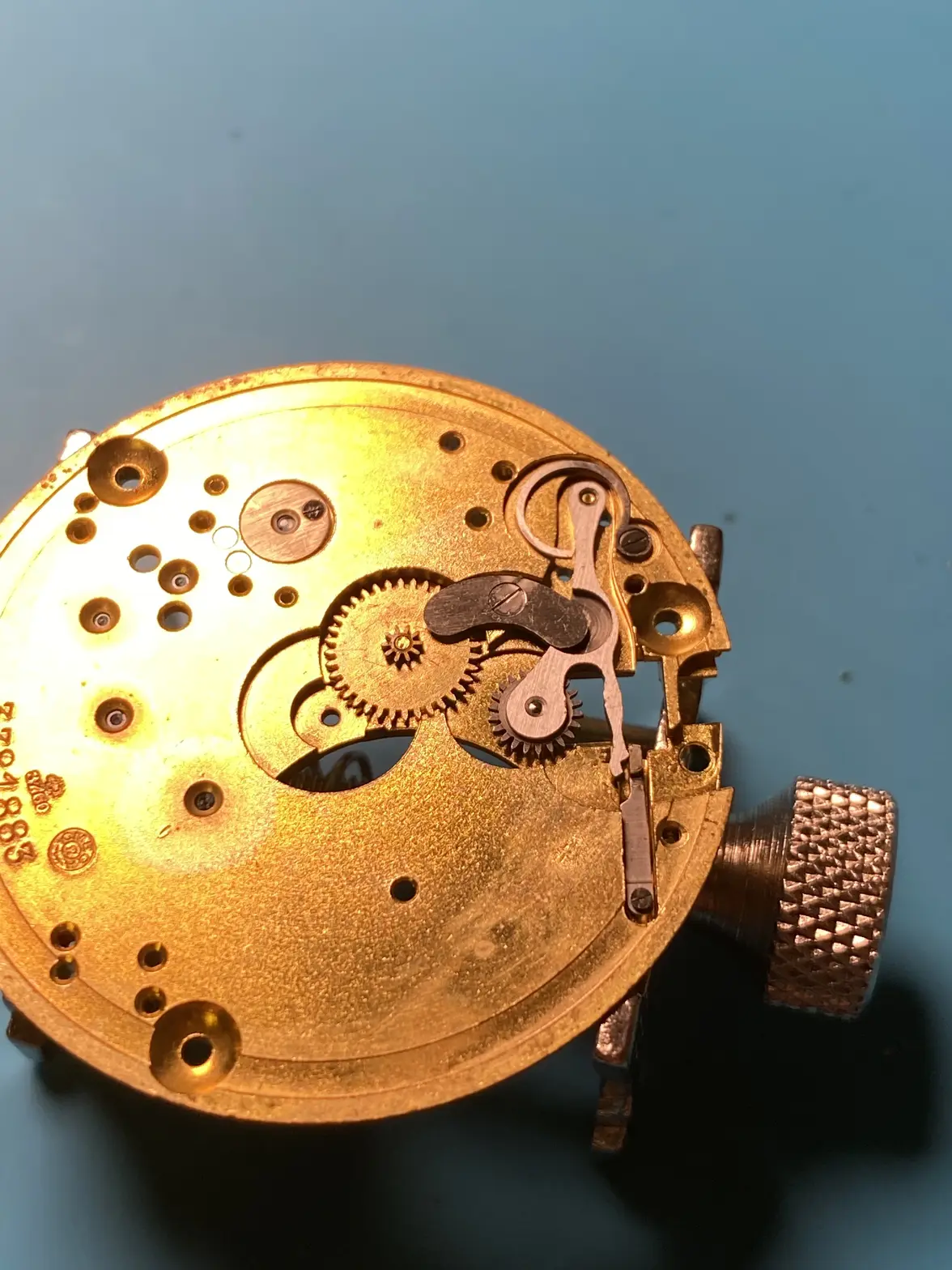

I guessed at the serial number and came up with this which seems right: https://pocketwatchdatabase.com/search/result/omega-watch-co/3381883 (looking at your new photos, I guessed right!).

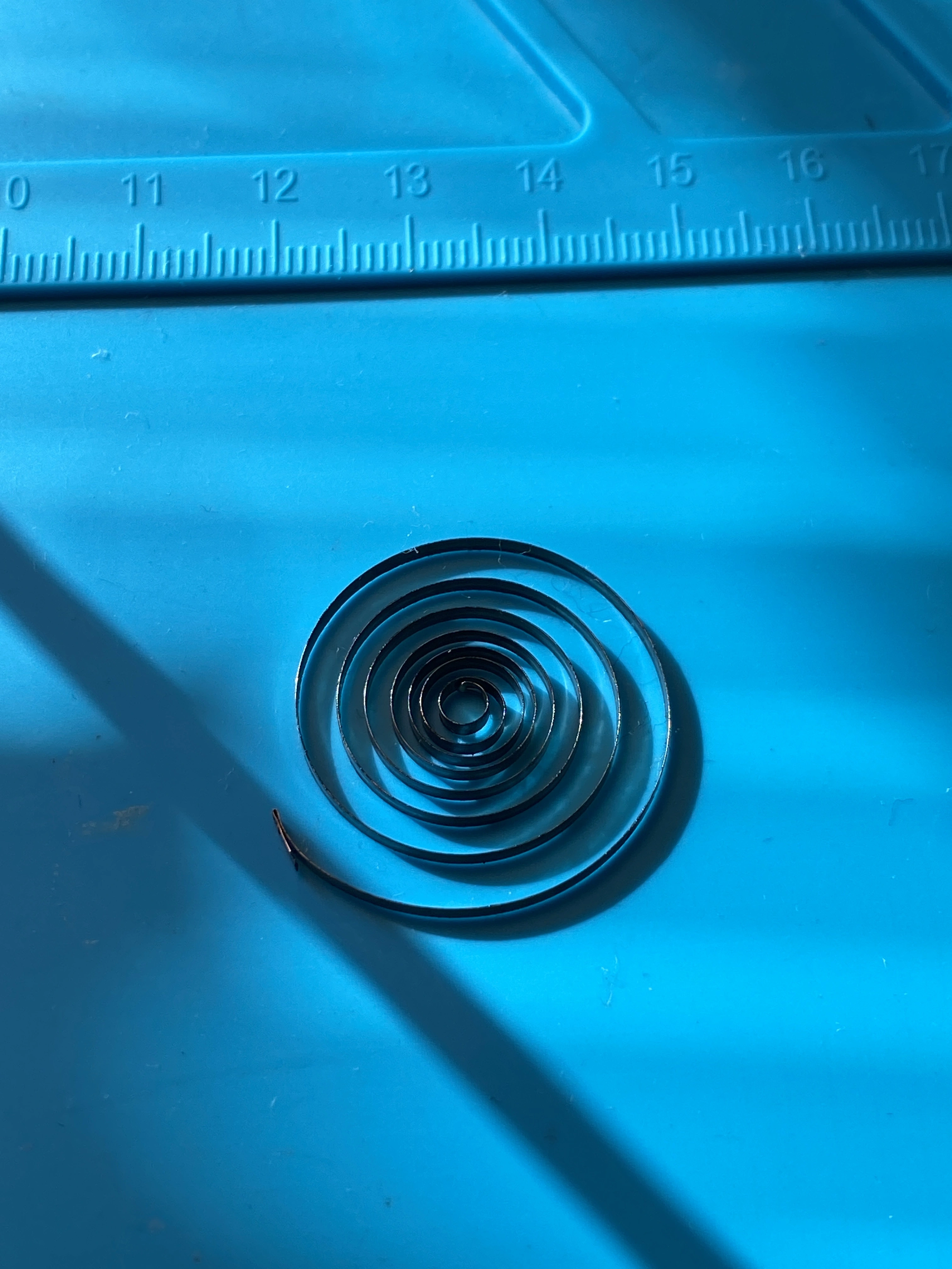

I don't see any info on model/etc, so you might just have to measure it.

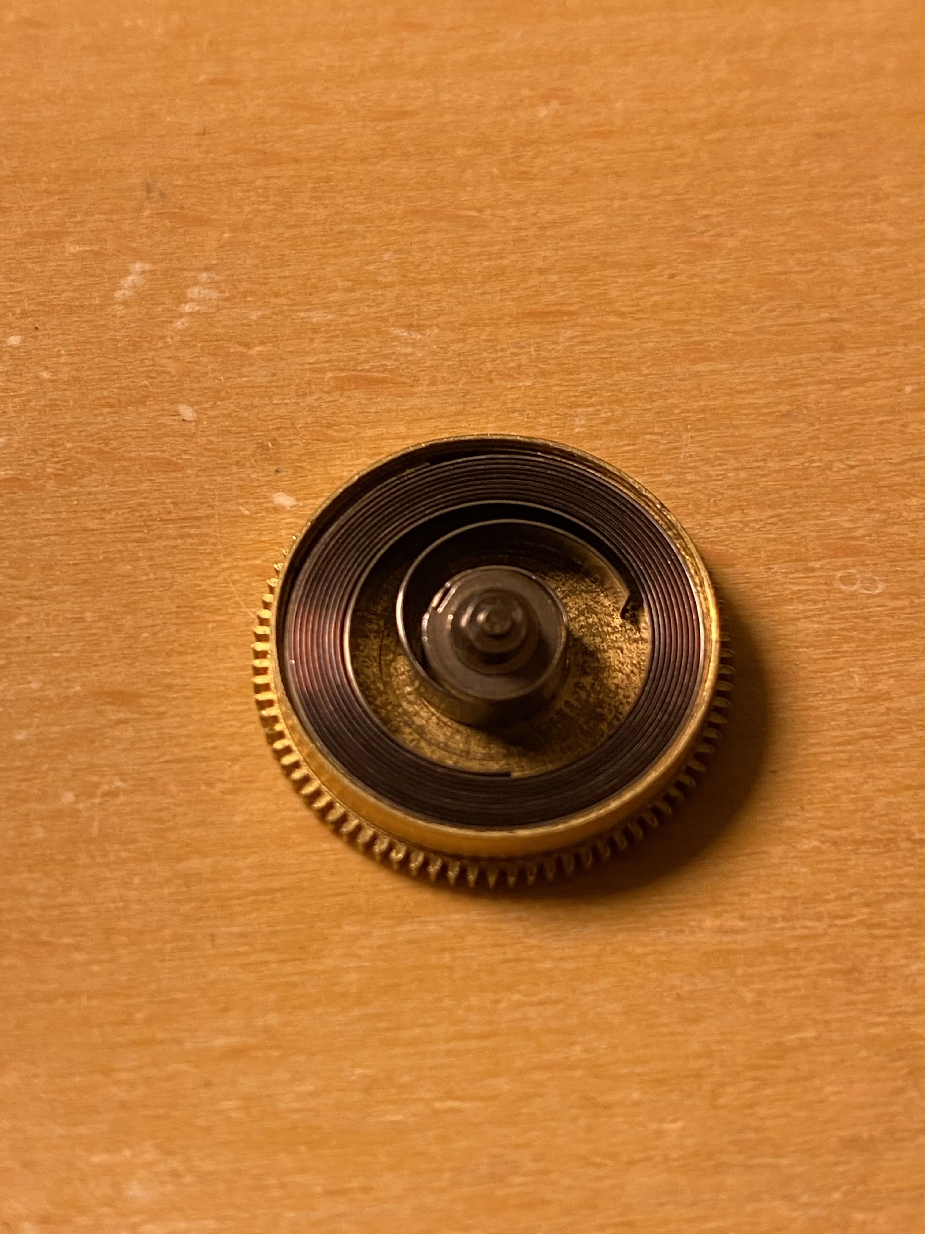

The numbers are sold as:
Height in MM (long ways of the cross section) x thickness in mm (short ways cross section) x total length in mm x barrel diameter (optional).
At that point, you'll need to know what sort of 'end' is on it (the bridle), this page has a picture of what they look like: https://www.cousinsuk.com/category/mainsprings-by-list-watch-pocket
For example, see: https://www.emmywatch.com/db/mainspring/1_7-0_11-285-9_5-man/junghans--j97/
1.70 x 0.110 x 285 x 9.5mm.
Height: You can't go any higher as it probably wont fit in the barrel then. You could possibly go slightly smaller though. Reducing height reduces overall power.
Thickness: You can go either direction a little bit, thicker is increased amplitude, thinner is reduced.
Length: This determines the total wind of the watch. Longer it is(up to a point), the longer the watch will run. Shorter will mean you h ave to wind more often.
Barrel Diameter: This one matters less?? IF you get this too high, you'll not be able to press it in off the little ring, as it'll be too large and you'll need a mainspring winder of some sort.
That said, perhaps someone who has a better idea of how to identify these will show up, you can sometimes do it by keyless works.

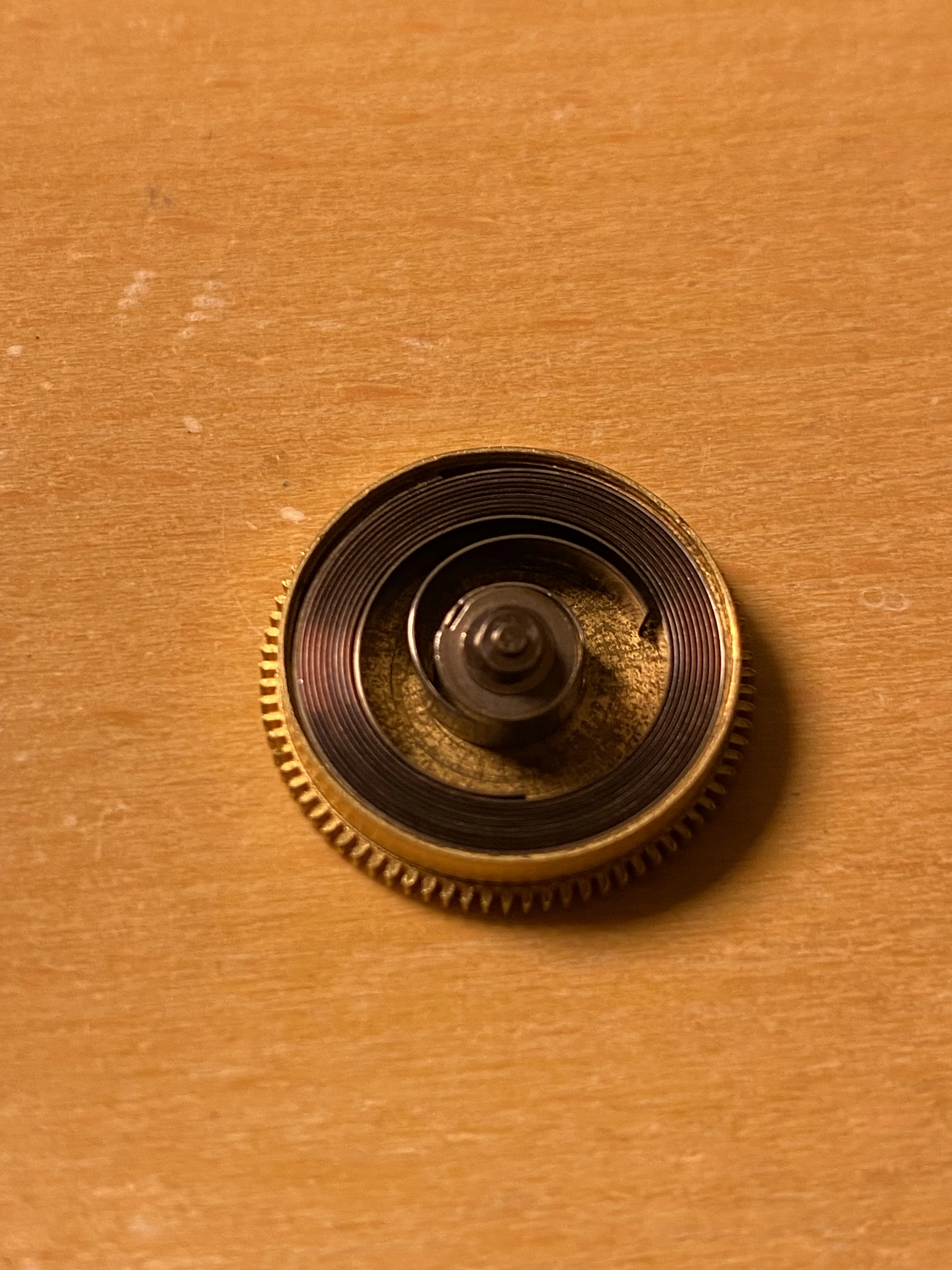

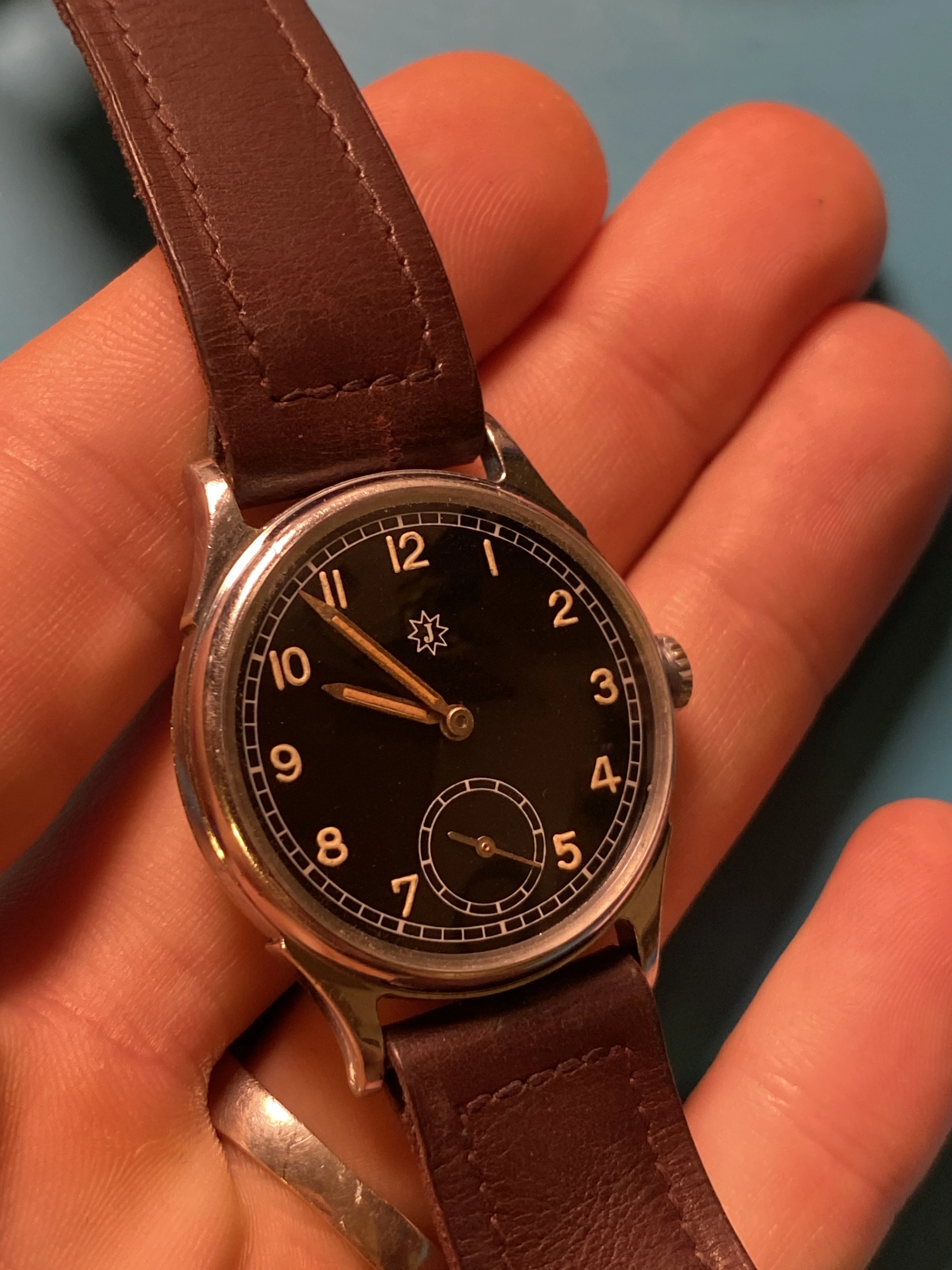

I reinstalled the j97 back together with the old mainspring but the amplitude is Not great so its probably a good idea to install the 4915.
208
181
Nice lume.

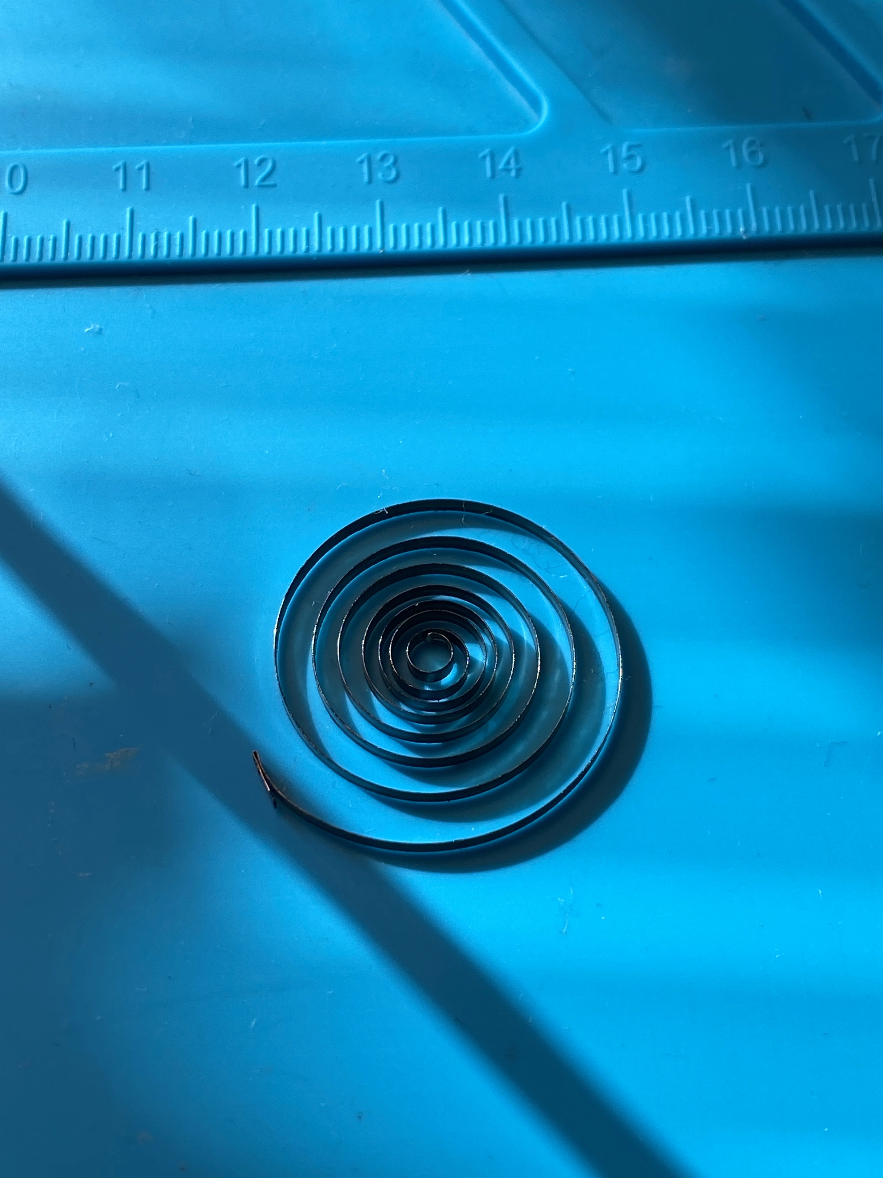

There also is a mainspring configurator on cousinsuk.com. You can choose a mainspring as close to the original values as possible (height should stay the same of course as Erich already suggested)
If you cannot or do not want to research your original values you can also measure them with a micrometer, it's a rather inexpensive tool..
