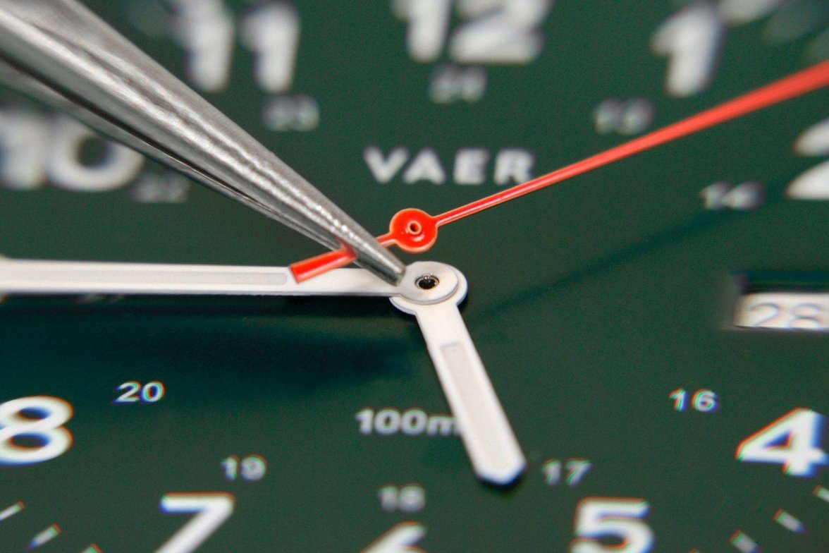

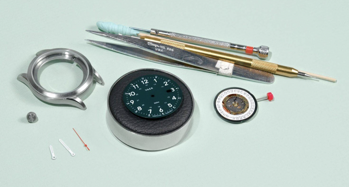

Lots of nice words, mostly fluff and bluff I feel.
The things that made me wince........
And the "hand setting phase"
Not a hand setting tool in sight (I like the Rodeo stick though 馃檮).
Kitchen table workshop, by the looks of things...or a staged shot and the watches are made in China. No idea as I've not looked into this brand before, so don't know a lot about who they are or what they claim, other than the bogus information on hand alignment.
A lot of eBay sellers seem to think that if they show watch parts being held in tweezers, it lets people know that they are professional watchmakers.
And white cotton gloves.
