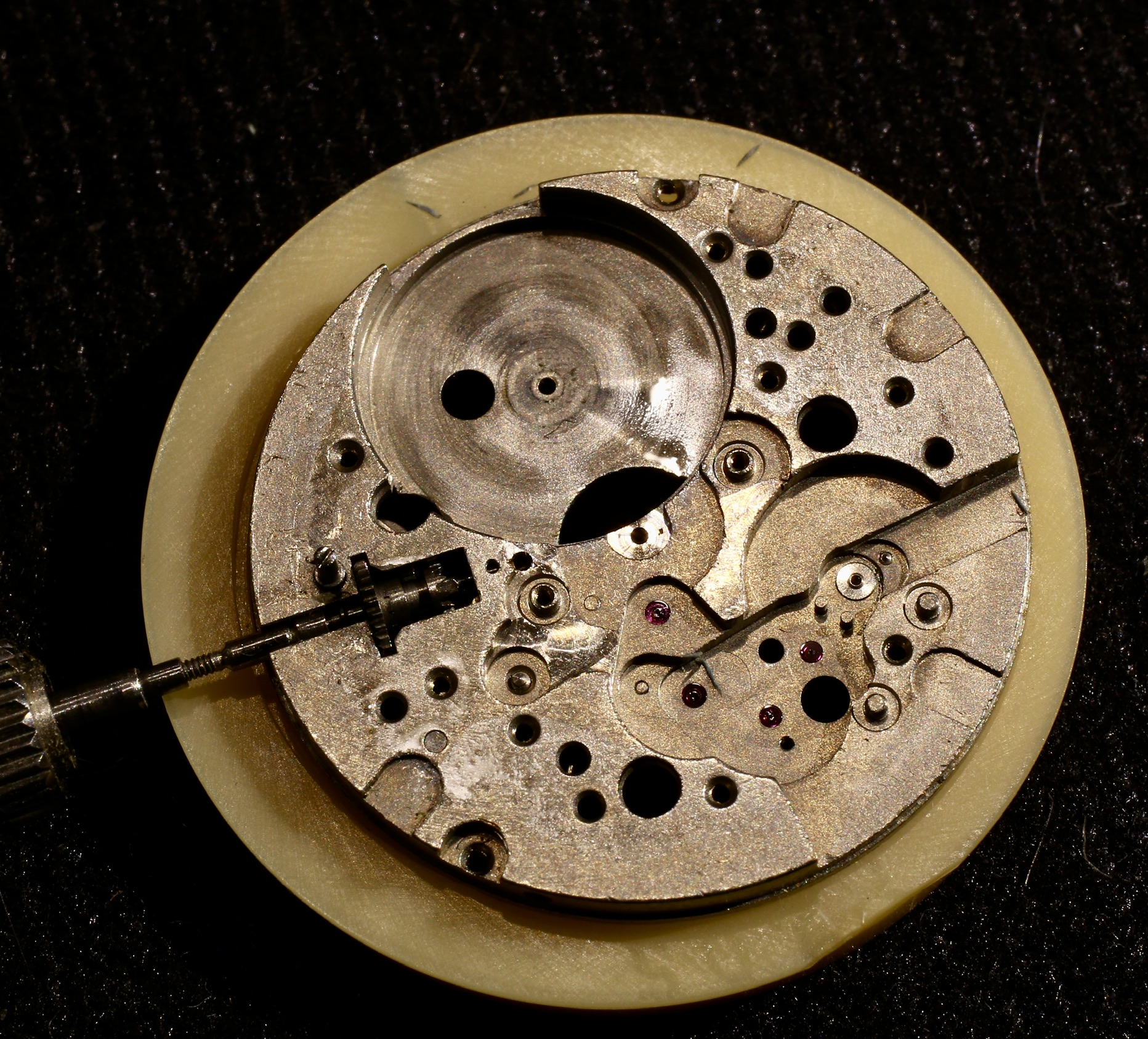

Probably been discussed many times before ….
- If it’s off eBay….. unless it’s freshly serviced by a really reputable dealer
- if it’s ‘freshly serviced’ without an invoice from a known watchmaker
- if the service history is unknown
please have it serviced by someone you trust before using it. I’ve lost count of ‘freshly serviced’ or ‘serviced not too long ago’ older and vintage watches that look like my skillet after I’ve fried an egg.
The shine and discoloration is mostly pools of oil and grime. The movement was keeping decent time though the balance amplitude a little low.
Don’t be greasy like this guy

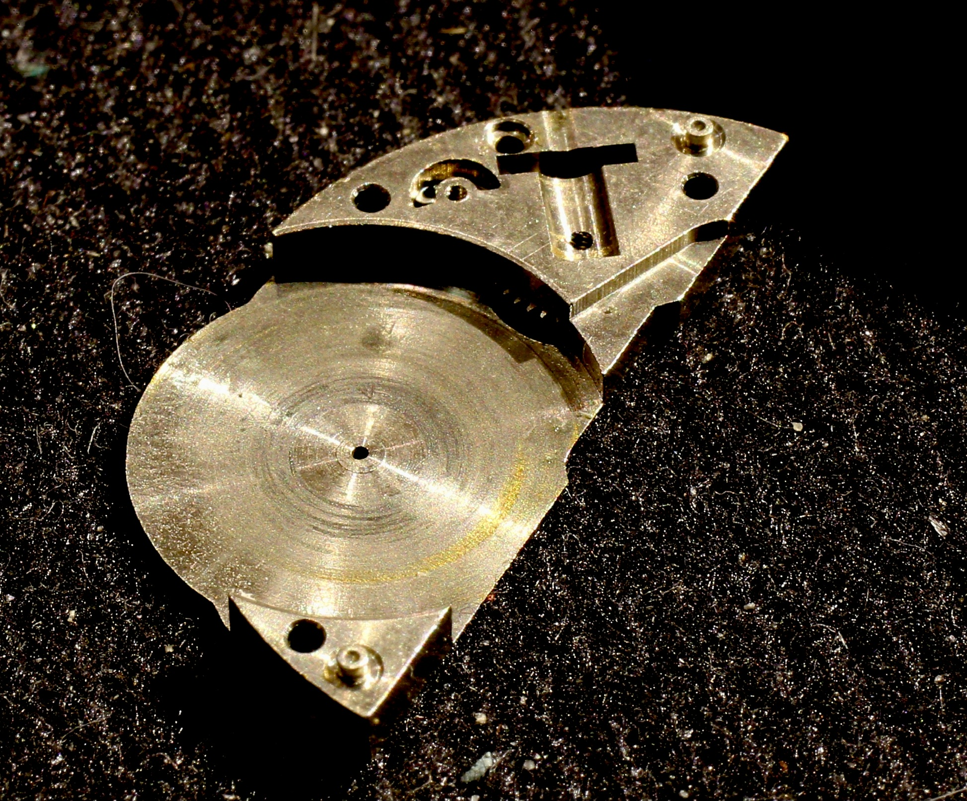

You can see where the barrel has been rubbing on the underside of the barrel bridge, and this will reduce the amplitude. Likely worn hole in the barrel bridge, so you can either bush it or find a replacement bridge.
279
753
Thanks!! Probably why someone put a quart of oil in the movement
