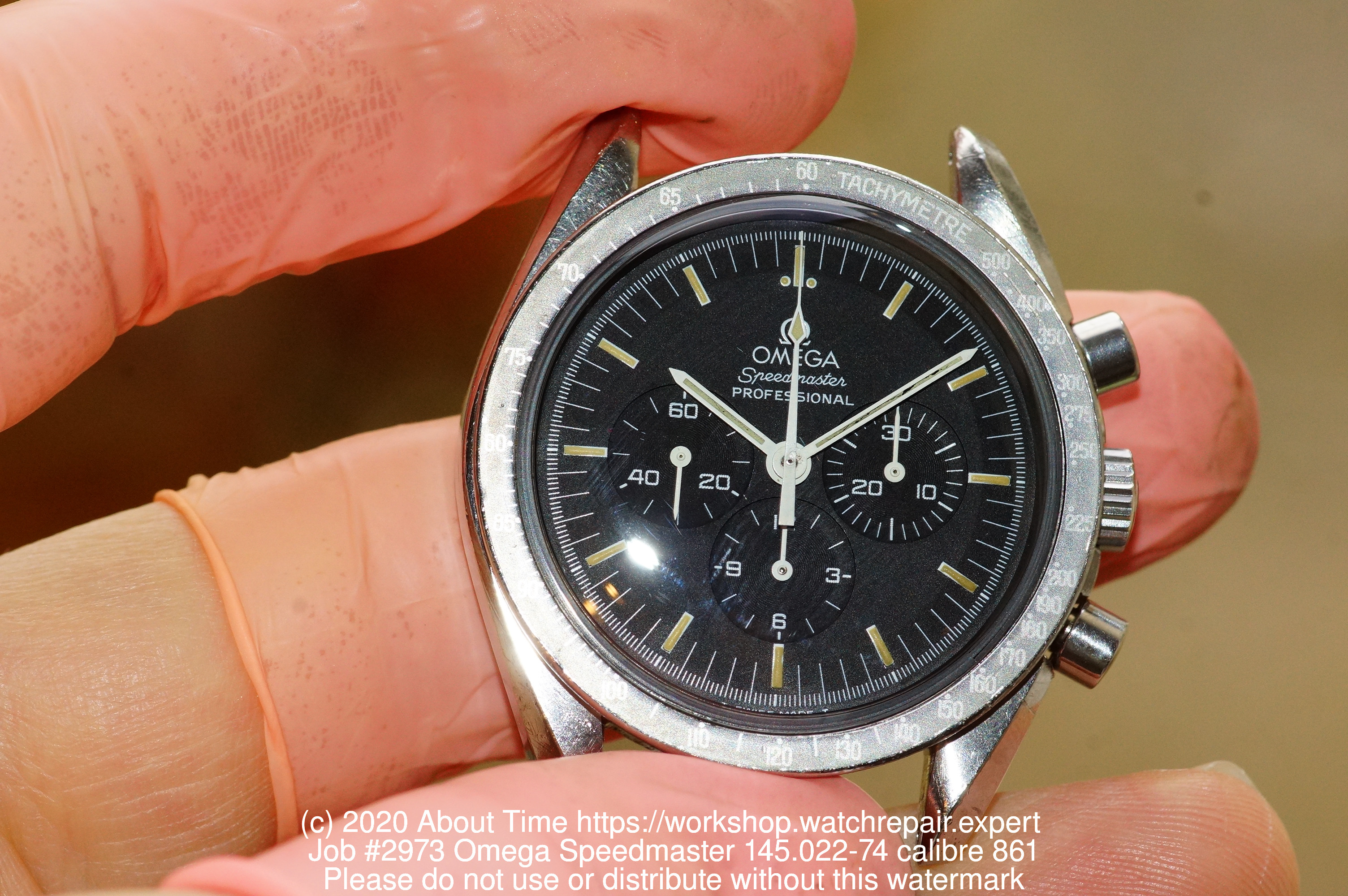

The plastic brake was introduced in 72/3.
Thank you for this input. I have never seen a regular Speedmaster Professional cal. 861 with a Delrin brake from this period.
Besides my own observations I had read this article from Chuck Maddox' website:
http://chronomaddox.com/omega/articles/delrin.html
Would you please share some knowledge with me and tell me where to find your information?

Thank you. Can you actually show me any watch in the wild for reference?
2,827
4,722
No I can't, but there would be no point if you are relying on Chuck Maddox articles for your speedmaster knowledge.
Thanks again. I'm mainly relying on what I've seen by myself.

I had understood this the other way round, which seemed ok for me, since I thought that the"plastic" brake wasn't used before the late 70s and with movement serials up from 39 m.
My understanding was the change was during -71 production. But as we are seeing what seems like early -71 serials in -74’s it may be right.
18,307
27,671
But would you expect a 31m to have a plastic brake?
I was trying to allude to that as there are now a few “-71’s” with extracts that show -74 production and have -74 case backs.
i still think these where sea monster car backs that got sent back and swapped. But who knows.
I was going to mention that, seem to recall a thread a few years back that there is a few 74s with 32xxxxx serial numbers also

You would expect it to have a plastic brake in 74 and the jury is out on 31m in 74. But as to the later it bears more research.

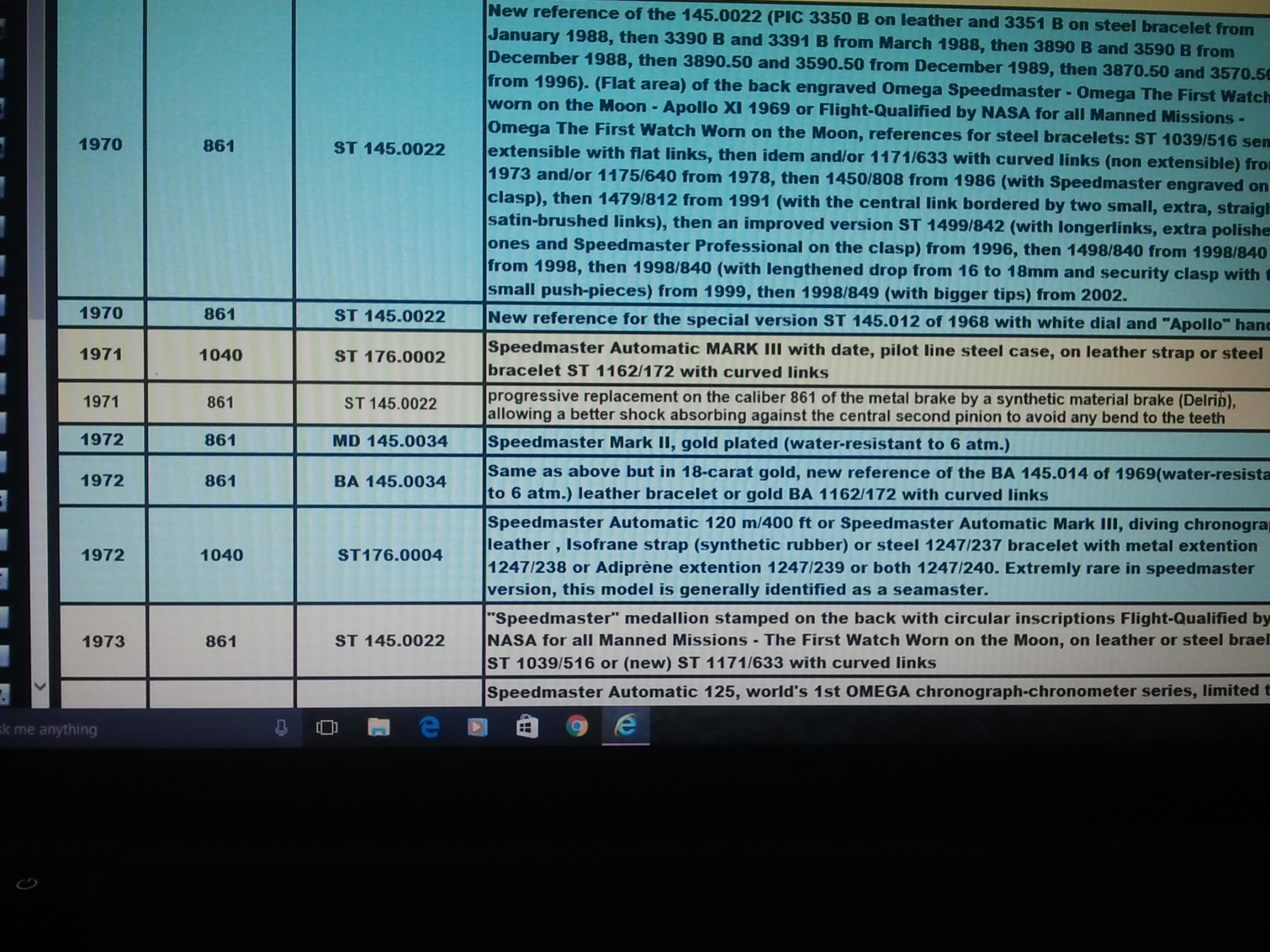

MWO says Delrin brake from serial 32.849.xxx references 145.022-69 and -71 towards the end of 1971 production.
Paradoxically models made in 1975 i.e 145.022-74 are fitted with the steel brake but having serial numbers below 32.85x.xxx.
They say that these movements were manufactured several years before being installed in the final watch.
5,109
15,810
That ties in with the ‘quartz-crisis-random-bin’ mashup theory in a way...
