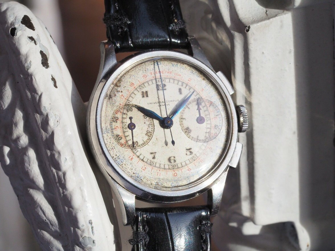

Hands and Breguet numerals
馃憥

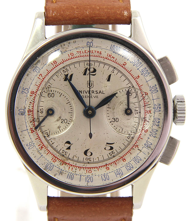

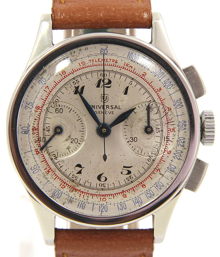

What do you think is wrong with them?
2,624
7,342
Not being an expert the hands seem short and I have not seen many UG with the Breguet numerals.
1,180
4,233
Not being an expert
It's a quest for Non-experts 馃槈

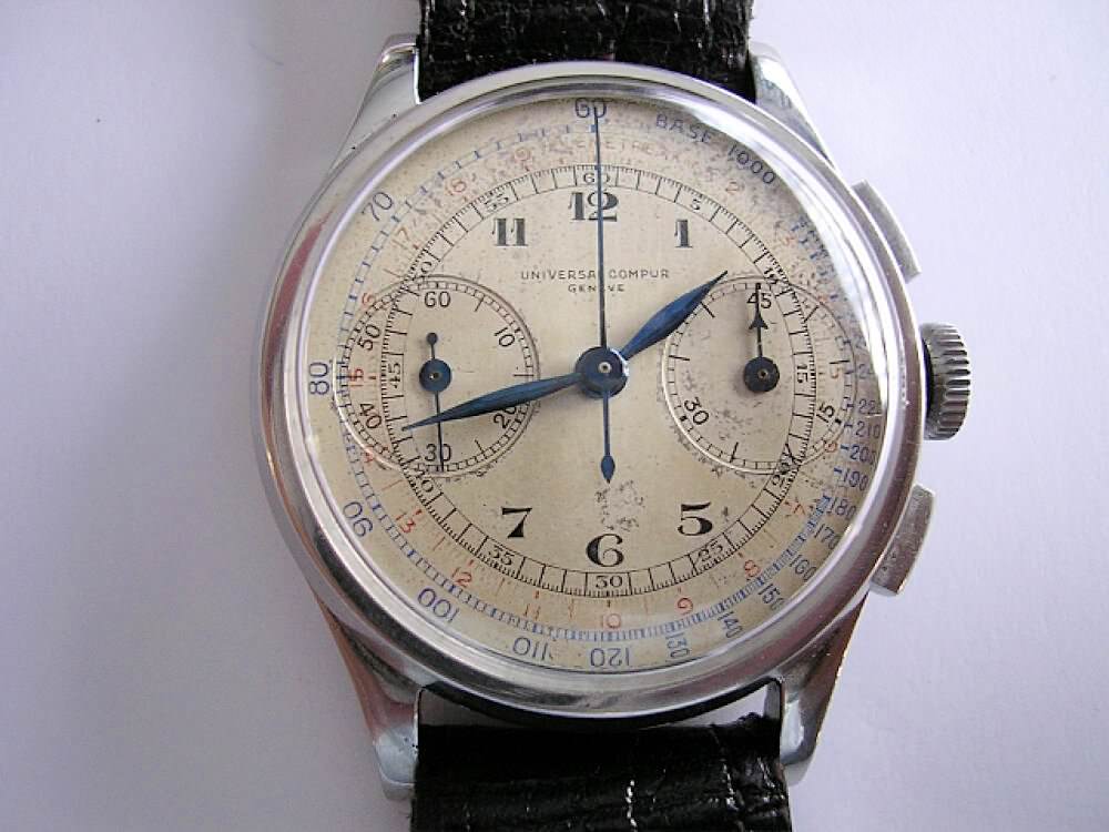

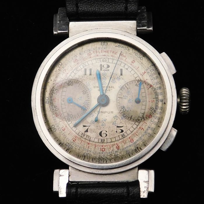

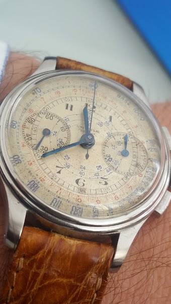

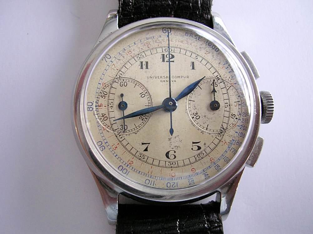

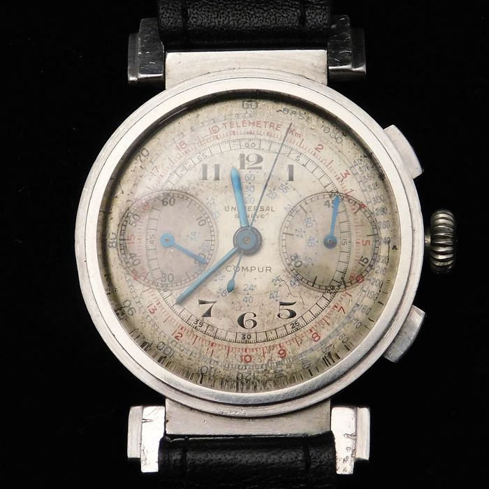

In general, Breguet numerals on Compurs are legit:
As you can see, shape of minute and hour hand is also correct.
So what may cause the "shortness" of the minute hand?
Redial. The first obvious telltale is the logo

Discuss what's wrong with it (apart from the price...)
That there are no movement pics nor from the inside of the caseback.

Subdials seem very wrong!
Exactly!
Not centered, wrong style.
But that's not all...

The auction just finished and this watch hammered at $17,350. I am keen to know what the Nina experts here think of this watch at that price.
I was watching from the sidelines and thought it interesting that the high bid didn鈥檛 move at all during last knockings. No late flurry, no sniping; nothing.
ouch, I missed the minutes not facing the correct way from 20 to 40
14,012
54,360
BINGO! I stopped at the logo.

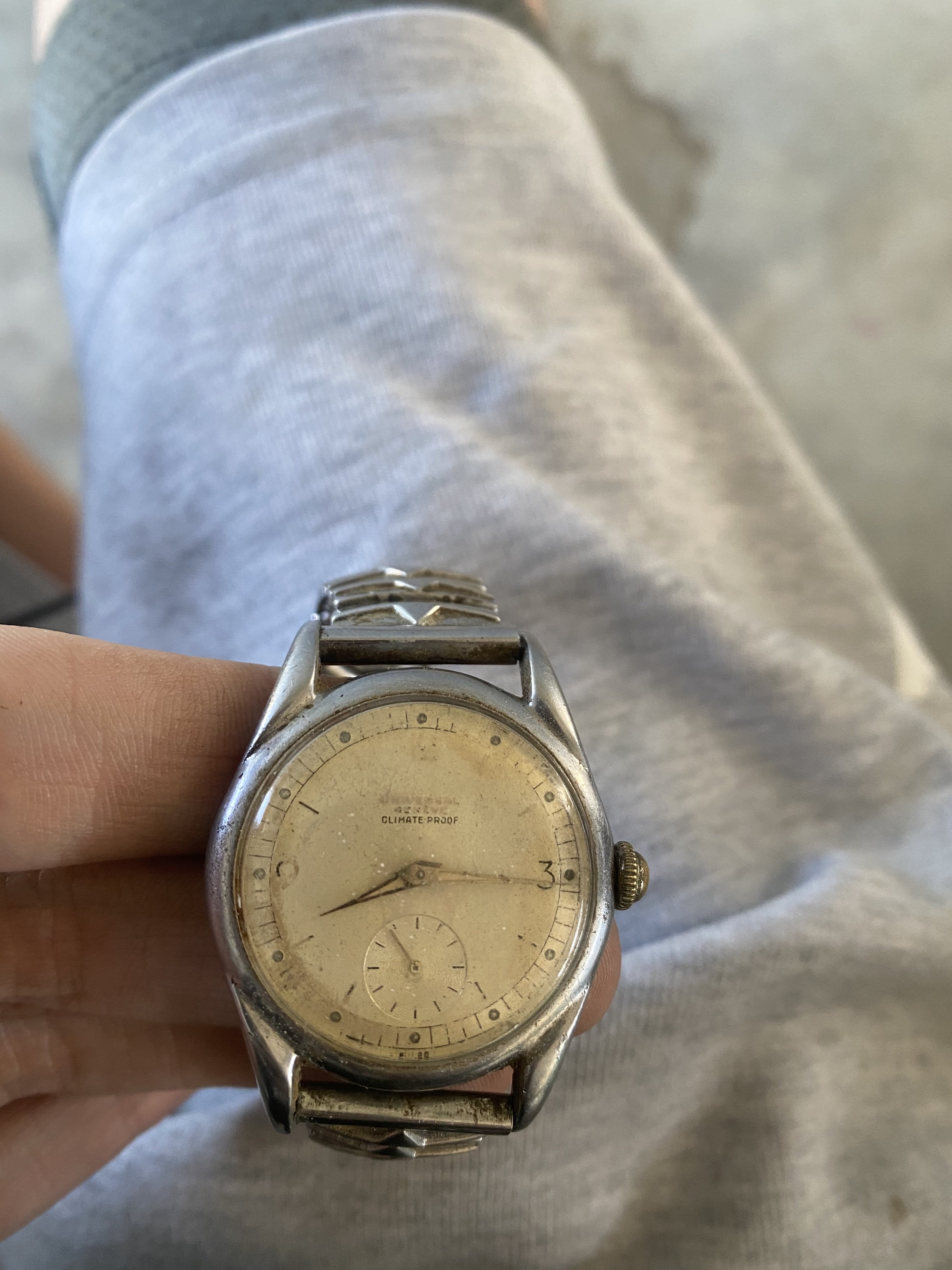

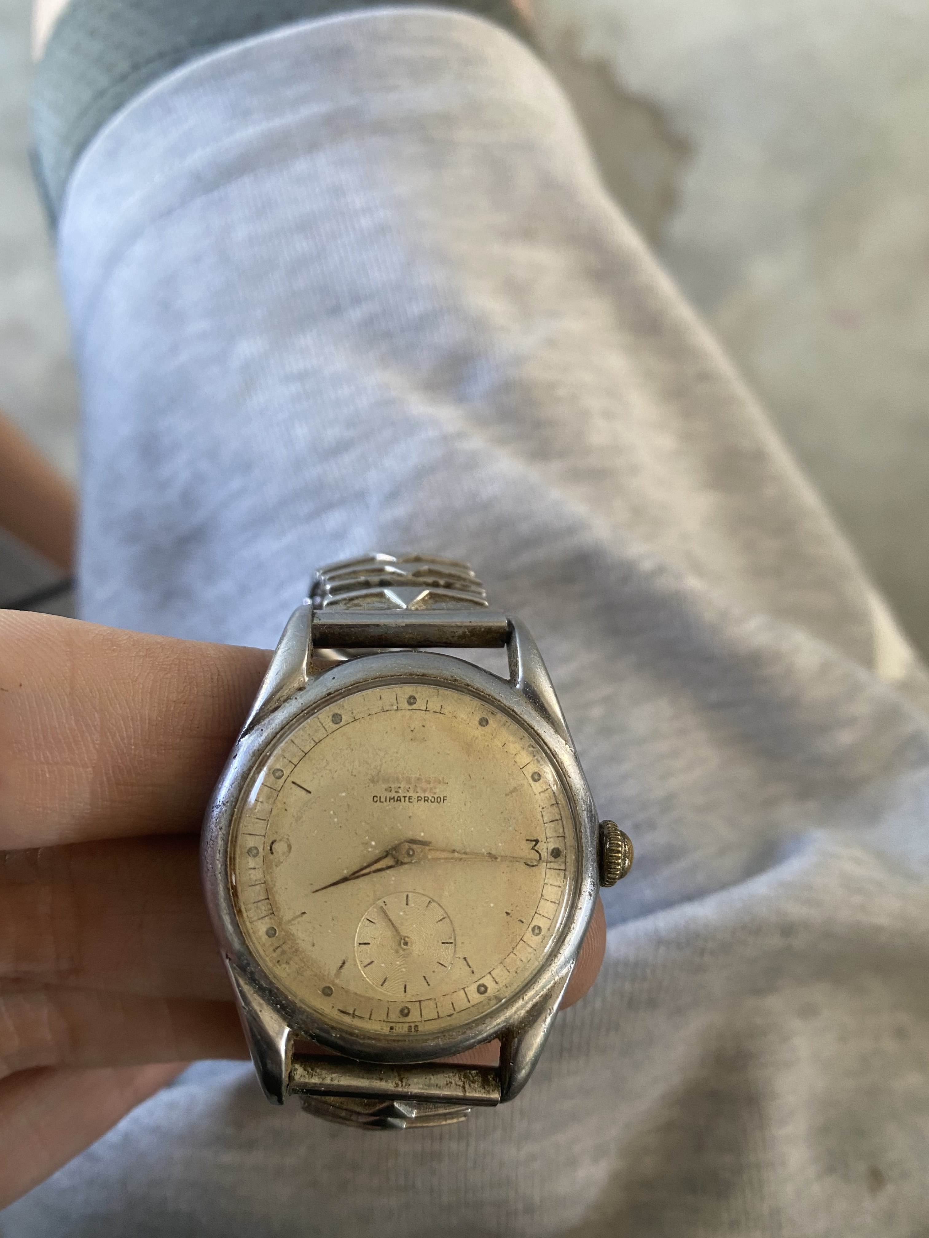

Got this off eBay an Added it to the project list.
That is the most brilliantly ironic dial lol
6,911
10,772
Hell yes. Not that proof ::psy::
