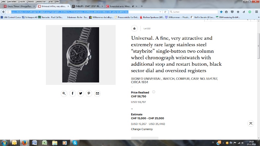

Universal Geneve Compur 1. generation at Christie´s
255
315
These 1st Series Compur are uber rare and historically very important as most likely the first chronographs with 2 pushers (or among the first, not 100% sure yet).
They are finally getting the attention they deserve. The fact that this example was in steel and with a black sector dial definitively also helped 😀!
FYI, these early Compurs actually work like a mono-pusher (start-stop-reset via the pusher at 2 o'clock) with the addition of an extra pusher at 4 o'clock to temporary stop and restart the chrono second hand while in use.
They were only produced for about 1/1.5 years back in 1934, then the "standard" Compur with Martel caliber 285 came out and they work as any normal 2-pushers chronographs that we see today (pusher at 2 o'clock start and stops and pusher at 4 resets).
2,958
6,309

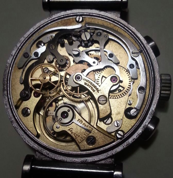

What does the movement of that watch look like? Does it have a designation?
255
315
No designation yet, as Universal (or shall i say Martel, the movement producer for Universal) only introduced movement designation, in the form of numbers, from the Compur second series, i.e. from caliber 285.
I have no picture at hand but I'll try to find some at home tonight. It looks very similar if not identical from the movement side to the previously used mono-pusher movement, the difference is on the dial side of the movement where there is sort of a second column wheel (kind of) that is needed for the added pusher functions.
The Universal Geneve book by Sala explaines it all in great details and pictures 😀!

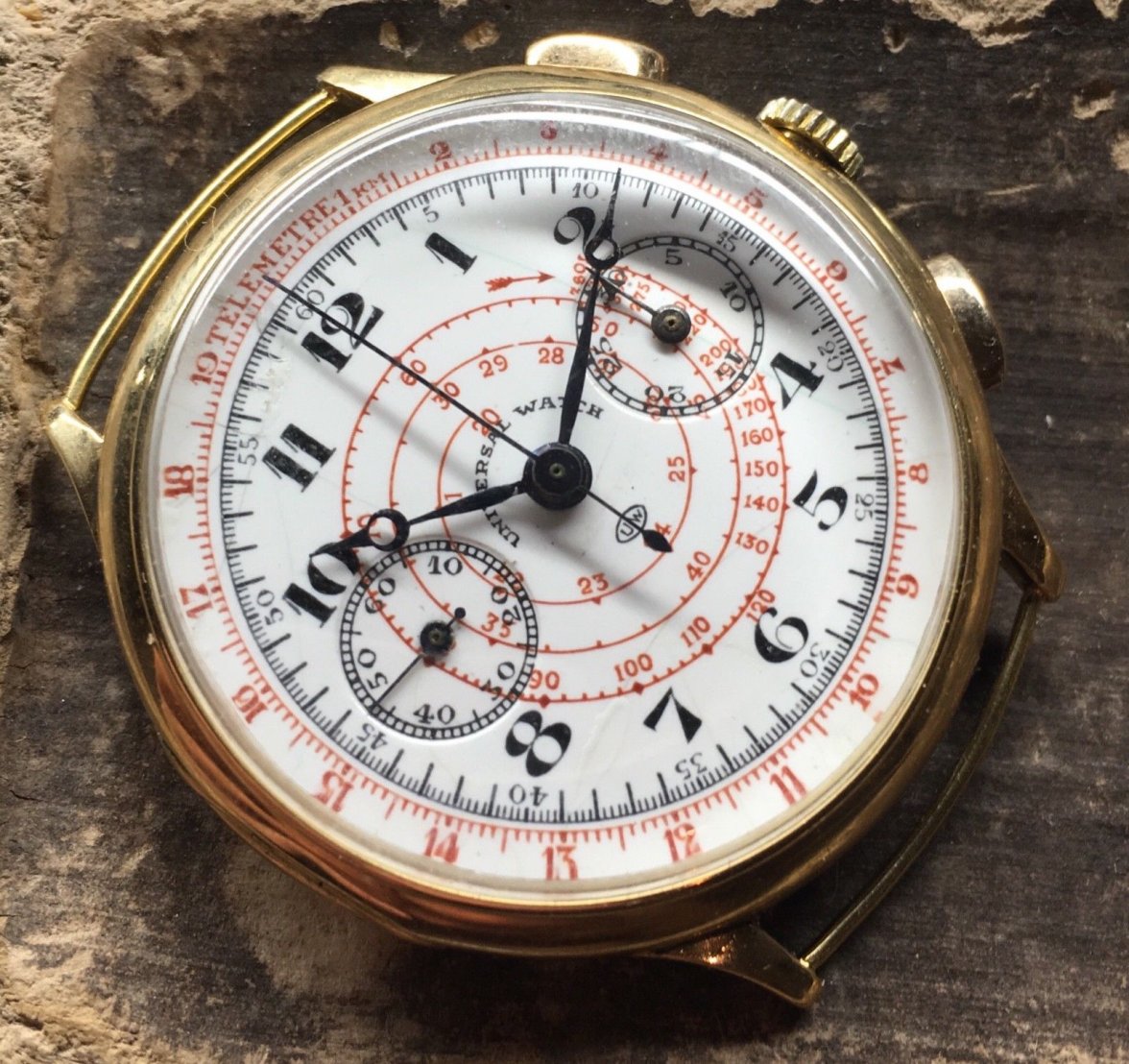

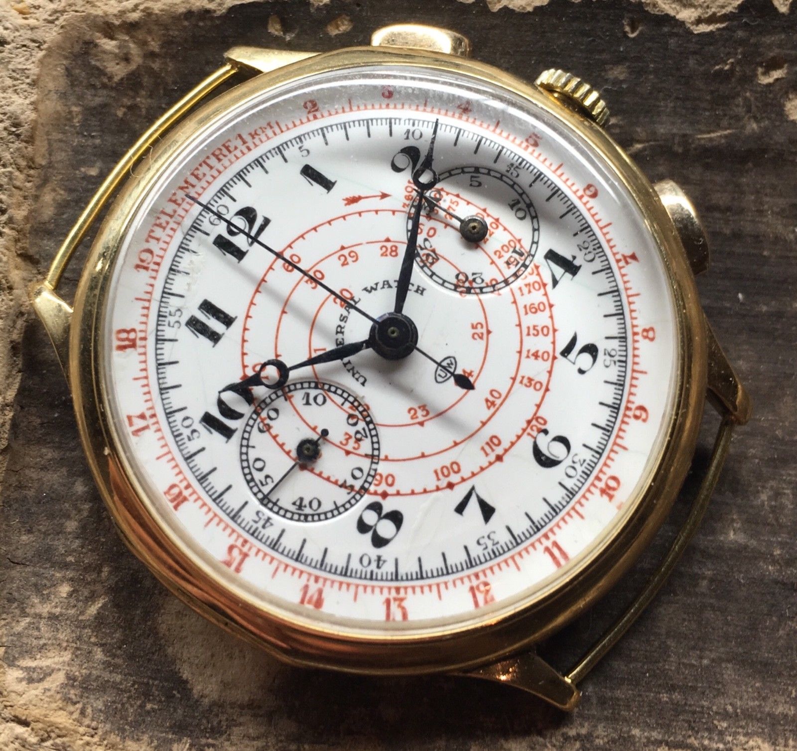

Can this still be correct 1st series, even without the "Compur" on the dial? This one is serial 552XXX
511
1,914
Not 100% sure. Maybe the enamal dial is a bit earlier. There were pre Compur onepusher models with Valjoux 22gh movements...
3,480
8,075
The example posted above by @nicola1960 looks like a very similar enamel dial, but it has the "compur" text, and the one I just posted doesn't, hence my question.
Also does anyone know if most or all of the gold cases for these 1st series Compur are Jeaneret ? Because the last two I randomly looked at are both 166 hammers, and that seems an unlikely coincidence?
