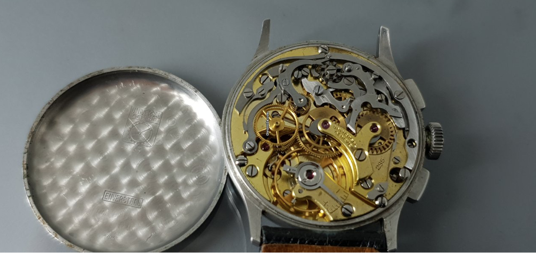

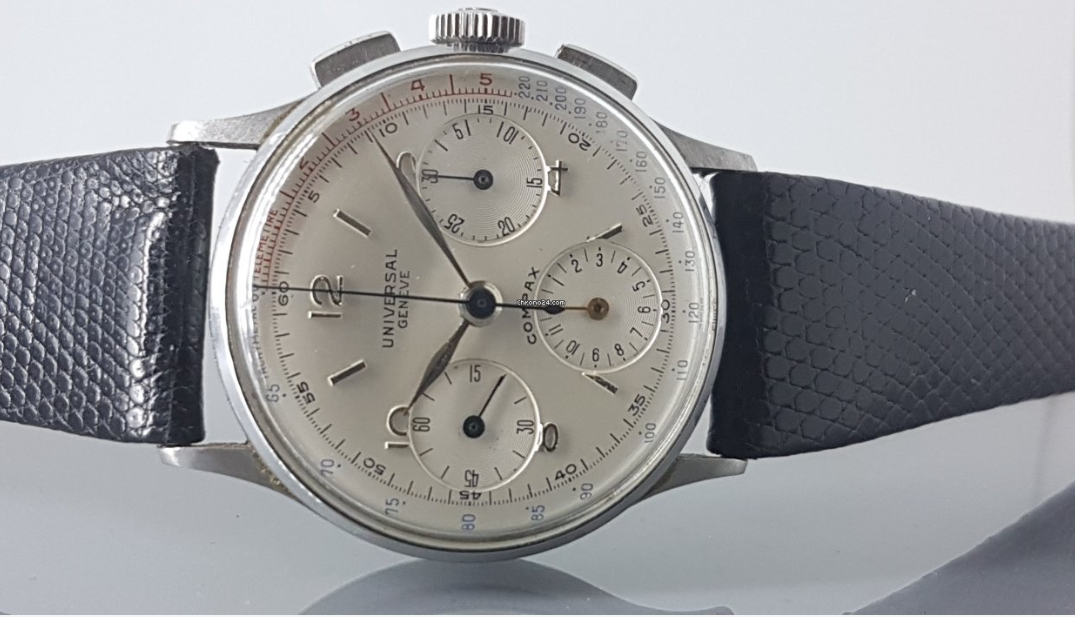

Hello, I would like your opinion on this watch please.
I am interested in buying it.
Is it a redial? Serial is correct for dial? Dial correct for the reference?
Thank you all.

The Universal Compax line has always been hard for me to verify because they have a tendency to use markedly different fonts between the dial, outside track, and subdials.
There's a 5 on the right subdial seems slightly off from the other subdials but I wouldn't want to stake any money on it one way or another.

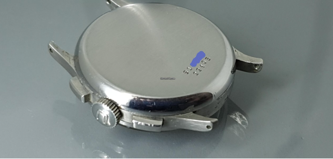

Serial dates the watch to 1942/1043.
Font on the dial is later.
Edit:
Crown is also later than 1940ies.

As @Oku already said, looks like later dial in earlier case. I tend to think of these fonts as 50s, although there is an example in Sala of this dial with a 48' serial (however I can't be sure that one is correct).
But OP watch hour and minute hands look wrong, plus the hour subdial hand, plus the crown, so when you add all that up.......shenanigans.
(I'm still not sure if this dial could be correct even with a 48' serial as seen in Sala, but that perhaps is a side research topic for another day).
Anyhow I would def pass on this watch unless it was crazy cheap.

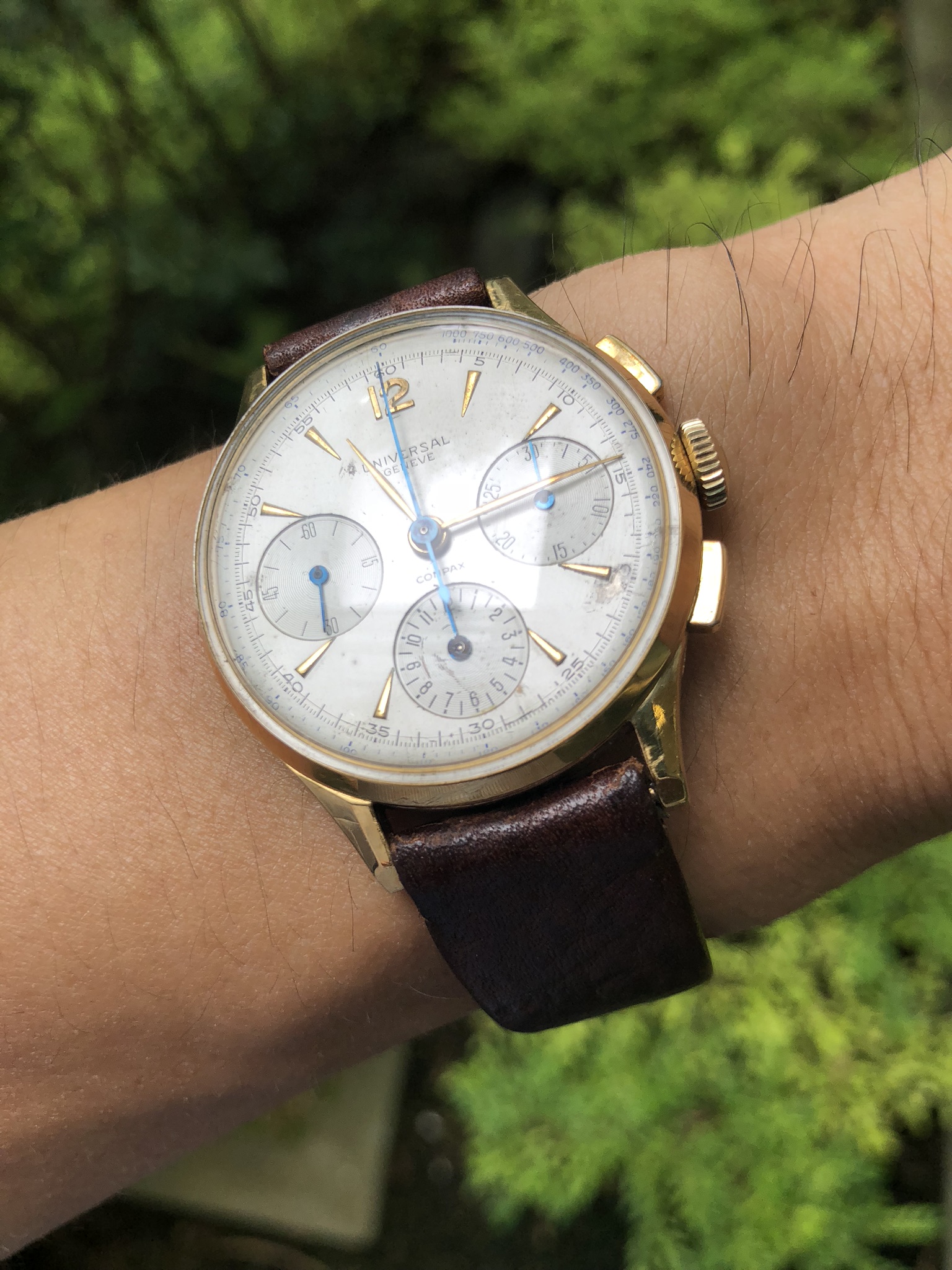

I got a similar one, always think it is later dial in earlier watch.
At least, yours has a consistent flat 3 in the hour subdial...

2800 Euros is not so crazy cheap imho
Whatsoever, to come back to one of the op's initial questions: the dial itself does not look like a redial but seems really well preserved.

Very puzzling. Mixes fonts ....
13,905
54,078
Price is an indicator that not all is well.

That was always a red flag to me as well but I've seen so many Compax variations over the past year or so of looking into them that I struggle to know what is correct, so I've compared fonts within types, like subdial to subdial and track to track.
Did they mix fonts on the dial ever or no?
13,905
54,078
They did lots of things. Not all are documented. Usual tells indicating redial, overall sloppiness are not here.

Hmmm, maybe it’s just a reflection but it looks like there’s some white paint on the sides and atop of the hour markers?
