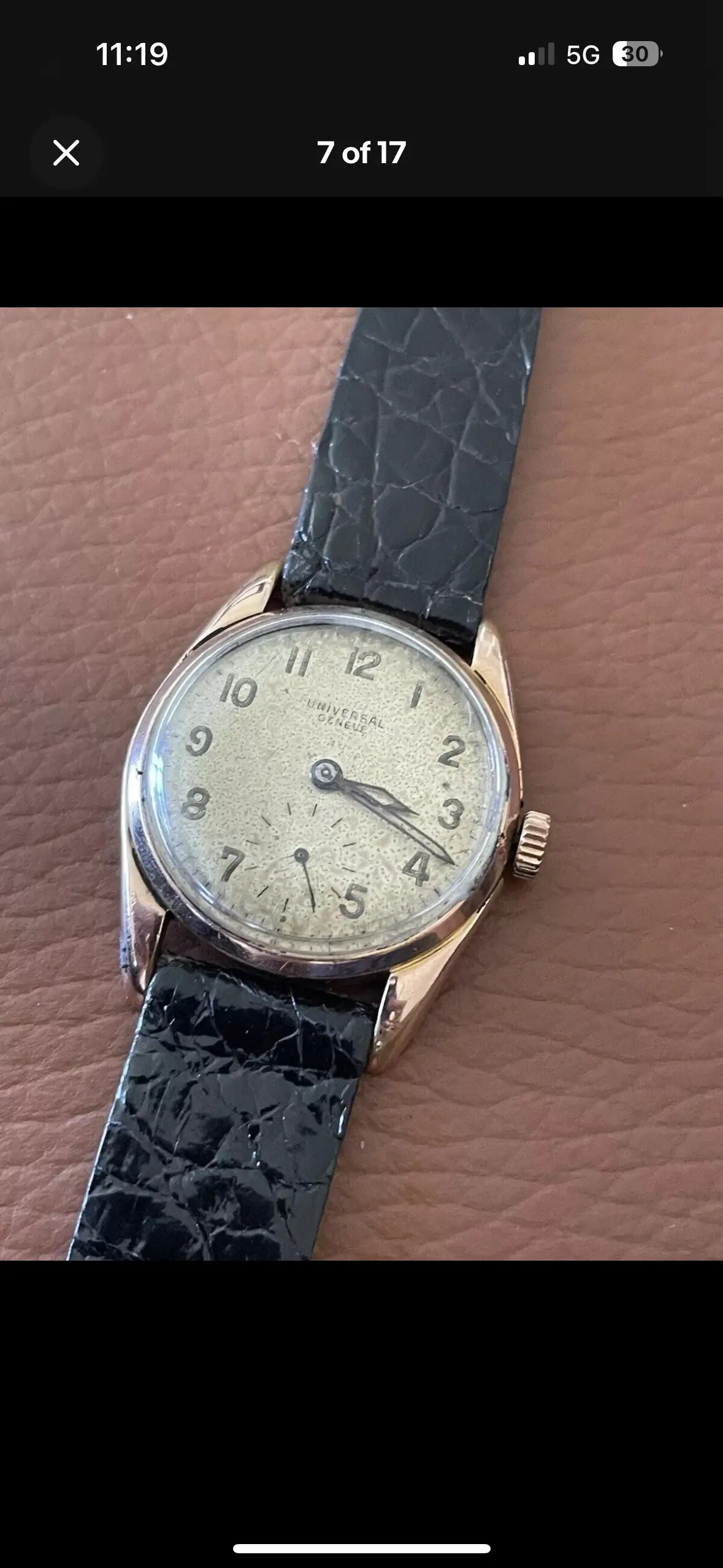

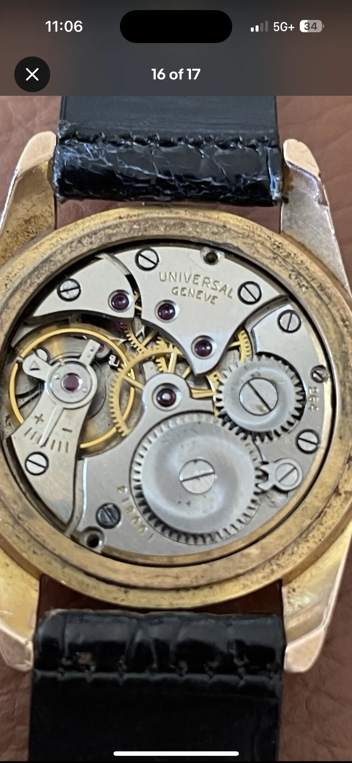

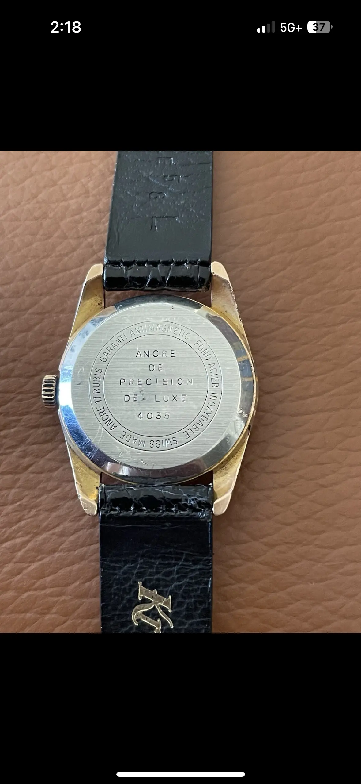

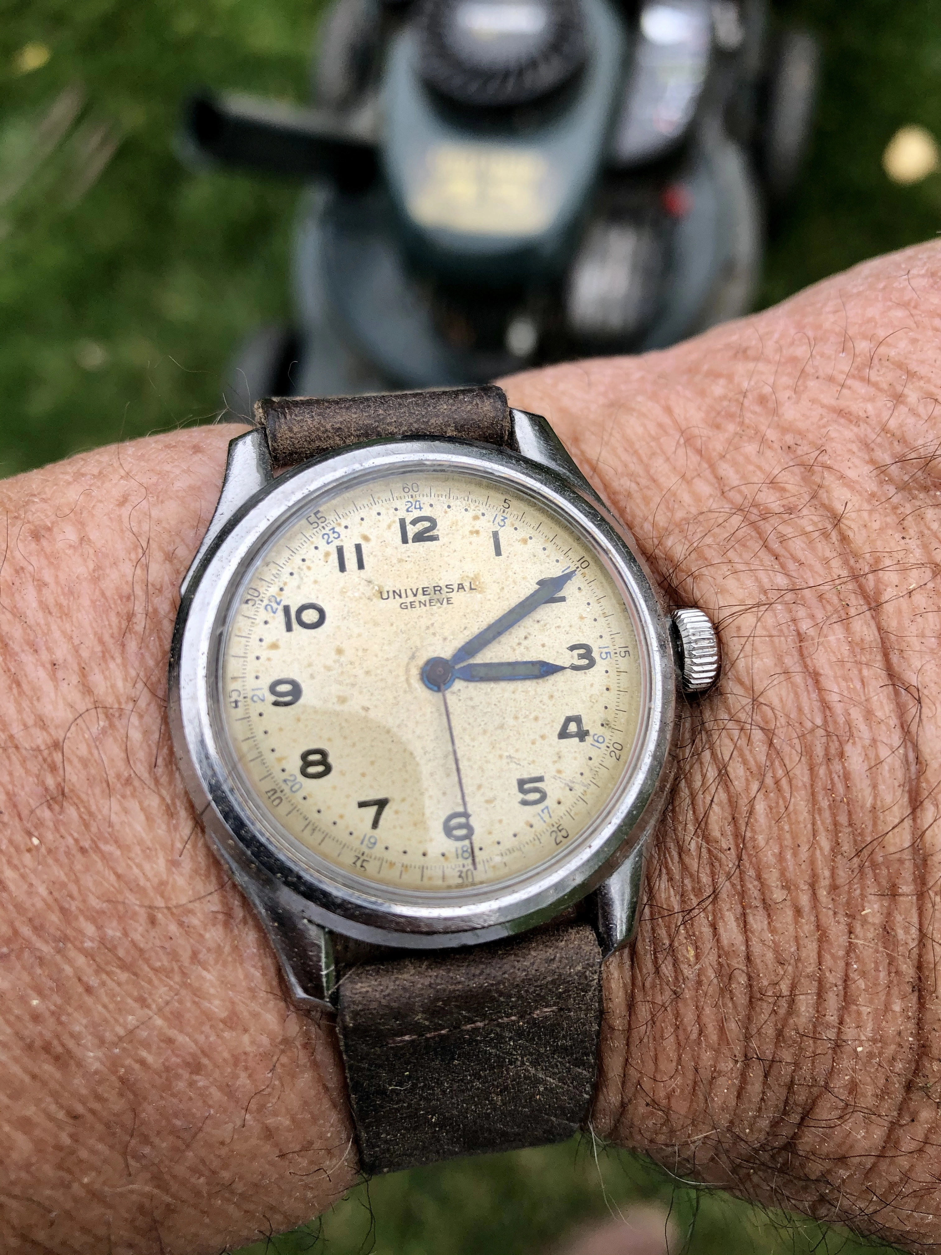

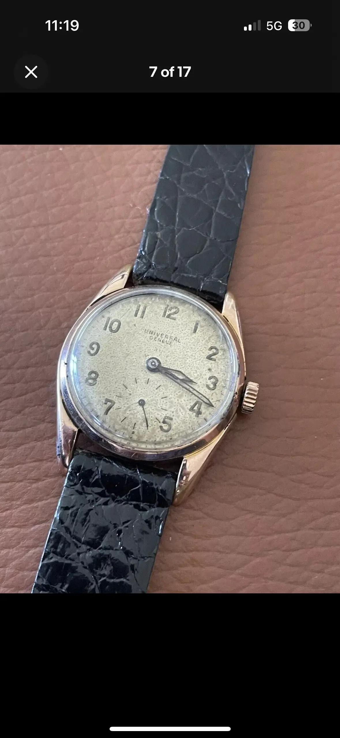

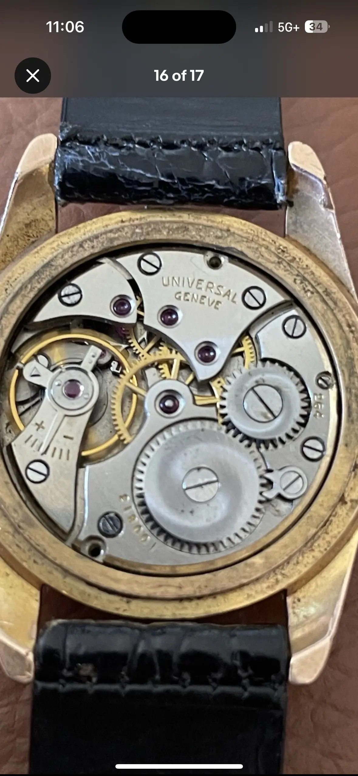

Not sure if recased can’t find much on the 264 movement the case back looks a little off to and the serial on the movement makes it more confusing no clue on date either will get some better pics shortly I know the radium on the hands is mostly gone too

Recased for sure … too bad … I like the dial and movement. Hate the case.

Any idea what case this is supposed to have or a production year would like to make it correct

Dont bother I’d say

Any chance you could elaborate a little more as to why. Just curious just getting into collecting and fixing

Poor condition and unoriginal parts - exactly the opposite of what you want.

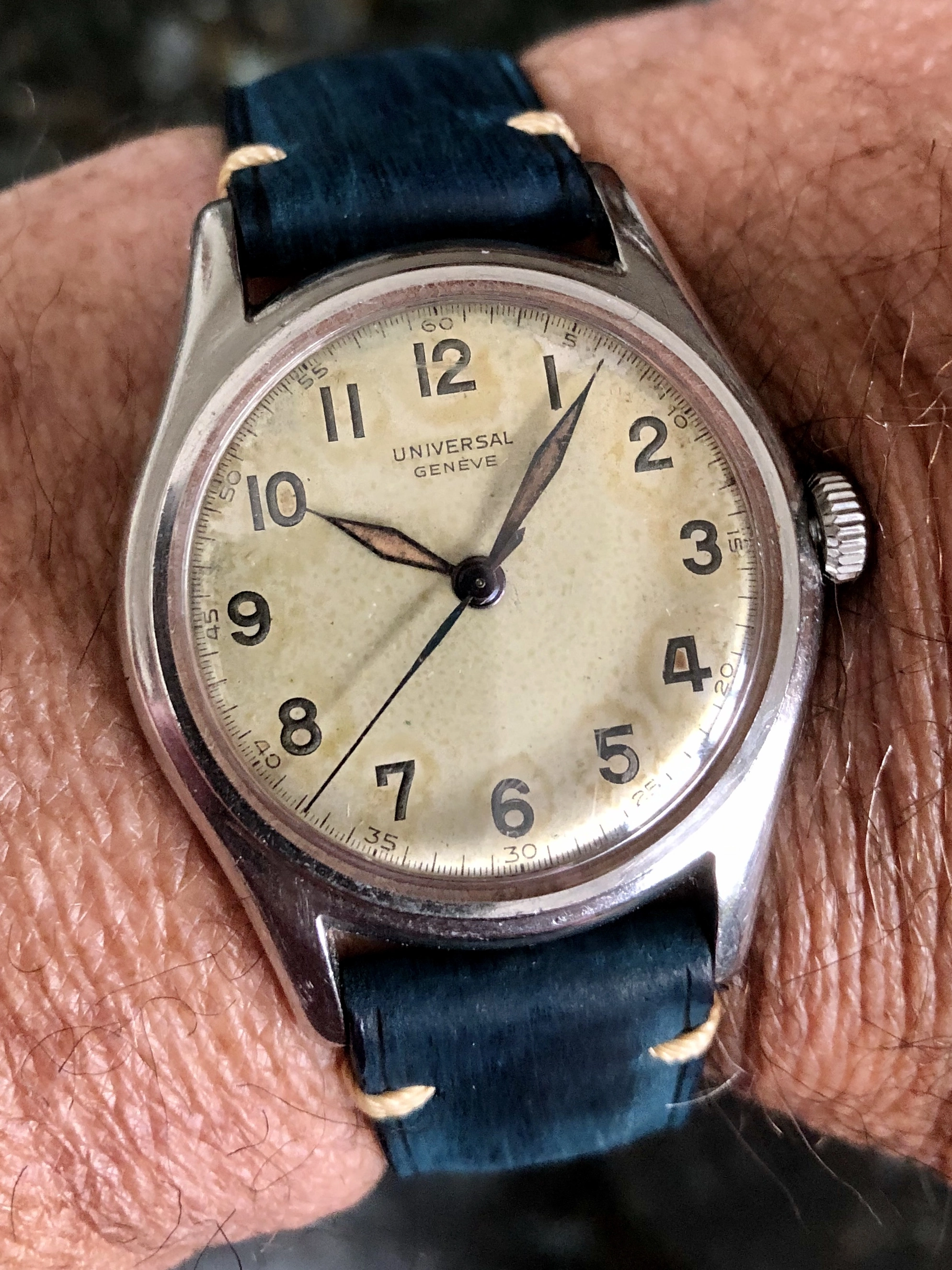

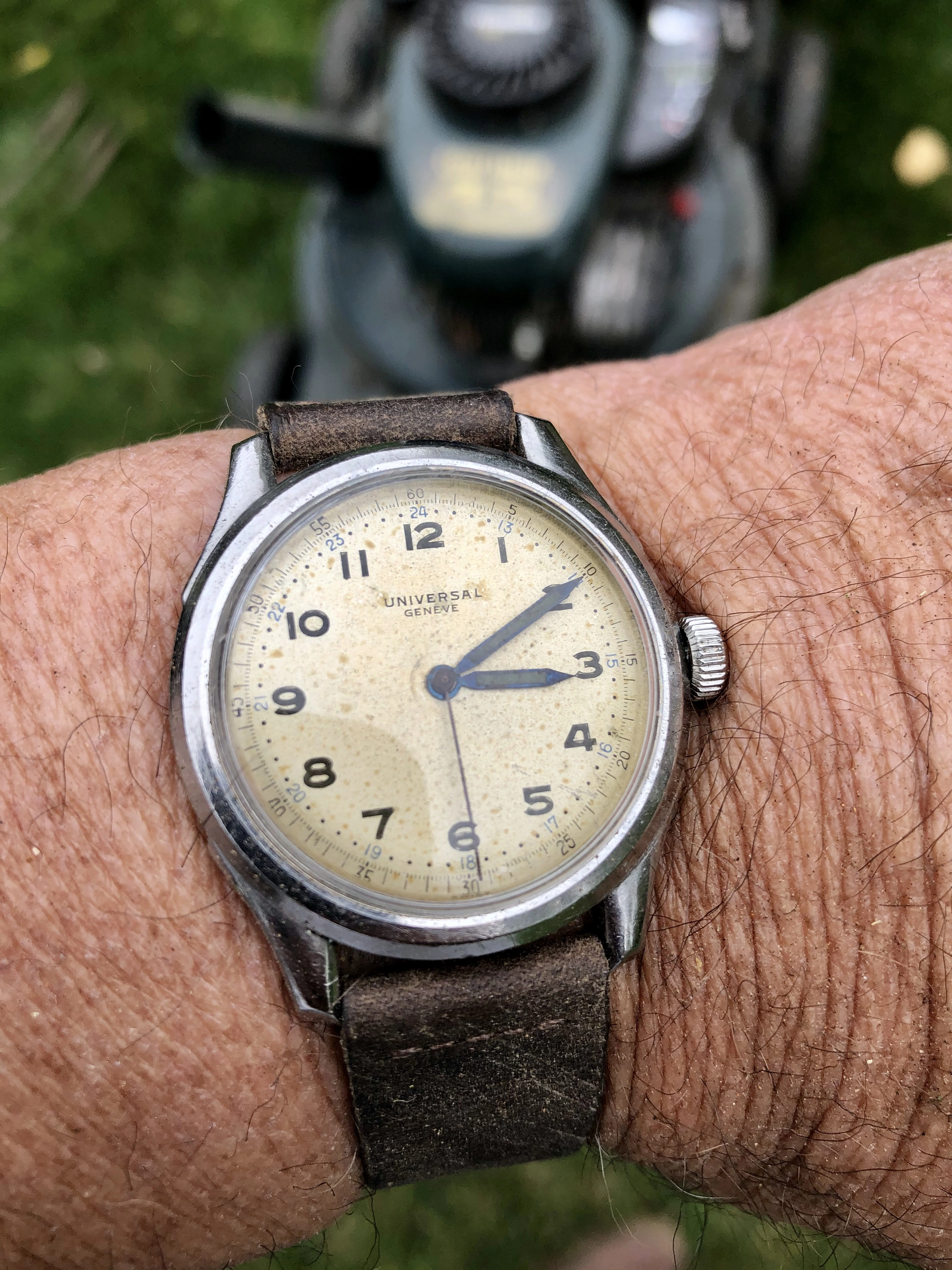

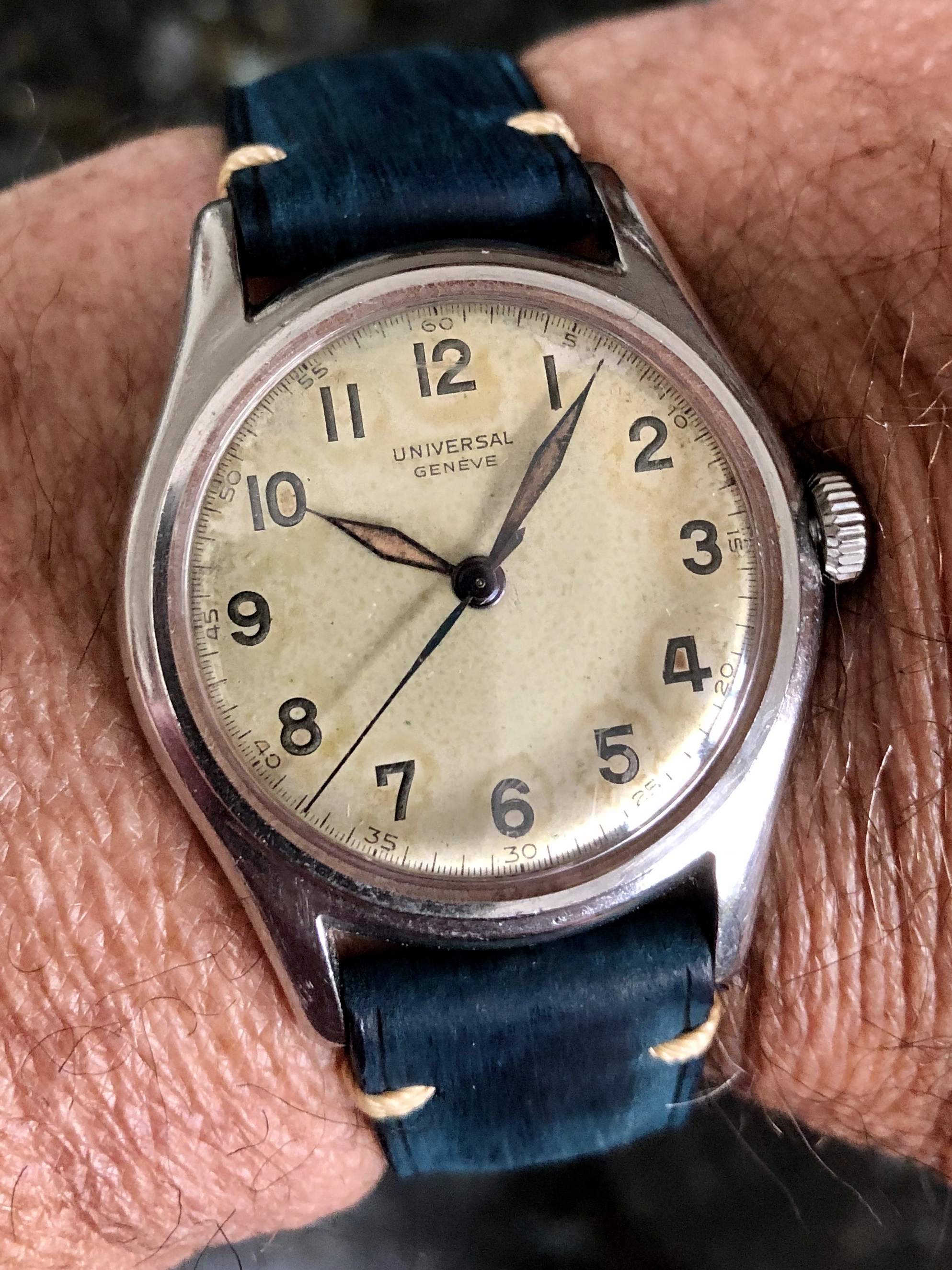

Field watch with an SS case most likely. References in 3 hand are not well documented. 1940s …. You really need to learn more about this brand before you start buying them. Here are two that I own. Not this caliber. Outdoorsman was the model. Various references. As I recall, this hand config. Is correct but this mess is not worth your time or money.

The upside is not there.

You're lucky I'm in a good mood:
First column is reference, second serial. These are the 100.xxx movement serials with 264 I know of. Good luck......

Outside of the case what appears to be not original just trying to learn more

Please forgive the ignorance probably in over my head but got to start somewhere

It's probably worth 40-50 quid but only to someone who needs a loose movement or hands to complete a project.

Shame this thing is keeping time flawlessly
That’s because it’s a great workhorse of a movement.
