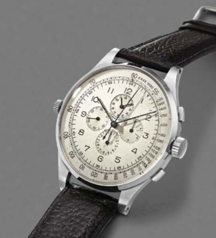

I really cannot see any reason to doubt the dial. Sure it's a unique cliché given the size of the watch. Most possibly a military watch made in the mid 1940s with radial counters for added legibility. This example went for sale at auction many moons ago.. unfortunately I cannot remember the exact auction... just have this picture...

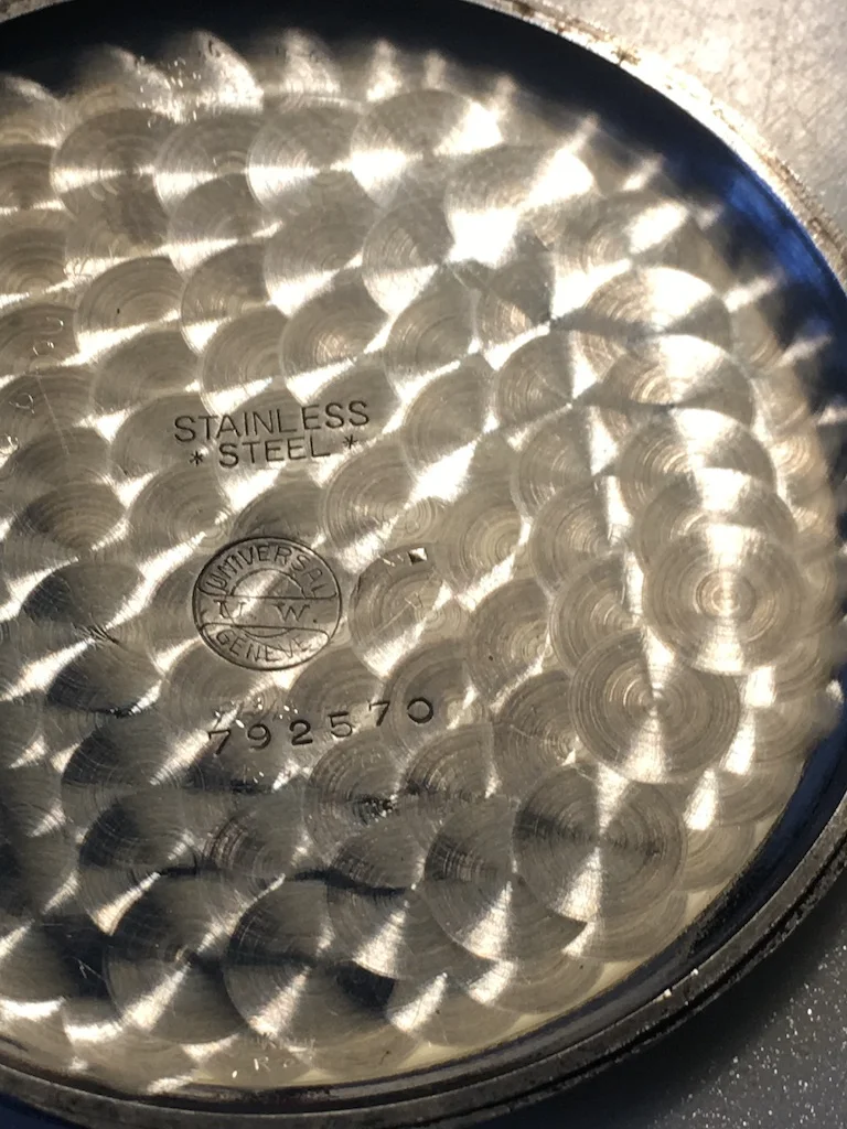

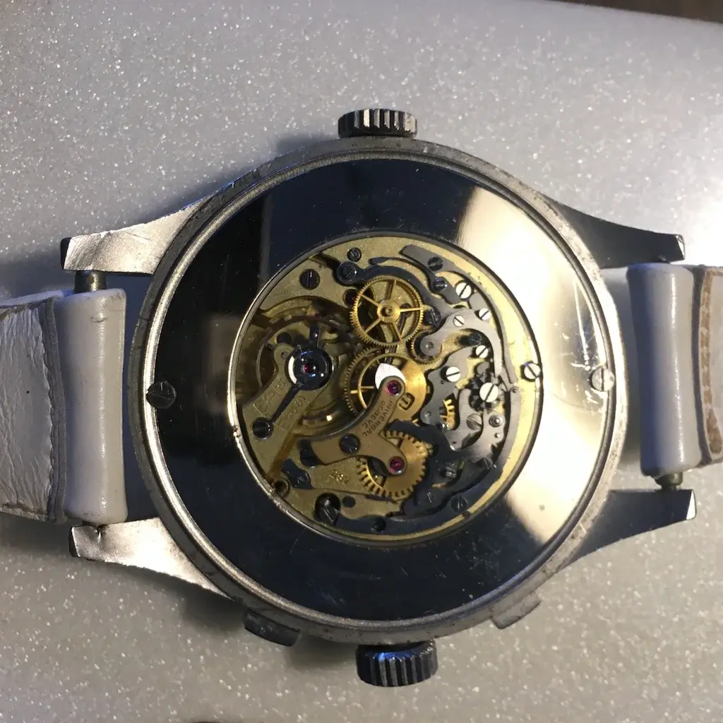

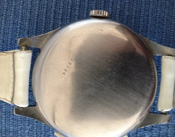

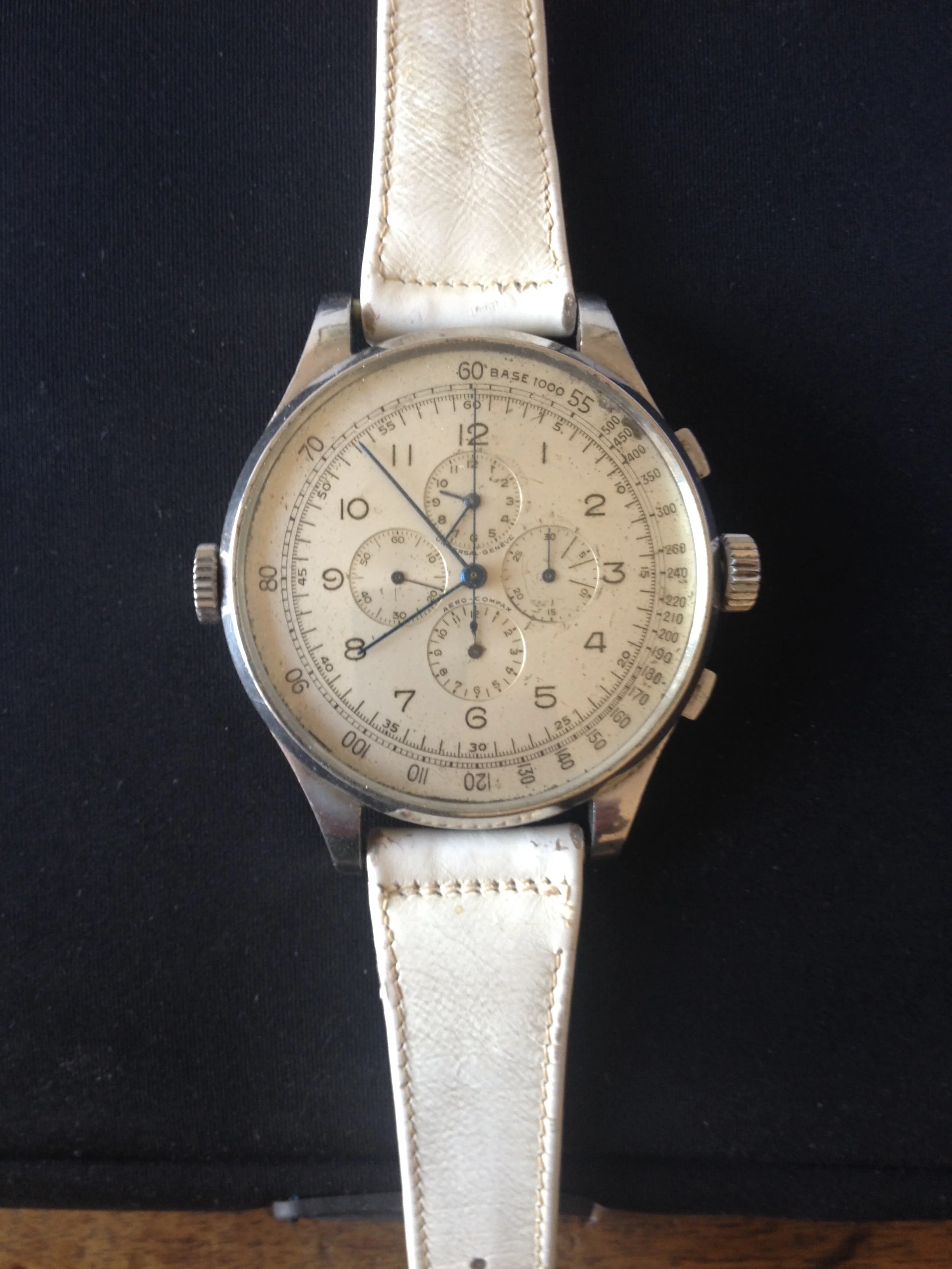

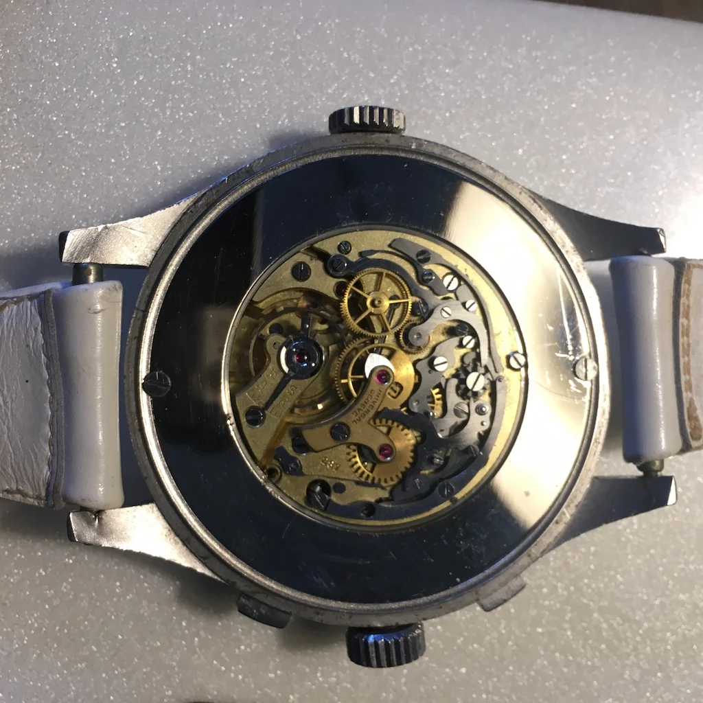

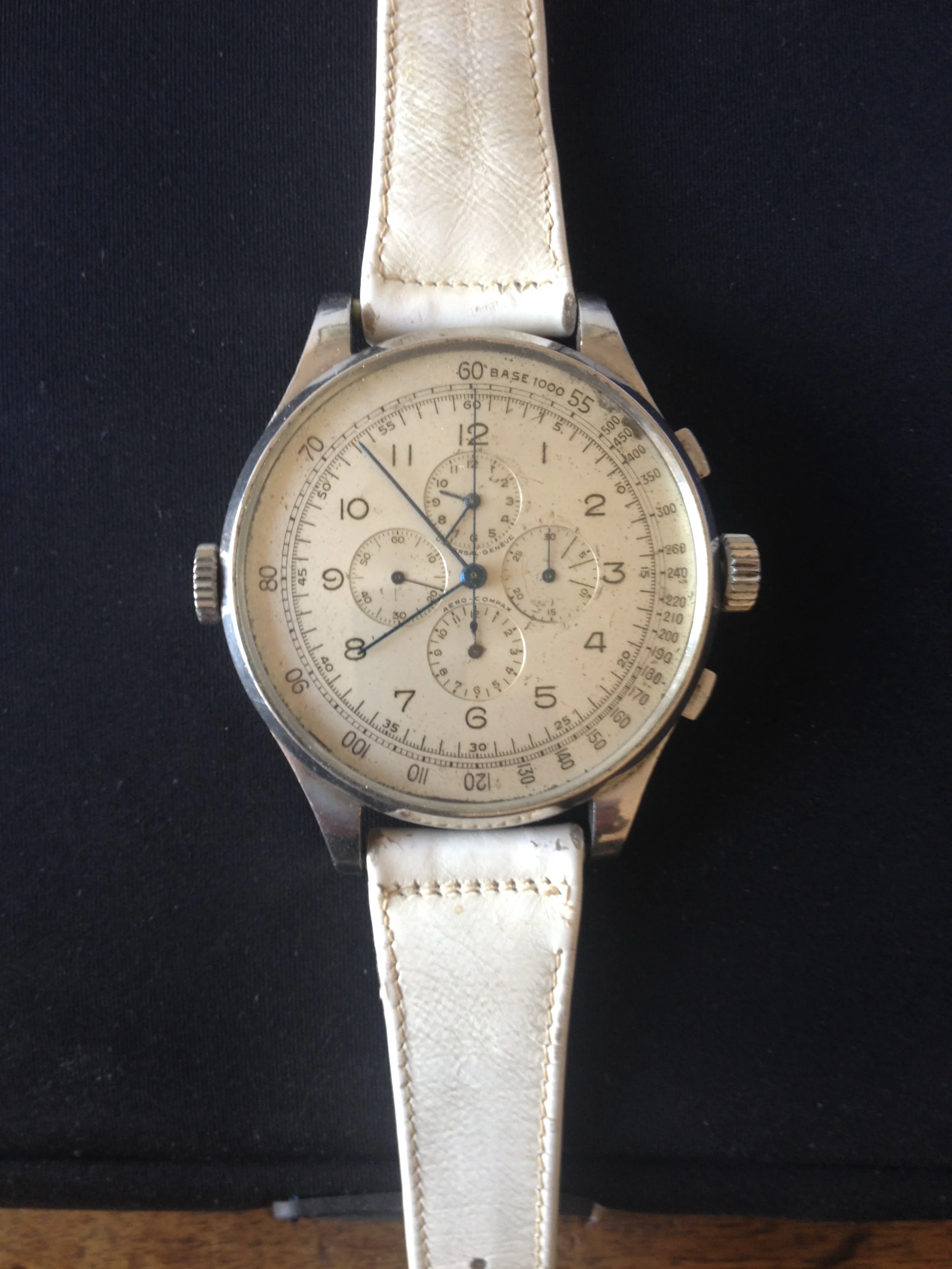

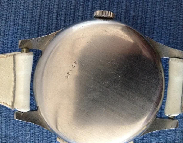

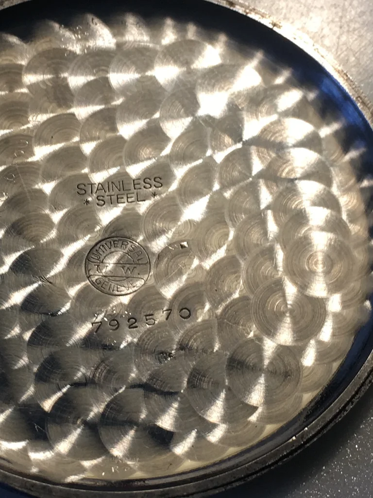

I know about 22424 I have one ! it was my father's and now it's mine......look at the photos.
6,902
10,765
Wow. Fantastic!!!
3,717
8,552
Amazing watch !! And a family watch on top of that! Thank you for sharing it here.
