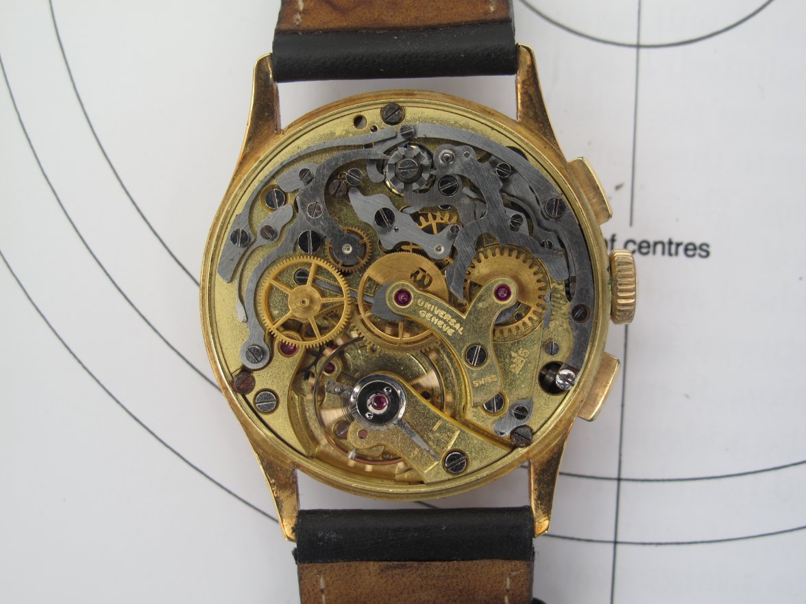

I think the "mint" descriptive is used a bit too loosely with this watch. The seller does have great photographs to compensate tho.
Has anyone seen a UG movement that has hand inscribed information on it, ie. 17 jewel unadjusted, etc.?
I'm also asking this, not implying, when did logo signed crowns come into use? With most of the other brands that I've experienced it seems like the 1950's and forward.

I am not a Dato Compax expert, but I have concerns as I don't find any cal. number on the movement.
Yes, UG and many other manufacturers. Typically, this hand etched information was added to movements for importation to the United States, and addresses information which determined the amount of import tax. Unsurprisingly, the markings are usually in favor of a lower tax - "unadjusted, etc."
What's your concern? It can't be anything but a UG/Martel movement, marked or not.

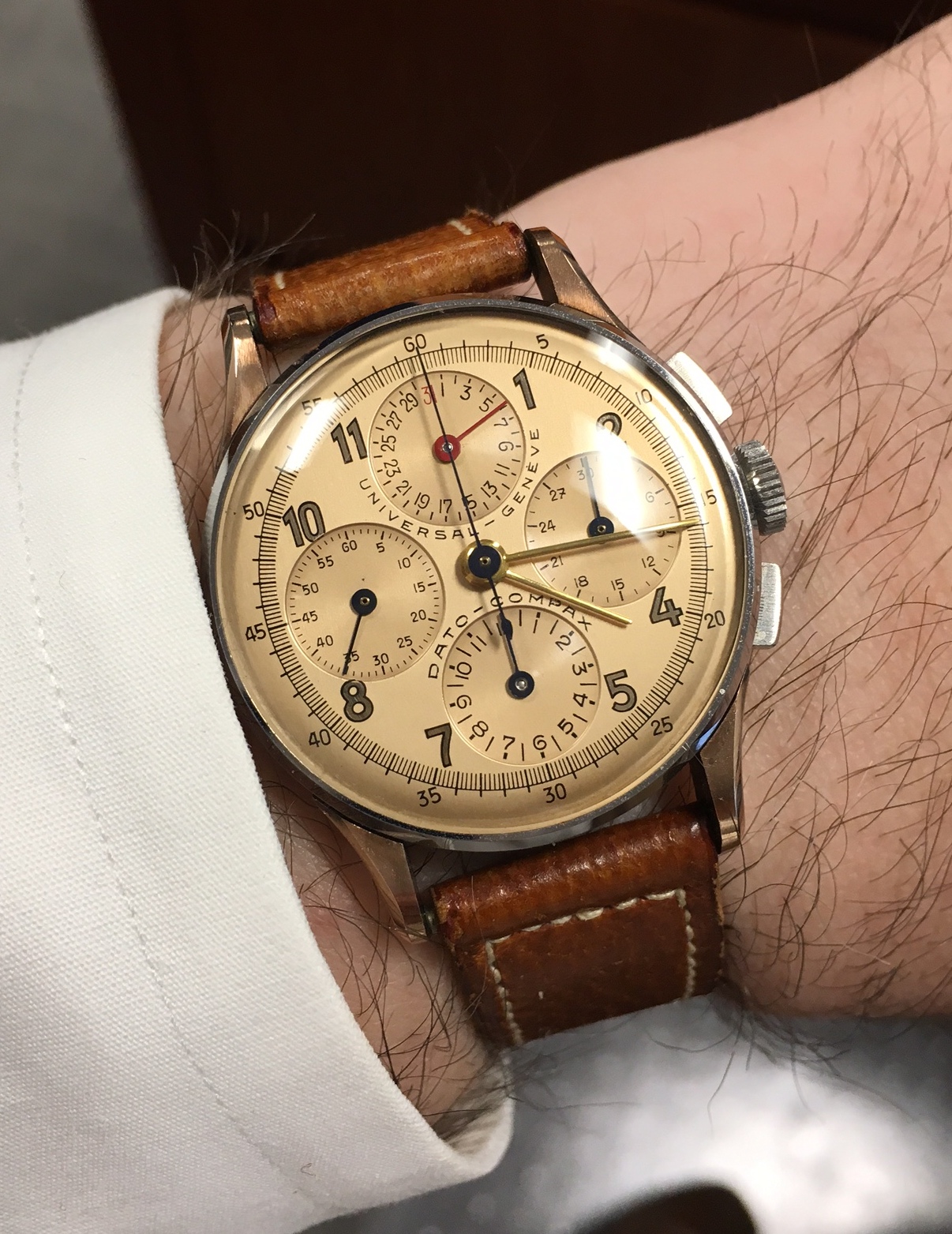

This is what 32mm looks like on a 7.25 inch wrist. It takes some getting used to.
Did UG use movements where the cal number is not on the movement?
As I said, I am not an expert but I haven't seen that before.

Yes. These movements are not like Valjoux or Lemania calibers, supplied to various producers. They are UG's own - actually Martel's, but at a time that UG had an exclusive relationship with them. They are the only movement that can fit the watch.

Yes I know that UG used Martel movements. But Martel also supplied Zenith with movements (146, 156 etc.).
That's why I was suspicious because Zenith usually had the number on the bridge and not on the plate like UG where it is missing here.

The movement of the watch in question is labeled Universal Geneve (although the US import code is gibberish as far as I can tell), and carries a UG serial number, blacked out in the image. There is precedent for UG movements to not carry a caliber number.

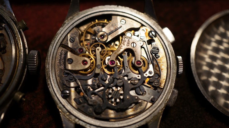

I would have dismissed a hand engraved movement like that on one of the big makers out of hand. The only time I have seen it is on smaller brands, usually upstart companies just post ww2.

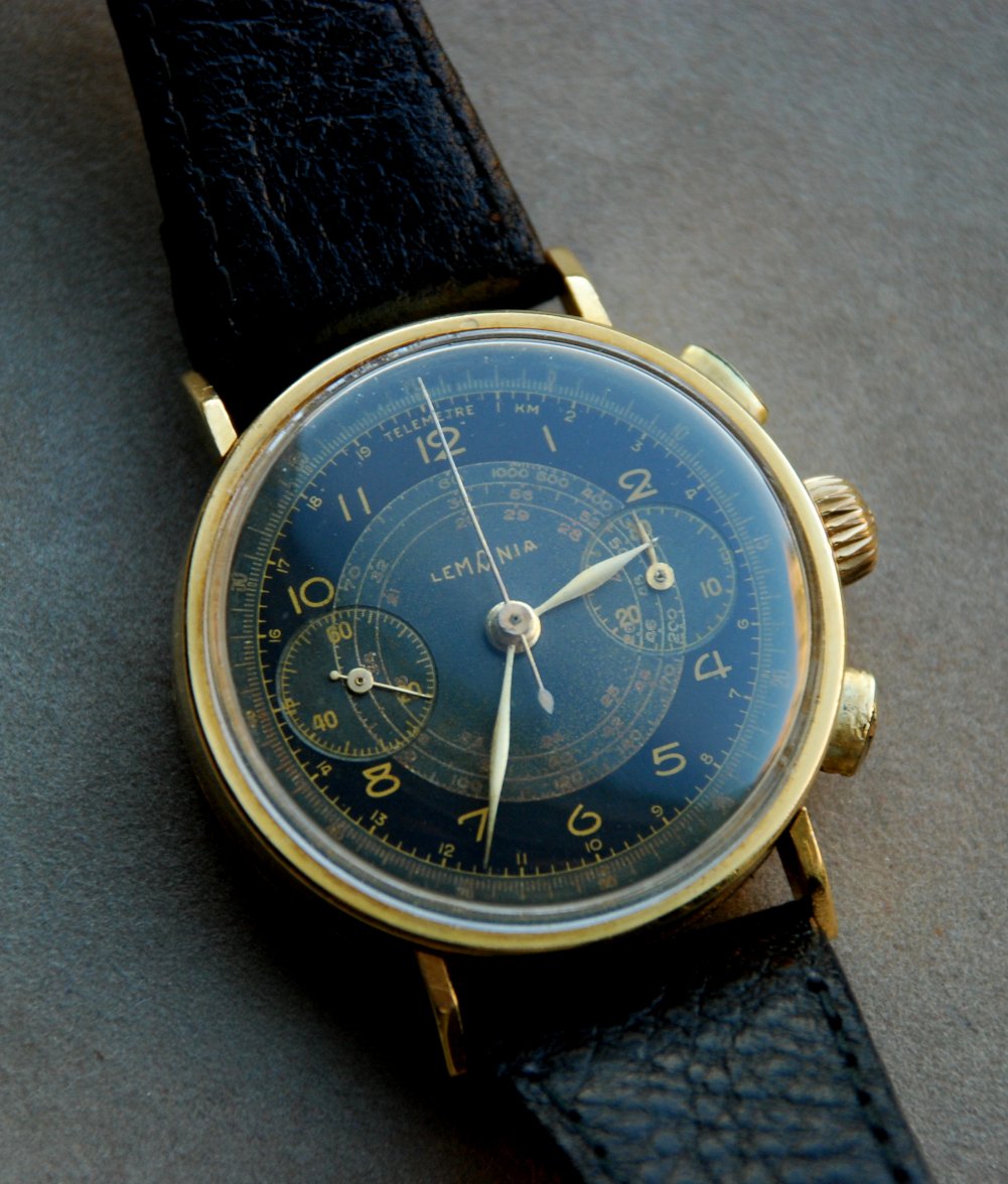

I have a number of these engraved movements in the collection. I love 'em as they scare off a lot of bidders.

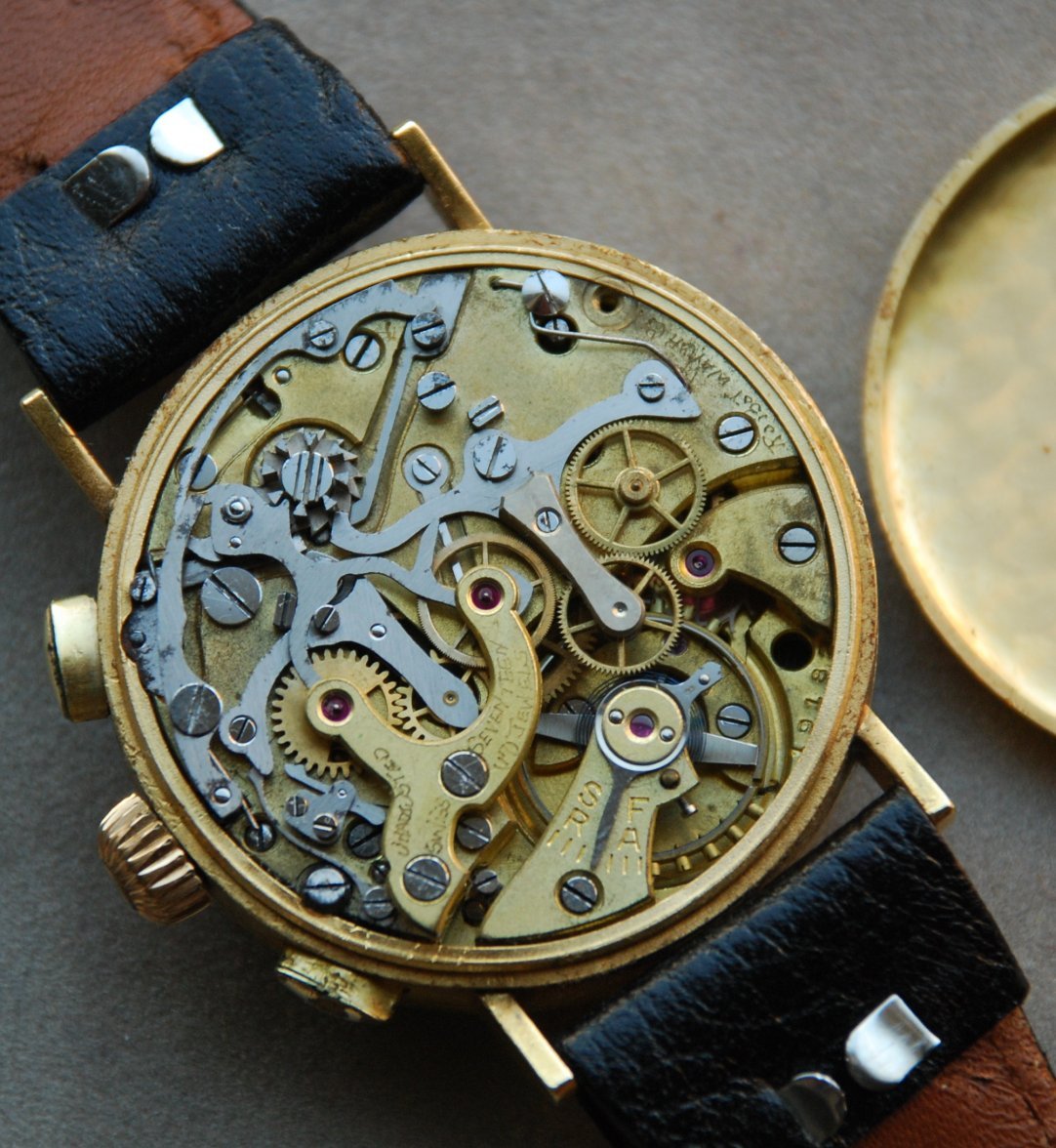

Here's just one that comes to mind easily - a Lemania cal 15TL - no upstart, and quite a respectable looking watch

Upstart only in the sense the Robot Watch Co was one a gillion small companies US GI's started after WWII with 100% gov backed loans.
Watch companies were just one category.
I've a Robot etched EP4.

Wondered about that. I assumed it was an american registered importer - now I know the context!
