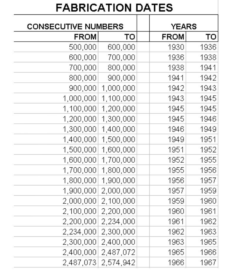

    Universal Geneve Logos
    Serial Numbers

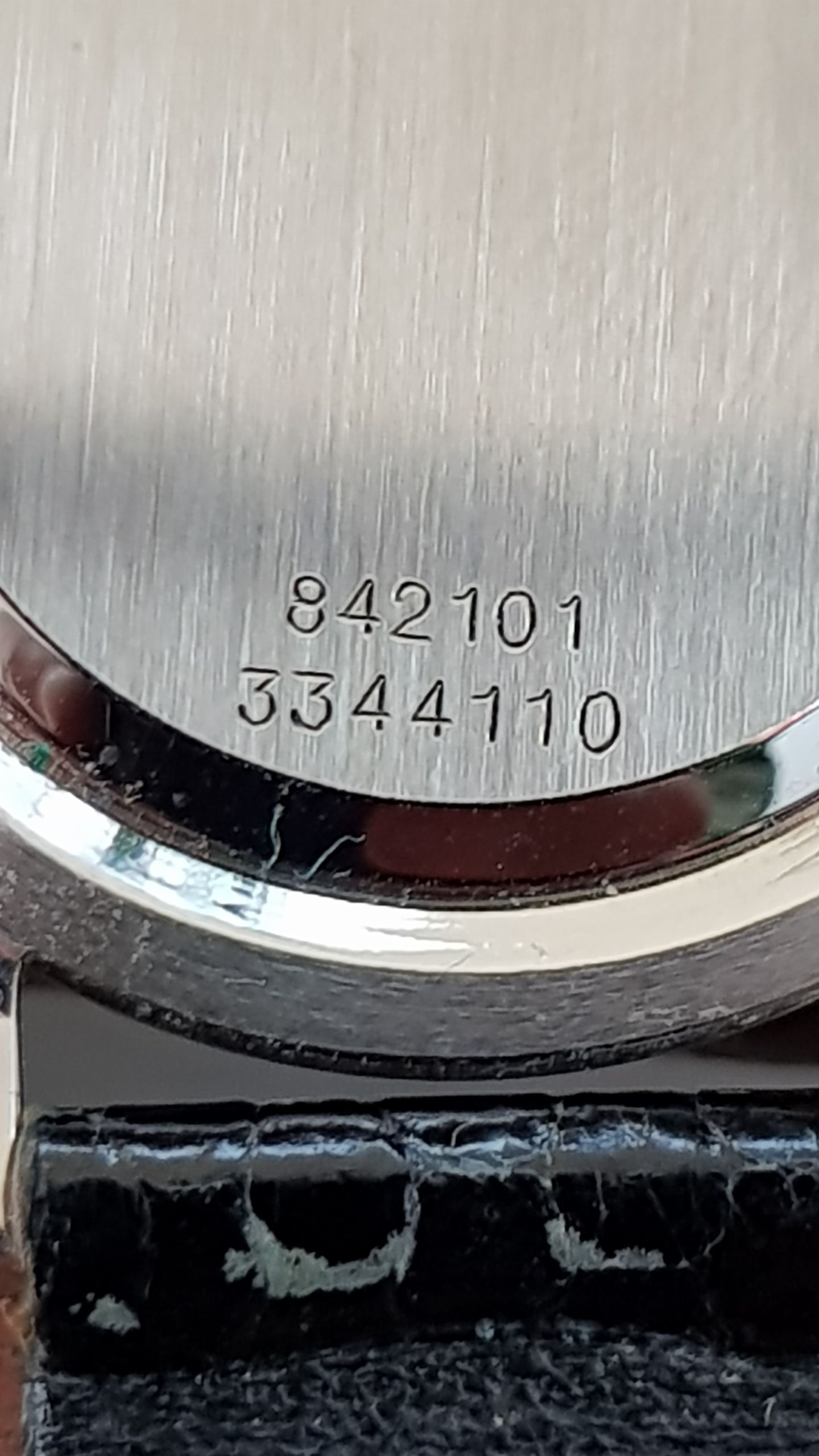

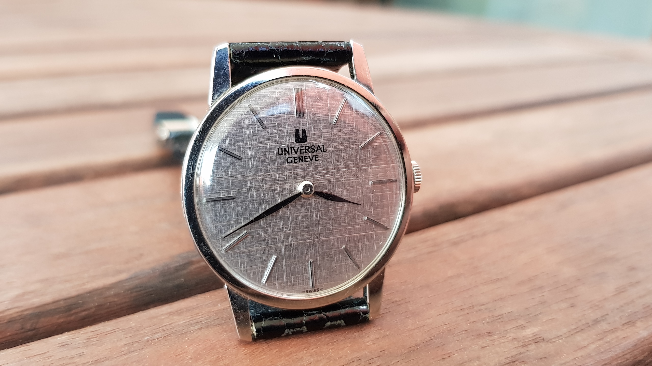

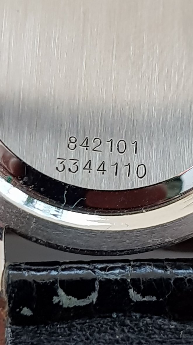

    Hi Everyone,
    does everyone have any updates on UG serial numbers past 1967 or > 2.500.000 ?
    I just got a lovely dress watch with serial number 3.344.000 that I am trying to identify the aproximate year of manufacturing. I will have it opened next week so that the caliber may also help but in the mean time I just ask in case there are more up-to-date tables ?
    thanks.
    regards
    Roby

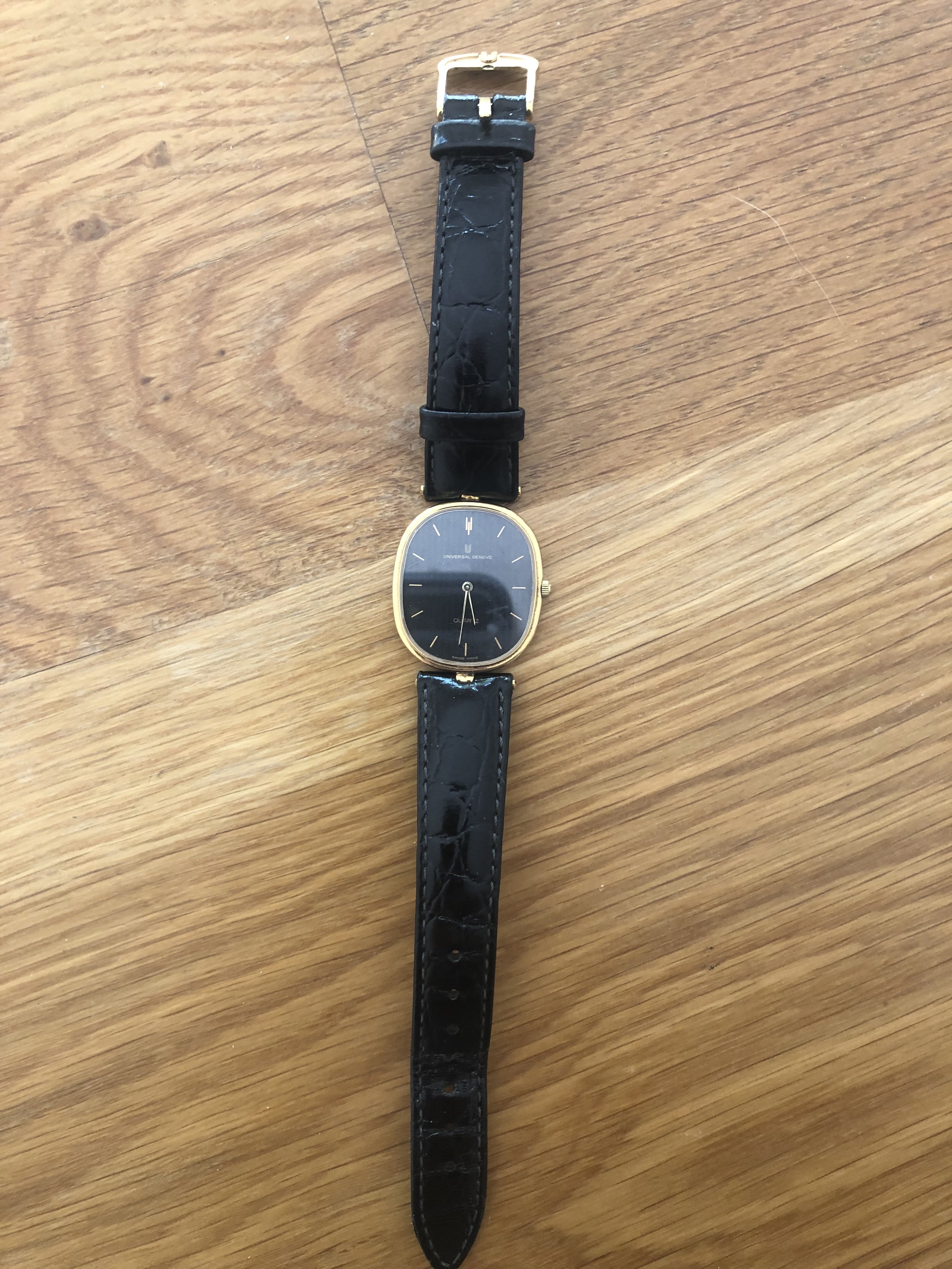

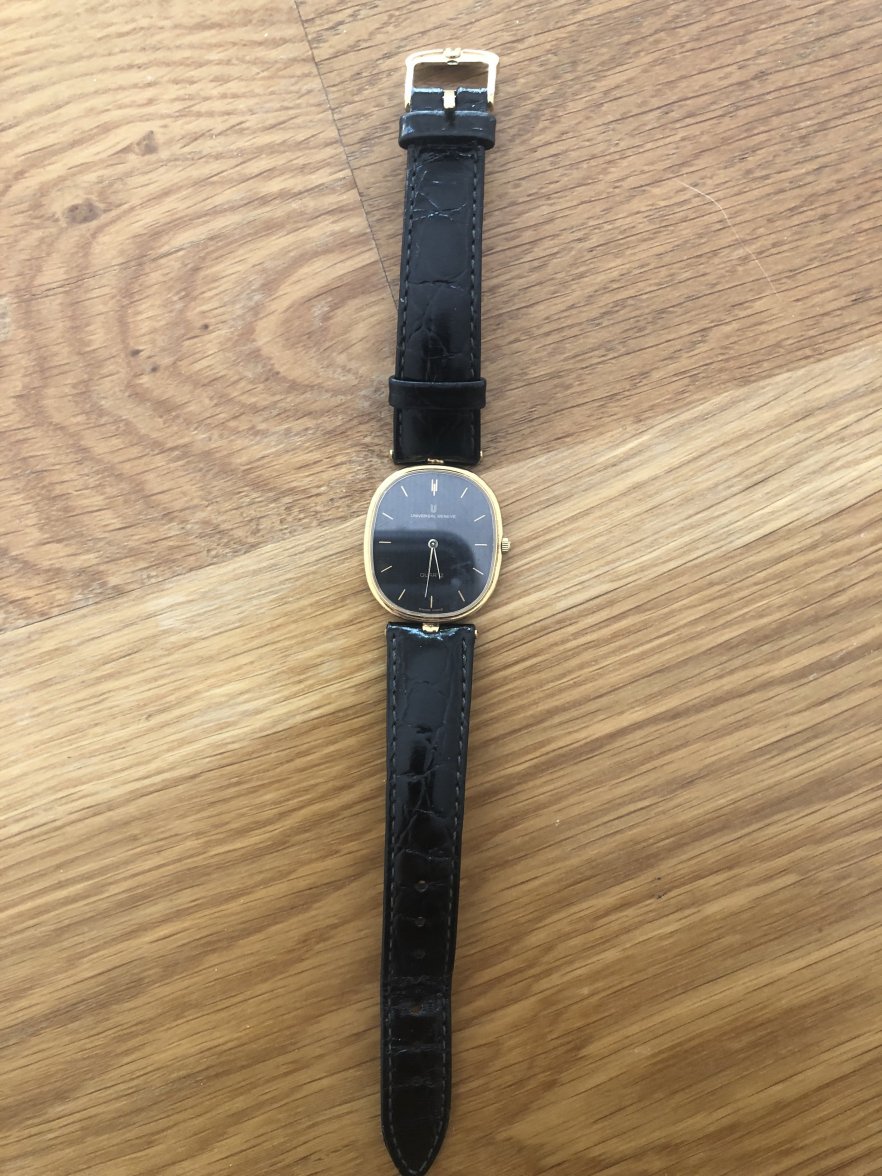

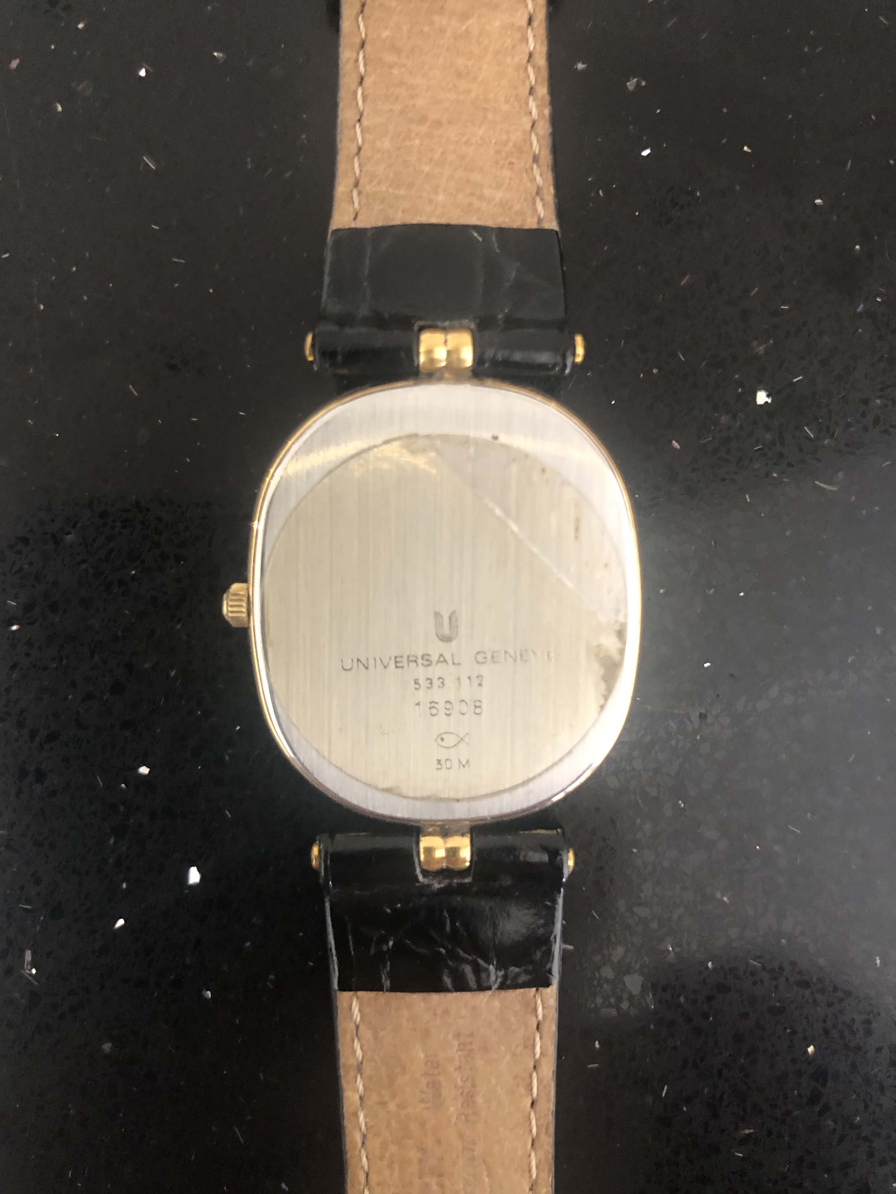

  20. Mike3 Aug 27, 2019
    3
    Hi guys, I'm trying to find out about a watch that I have been left by my father. When he finished with the British army he became a private security contractor (bodyguard) mainly working for people in the Middle East. He was often given watches as a thank you including this one. It might have been in the late 70s or 80s. I'd love to know what it is!
    Kind Regards
    Mike
