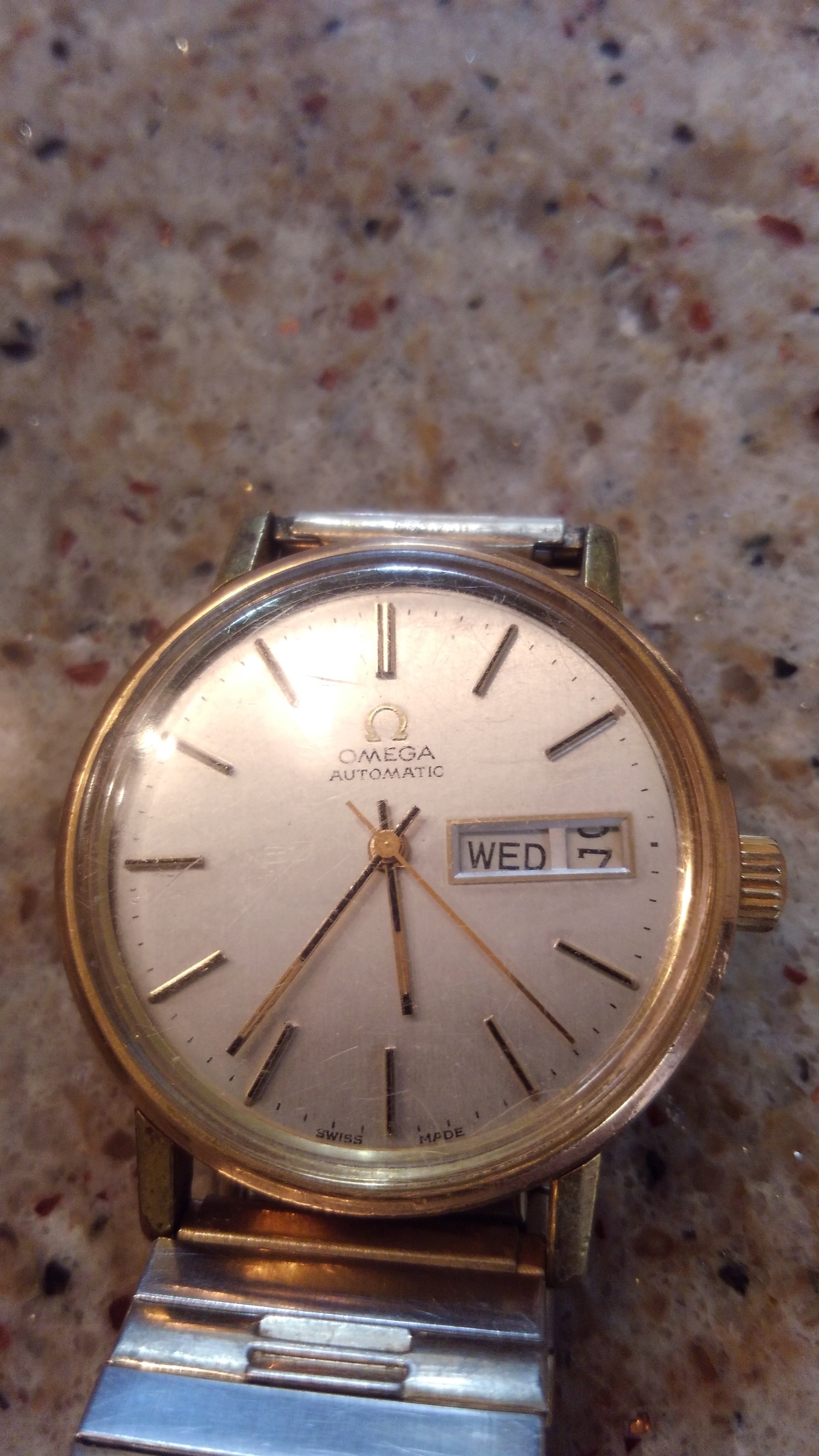

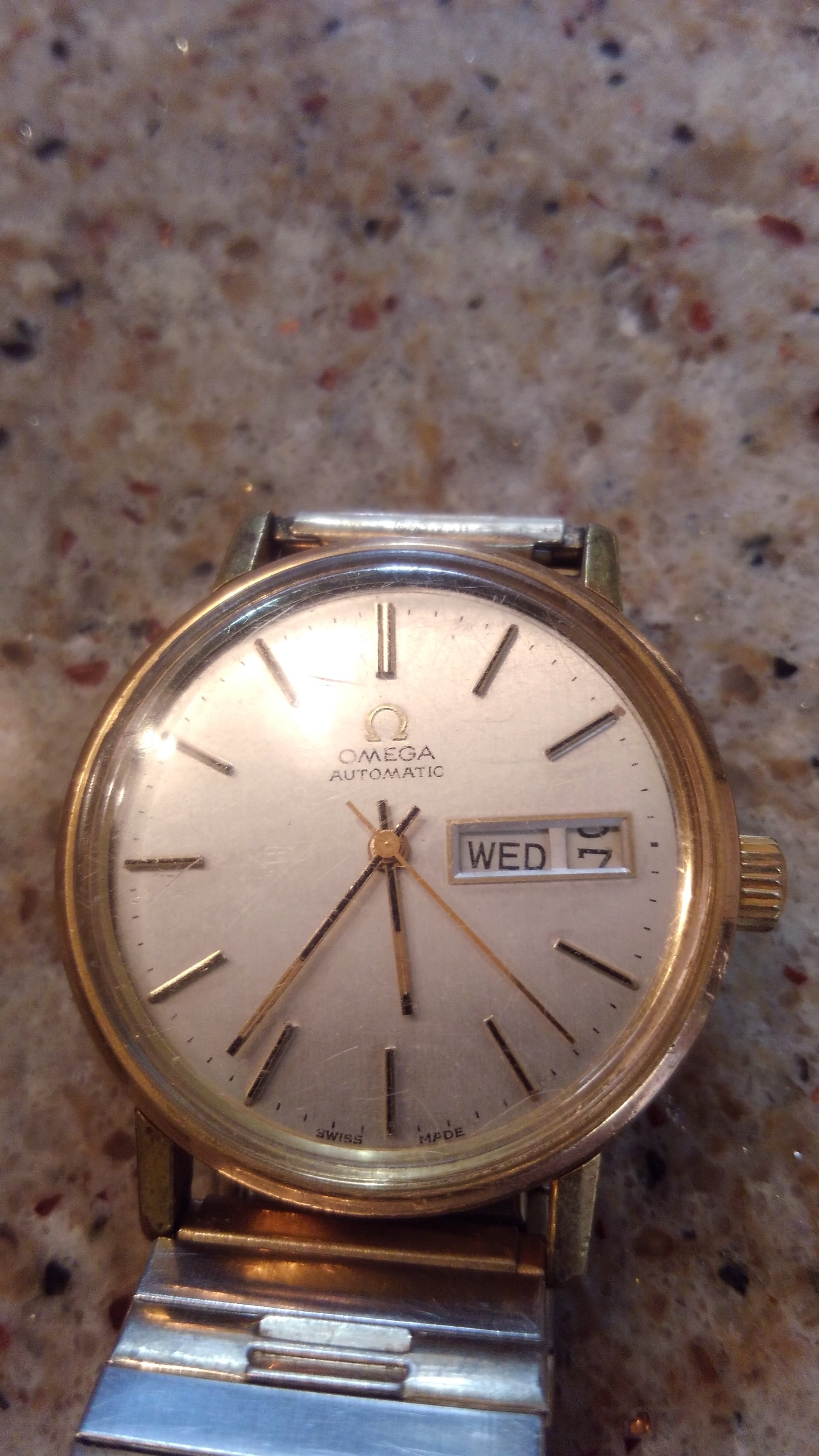

As I've been registered on here for two years but with no posts, I've got to surmise all prior presence here has just been for searching. I've just spent 7 hours today refreshing myself on the sketchy notes I put together then, along with relearning the 95% I've forgotten. I've hit a big roadblock after having been able to find out a good deal about my uncle's watch using what appear to be popular online sites for researching. However, I'm striking out with where to go when I can't find anything resembling an actual serial number!
It appears an image hosting platform is necessary to post pics, so until then I have found enough to be pretty certain it's a Seamaster 1020 166.0209
Gold Plated Bezel, Stainless Back
White dial, with 'Omega' and 'Automatic' under that (the only markings)
Background: He worked for a huge multi-national corporation, and suffered a major stroke in '79 so they retired him out. That, plus his personal accountings before death go toward legitimacy of the watch being genuine goods.

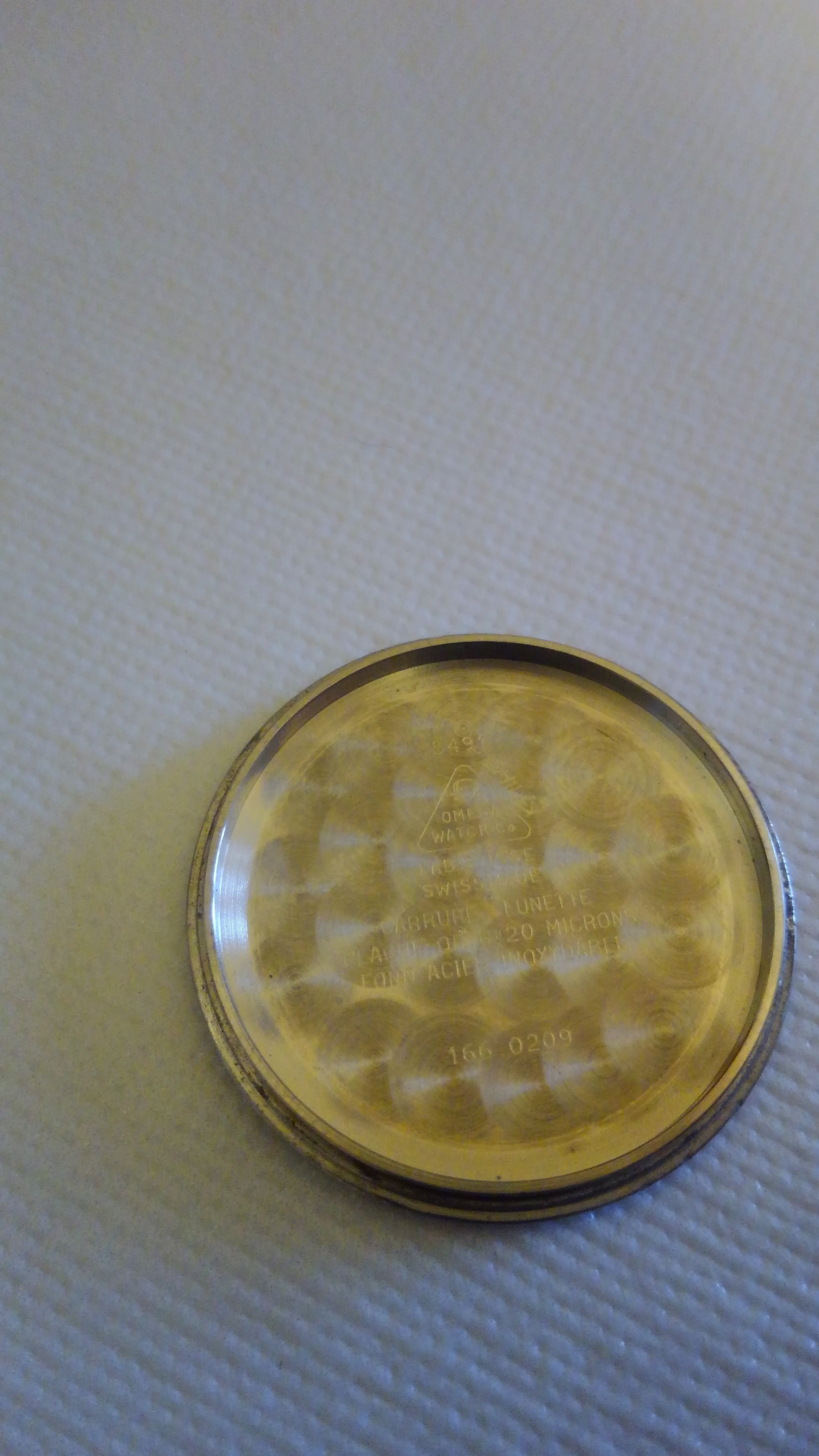

The back cover reads his name, corp. logo, and "For 25 Years Service - 1965", which matches retirement date. I surmise the protocol was awarding quarter-century anniversaries and they reverted back to the award level prior to the 50-year mark.
Identifications-
Dial side of back: Above the triangle is '5491', and a hand-scratched or penciled 'K91ACFR' upside down and running outside the rt. hand triangle leg
and the 166.0209 at the bottom below all the Swiss printing

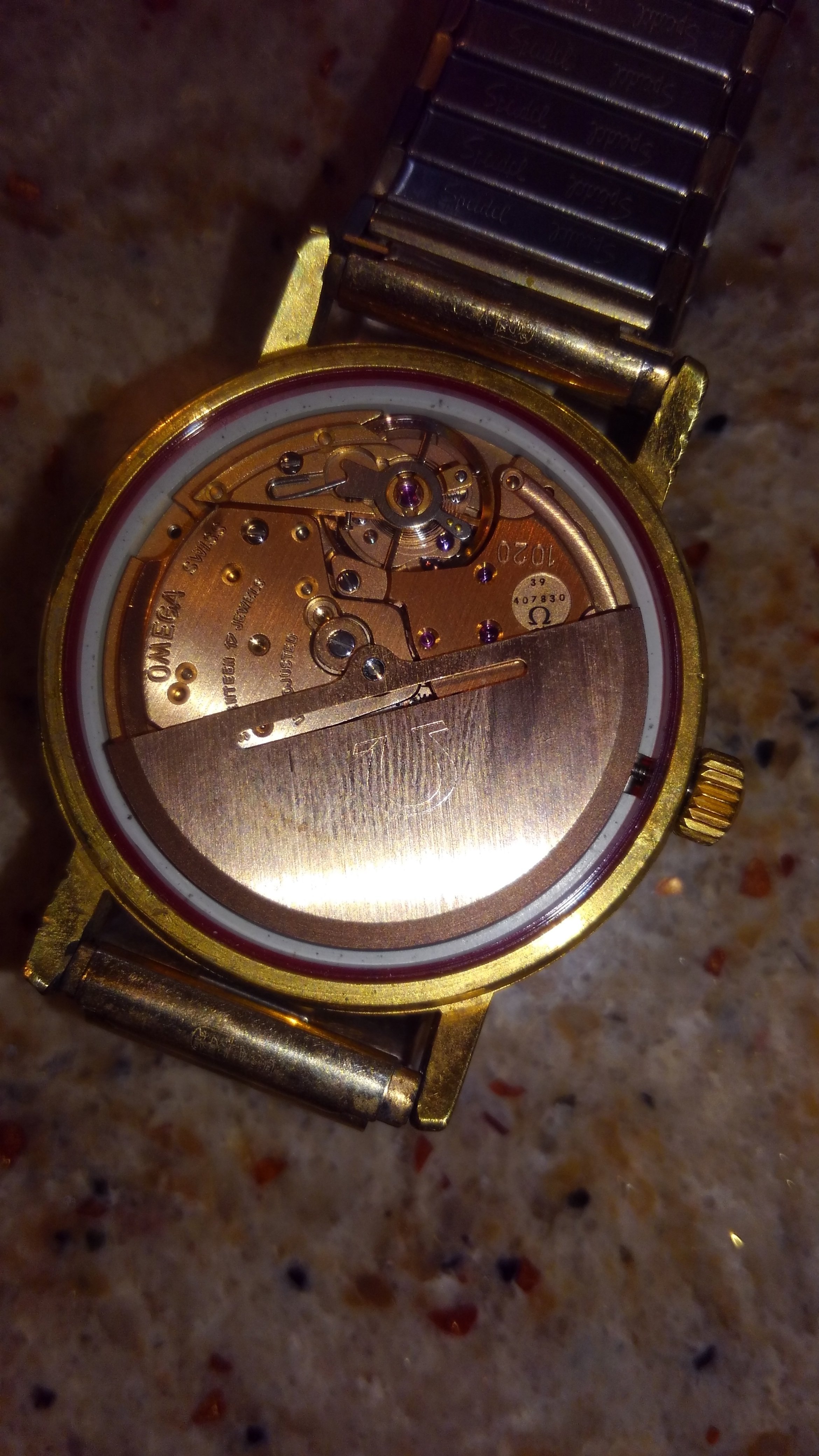

Movement:
'OMEGA' and 'SWISS'
'Seventeen 17 Jewel'
'Unadjusted'
(Inside of the indented circle)
'39'
'407 830'
and the '1020' near that circle
There's nothing else, certainly nothing close to resembling the MAPICS formatting of that timeframe:

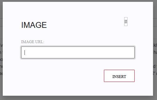

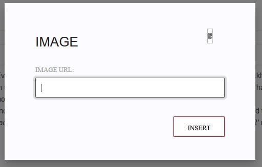

This is not true. All you need is to attach the photo using the "image" button above the compose message box. Easier to do from the phone that you took the pictures with.
I'm assuming it looks like this: https://www.omegawatches.com/en-us/watch-omega-seamaster-omega-st-166-0209. Reference number is 166.0209 and 1020 is the caliber of the movement. 39407830 is the serial number.

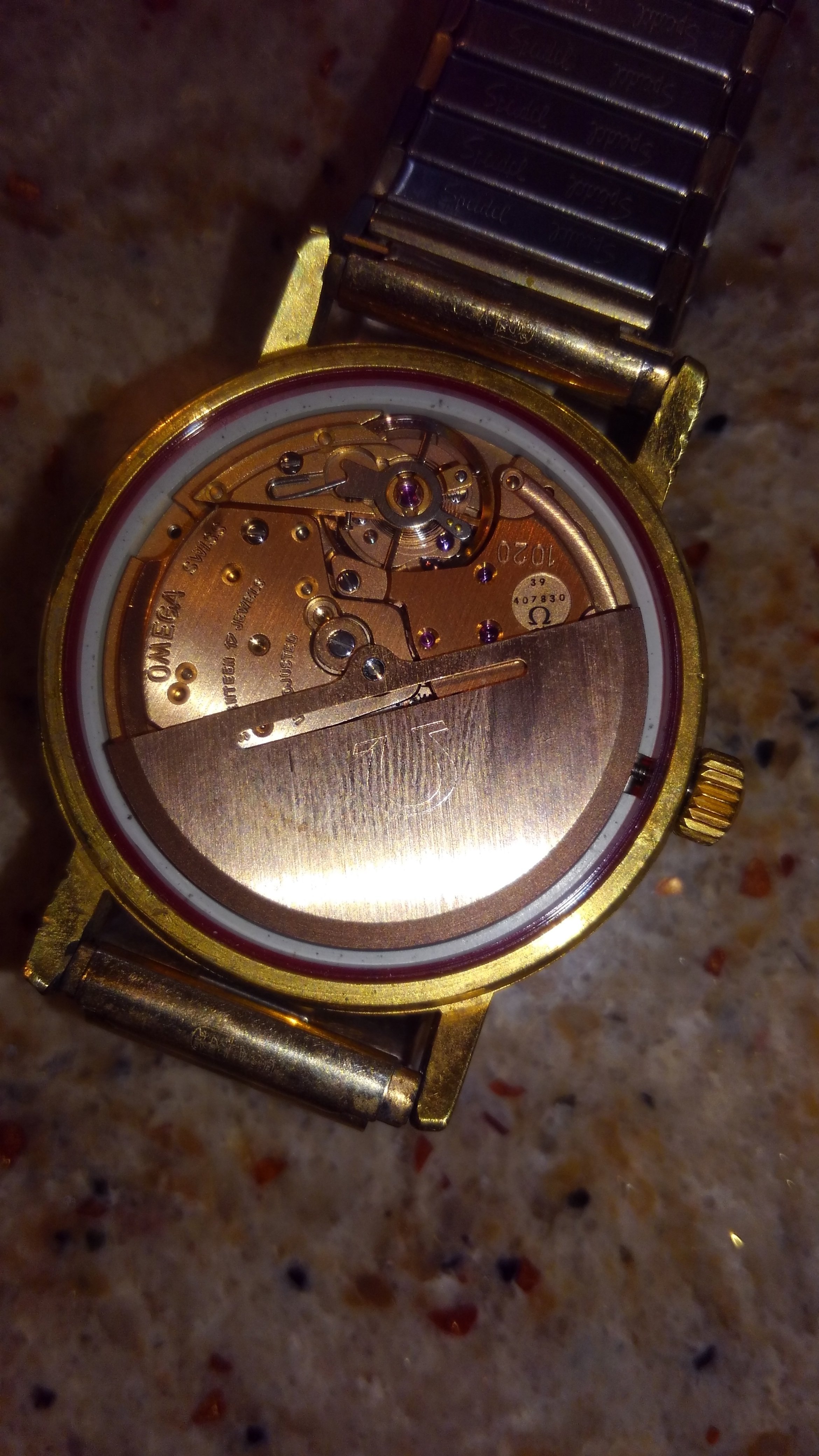

Omega introduced the caliber 1020 in 1972.
The serial number is in the little circular decal.
39,407,830 puts the production date of the movement to approximately 1979.
This aligns with the entry in the Omega Vintage Database for case reference 166.0209.
Gad Zooks! Even with my meandering with the details you folks beat that to the ground quickly, thanks! That Omega illustration was initially what started me down the path to the rest of what I pieced together. I admit a big D'oh! with the Ser. No., but hadn't considered the leading letters could be numerals. And curious no graphic ever popped up in all my twisting searches that displays it in that format.
And appreciate the primer on attaching pics. I had used the Image button earlier but caught the prompt for a URL which scared me off. Following through with the procedure this time led to success:

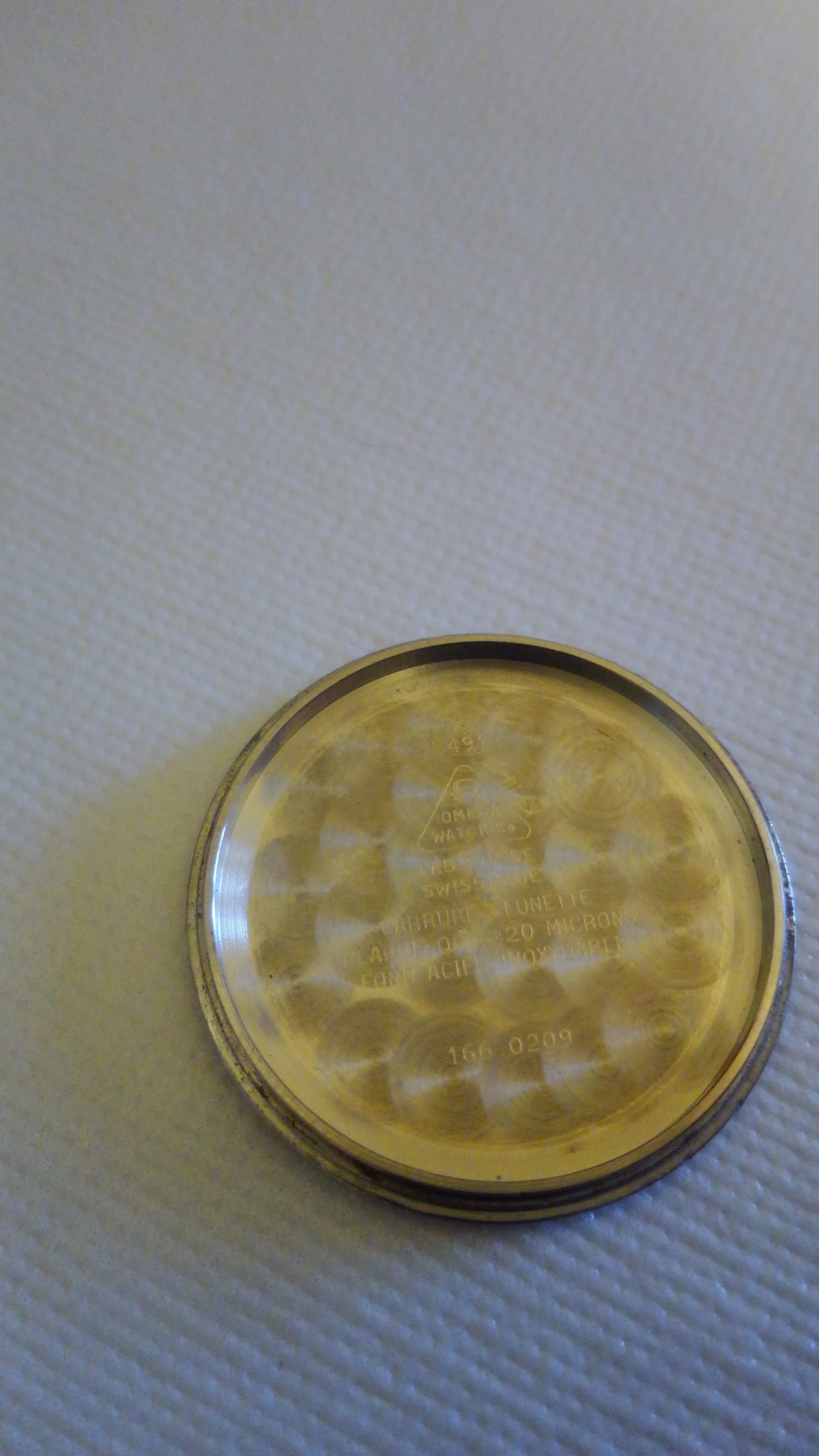

I'm relieved enough that my nosiness has diminished about what the only remaining unknown marks designate:
"Dial side of back: Above the triangle is '5491', and a hand-scratched or penciled 'K91ACFR' upside down and running outside the rt. hand triangle leg"
Back is indeed s.s., just had wife shine diff. light attempting better detail:
