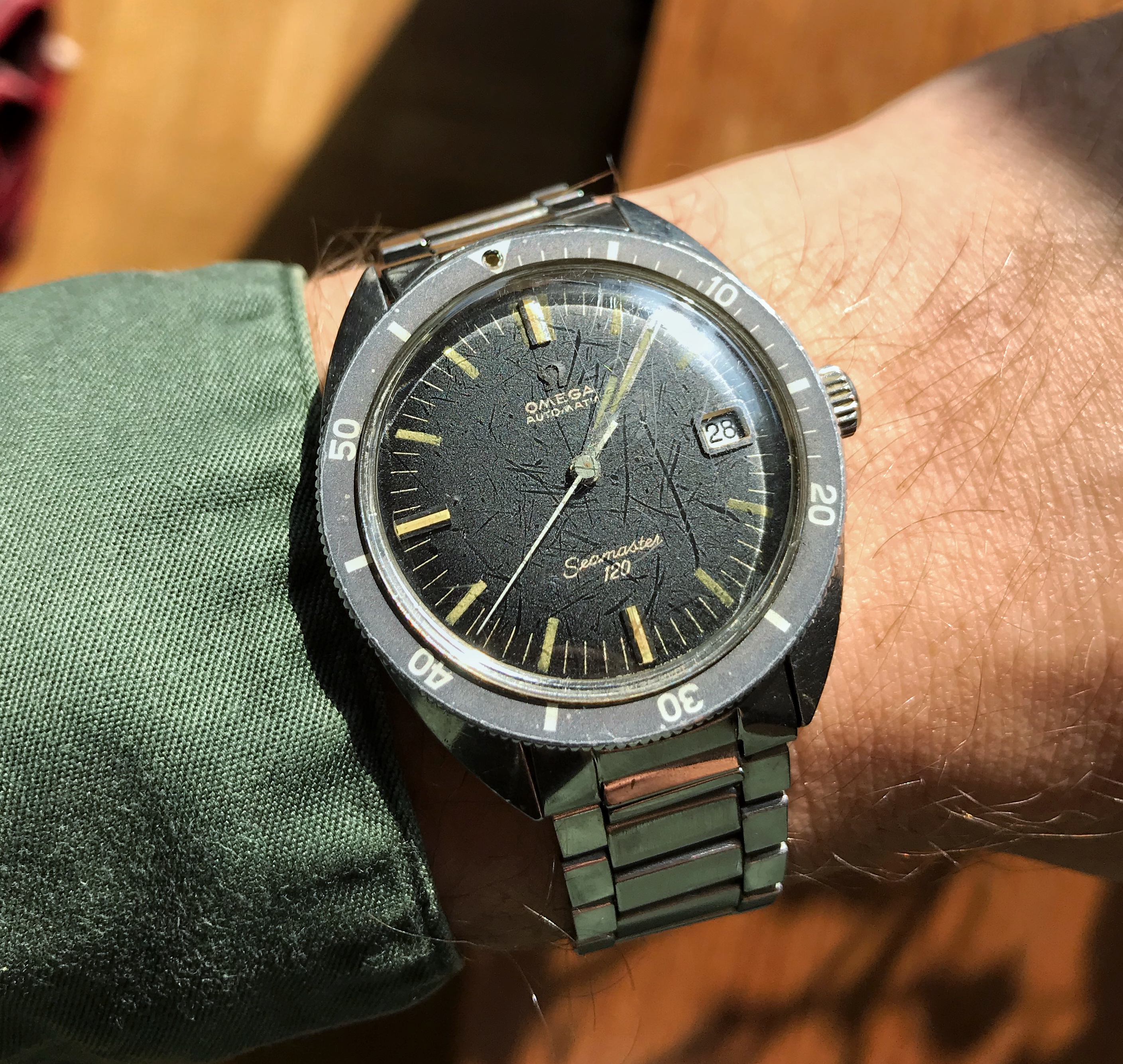

This is the 19mm US Holzer on my 120, his Flatlink fits the same way. I did a little tweaking on the endlinks (just a touch of bending) to get the endlinks go sit more flush- it's a great fit I think

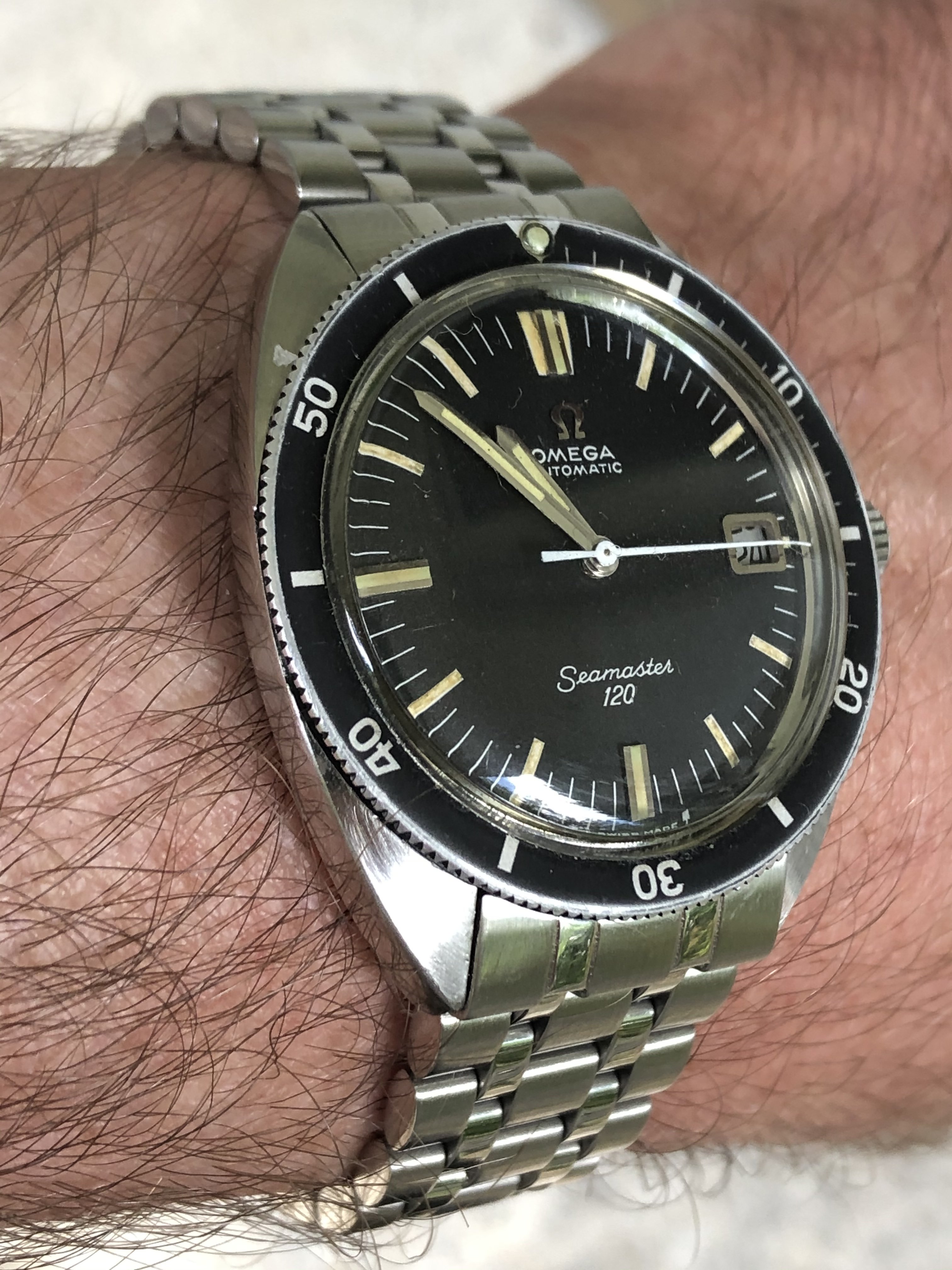

I like how the Holzer look on the sm120, but I love the look and feel of my 7912, and the end links fit quite nicely after some tampering. It feels like I got the little brother of an old Speedy or a Seamaster 300 on my wrist.

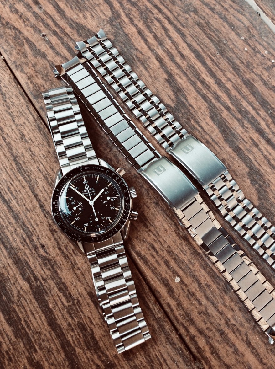

These look great and may have a multitude of uses, not just for the Reduced which is the ginger step child of Modern Omegas.
I do think @Uncle Seiko may have missed a trick in not releasing an 18mm Beads of Rice Design. Having said that one or more of these may work well on 50s/60s Seamasters and Connies.
