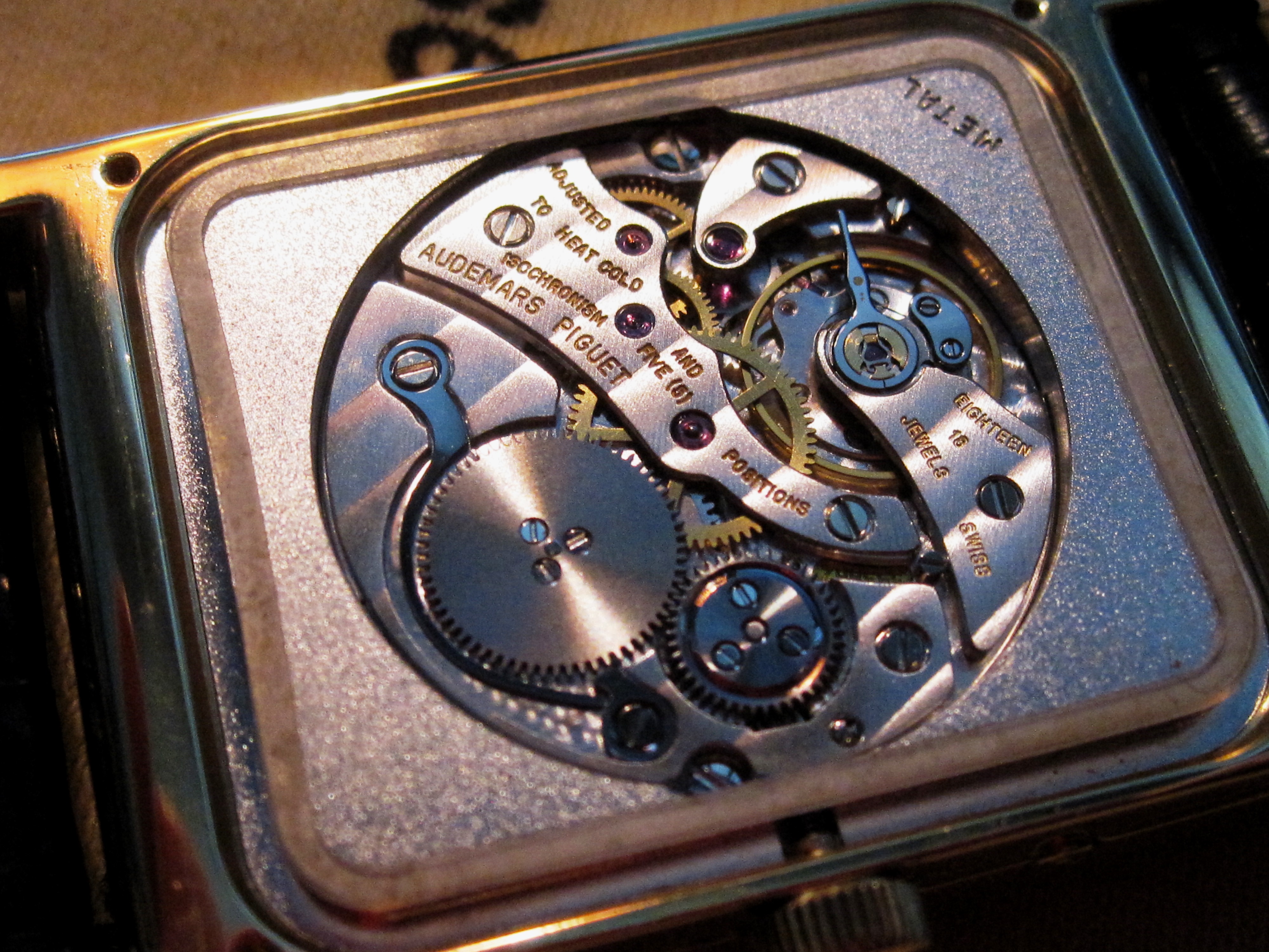

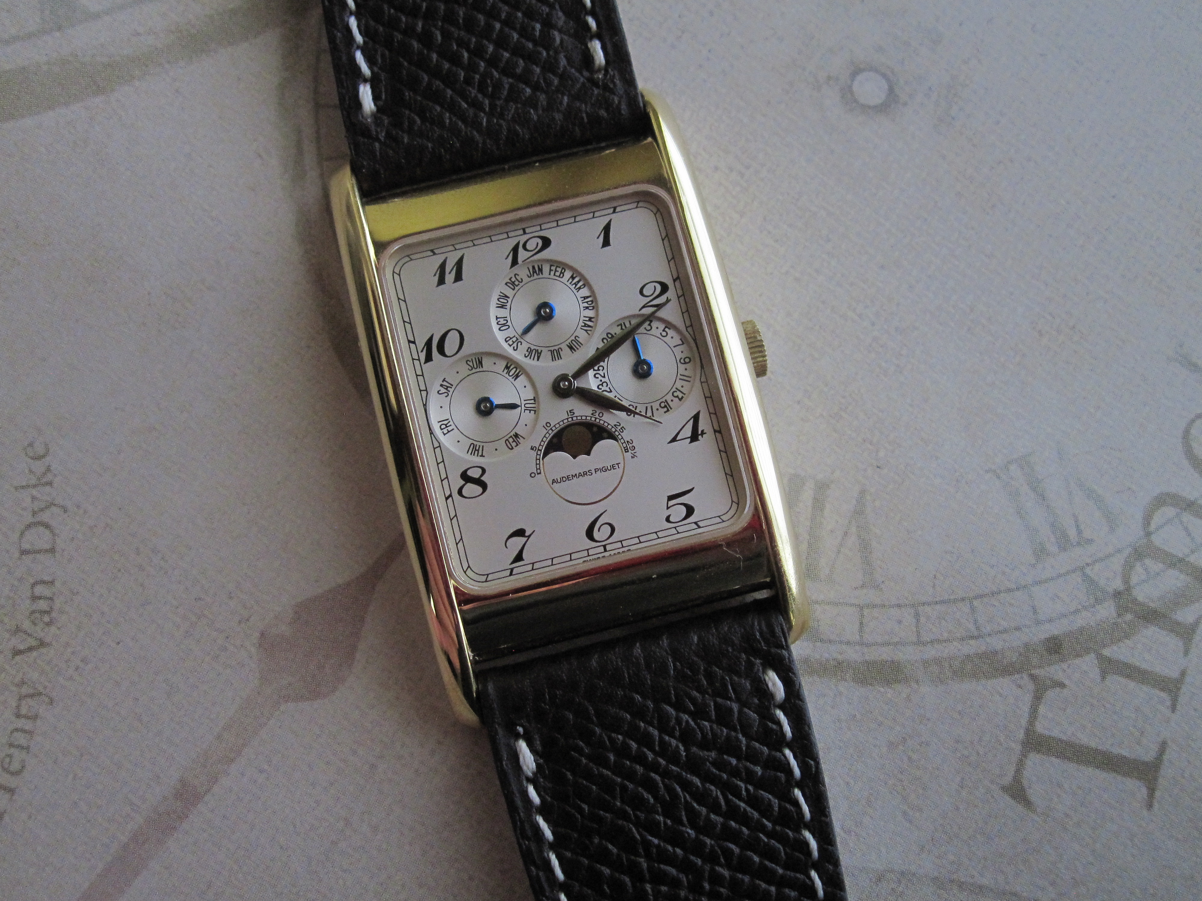

I have an AP manual wind perpetual calendar ca 1992 based on their Cal 2003 ultra thin movement developed around 1946, 1.64 mm thick and 20.8mm diameter. On top of this AP added the perpetual calendar module, 1.55 mm thick, for a total movement thickness of 3.19 mm. This is very thin and a pretty small diameter movement with this complication. All based on old skool technology.

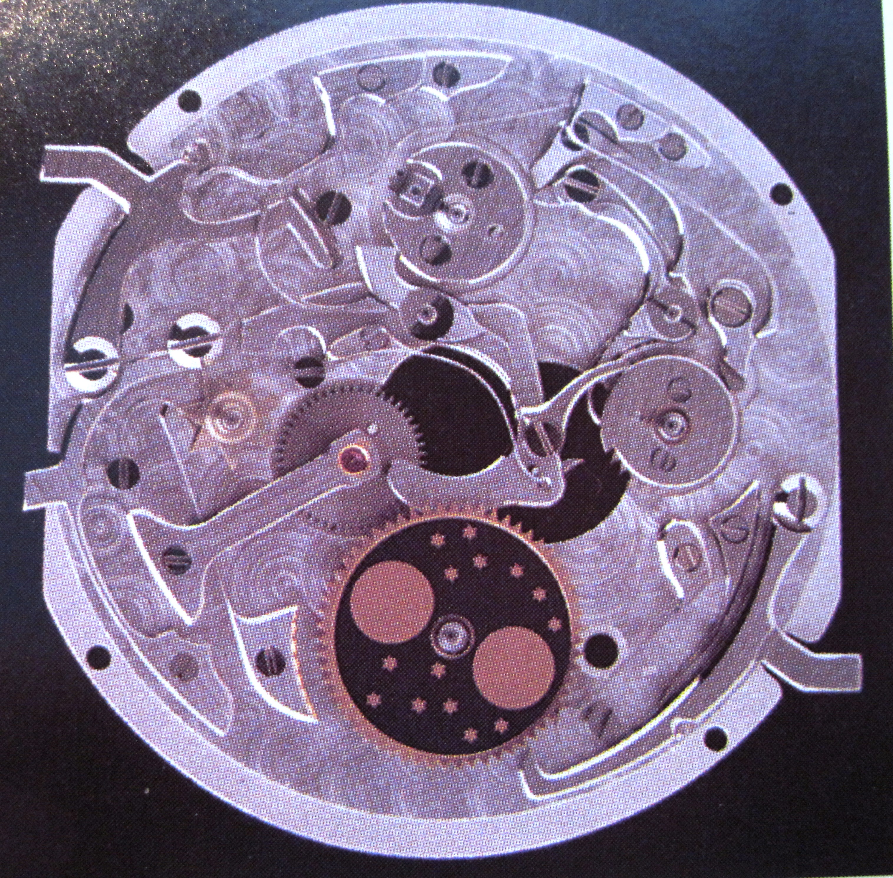

How about a peripheral rotor column wheel chronograph with GMT in a 3.3 mm movement?
And don't leave out the peripheral winding mechanism.
I raise you a perpetual calendar that is thinner at 2.7mm

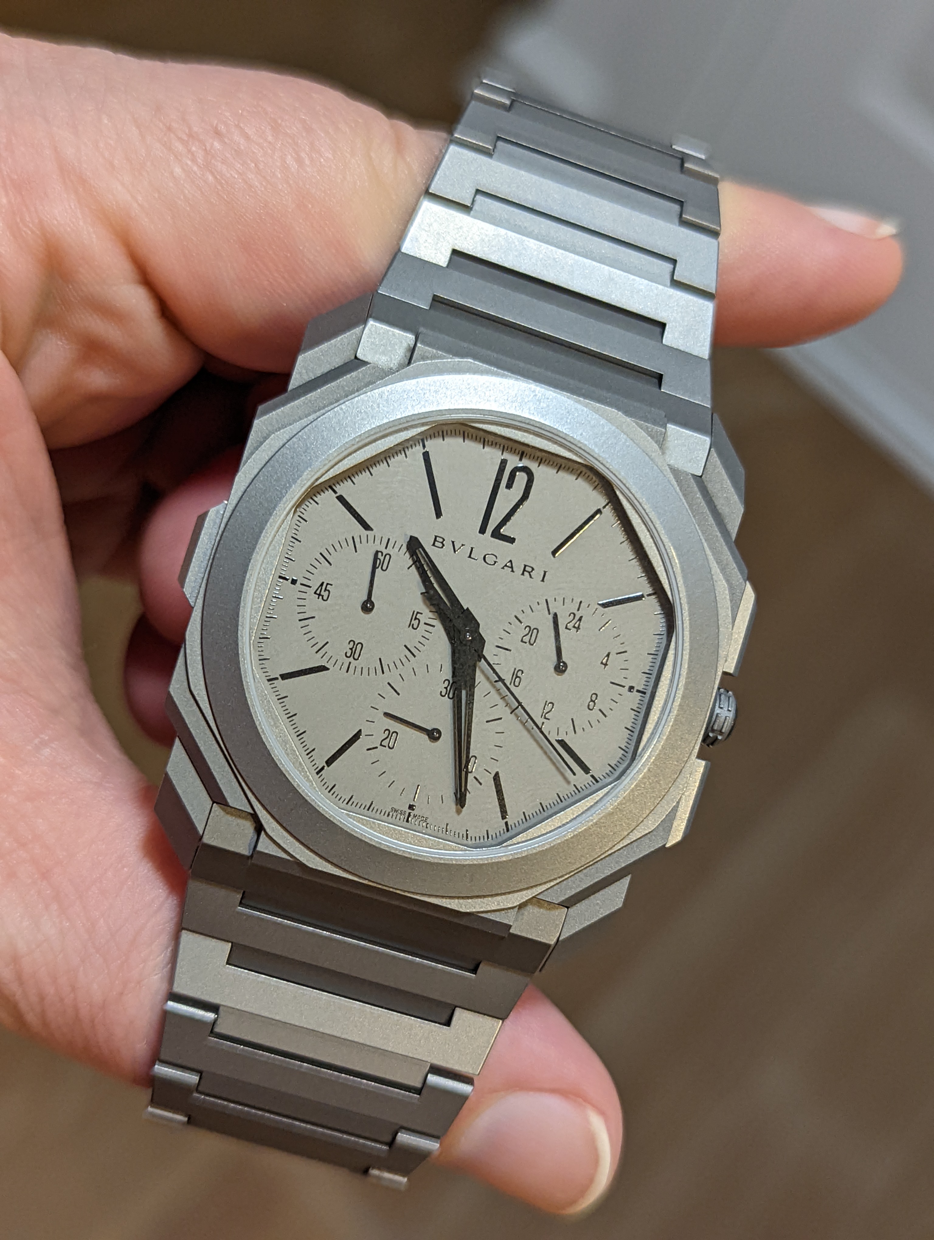

I was looking at the Bulgari ultra thins, and thinking that those really need some depth on the dial to make them really pop...
I deserved the facepalm I gave myself...

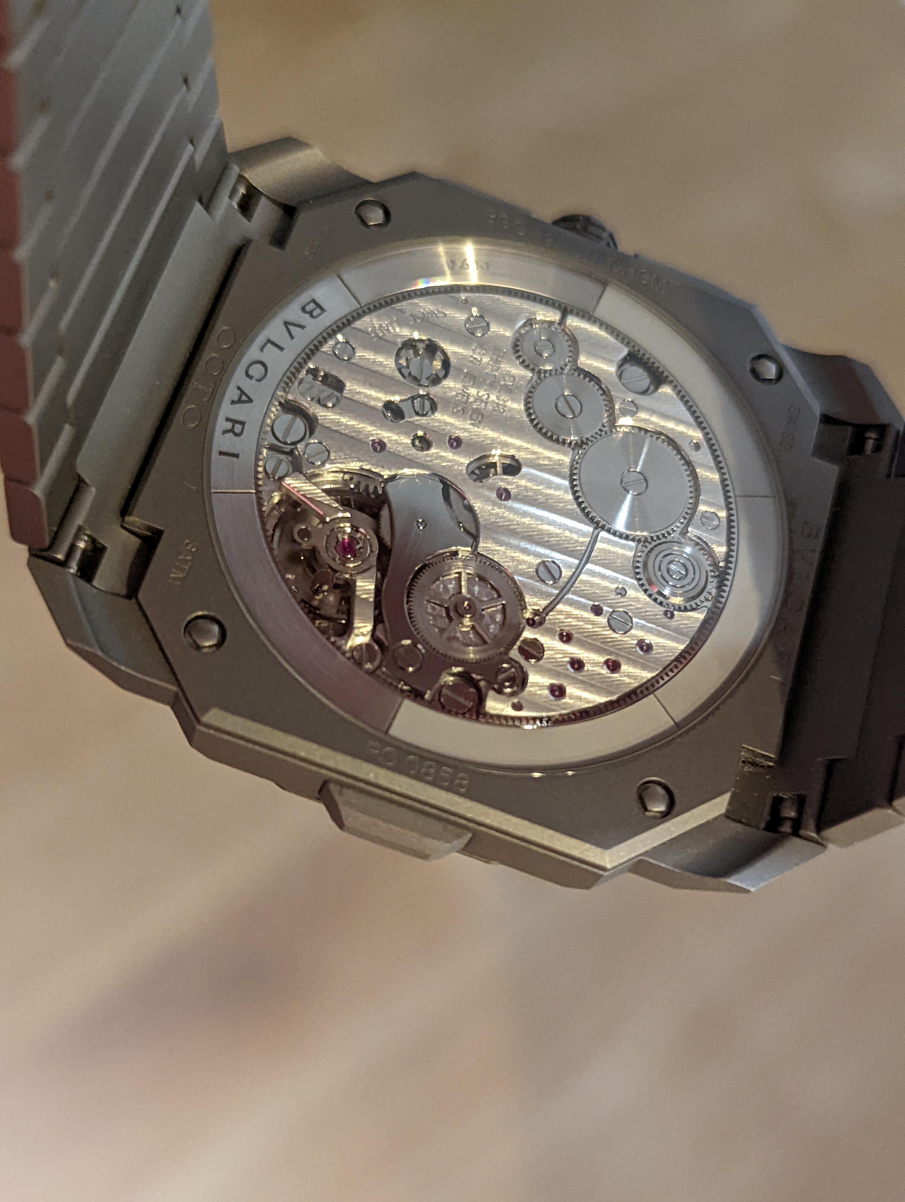

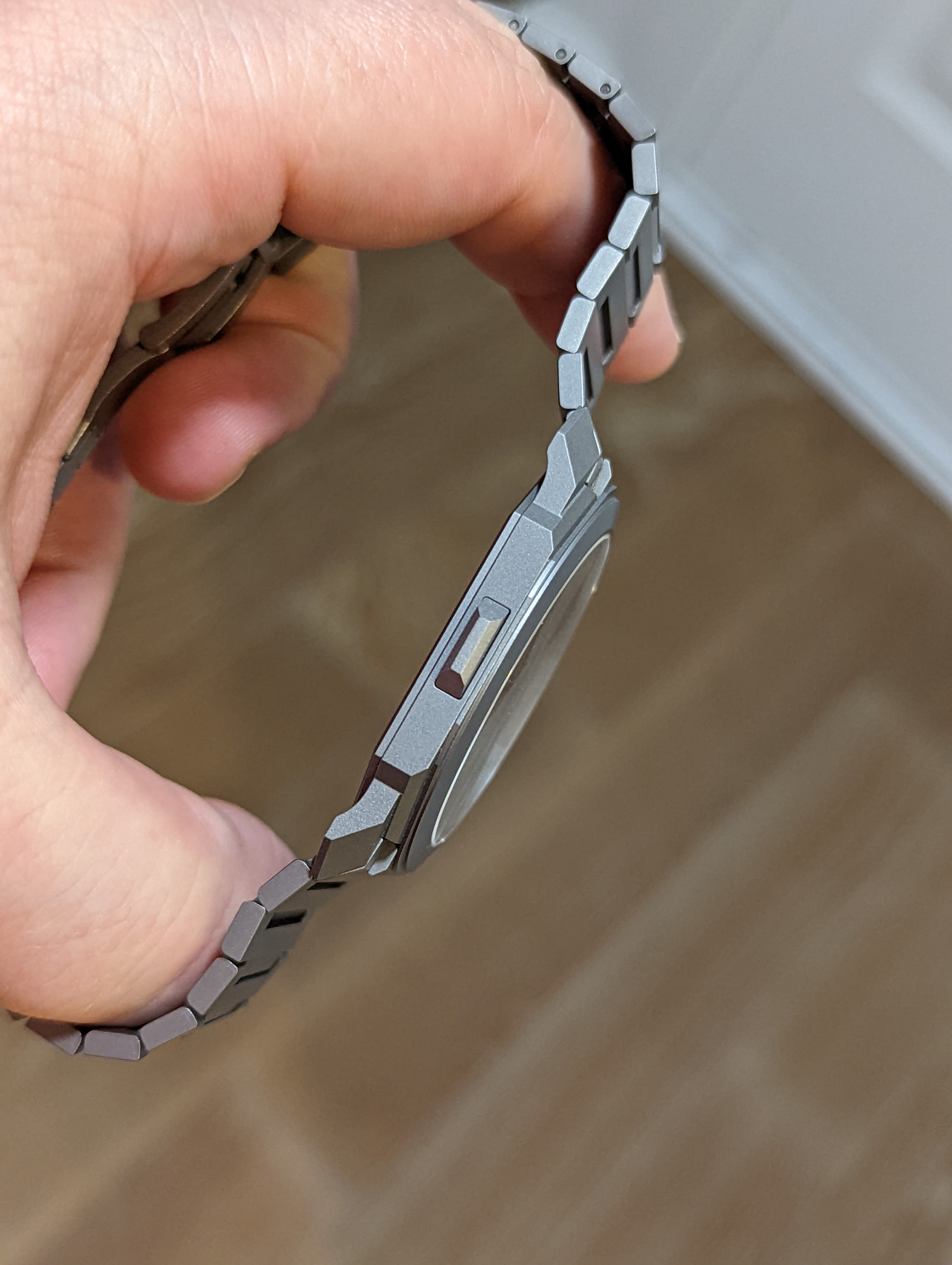

I questioned whether the gray on gray is too plain, but I've grown to really love it. It lets the beautifully sculpted case be the star. The case is the really inspired part on the watch. Like the Nautilus, it's the kind of thing where if you sketched a million watches, you'd never hit on these particular angles and proportions.
They made the steel version with colored dials which have depth and contrast if you like, but they did that because statistics show that's what sells. It was a marketer's choice, not a designer's choice. The gray is great precisely because it's completely different from everything else at the boutique, and in my watch case. There's a gloss to the numerals and markers and hands that give it some subtle textural variety. It has a high fashion look that's on-brand for a company like Bvlgari, and that's what I like: a watch that's completely and unabashedly of this day and age in technology, design, materials and style. I wouldn't change a thing.
