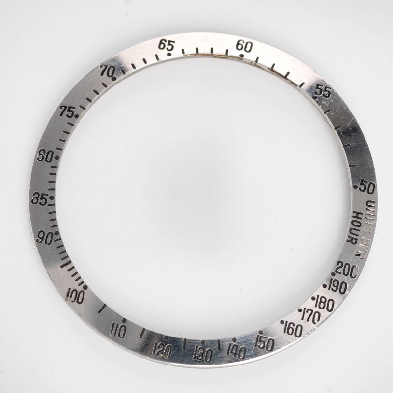

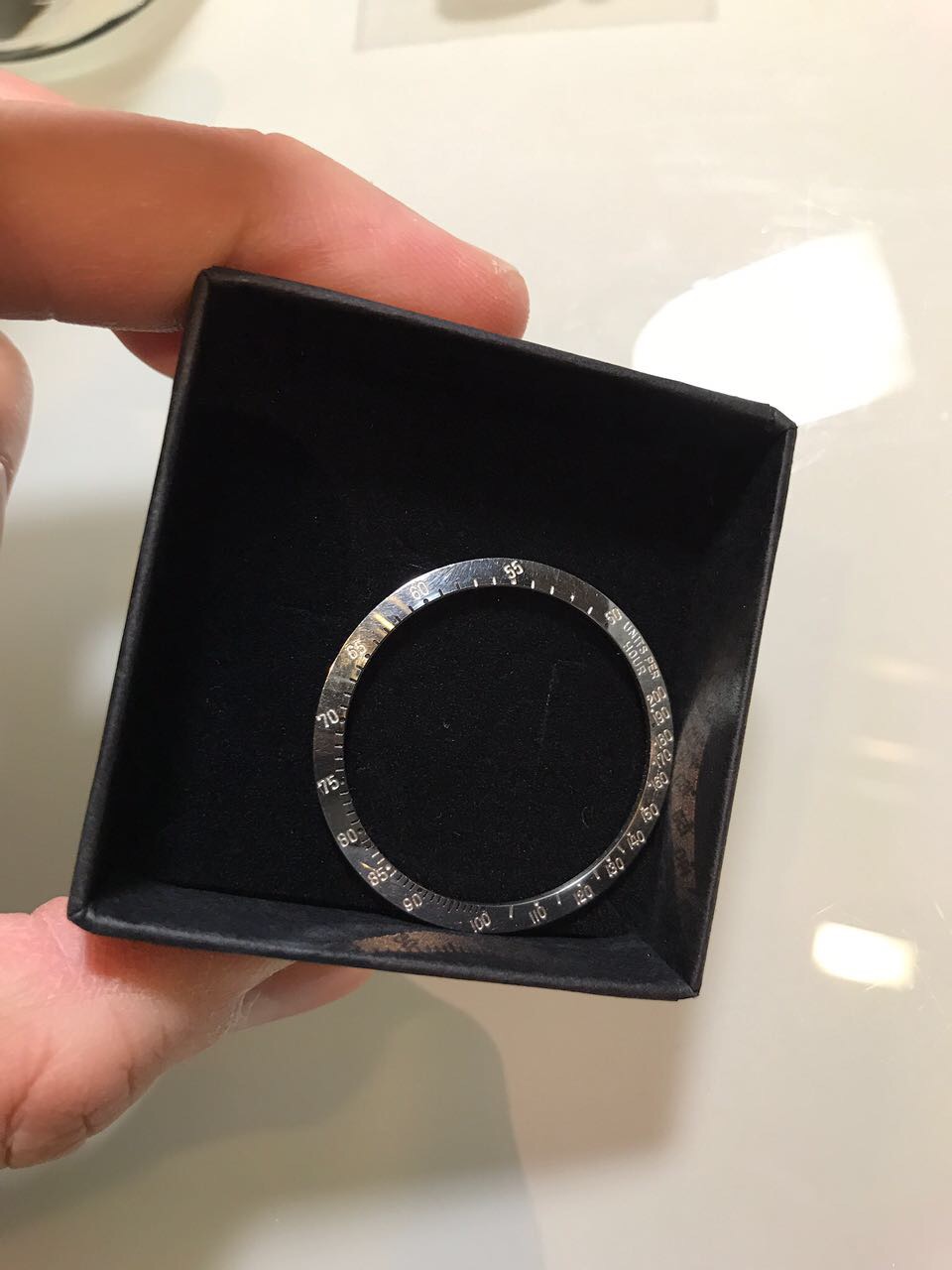

  18. SgWatchBaron May 22, 2017
    628
    1,154
    Damn it. The ultrasonic messed up my 6265 Daytona bezel as well. See the before and after... all I used was some washing detergent and 30secs in the ultrasonic in warm water. Also, alcohol swabs will make the paint run... I will recommend warm water and light detergent without ultrasonic.
  19. kreyke May 22, 2017
    626
    836
    Thanks for the heads up man.
  20. The_Walrus May 22, 2017
    369
    331
    Sorry to hear. I suppose this isn't fitted to the watch no more?
