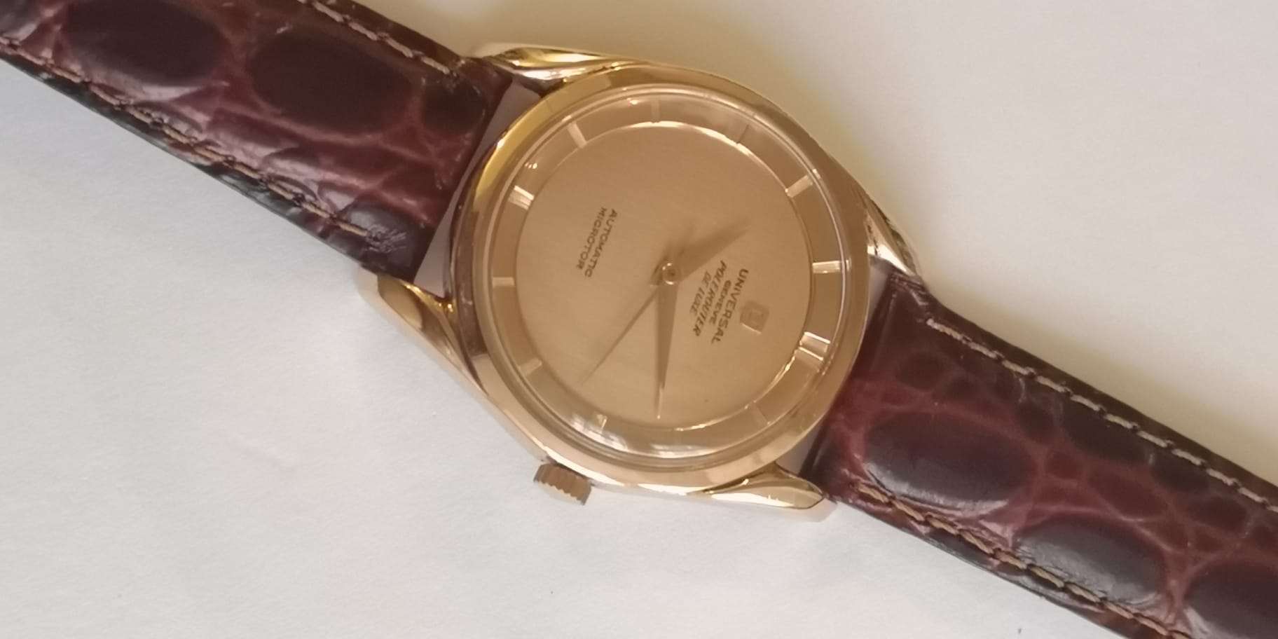

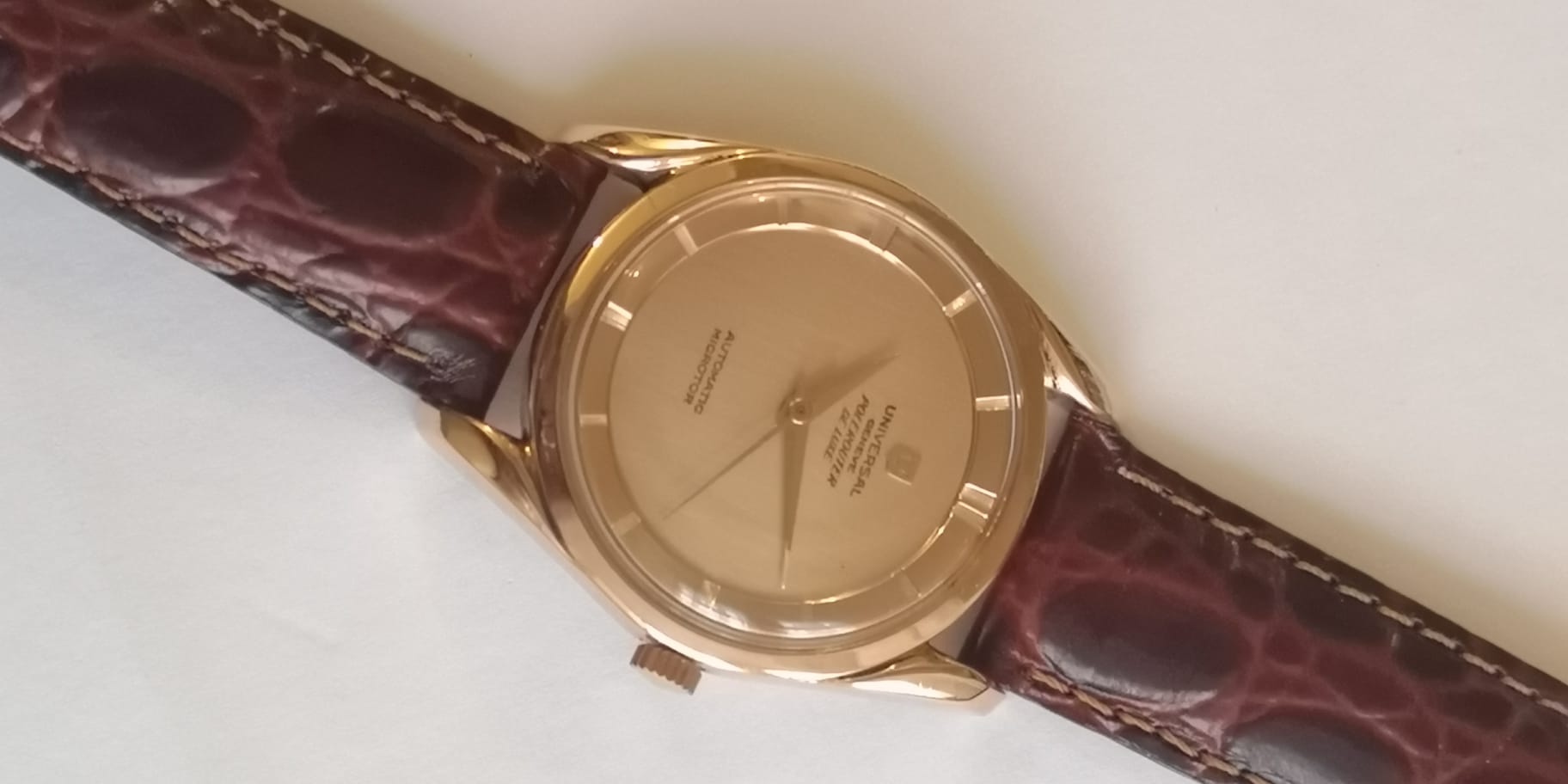

Hi All.
Would appreciate your comments on this watch.
Better pics to come but do you consider the case to be heavily polished?
Under 1500€, is it an acceptable deal, with movement service and one year guarantee?
Thanks
Joao

Btw, I know crown is incorrect, are this very hard to find?
Thanks

Crowns aren't easy to find and it does look quite heavily polished. I'm not sure on that dial - the printing looks a little off and the 'swiss' is missing.
I'd keep looking

I’ve got redial warnings blinking.

Heavy polishing, but numbers still visible at least.
Id ask for much better photos of the dial - the swiss could still be hidden under the marker ring, but its impossible to say whether its a redial from that resolution.

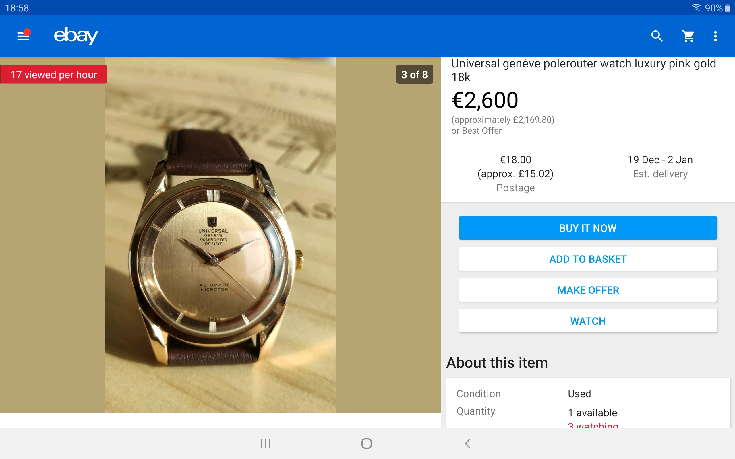

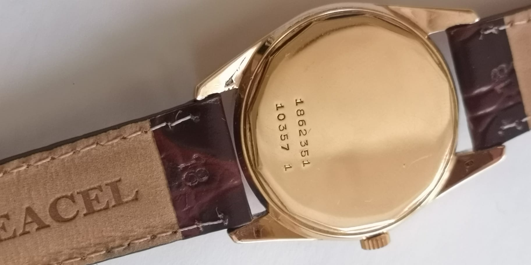

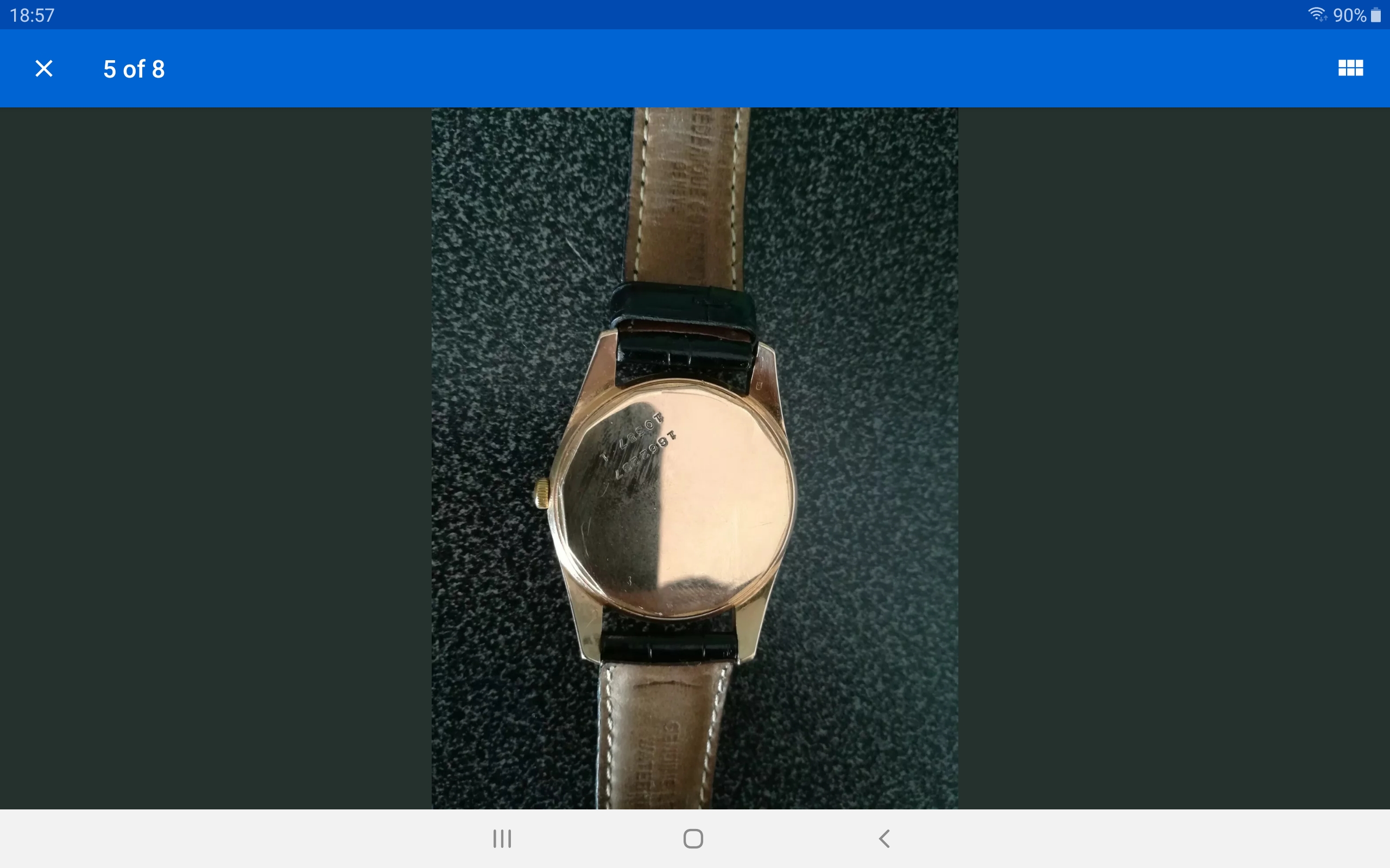

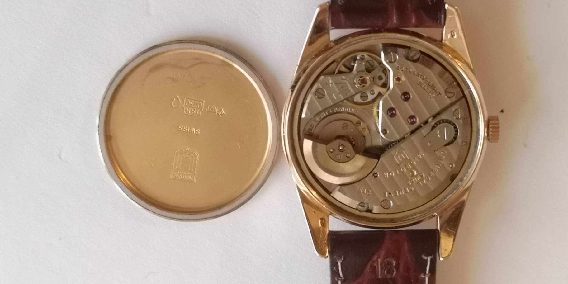

I see it's twin brother is currently for sale on ebay only 54 apart in serial number

I'm more inclined to say it is a redial having looked in the watchbox at my own which has a serial number only 38 away from the OPs. Thought the number looked vaguely familiar

Better photos would go a long way, but as many others here I am thinking redial. Something is off with the writing.
