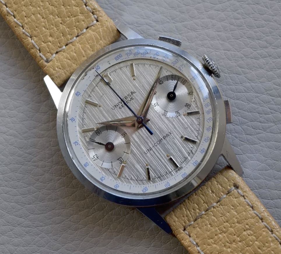

  3. billving Nov 3, 2016
    559
    324

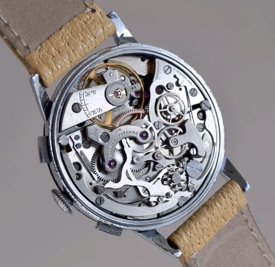

  4. billving Nov 3, 2016
    559
    324
    Fake? Or something that I am missing?

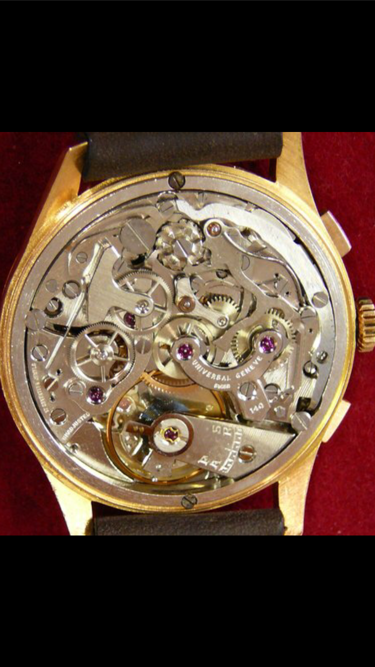

  6. billving Nov 3, 2016
    559
    324
    My movement pic is from that gold one

    mmm, I would say these watches are put together and not original, aka fakes!
    To solve the issue once and for all we would need shots of the case backs, inside and outside, so to see if they are indeed UG cases (from both the serial numbers as well as the hallmarks).
    The shape of the cases doesnt look UG, also the dials, given the shape of the logo and brushed finish, would be from end of 50s/60s (I say would because I don't think they are legit either) but the Valjoux 22 is a caliber used in much earlier chronographs...

    That's my feeling also. I liked the case and dial but got turned off when I saw the movement. No case number on the case back, just a serial number on the inside.

    if you know the serial number post it here and we can judge whether it could be a proper UG serial number or not, but if there are no all marks that is not a UG case. I would stay clear of them!
