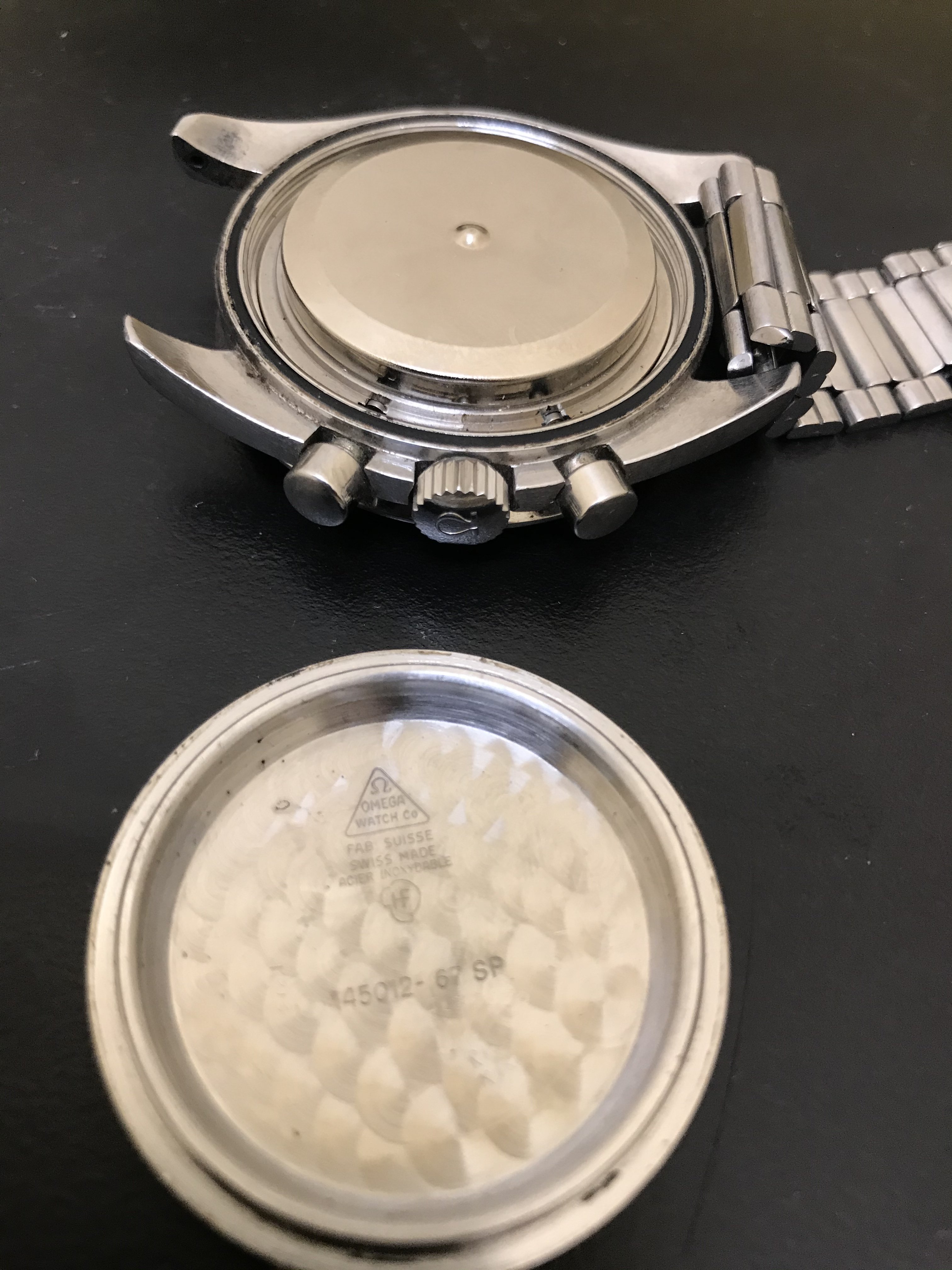

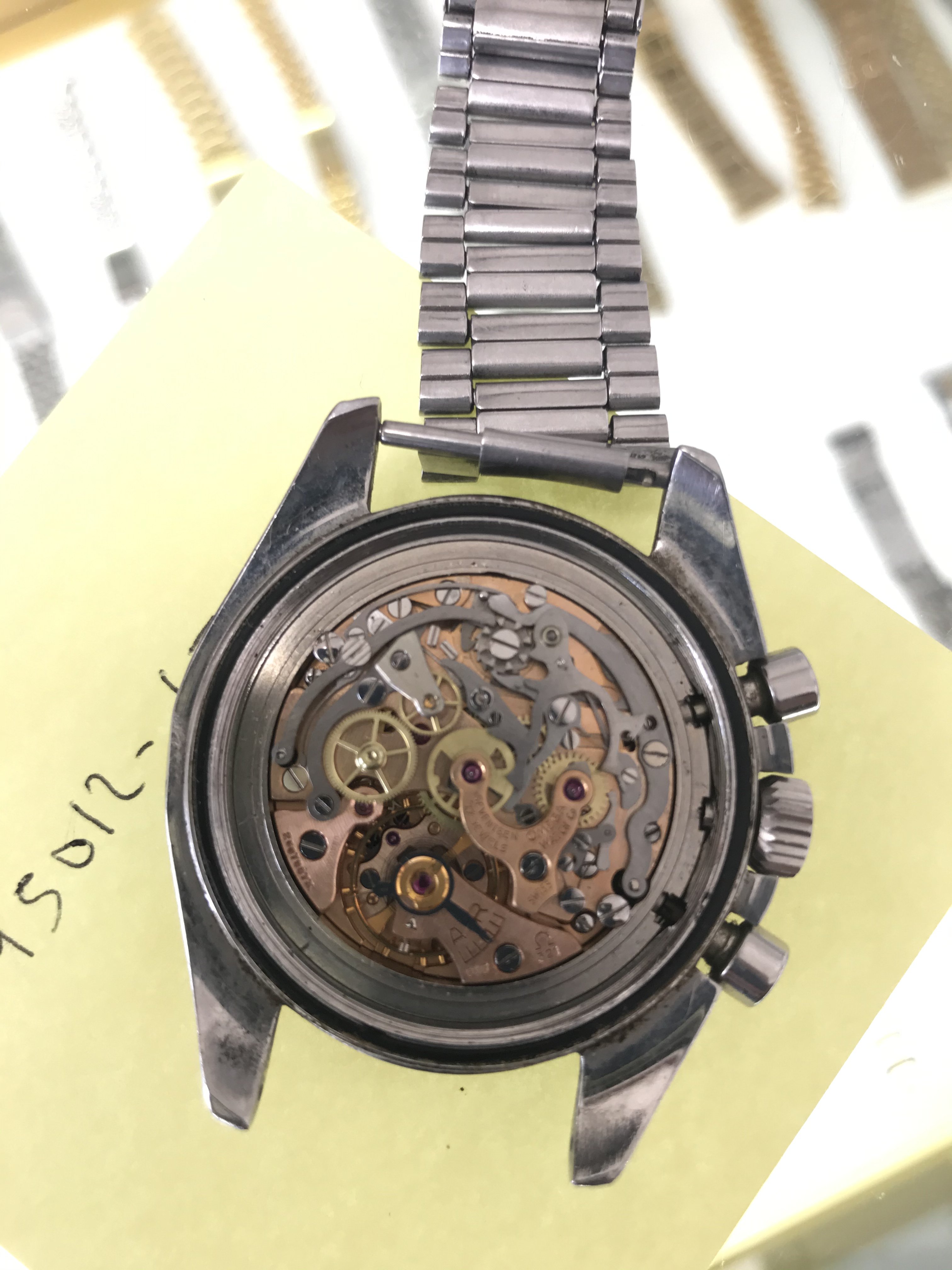

Picture of the movement.
case says 145 012 -67 SP
Caliber is 321
Serial number read off by the watch maker is 20079873.
Not sure if that's a correct serial number?
I have the form for getting an extract from the archives.

If you submit that serial I guarantee you will be $150 out of pocket with nothing at all to show for it. There are no refunds anymore for a lack of hit due to incorrect info. He will have read the second digit (and maybe some others) wrong. A -67, inc the non Ultraman variety will have a serial in the 24.00-26.55m range. A genuine Ultraman is usually between 26.076.xxx and 26.079.xxx* so if yours is incorrect only in the second digit it may actually be OK. You need to get a second opinion, either check it yourself with a loupe or take a in focus photo then blow it up and check. if it turns out the serial really is 20m then you have a big problem which will knock $10k's off the value but I think that is unlikely. Hopefully it is actually 26,079,873
*range from SP101

Thanks for saving me $150, and the time wait for the results.
where exactly is the serial number?
If you submit that serial I guarantee you will be $150 out of pocket with nothing at all to show for it. There are no refunds anymore for a lack of hit due to incorrect info. He will have read the second digit (and maybe some others) wrong. A -67, inc the non Ultraman variety will have a serial in the 24.00-26.55m range. A genuine Ultraman is usually between 26.076.xxx and 26.079.xxx* so if yours is incorrect only in the second digit may actually be OK. You need to get a second opinion, either check it yourself with a loupe or take a in focus photo then blow it up and check. if it turns out the serial really is 20m then you have a big problem which will knock $10k's off the value but I think that is unlikely.
