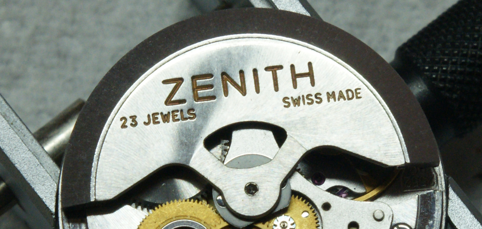

Well that's why I am asking this. My turtle's rotor doesn't have the word chronometer and I was sure that it was a replacement. But having seen the examples in chrono24 I am beggining to have doubts. By the way what's your opinion about these watches. Do you think that they are all original and in good condition or do they have also problems;
16,900
48,108
First one has a issue
Replacement rotor on the first one as why would you drill the jewel no out ?
look at centre attachment for rotor of two examples you have posted? Both not the same..
4,643
31,245
...But having seen the examples in chrono24 I am beggining to have doubts. By the way what's your opinion about these watches. Do you think that they are all original and in good condition or do they have also problems;

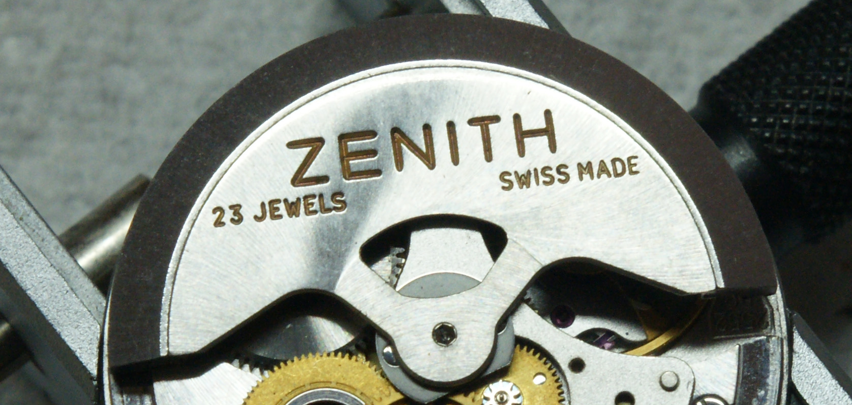

Both have big problems. The first one has the number of jewels drilled off the rotor! The second has a rotor that says 23 Jewels... and the 2542 PC is a 25 Jewel movement. So they are both replacements.

Haha I knew someone would beat me to this by 17 seconds. But you missed the second problem so only half points. 😉

The rotors of many if not all of the 25xx automatic movements are interchangeable between references, so count the jewels!

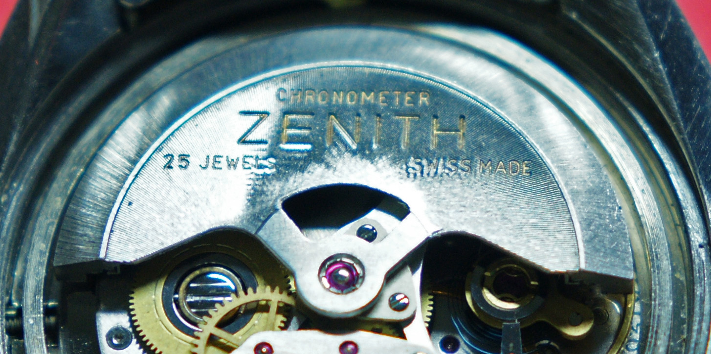

3,070
3,535

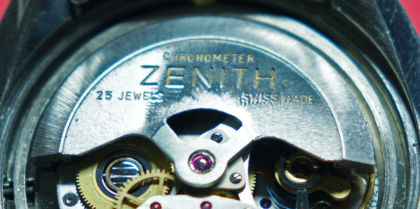

Sorry to throw this into the mix but I thought I would post clearer pictures of the two oscillating weights that I know from the 25x2 P series.
First is up to 2542 (25 jewel) This actually from my Turtle
Then from 2552 they corrected a recognised weakness - the post on which the weight rotates was prone to failure.
This will also give you a clue as to where the missing two jewels went.
The 2562 is the same as the 2552 and I don't have a 2572 to compare.
I don't think the weights are actually interchangeable without also changing the post or perhaps even the whole auto-winder.

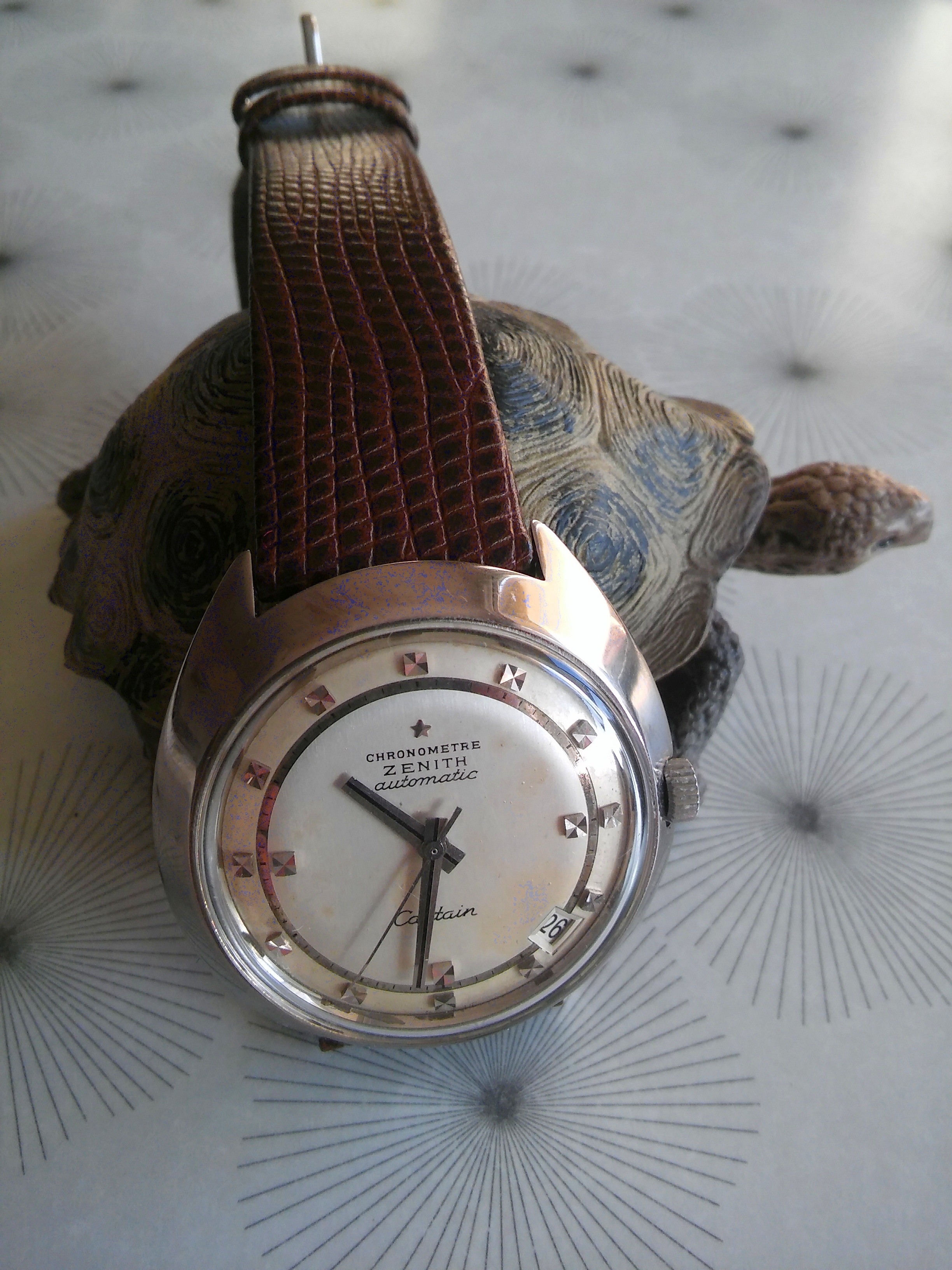

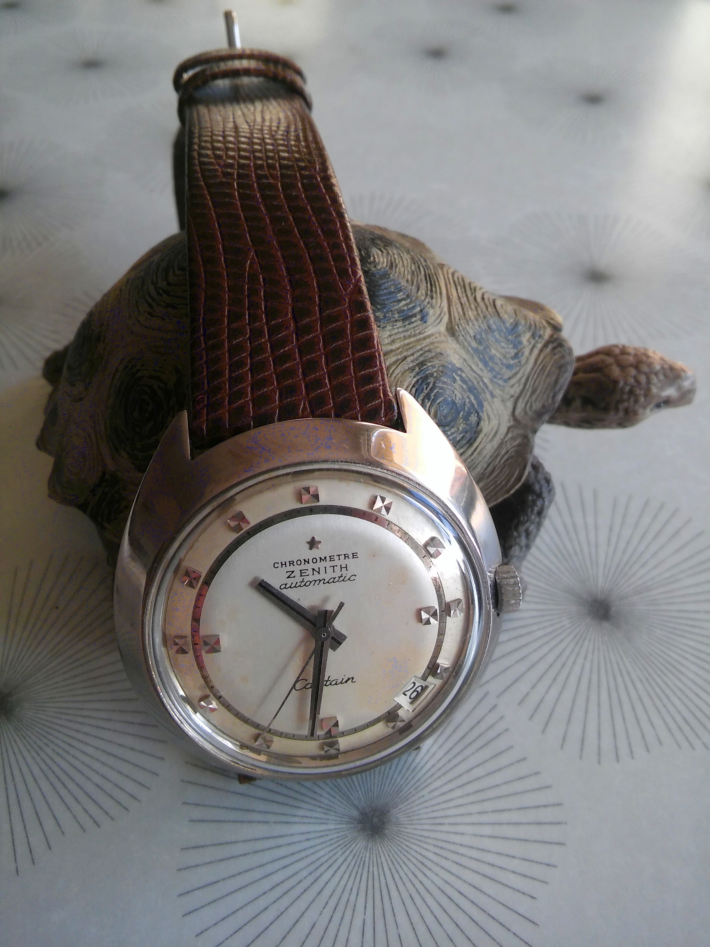

Well I have already done that and I am hoping that I will be lucky enough to find one soon enough. By the way here is my turtle. Hope you like it even if she isn't entirely correct:

American turtle on exotic toad.
As we all know the fable wins the slow creatures at the end…😀

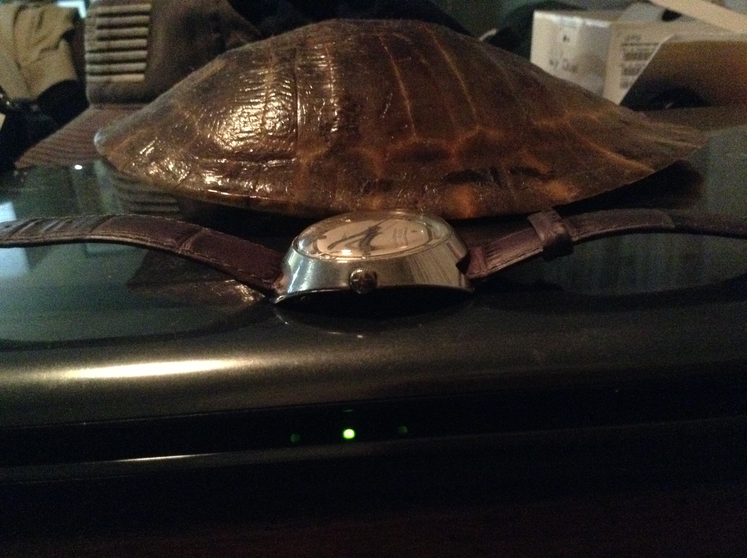

Bump this thread with my 2nd turtle..
..and with "the american friend".
