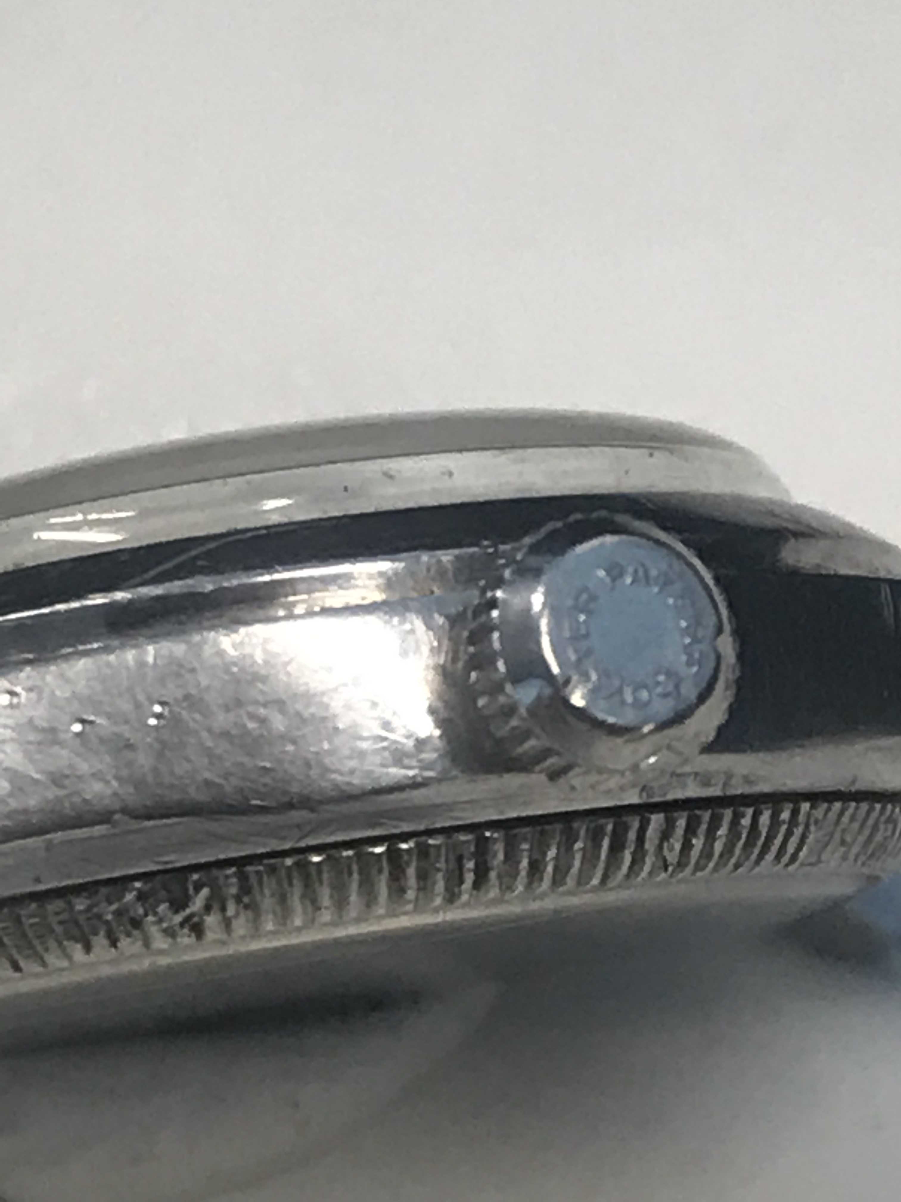

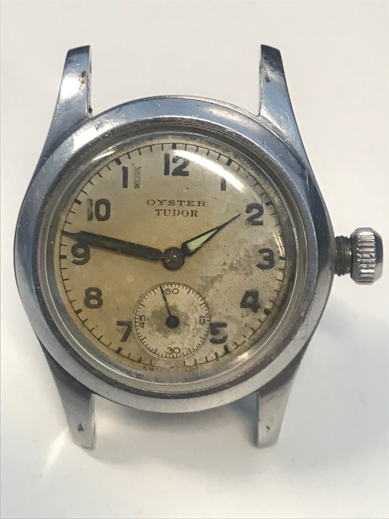

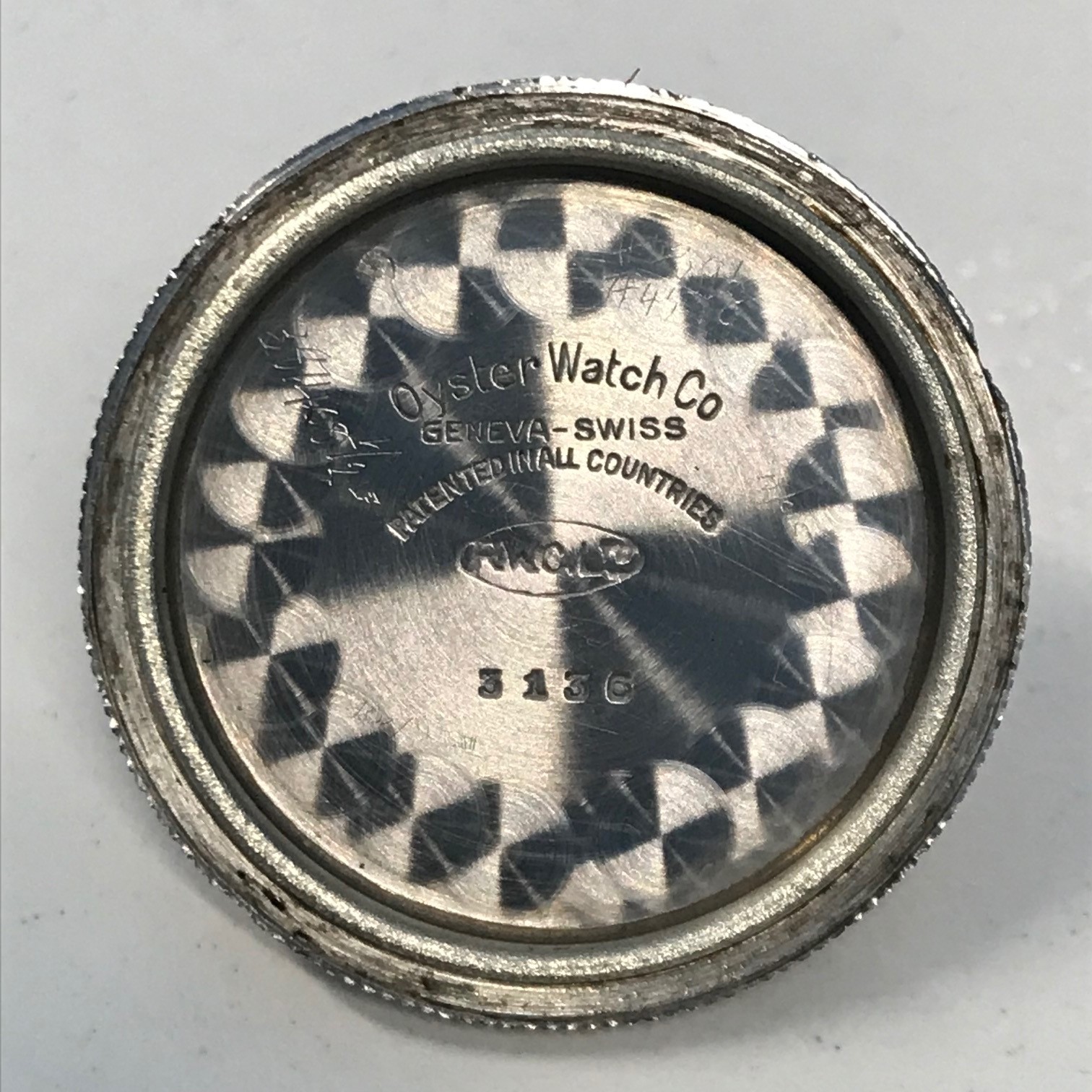

Trying to identify details of what I believe is a Tudor watch possibly from the 1940's. There is no maker logo on the dial and the word Oyster above Tudor. Not running but crown screws down and i can change the time on the hands. Also looks to have incorrect hour hand and some obvious stains to the dial. Watch diameter is approximately 31mm in diameter and lug size is 16mm. Case back number is 327011 which based on Tudor numbering puts it between 1960 and 1961 unless i am looking at the wrong chart as it certainly isn't from the 1960's. There are also no markings between the lugs. Any help with watch era, movement and case serial number would be helpful.

I’m not near my reference material at the moment, but IMO, your Oyster Tudor is likely 1940, or thereabouts. The way I read it, at one time, Oyster watches were a range unto their own. Subsidiary to Rolex. Since the Oyster design case was used on both Rolex and Oyster, Rolex was selling Rolex Oyster watches, AND Oyster watches. Oyster watches became TUDOR watches, so Rolex could use the Oyster name on both Rolex and Tudor watches. Your watch pre-dates that. I am not certain as to when Tudor became the name of the companion line to Rolex, but it seems like it might have been in the early to mid -1950s, or thereabouts. By the 1960s, Tudor watches were a range unto their own, and had a logo on the dial. Either the Tudor rose, of the later shield shaped Tudor logo. So the way I see it, yours fits into sort of a transitional period in time.

The serial number is 138009 and its from 1939. Given your watch is 200,000 on from that one it could be as late as the 50/60s

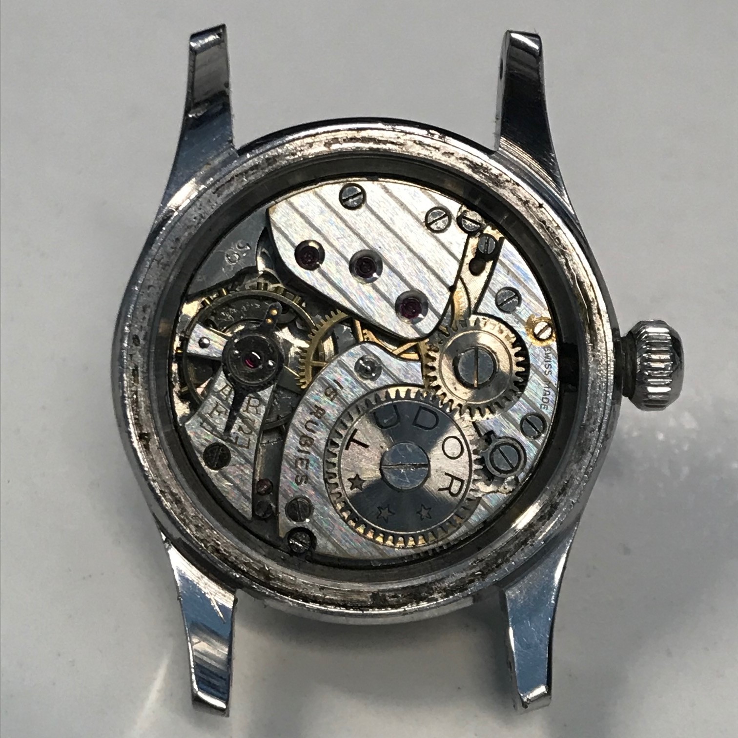

Thank you for your replies. Information is most helpful. In regards to the serial number which following the Tudor numbering certainly puts it to around 1960 but it isn't a design you would expect in this era. I have managed to get the case back off and found it also is a 3136 reference and houses the Rolex / Tudor 30 (59) movement. Hoping it may need just servicing to get it going but will also need a new hour hand and possibly minute hand to match. Any leads on these would be appreciated

I was in the retail jewellery business in the 1960s, selling TUDOR watches. And my late father was in the jewellery business in the 1950s, selling Tudor watches. By the 1960s Tudor watches were badged Tudor. And they were all equipped with KIF shock protection. The subject watch is not. And they used ether the Tudor Rose or the Tudor shield on the dial. That watch is most definitely not from the 1960 era. You can take that to the bank. I am not aware that a reliable serial number/date chart exists for Tudor watches. That watch is from the 1940s! The Ranfft archive is reportedly not totally accurate but it is a good guide. Take note of the era when the FHF 30 (Oyster calibre 59) movement was produced.
Not a Rolex movement in any sense, but an FHF-made cal 30 re-badged as a Tudor 59, which is certainly correct for this model. As @Canuck mentioned, the lack of shock protection suggests that it is from no later than the 1940s.

Thanks again and I also believe the watch to be from the 40's. Would the watchmaker marks give a clue with service dates. One line looks to be #45518 which could be a date

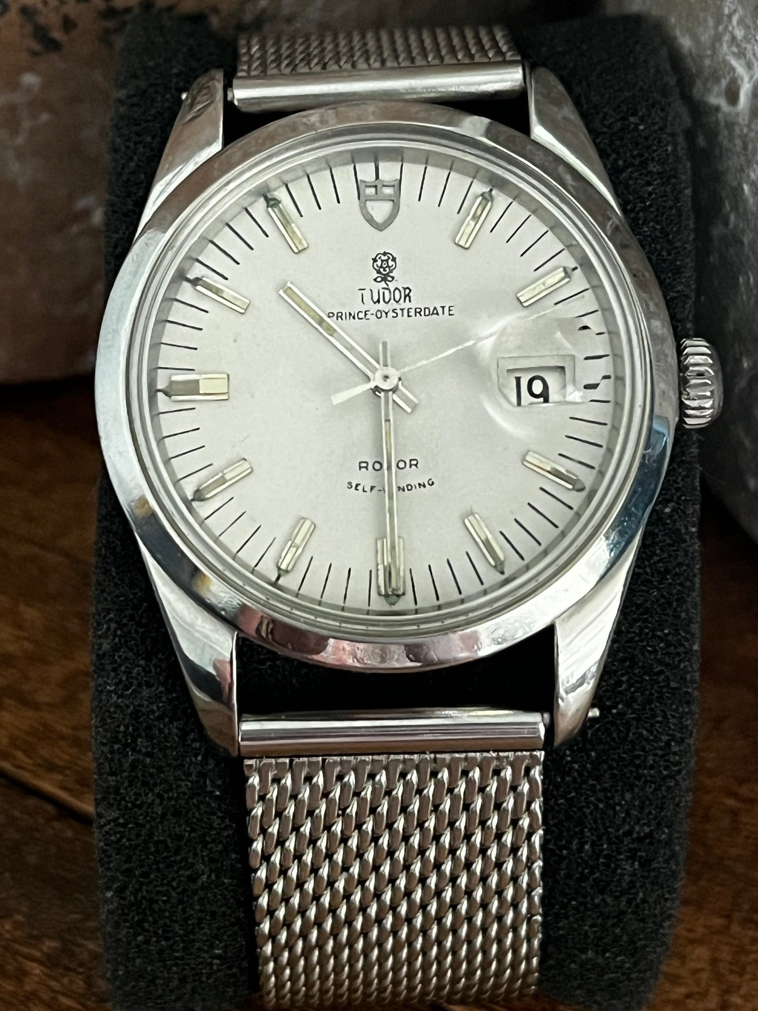

The image I have uploaded is of a Tudor watch sold to a family member by my late father when he sold Tudor watches in his jewellery store.. This watch was sold in 1955. It has had a hard life. It was sold to a cousin of mine who worked in construction, he was a millwright, and an auto body mechanic. It was originally sold in a gold filled case which was not up to the use it was given. I re-cased it for him circa 1985, in a steel Rolex case. Note the dial. By the late 1950s the TUDOR name was prominent on the dial. At this time, Rolex sold Rolex watches and Tudor watches, both using the Oyster name. This one was known as a Prince Oyster Date. The Oyster name was no longer dominant, but secondary to the TUDOR name. Also, notice that above the TUDOR name is the TUDOR ROSE. This is how Tudor dials were marked after about the early 1950s. If you need more examples of Tudor dials of the ‘50s and ‘60s, I have them. Back to the watch owned by the OP. IT IS FROM THE 1940s!
15,935
47,853
This dial perhaps better shows the dial markings for Tudor, in the 1950s. Notice this is a TUDOR watch, after Rolex changed the name for Oyster watches, to TUDOR, for their subsidiary watch brand. The TUDOR name is dominant, and you will notice by the 1950s, the Tudor Rose emblem was added to Tudor dials. Until this re-branding occurred, the OYSTER name was dominant, and the Tudor was secondary. And there was no Tudor Rose on the earlier dials. Rolex began to realize what an asset they have in the OYSTER name, so it was used to signify an Oyster case on both Rolex and Tudor watches.
The private numbers watch repair people use are often meaningless to anyone but themselves. Unless you see a number like 09/17/49 (for example), it is anybody’s guess when it comes to interpreting these numbers. Don’t confuse numbers that are die struck into the interior of the case back by the case maker.

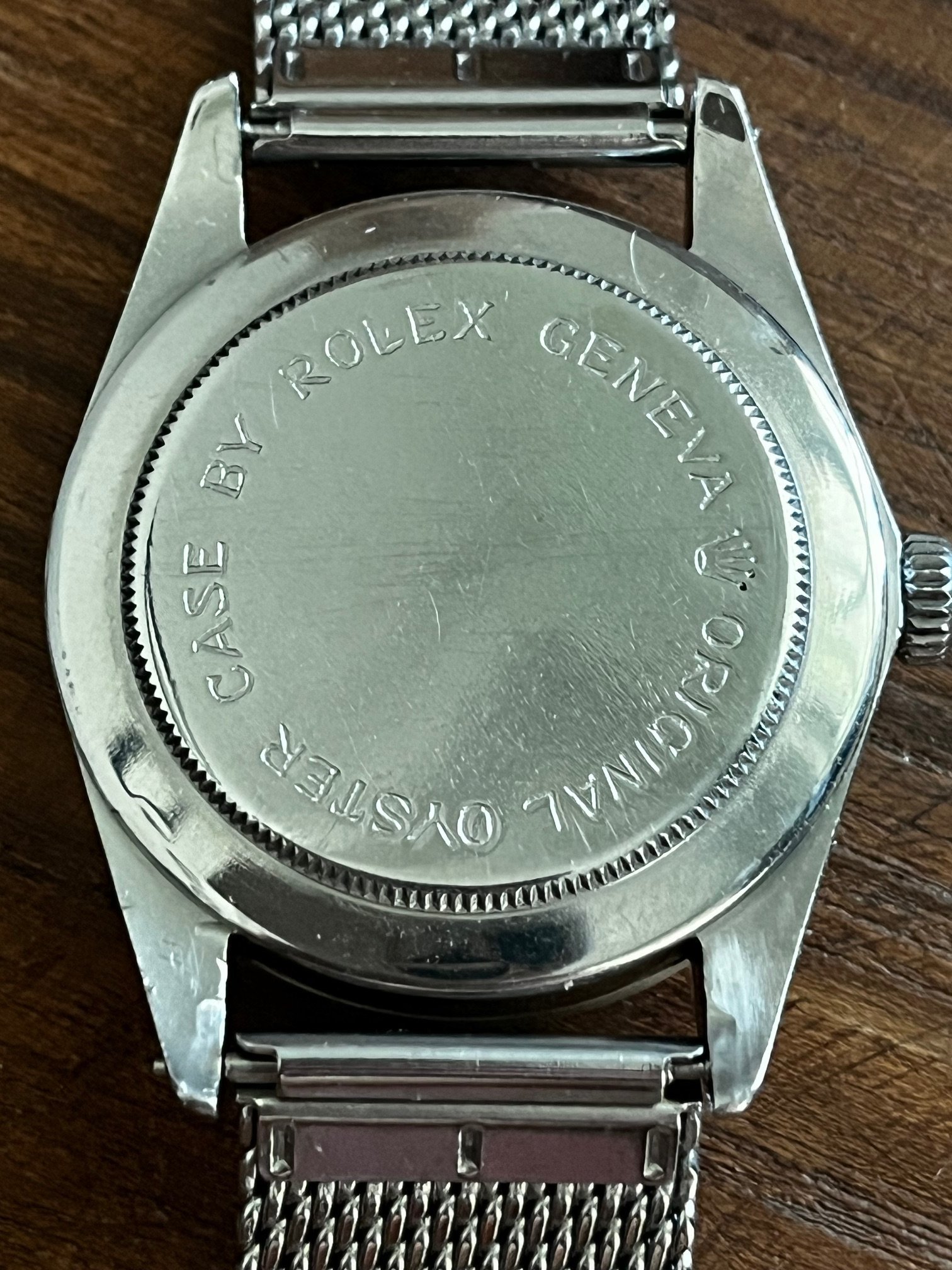

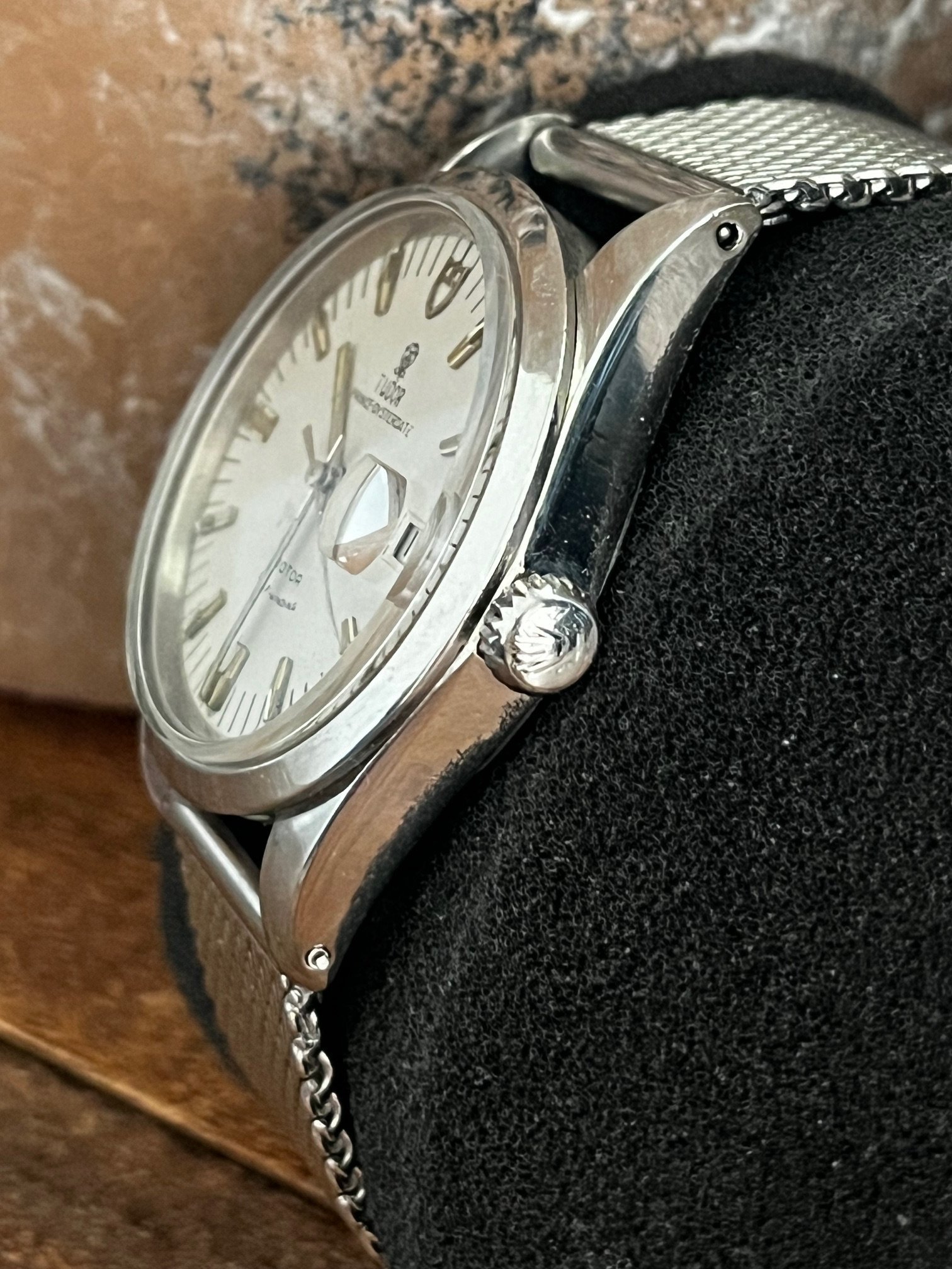

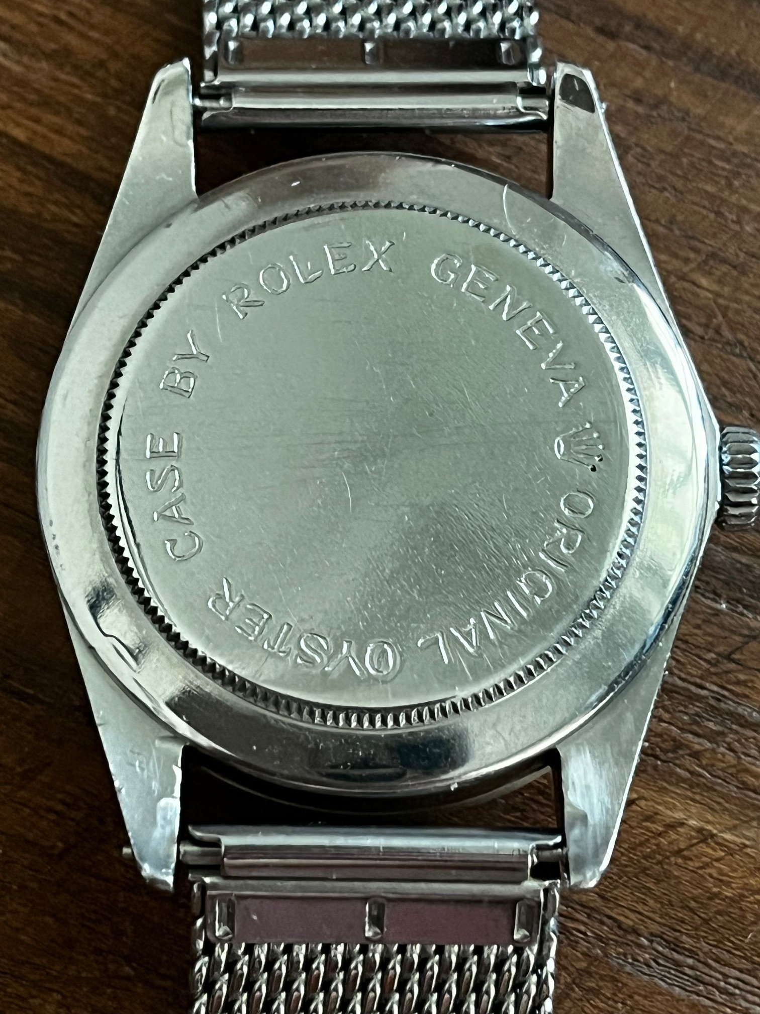

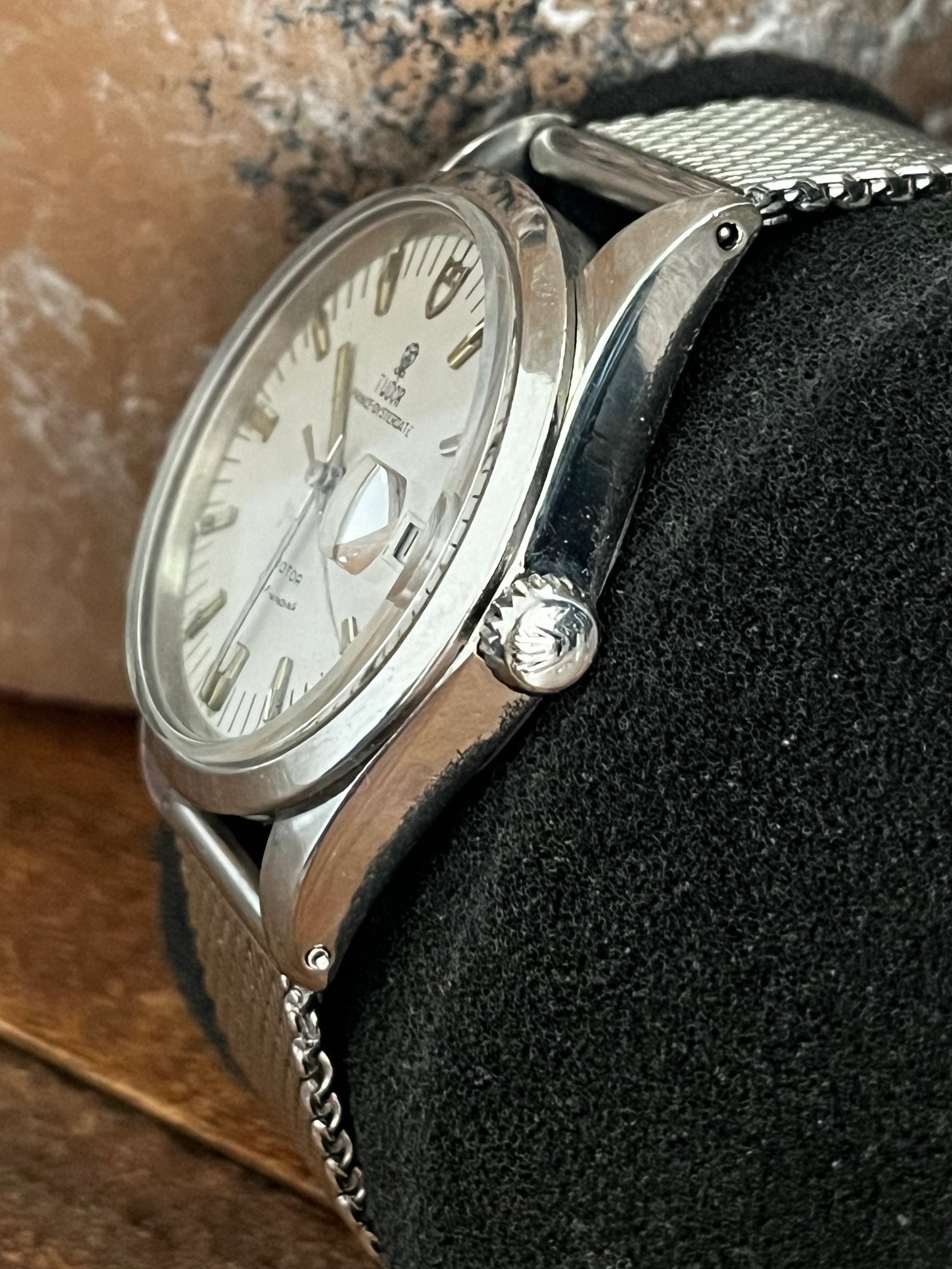

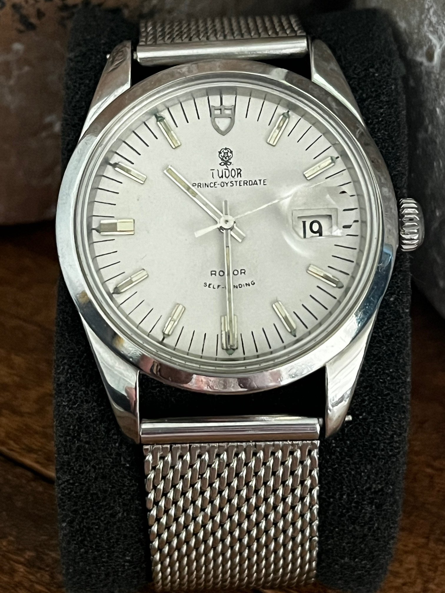

I recently inherited a Tudor Prince Oyster Date but am struggling to find the year and model of the watch. I found several similar watches online, one of which is posted above, but none of the models I have found have the Tudor logo in place of the 12 AND the flower logo on the face. Below are pictures of the watch. Can anyone advise what the year and model of this watch is? Thank you for your help!
13,489
31,802
Probably not going to find that dial anywhere else as it appears to be a pretty bad redial using typography from an earlier watch.
