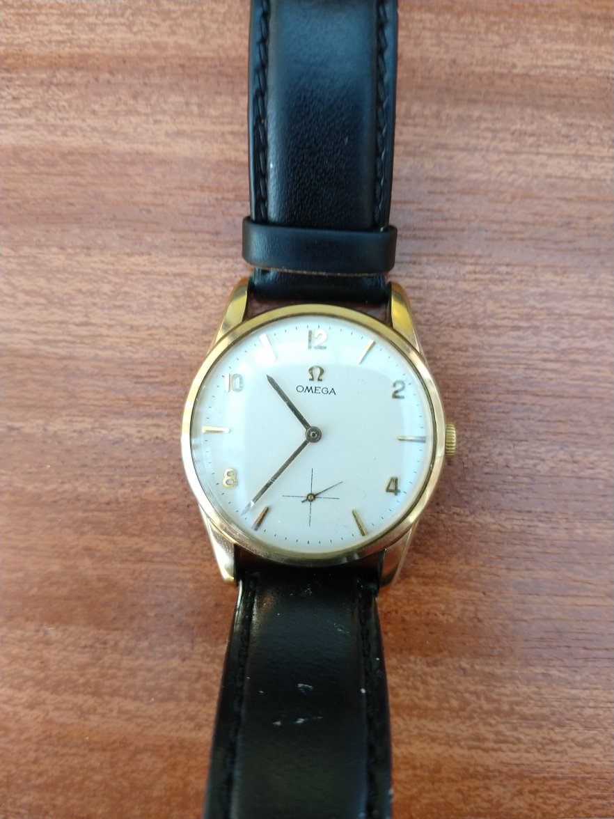

Hello all and thank you for allowing me to join the forum. I have been lucky to inherit an Omega from my father who inherited it from his father who was given it as a retirement present from his employer.
I have managed to find some information such as the movement serial, which Omega Archive has confirmed as a Calibre 269 manufactured on 8 December 1964 and then shipped to the UK.
But here is where I need some of your expert knowledge. They were unable to find any other information on the watch and I am now stuck!
It does have a national case number. I don't really know what that means and am only assuming that the movement was put into a watch that was made here in the UK?
I would be very grateful if anyone could give me any more information or where I might be able to get any information that is available.

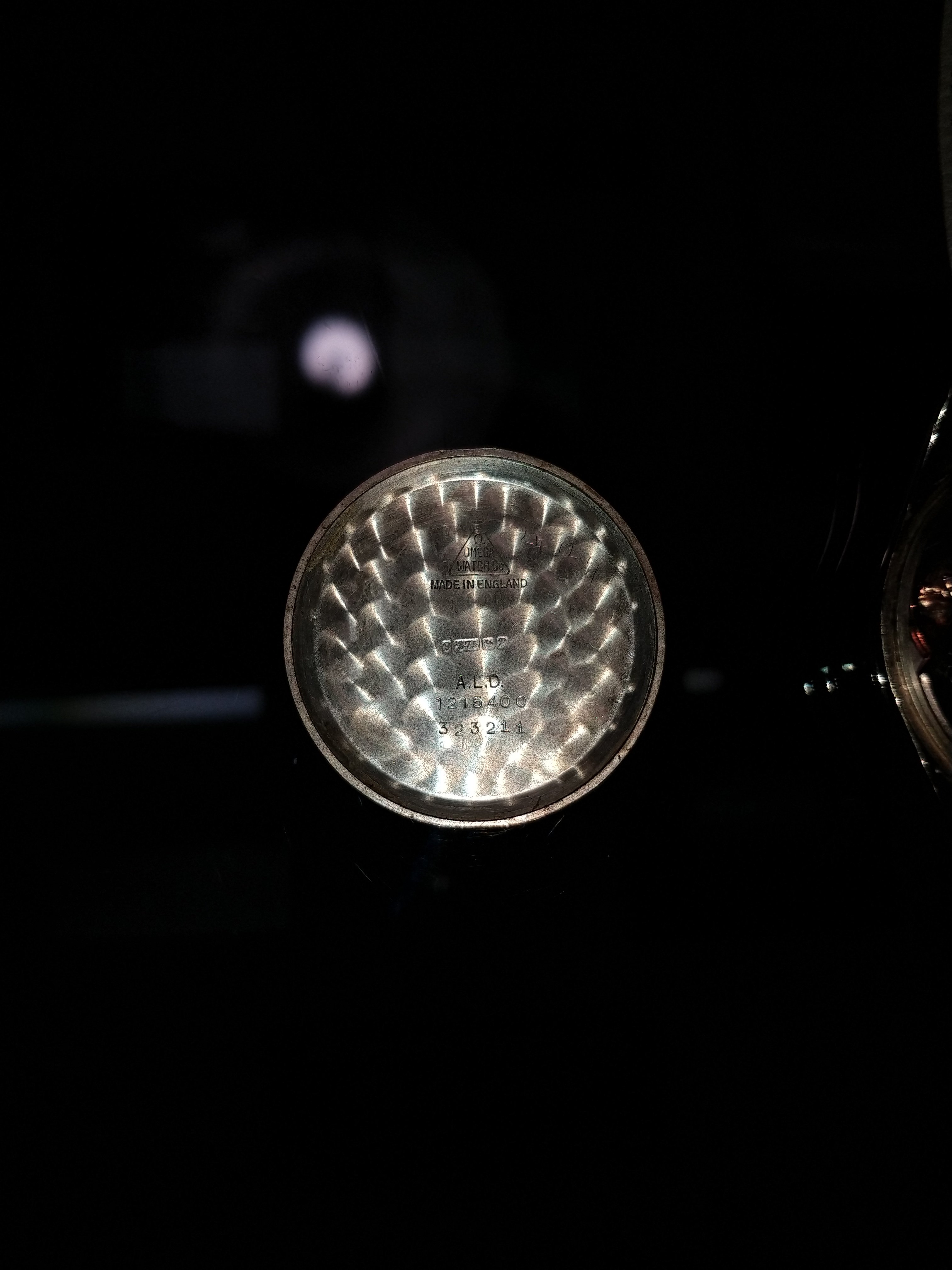

no need to remove the movement. Just have the case back removed and take a good photo of the inner side of the case back - there is the info we need to see.
You can add a shot of the movement (altough we know how a cal. 269 looks like) but we can judge the condition of the movement.
The numbers you provided: the 6 digit number of the case might be a Dennison reference number

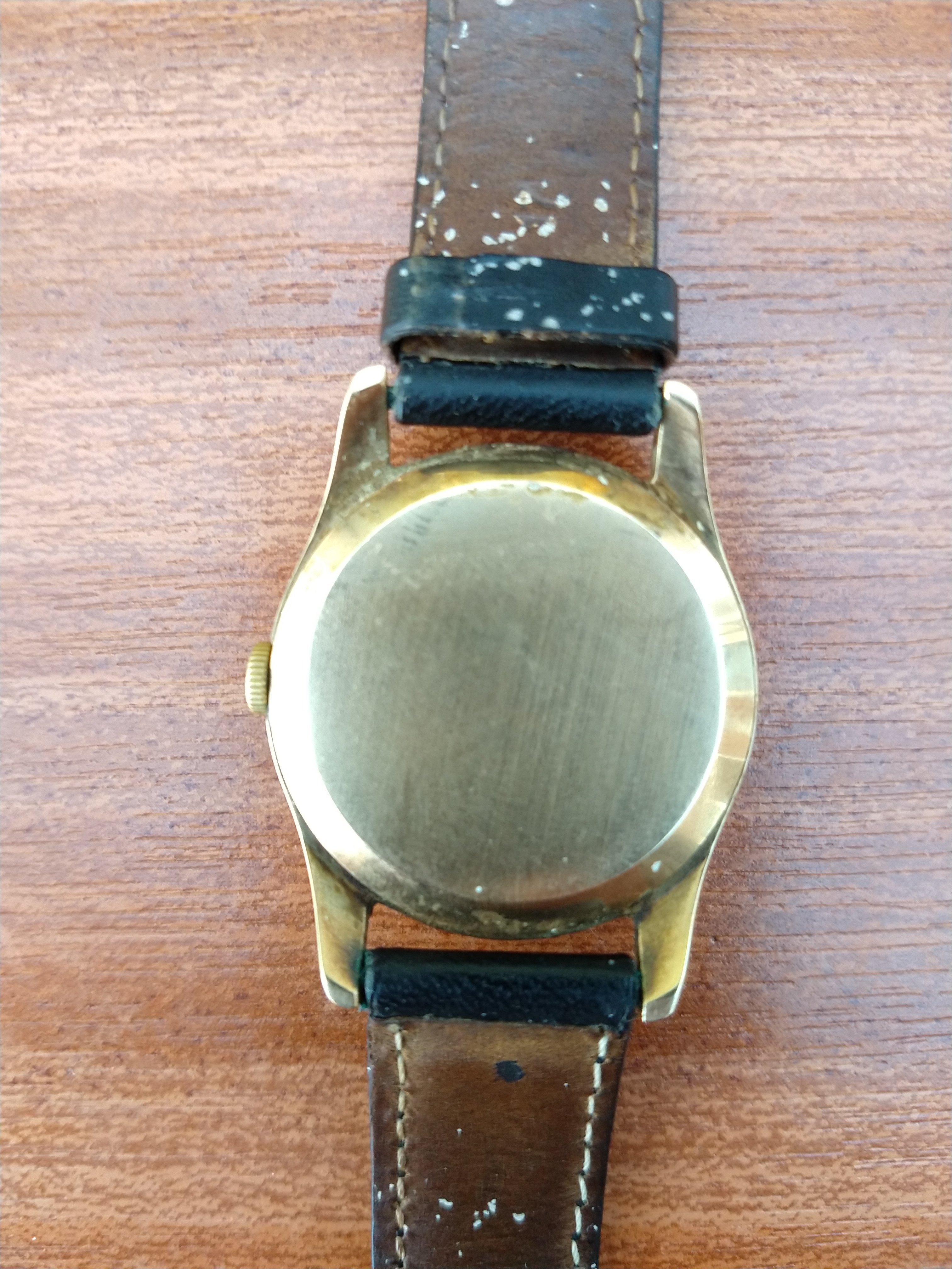

Afternoon again

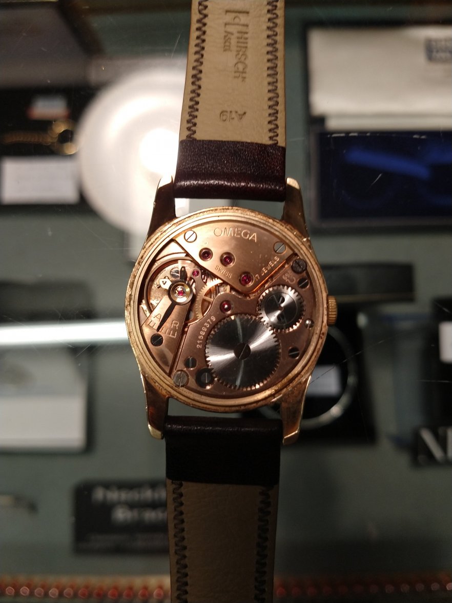

I have had the back removed and here are the photos. I hope they are good quality enough for you to get the information you are looking for, the watchmakers was a little dark!

As supposed in a former reply it is a Dennison case produced in the UK: 9 carat .375 fineness as the hallmarks indicate.
Further it has the anchor hallmark (assay mark) for Birmingham
1215400 is the case serial#
323211 it the Dennison (factory internal) reference#
so all you have to know is obvious now

You may not be able to get much from the photo, but how does the movement look. I assume having it serviced would be a good thing regardless.

Movement looks clean - but you should always service a movement when you are not sure about the service history or when it has sat in a drawer for a long time. The oils dry up over time and the movement takes damage if you wear the watch in this state.
The case screw (upper right in the photo is corroded and should be changed during service.
Have it cleaned and lubricated by a good watchmaker in your area who is used to work on vintage watches - avoid battery changers who often call themselves watchmakers...

I'm not a watchmaker, but the movement looks relatively clean for a watch that probably hasn't been serviced in a long time! There are some watchmaker's markings on the inside of the case back, though, so it has been serviced at some point. Maybe it's the picture quality, but I see some smudges around the main spring and the screw around 2 o'clock seems rusty. You can try and find a watchmaker who has experience with Omega movements, preferably someone certified. I reckon some UK folks out here can recommend particular watchmakers. The cost of servicing will be a couple hundred, just so you know.
