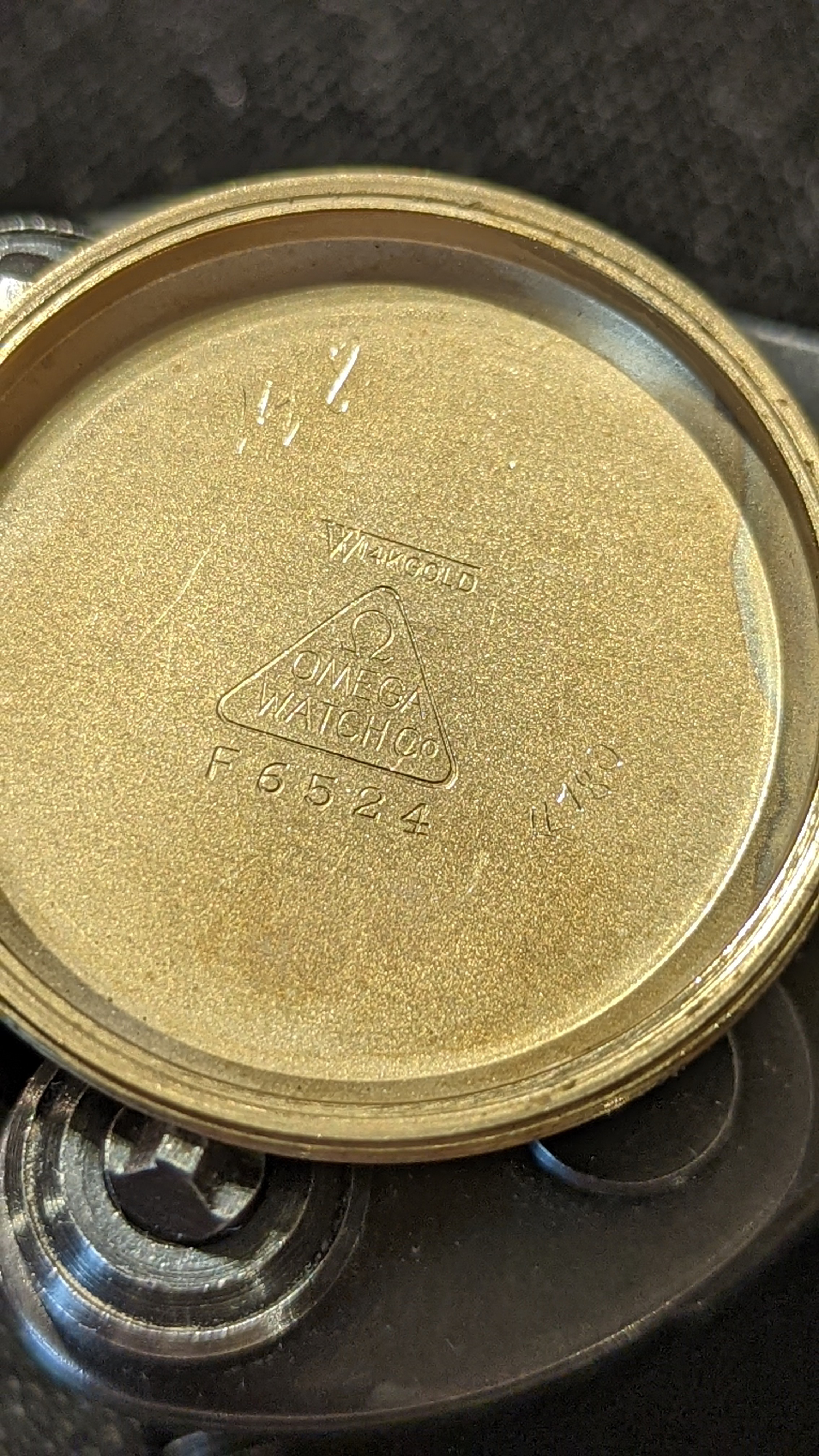

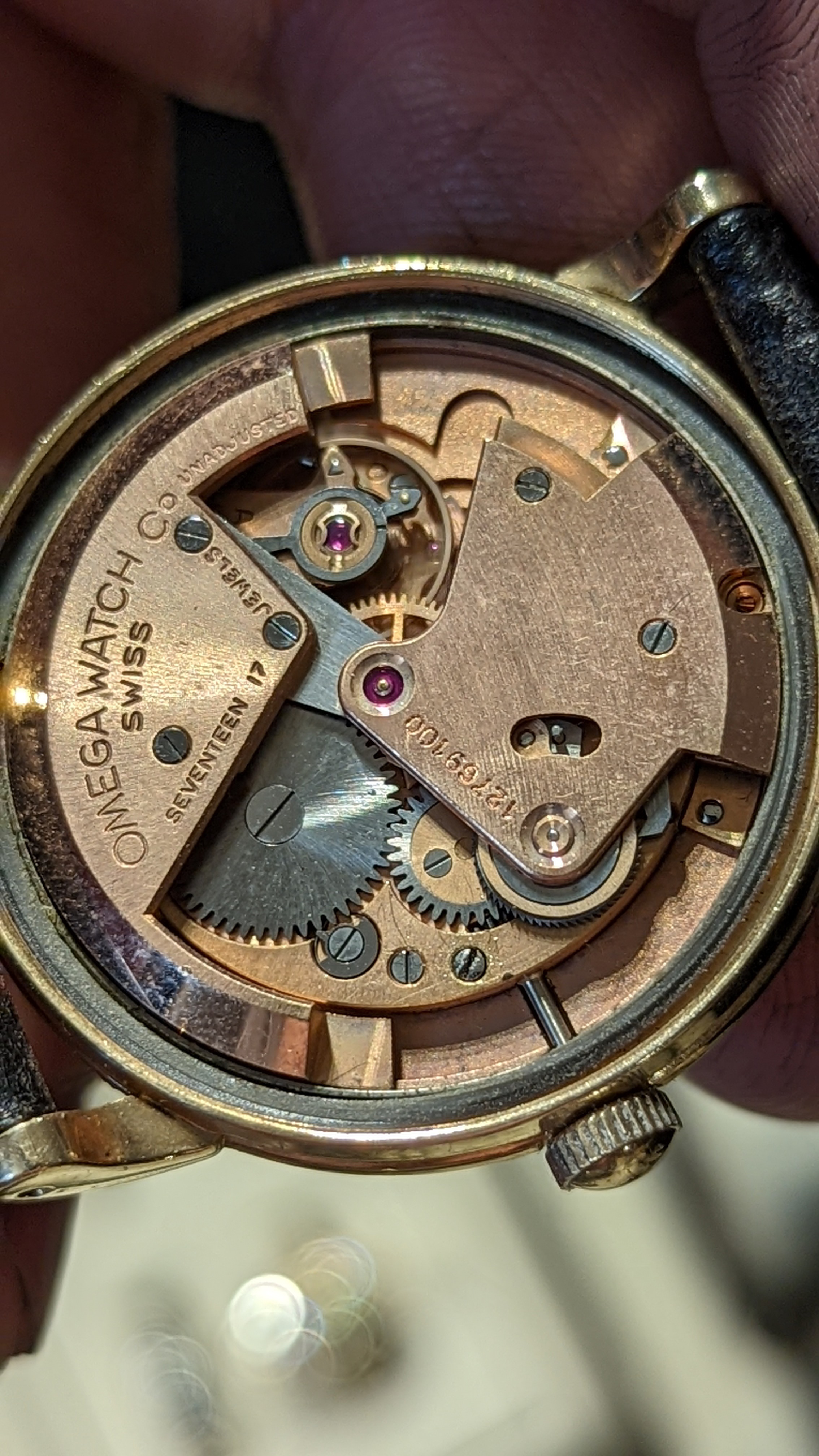

Trying to fish, looks like a caught a decent bumper, Wadsworth case F6524
2,077
4,245

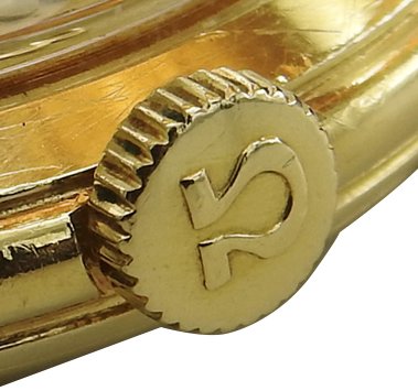

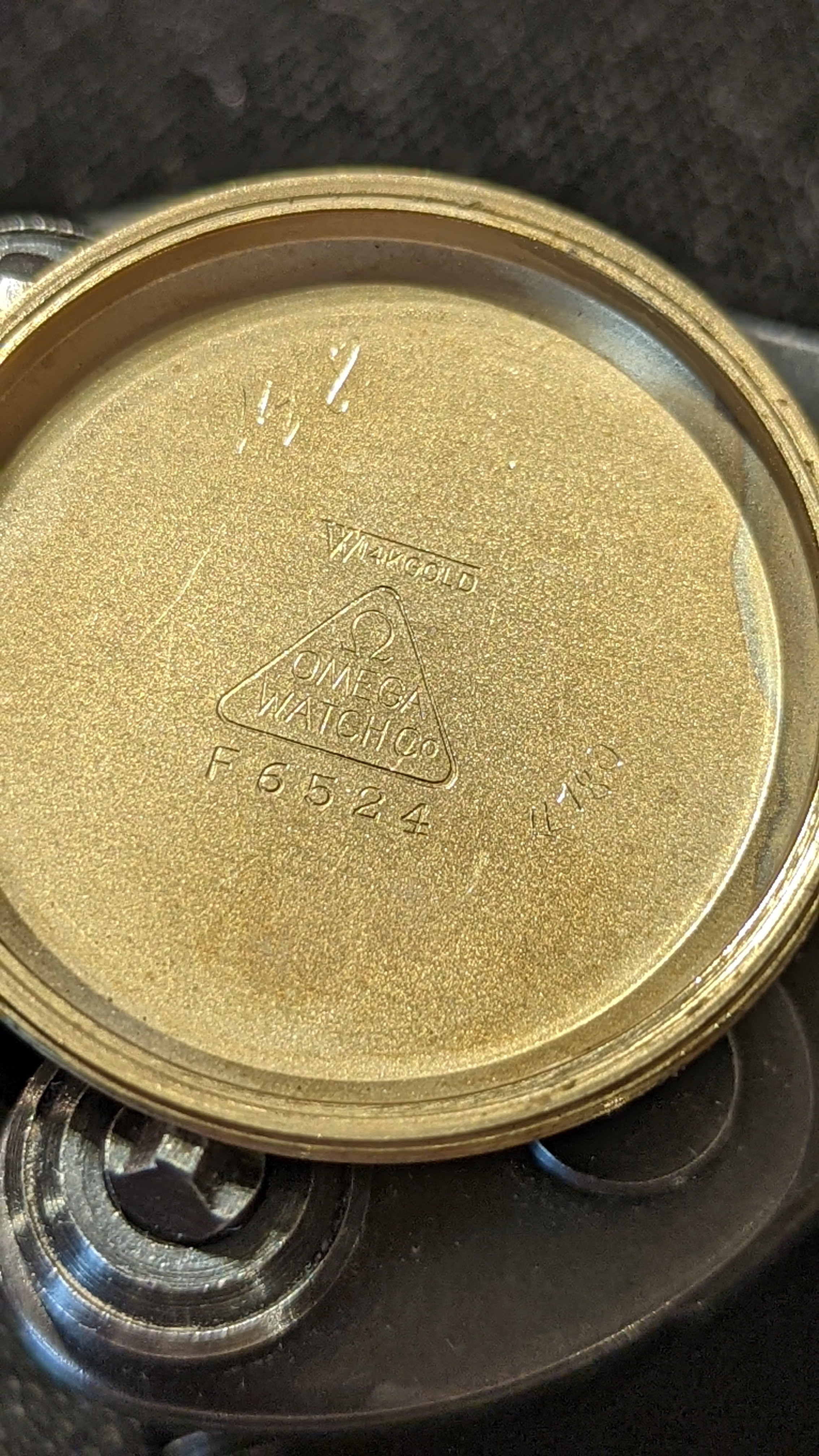

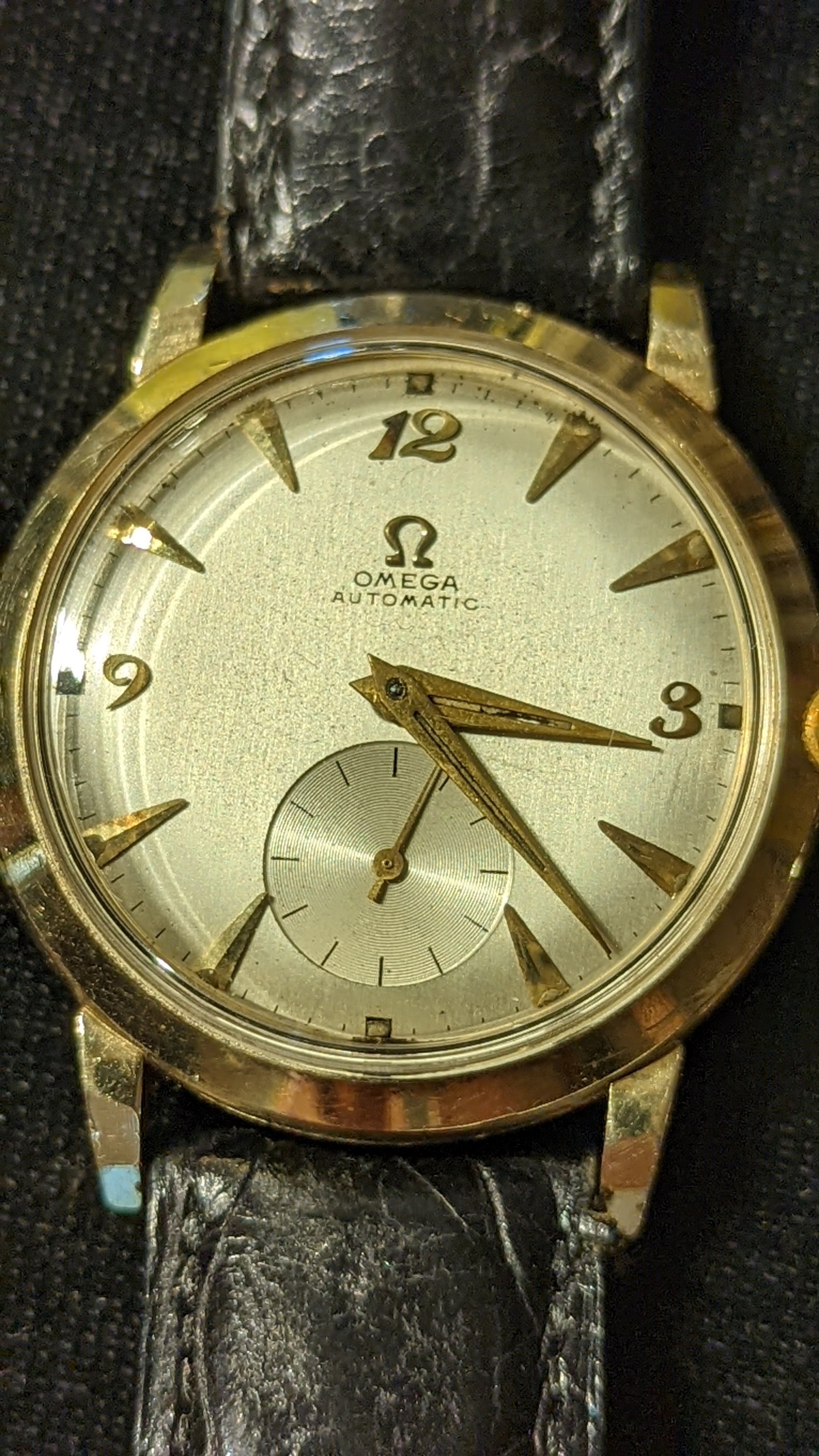

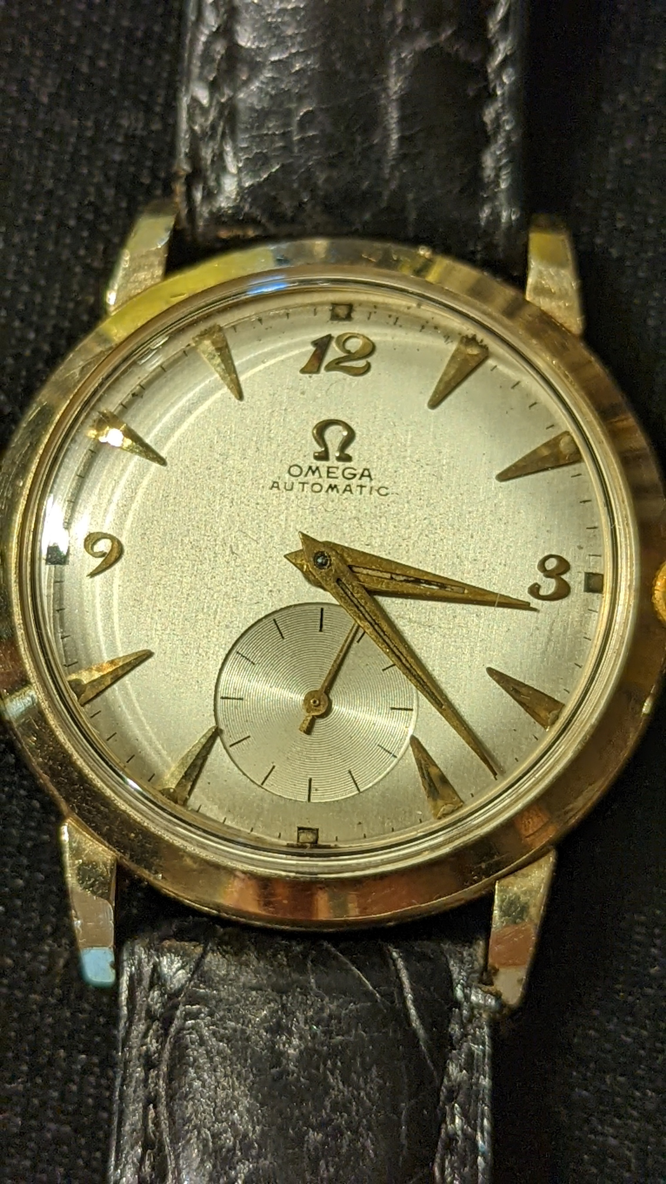

Came across this in my local watchmaker. Looks the be a correct dial and it's running well. I know it's not the correct crown already and we're looking for one for now. Seems to have a bit of polishing but the lugs seems solid. Lmk what you think.
24,815
55,164
F6524 would be some sort of reference from Wadsworth (US case maker for this imported watch), but it doesn't mean anything in the context of the standard Omega reference numbers. The style does look similar to some of the early Seamasters.

Seems like a nice gold filled bumper. Wadsworth case as Dan mentioned so that reference won’t tell you much. Nice, nonetheless.

How do you find a reference number on these 3rd party cases?

14kt solid, can see the lug better here.
That number is a reference number but it’s a Wadsworth reference number. The watch has no Omega reference number. However sometimes the nationally cased watches mimic some of the Swiss references pretty closely. And sometimes they are completely different.
Okay, I get ya. So Wadsworth would have ordered a dial and movement and built them in locally in the US with their own cases?
It was definitely a partnership between Omega and various local case manufacturers in different countries.

The other one I saw previously on the forums is a F6524 1 and has slightly more angled lugs. It has also has a flat profile crown which they say was original. Are these hard to come by? Is there a part number I should look for?

"The Wadsworth Watch Case Co., Newport, KY, came into existence in 1892, a descendant of H.A. Wadsworth & Co. It remained in business for 61years, until purchased by the Elgin National Watch Co. in 1953."
So these were some of their last cases. Wild.
4,368
12,950
Omega, and other Swiss companies, would send uncased movements and dials to the US, France, England, and have them cased in that country to avoid import duties on gold.

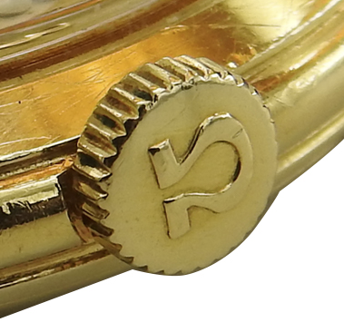

Note how the straps are constructed. You can occasionall find NOS straps on eBay from J-B "Champion" or Kriesler. Note that the strap size to fit that case is likely 11/16 of an inch.

Oh wow, i didn't even think that the strap size wouldn't be metric. but cased in the US in the 50s, sure, that makes sense. I'll keep an eye out for those names.

Since it can be hard to find the strap you want in those odd sizes these days, people will often use a metric strap that is "close enough".

Dan is correct, what is sold as 17mm nowadays is usually just oversized enough to fit those old cases, but it can be fun looking for a vintage NOS version on eBay, there's a lot of them out there.
