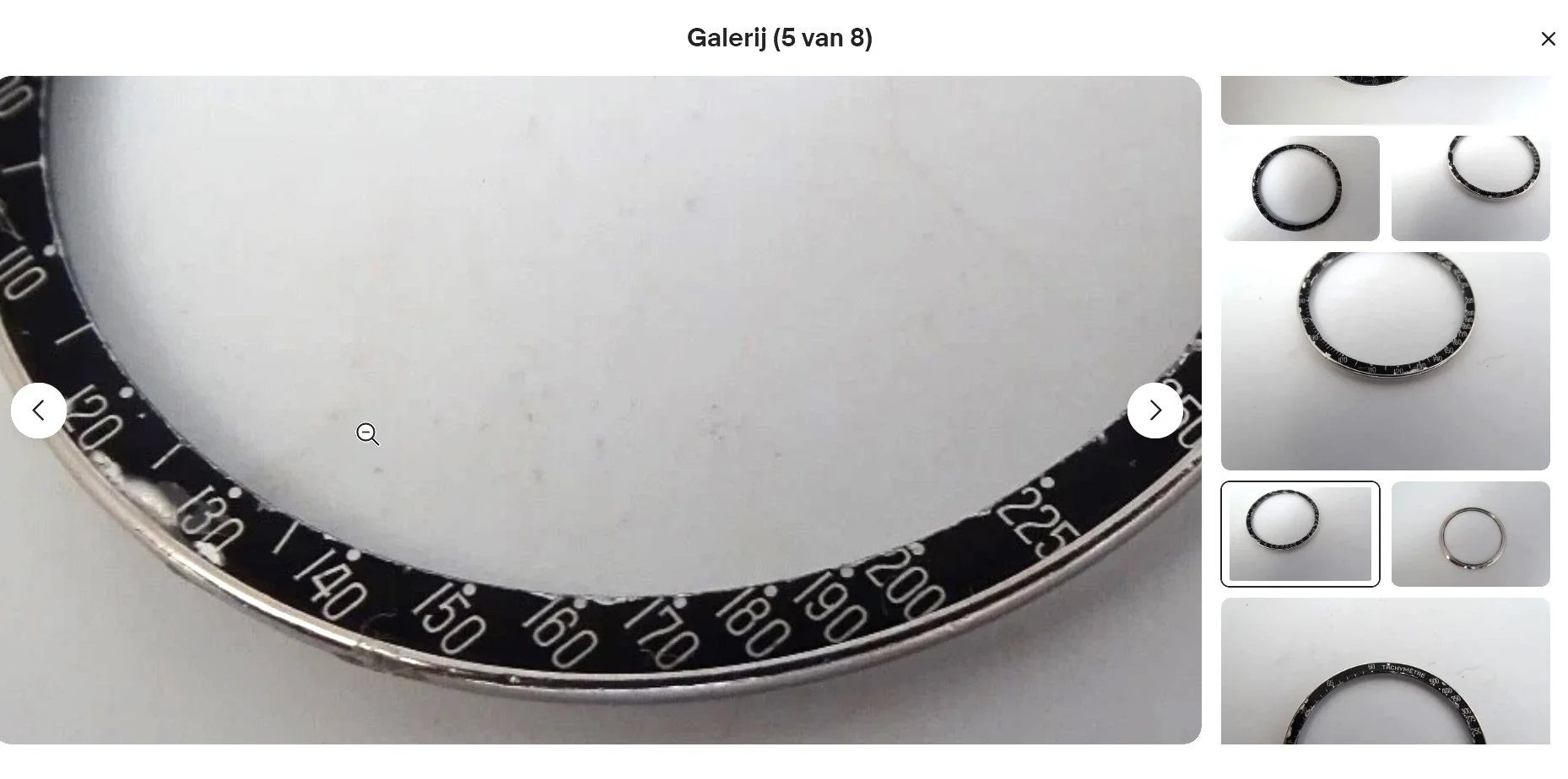

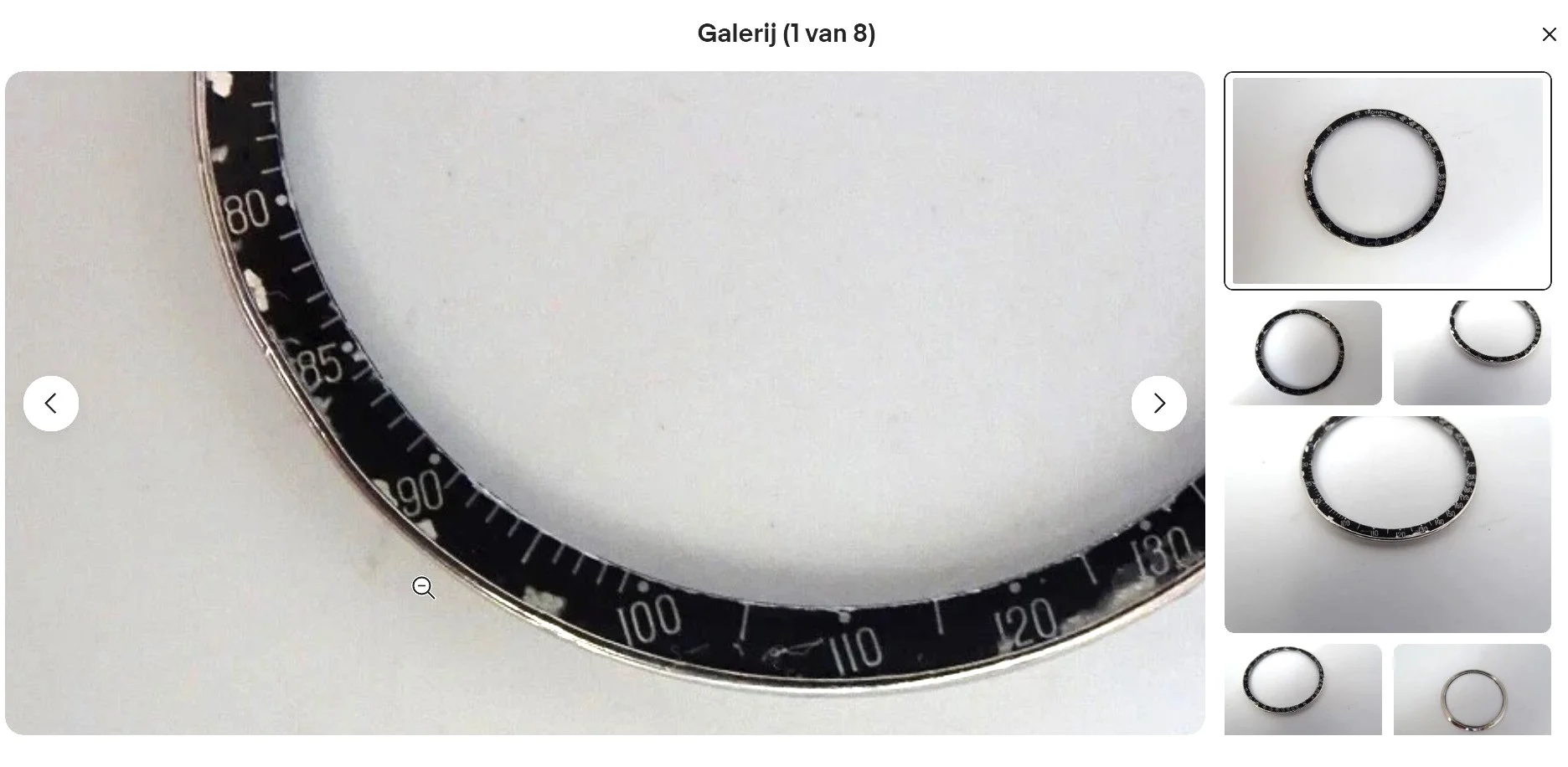

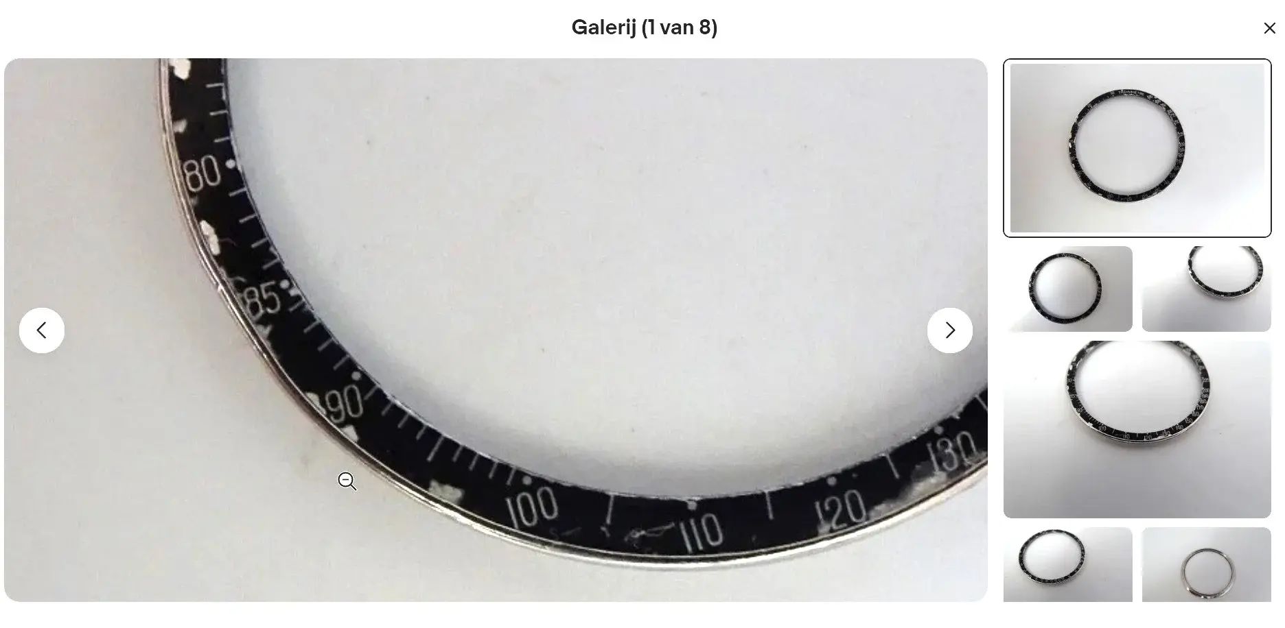

True or Fake bezel Speedmaster 321 DON 105.003 105.012 ?

If that’s a fake it’s a damn good one. The analogue imperfect look of the numerals is very hard to replicate and this bezel looks very convincing to the eye. Having said that though, there is big money in these little pieces of aluminium so it wouldn’t come as a surprise if someone actually figured out how to make them look convincing enough

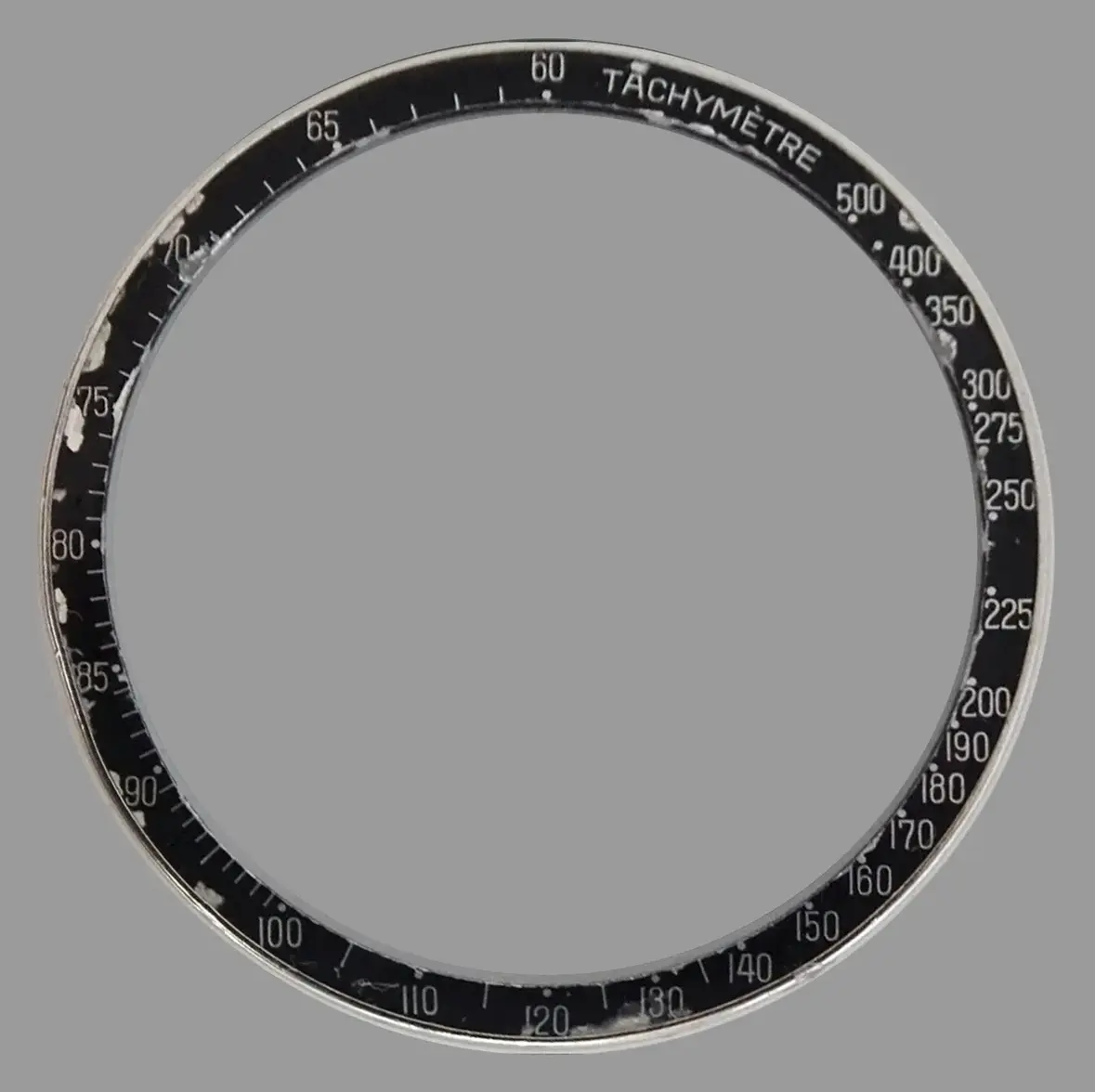

Compare to the one from Moonwatch Only. (I presume they don't mind me sharing because it's a free plug for their book)
Anyway, the one on ebay looks like trash and I'd never pay 1800 usd for it. I'd rather have a service insert than that.

Thanks, and i am not looking to buy this one just curious to see if it is legit.
Maybe @hansaboy and @Spacefruit have a moment to look at it ?

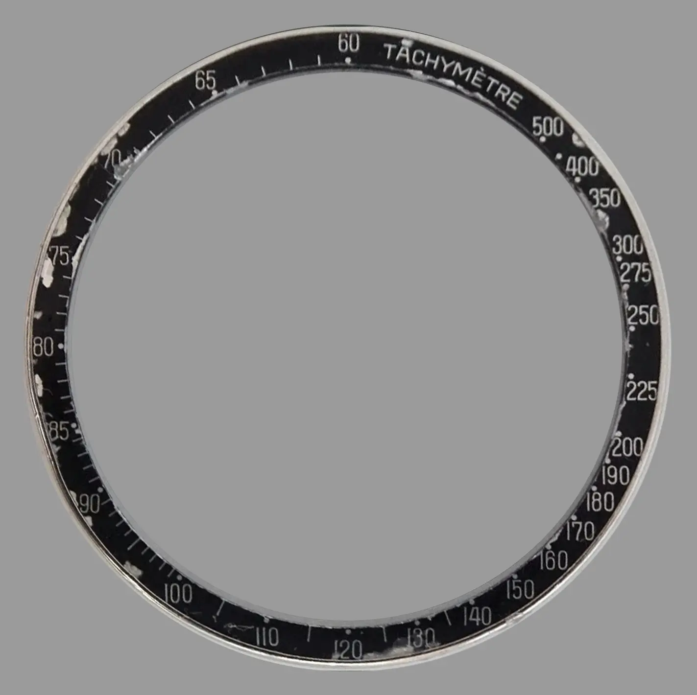

Poor example but it checks out.
I was waiting for one of your amazing overlays 👍
Thanks , that is amazing and very helpfull ! My eyes were deceving me.
That’s brilliant!
Even if it’s real though, I can’t believe they want $1800 for it. Chipped all over and with a massive dent in the side. Your overlay really shows how demolished this one is compared to a good example!
For the record; they don’t. Asking is 1,5k USD with best offer possibility. Still rich given condition.

That’s brilliant!
lots of wishful pricing in the bezel world. not worth it obviously but someone might just bite if they are desperately in search of one.

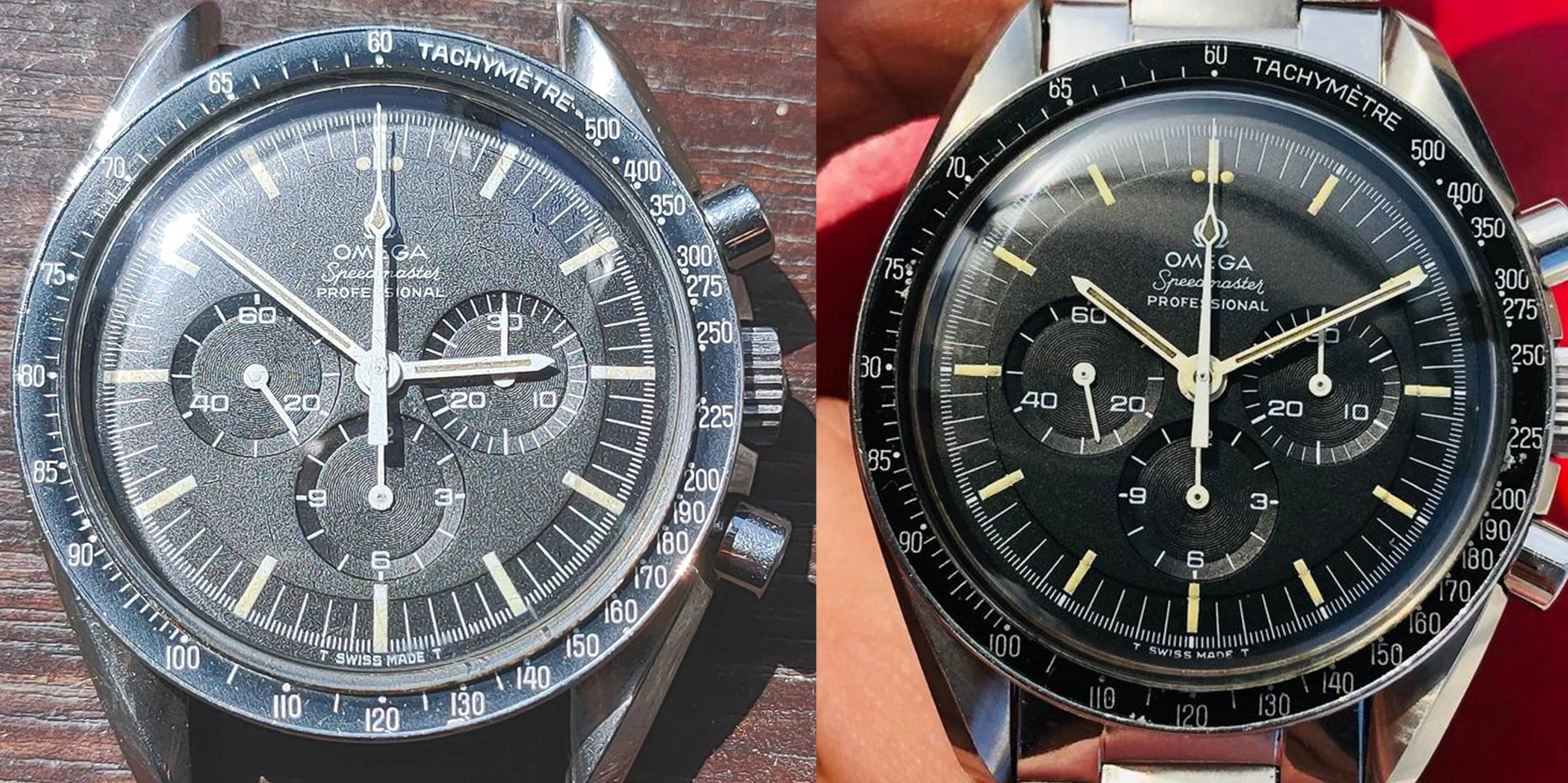

It’s an original older, thin font bezel.

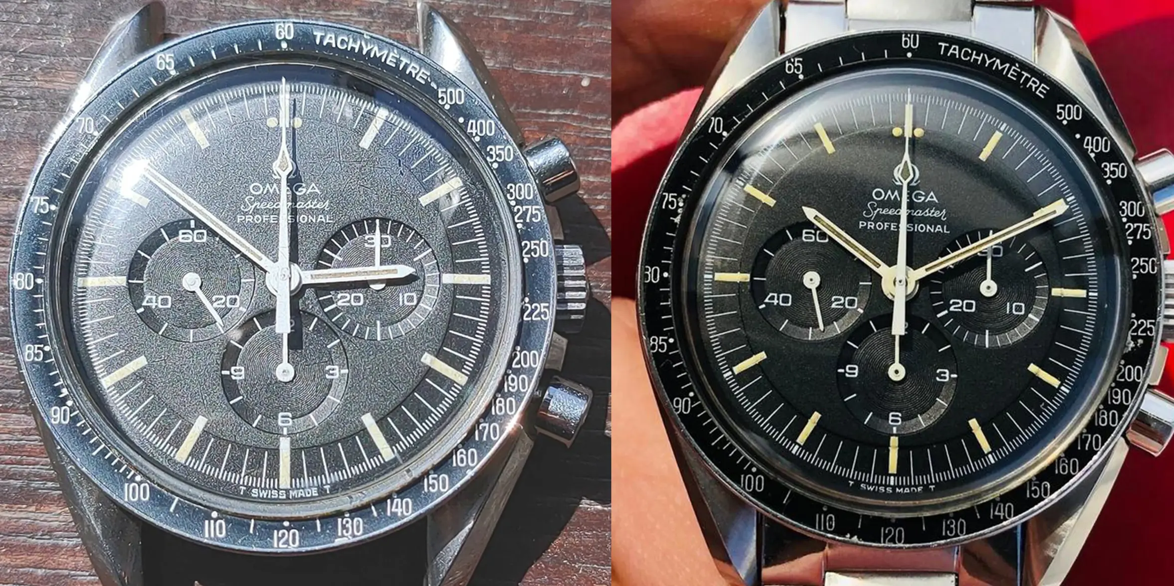

How come some of the inserts have really big numbers with thin font that extends off the edges of the bezel insert, and others it’s much smaller and all fits on without clipping? I always thought the ones with smaller numbers were fakes.
185
84
This is what I meant with my last question - one has numbers extending off the bezel and the other fits within the frame. I have never understood why there is this variation
My recollection is that this is just variation in production. Omega stamped the bezels, with sharper results on the early prints. As the stamps aged, the fonts got fuzzier and fatter. Also, some batches were closer to the edge. They were within acceptable tolerances.
Forgive me for not citing a source. I remember reading threads on this, which probably were written by Spacefruit. You might be able to find them in a search
