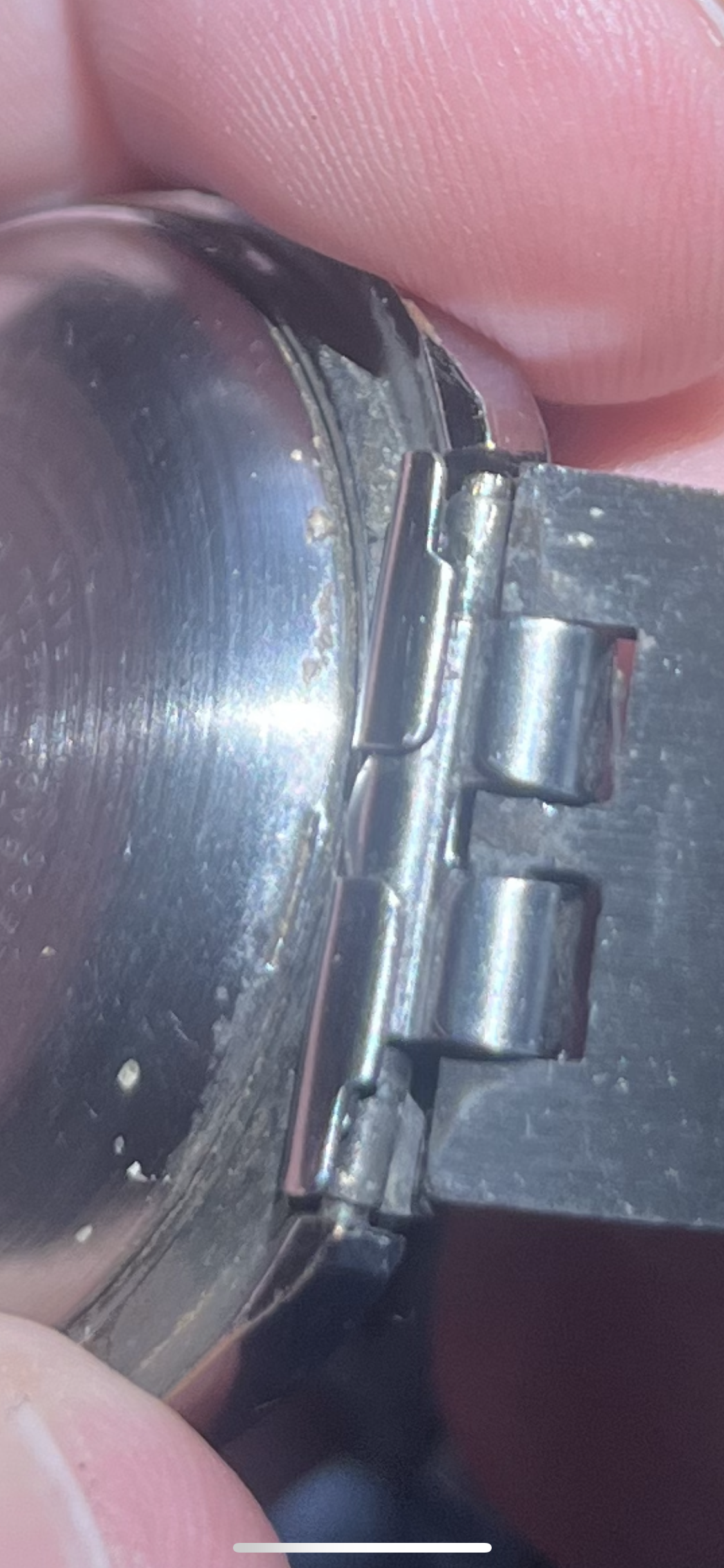

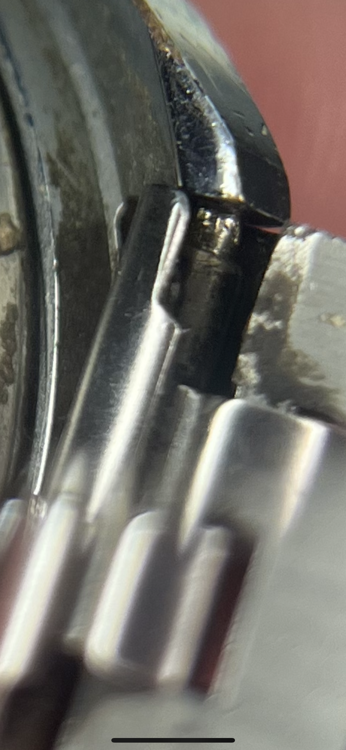

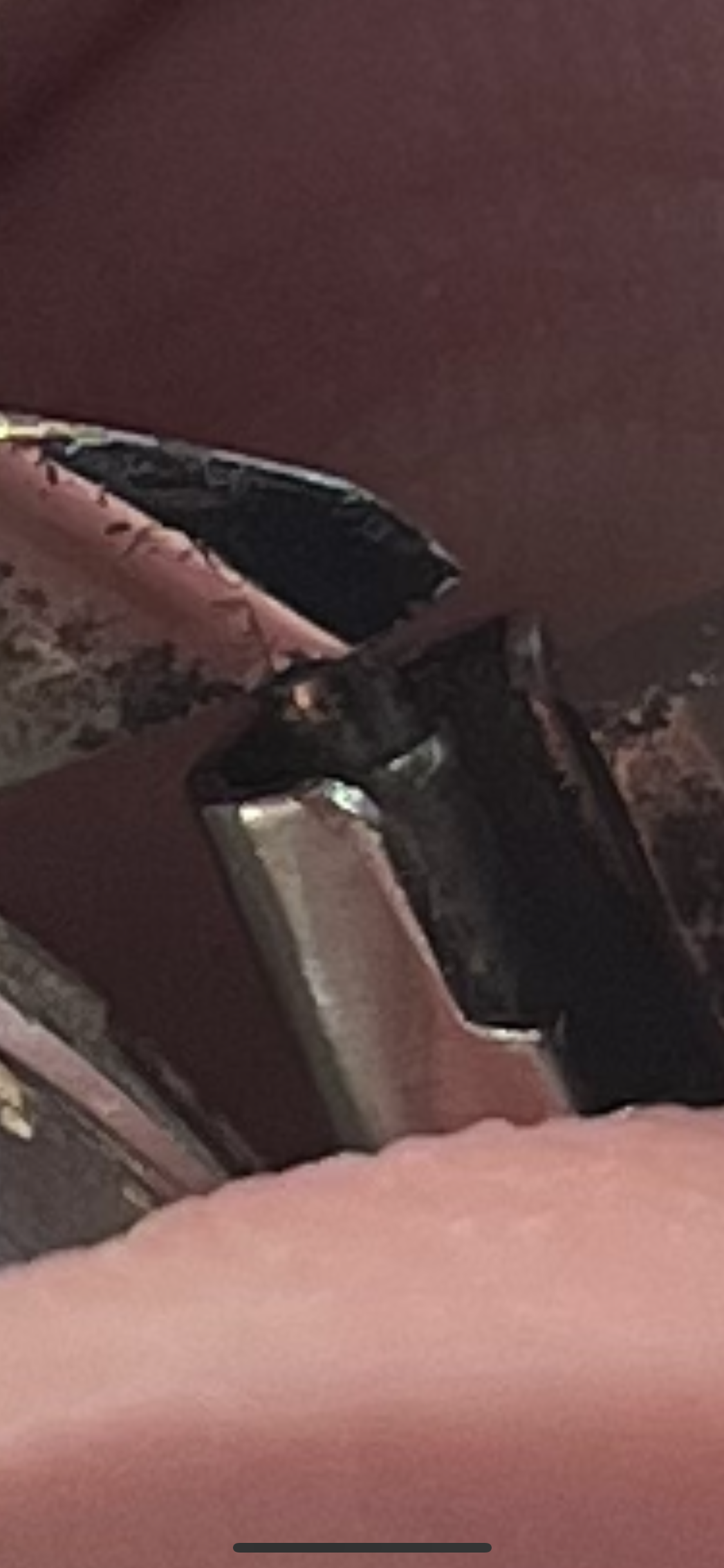

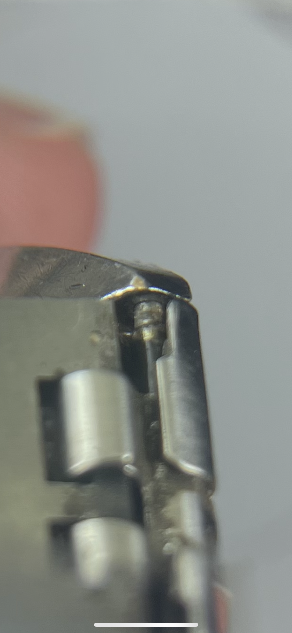

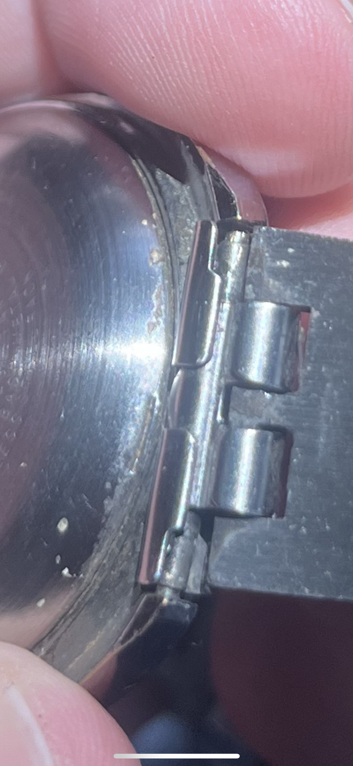

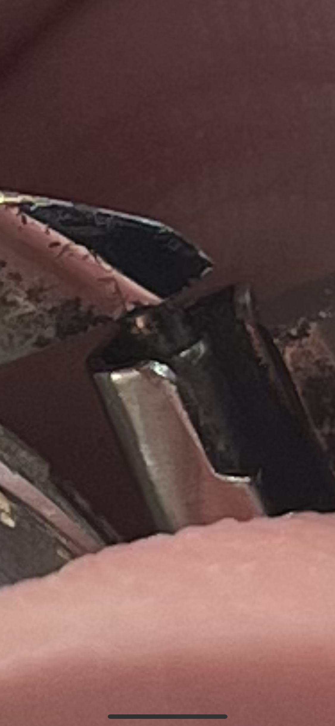

Before I some how break something I wanted to see if anyone had thoughts on some spring bars I'm having trouble removing.
I can’t see anything to actually grip onto. I believe the bracelet has been on the watch since mid-late 70s.
The bar itself does seem to have a sliding ‘sleeve’ you can push to expose more of the bar.
If anyone has ideas on how to better photograph the bars let me know.

If those are the type I'm thinking of, the shoulder of the bar presses right up against the lugs, and there's no other surface to gain purchase. Try spring bar tool heads of different widths to get in between there.

I guess they could also be fixed bars?
The bracelet is from JB Champion. It’s in a Timex watch, they may not have intended for it to be removable.

Or it is those darn shoulder-less spring bars, they are a real pain to remove but the fine tip on a bergeon usually can get in there if so.

I can't really tell from those photos, but someone may have used shoulderless spring-bars, which should only be used on watches with drilled holes through the lugs.

I may just need to bring it to a professional. I’ll try a few more tip heads later today.

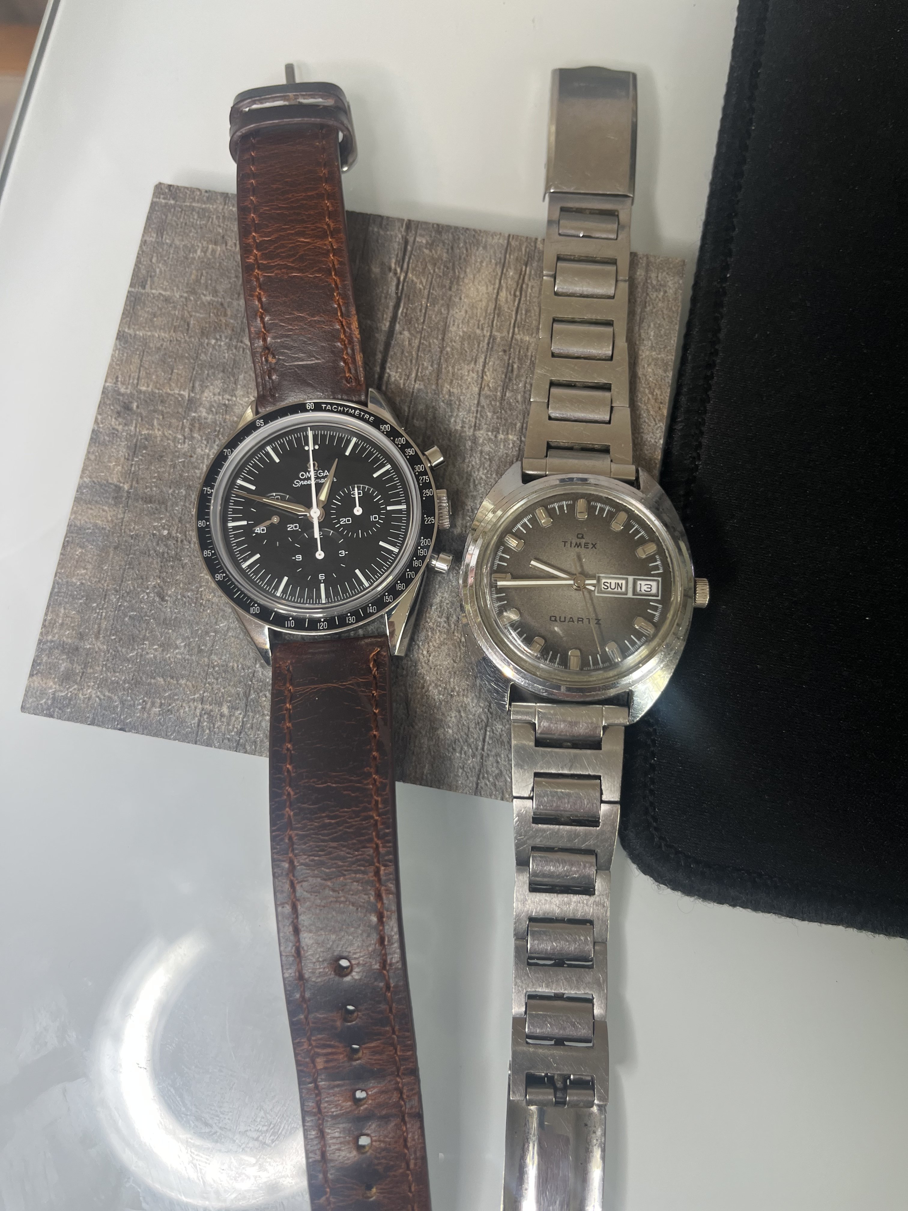

Its not a valuable watch (financially) but was my fathers. I’m more likely to use the bracelet than the actual watch though so figured if I could get it off and cleaned up, it should fit the FOIS nicely.

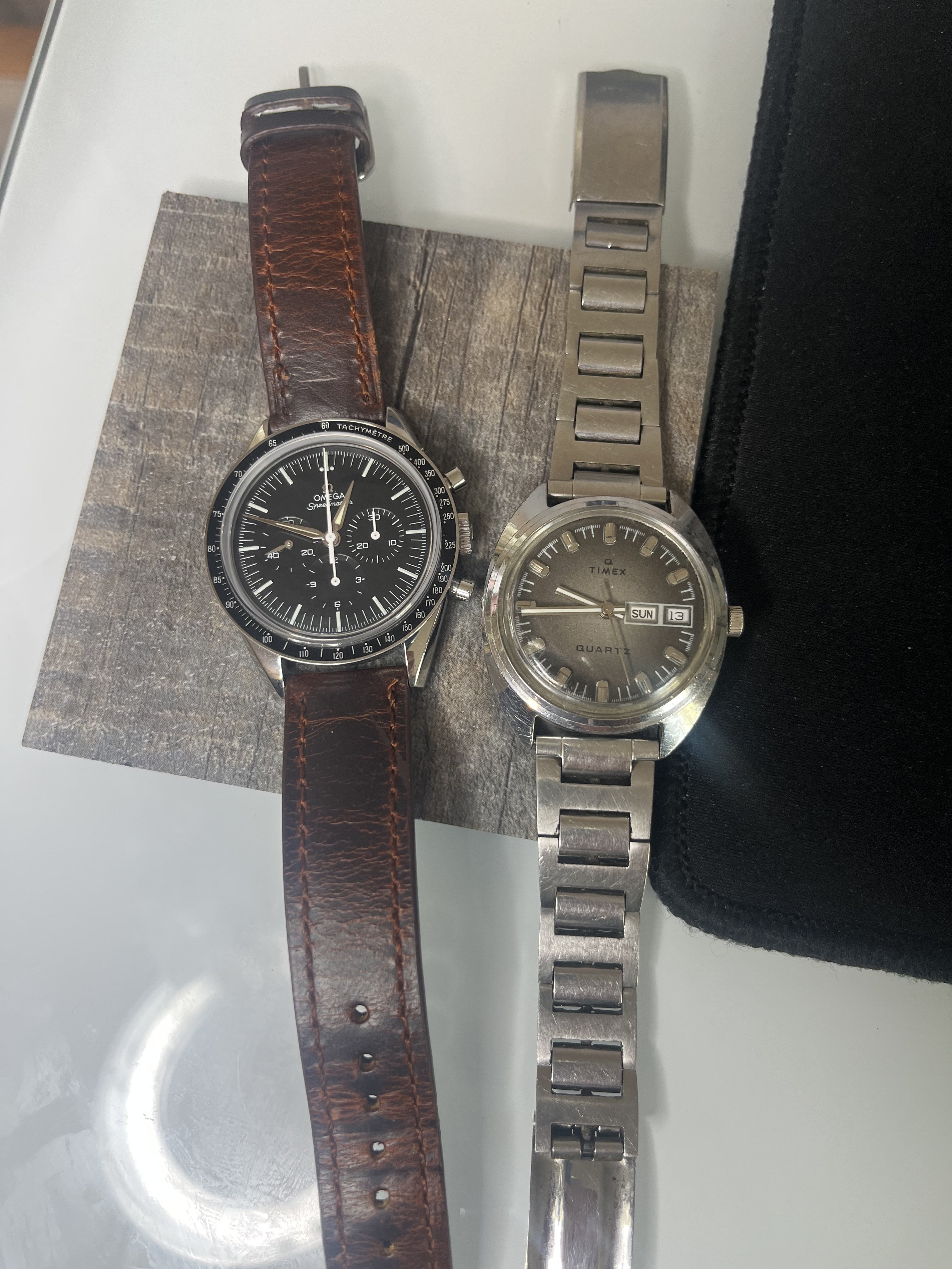

I’d work on slicing through the spring bar if I was 100% confident they’re actually removable. My mom is coming up in a few days and has a second of these watches, I’m hoping the spring bars are a little easier to remove, which would give me confidence just cutting these ones.

Haha me too, though a guy I’ve worked with likely wouldn’t charge too much. I’m hoping the second watch will shed some light when it gets here. I don’t want to prevent the watch from being useable either so if they end up being fixed bars I probably won’t cut them, the cost to then get a bar installed and welded(?) on probably makes this way more of a project than i want to sign up for.
the watch needs a service either way (day/date change isn’t smooth) so I’ll end up needing to talk to the watchmaker at some point.

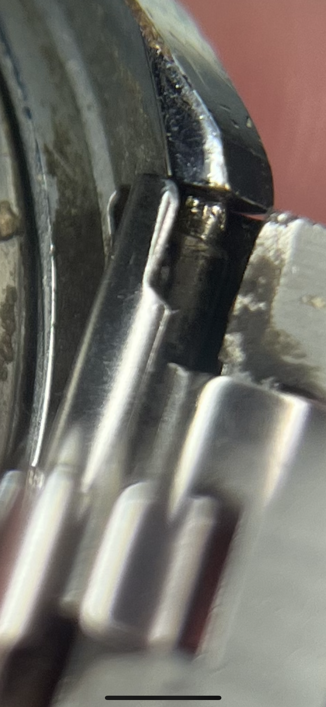

Not an expert on fixed bars - I don’t own a single example - but if they were, how would the bracelet have been attached and why would they be recessed where they enter the case?
1,144
3,111
I would be shocked if they were fixed. I think there’s enough of a hole that you can see that tells me they’re spring bars. I just hesitate because it was my dads watch. I don’t want to make it unusable.
I don’t know what Timex was up to in the 70s, I don’t see any clear indication that the bracelet would have been clamped down after being attached, but I just couldn’t tell anything for sure.

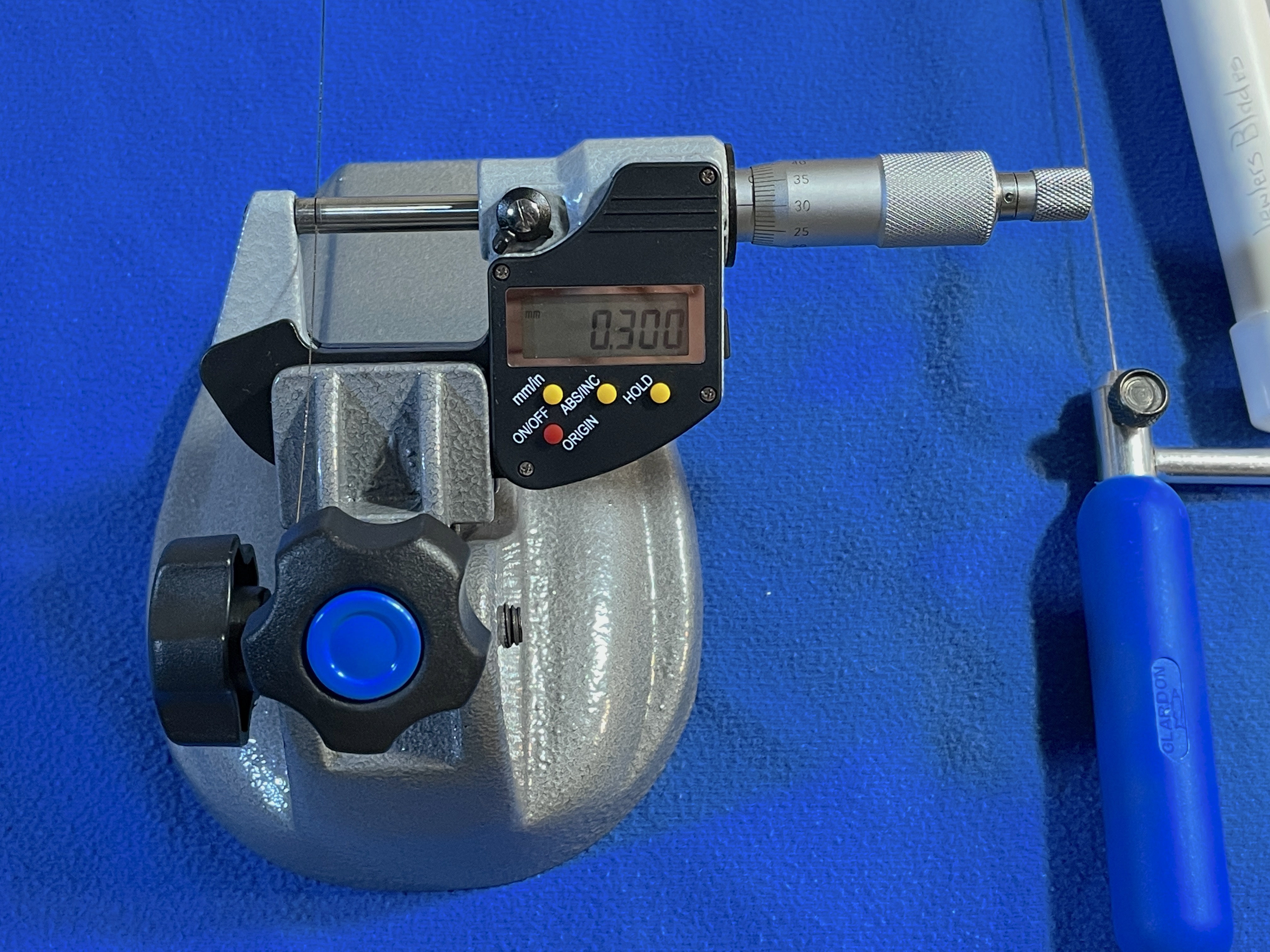

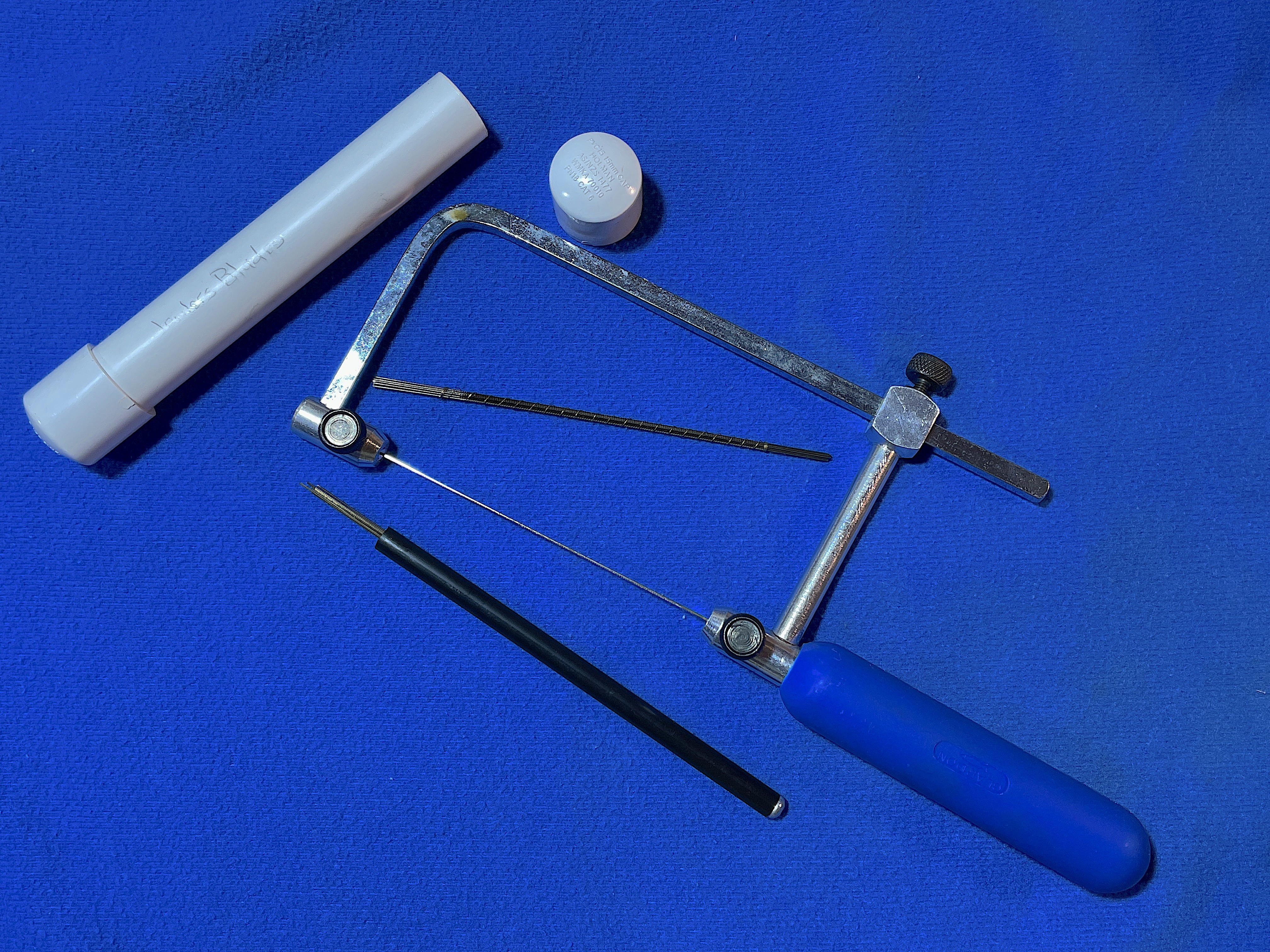

I think it would be best to have a watchmaker use a slotting file to cut one end of the springbar . There looks to be enough clearance between the lug and the end piece. Slotting files come in various thicknesses, 0.5mm for example.
Any decent watchmakers will have one or two in their tool kit.

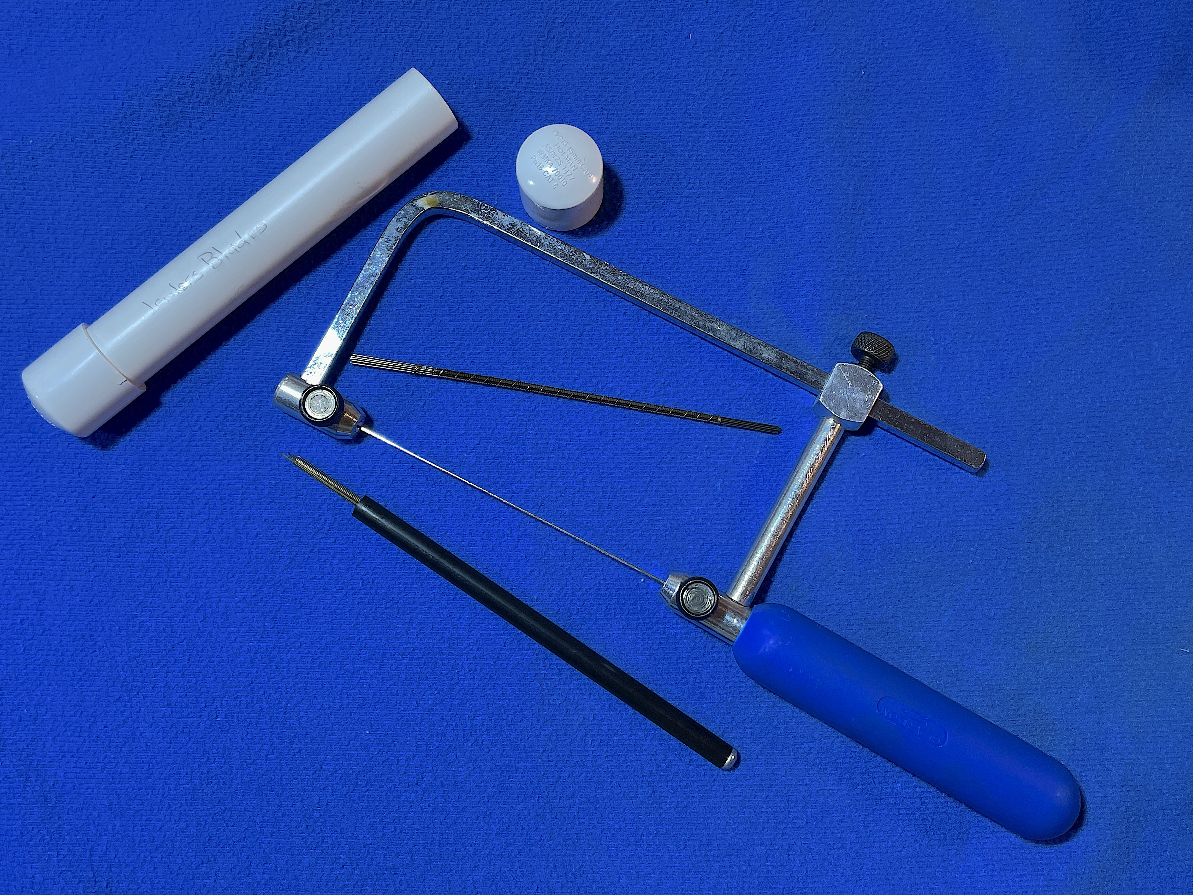

I’d personally recommend a piercing saw.
17,565
36,755

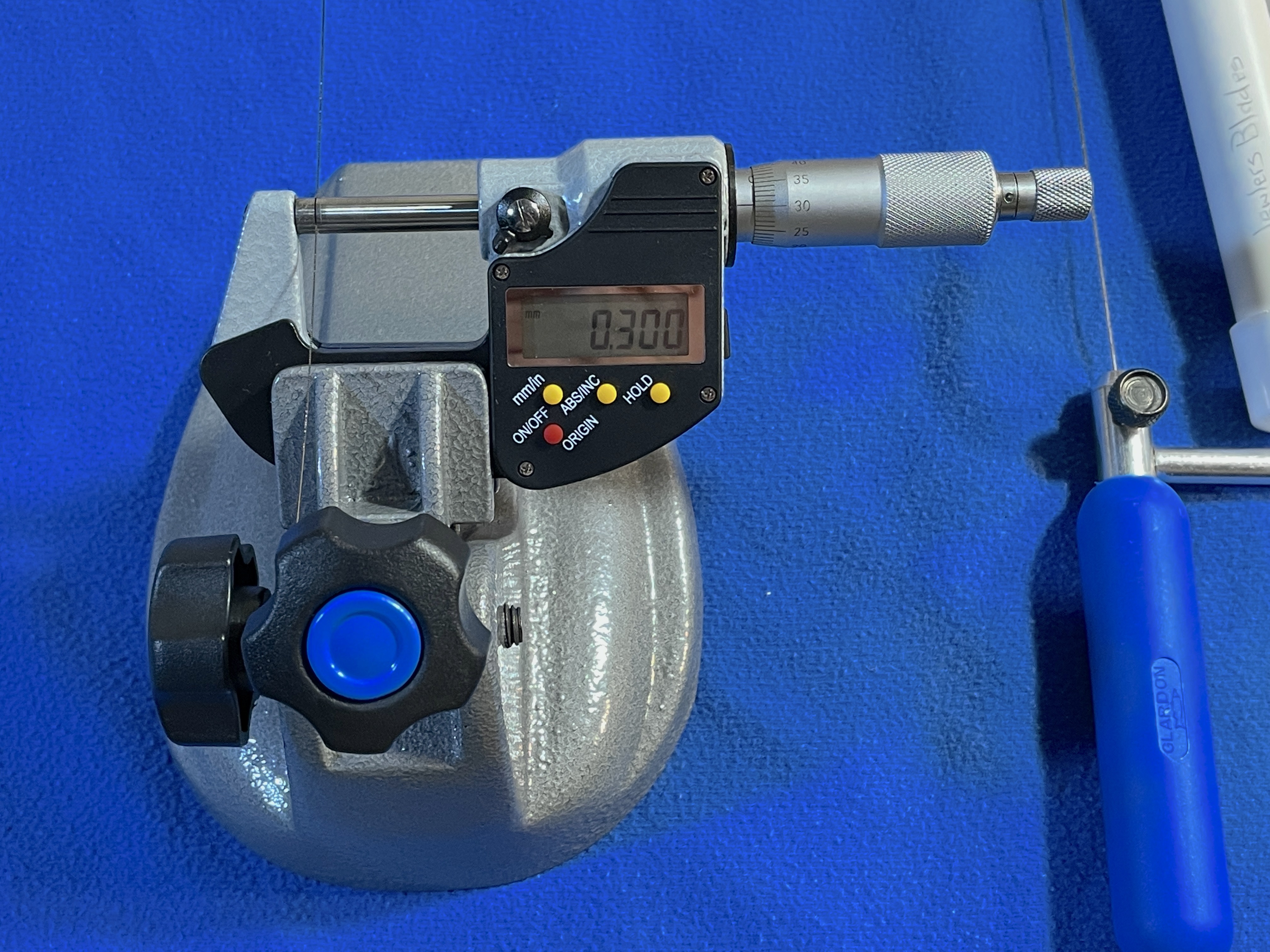

I agree, forgot about that.
Blades can be even thinner.
