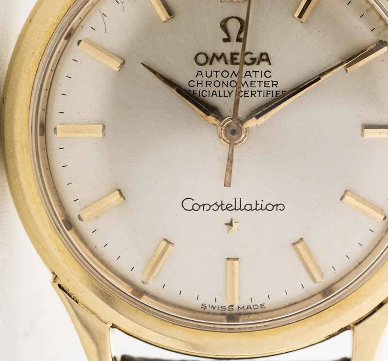

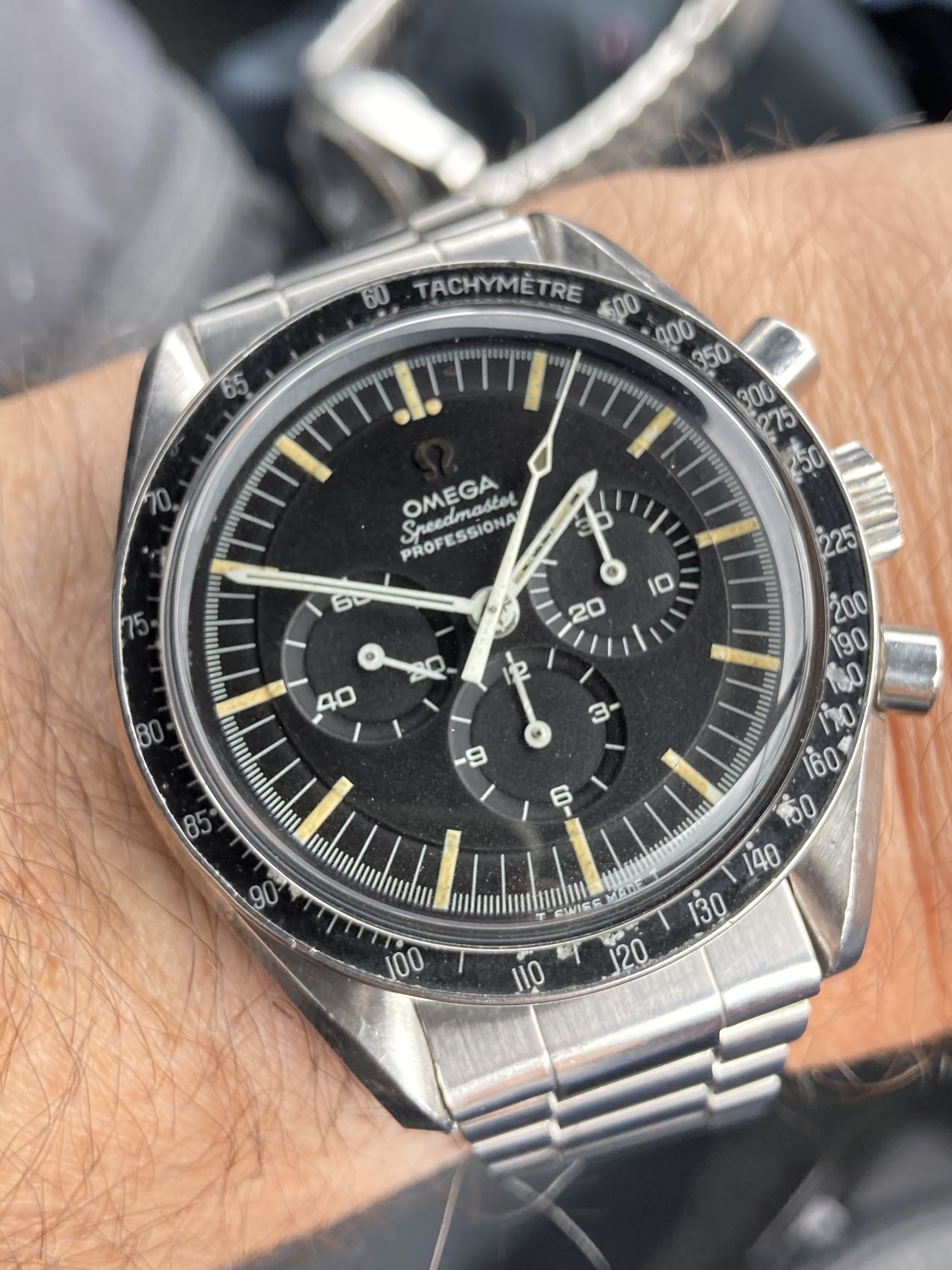

It's a Caliber 354 bumper automatic, Ref 2782 SC from 1954. The overall layout, with these simple faceted baton style hour markers, feels 1960s to me.... and I cannot find other examples of this reference with this style of dial:

Certainly is later than 1957 since it has the ER spelling. If it is described as a 1954 watch then it has been messed about. The hands too don't belong on that model. That dial style and text is too late to be seen on a bumper. Why are you sure it is tritium? If it were, it can't be later than ~1964 since it has no T marks. It looks like Radium to me. I wouldn't worry about your dealer's feelings if they are selling Franken watches.
Thanks, I didn't realize about the ER spelling -- presumably it should read "Chronometre" in 1954? The hands, the sunburst brushing, the layout with the wide minute track, and the straight faceted baton hour markers... just looks 1960s.... Also good point about the T. If it is tritium, we have a small range of possible dates for the true reference that this dial belongs to....I am tempted to go play detective here!

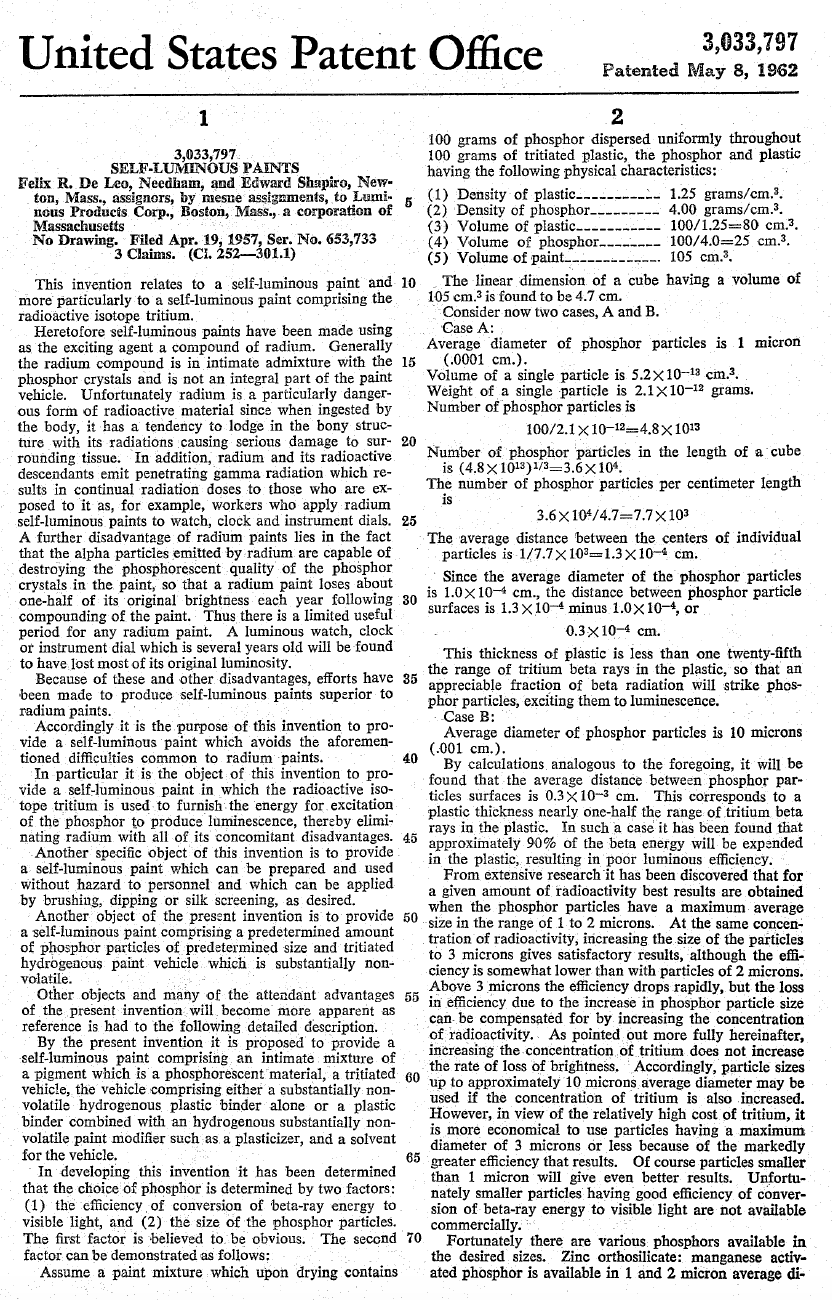

That patent is interesting, and demonstrates that Panerai did not have an earlier patent, but it does not really describe a practical way of making or applying robust tritium lume. I'm not sure that method was ever widely used on watch dials, although I would certainly be interested to know of examples of dials with this sort of lume.
Probably a more important patent from a practical perspective was filed in 1957, "Self Luminous Paints" (3,033,797), which describes the use of a tritiated polymer binder for luminous paint.
Great, thanks! This is all coming together in a coherent picture: in the 1950's, production of Tritium and the technology of Tritium-based paints was very much under development. The article also points out that the cost of Tritium would have been far to high in the early 50's for use in watches. By the very late 50's, the industry was ready to make the switch.

Yes, the movement is a bumper, has the right serial number for 1954, and the right movement caliber for the case reference.
It is the dial that does not belong...

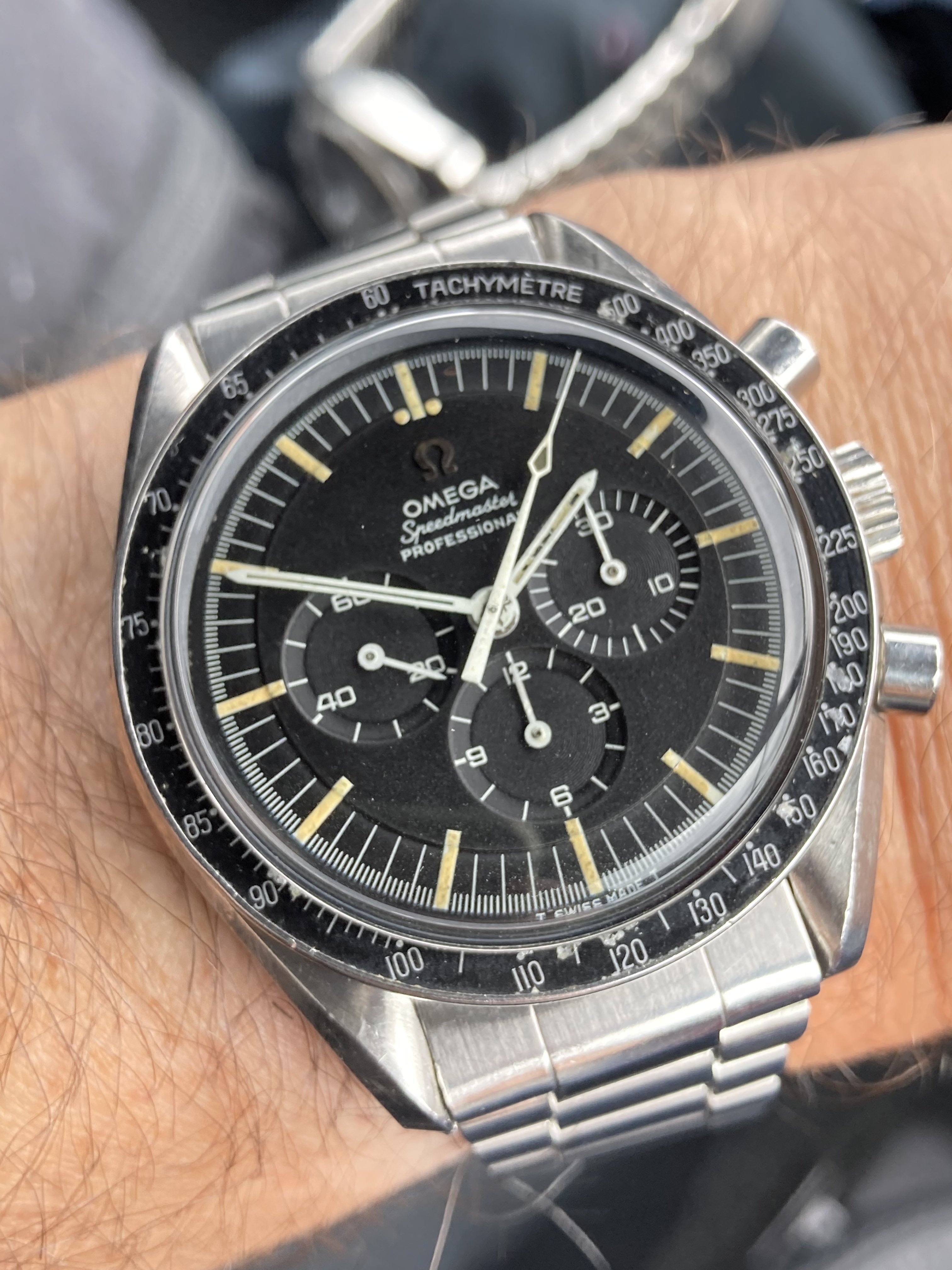

It’s odd: I have two 105.012, and one 145.012. All sourced 20+ years ago, all from different places. And none of them retain their original lume. The same goes for pictures I have searched for regarding the same watches. Yet, Speedmaster references both before and after seem to more often retain their lume. Of course, I could have just bumped into a bunch of outliers, so this is just my observation, not science.
My 1969 145.012 just lost a bit of lume from the hour hand. The hands seem to be the issue / the markers seem ok and I like how they have aged. I had the loose lume cleaned out and the remaining stabilised (did not look to have anything replaced)

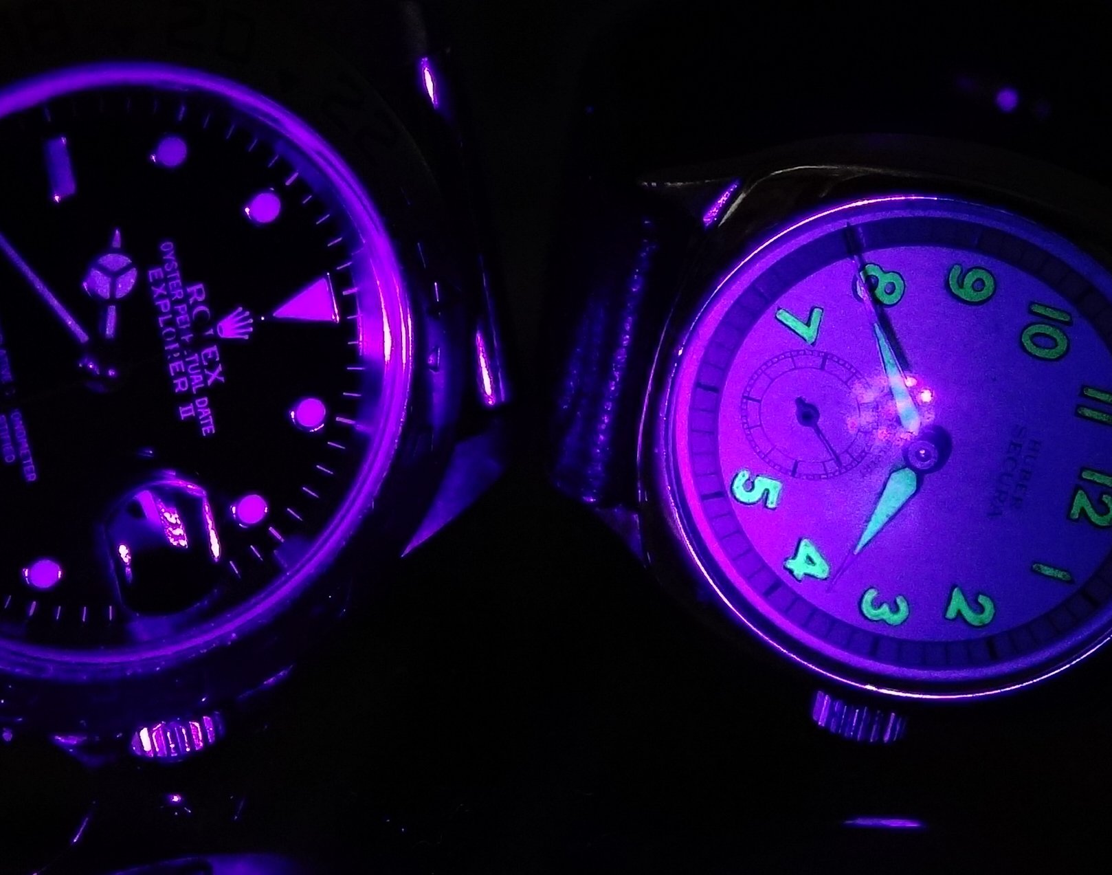

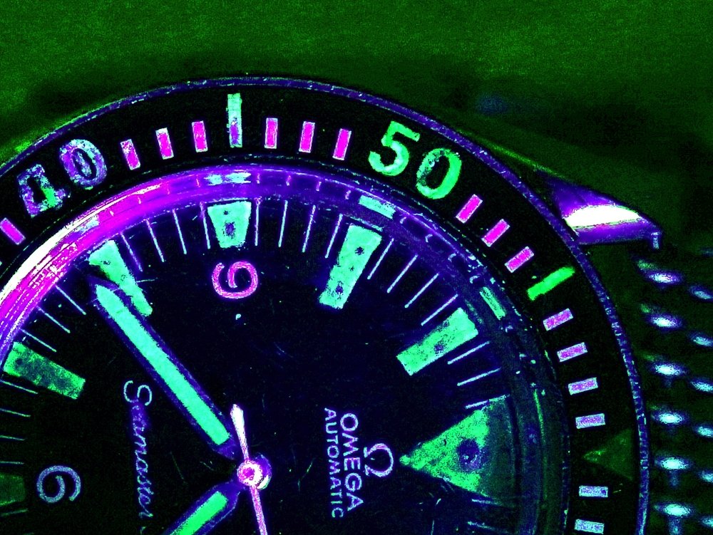

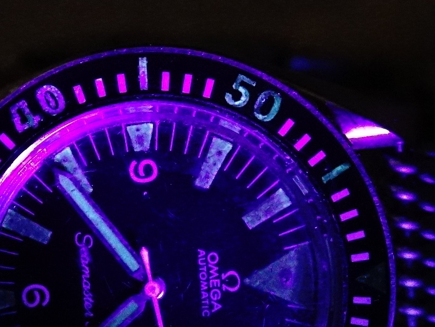

Yes and No: UV test with small UV-lamp
left: Tritium T<25 from 1996 = nearly zero glow ----- right: Radium from ?? 1948 = bright glow under UV
A check with a Geiger is the ultimate test - that is correct!

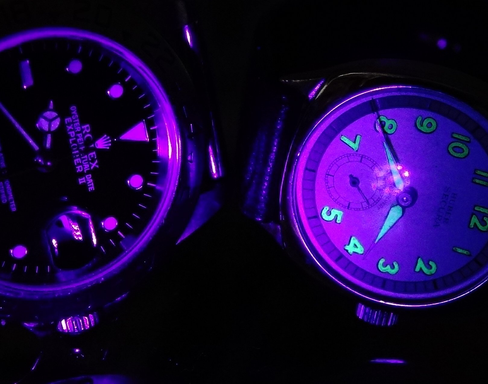

You’re not comparing like with like there.
Rolex tritium based lume from certain periods is known to be ‘dead’ after 30 years. Omega tritium based lume almost always glows well under UV.
correct 👍 my BT from 68
white-blance adapted:
