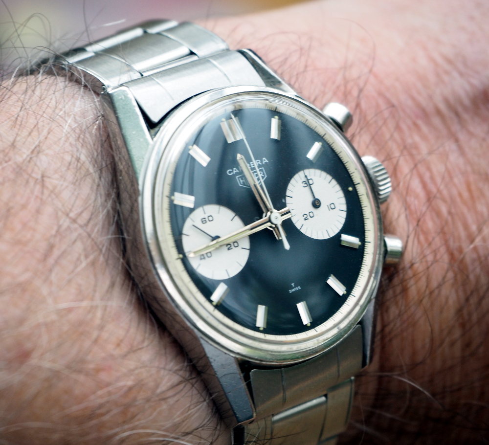

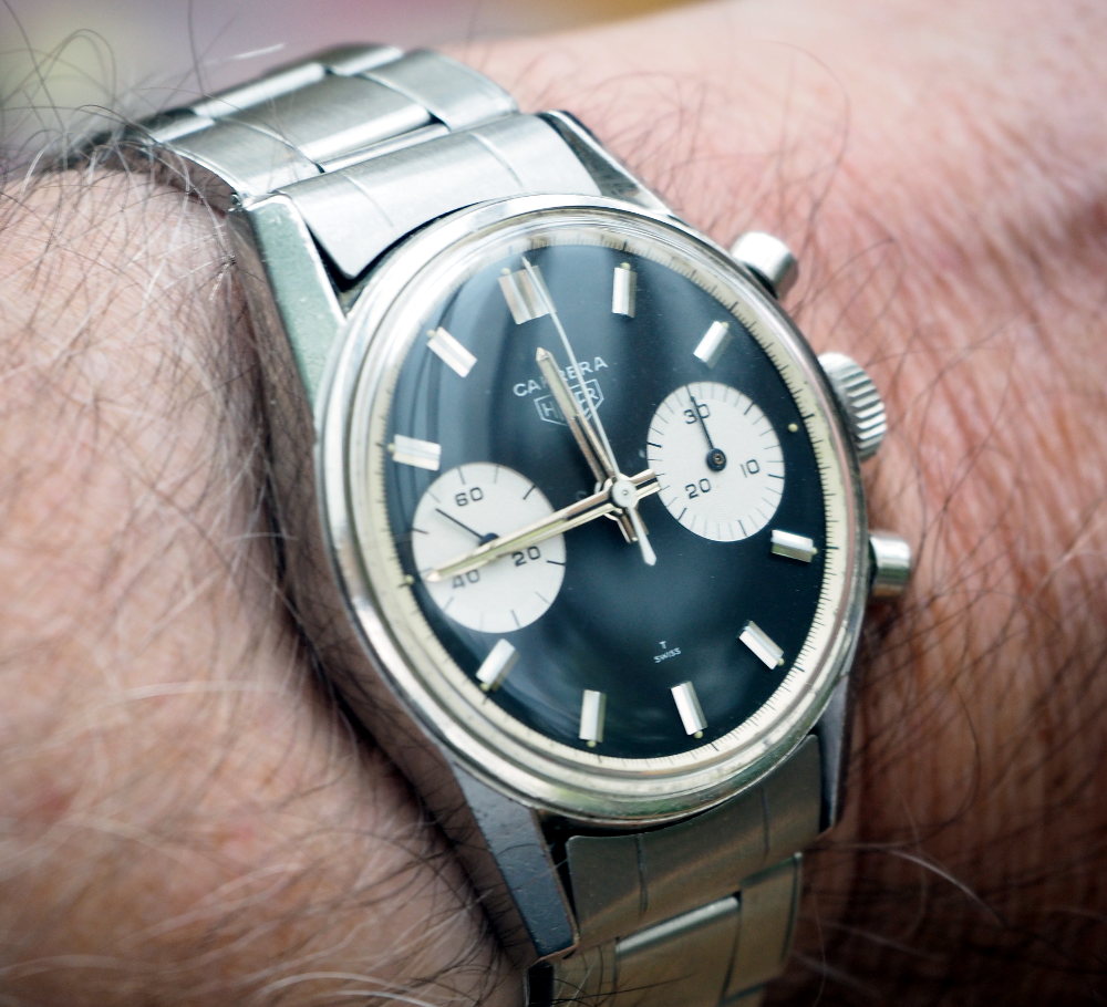

This has been to 13,000ft in an unpressurised aircraft, tritrium lume still OK (air pressure ~60% of takeoff point at sealevel). If we had any idea the wave-lift was so strong we'd have taken oxygen with us and got well past 20,000! I still would not have worried about the hands 😉 The watch has lots of aluminium-tube airmiles too, not so much fun.
