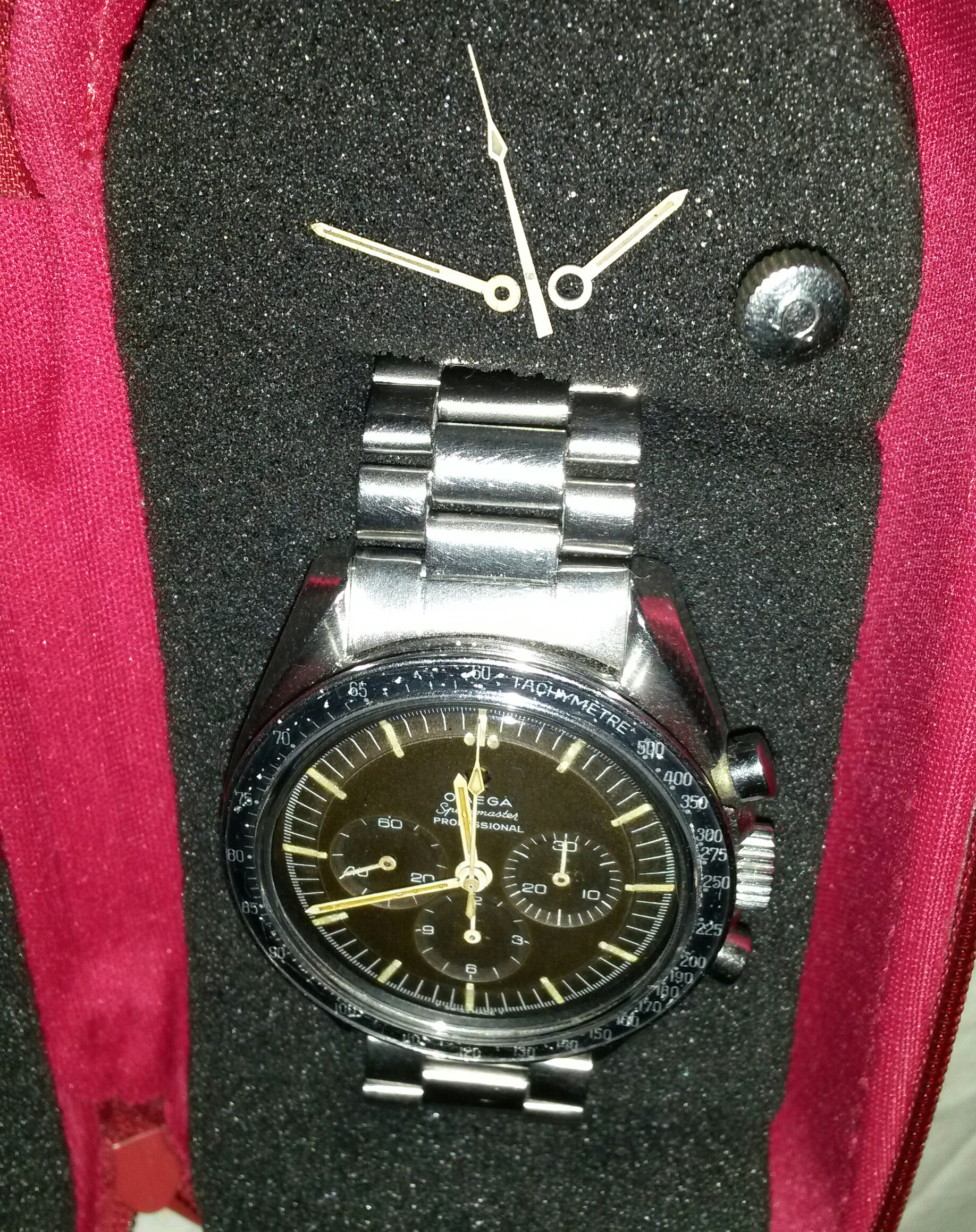

I am pretty sure the tritium service hands fitted to my 105.012-65 in the 1970's are the type you describe in this thread. The minute and hour hand were too short to be correct for a 105.012-65 I've kept them along with the old incorrect service crown. I would be interested to know if that assumption is incorrect.

Yes I’m fairly sure those are mkII hands

Thankyou @Dash1 . I've wondered what they are for a few years now. I'm pleased that I hung on to them, as they are part of the history of the watch.😀

Well unfortunately I wasn't able to help @lexieb007. After more than 30 years together on my Dad's wrist, (and another 15 years with me) the old 1970's, Mk2 service hands deserve to stay in the case, with my old 105.012-65 Speedmaster. Along with the 1970's service crown and 1171/633 service bracelet, they've become a close but incorrect family.
If anyone can point @lexieb007 in the right direction for a set of tritium Mk2 Speedmaster hands, I think he would appreciate it.
(See original post above)
Having said that, it has got me interested in the difference between hand length of the Mk2 Omega Speedmaster and the slightly longer hands of models such as the 105.012-65.
@simonsays posted: "1040 calibre movements have a larger hole so not the same as cal 321/861.
So if the old service hand set (posted above in the red Omega case) on my 105.012-65 were correct for a Mk2 Speedmaster, I was wondering how they fitted my pre-moon 321?
Got the answer with this nice, informative article. (Best read with a cup of tea):

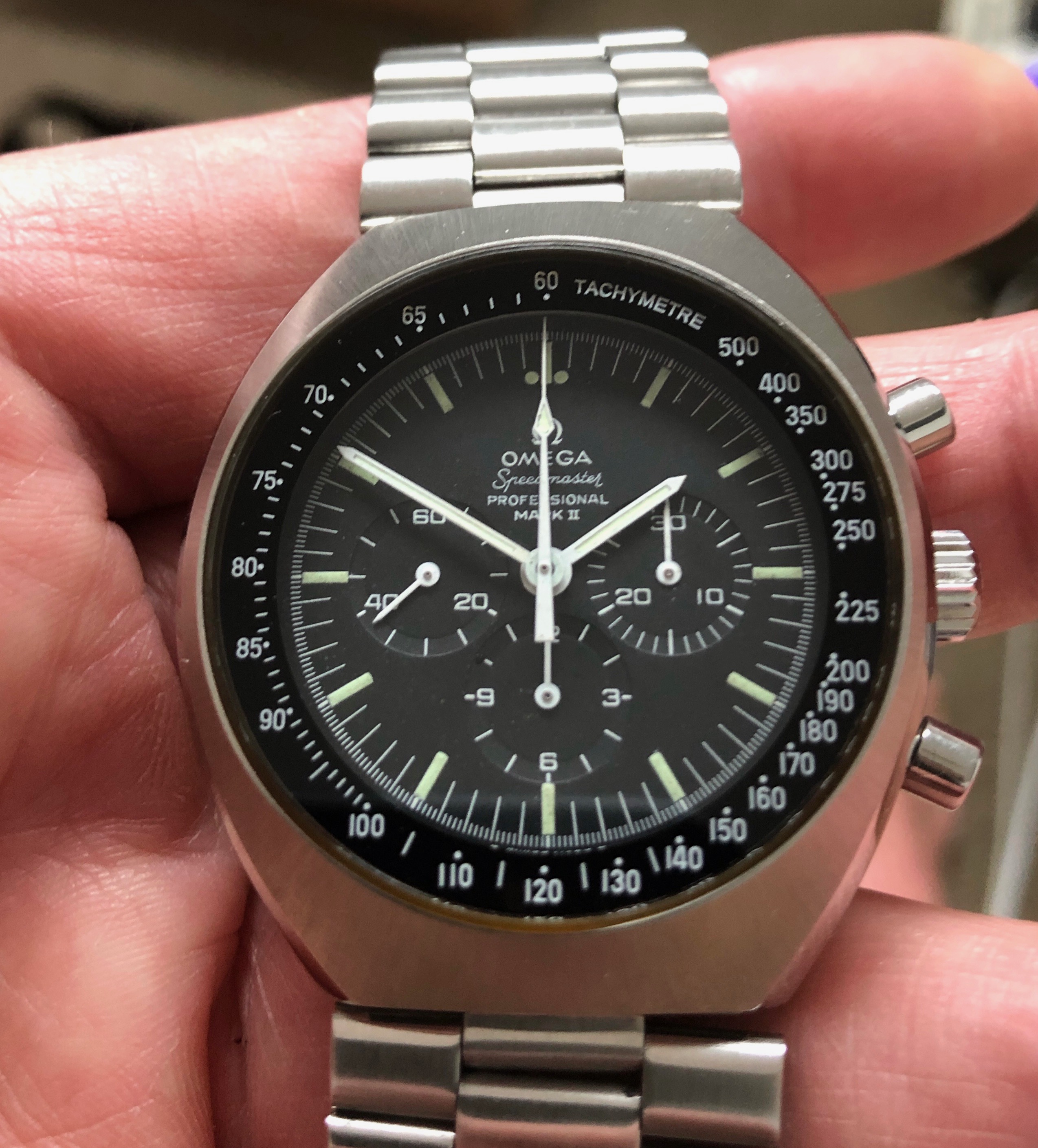

^Bump. Anyone like to help out an avid vintage watch collector? I don't have an Omega. I have my heart set on getting two classics. First up a classic Mk2. If I can get some, hopefully these hands will be destined for the @Tonyash Telestop. He has recently posted about the fantastic restore he did on that watch. Can anyone help me out here?!

The watch in question. After finding and restoring this Telestop I feel my part of its' story is done and dusted. Adam Lewis did a fantastic job reluming service hands to match the dial but Alex would like to take the watch to another level of originality. Having tried
to find a tritium set during the restoration I admire his perseverance.
