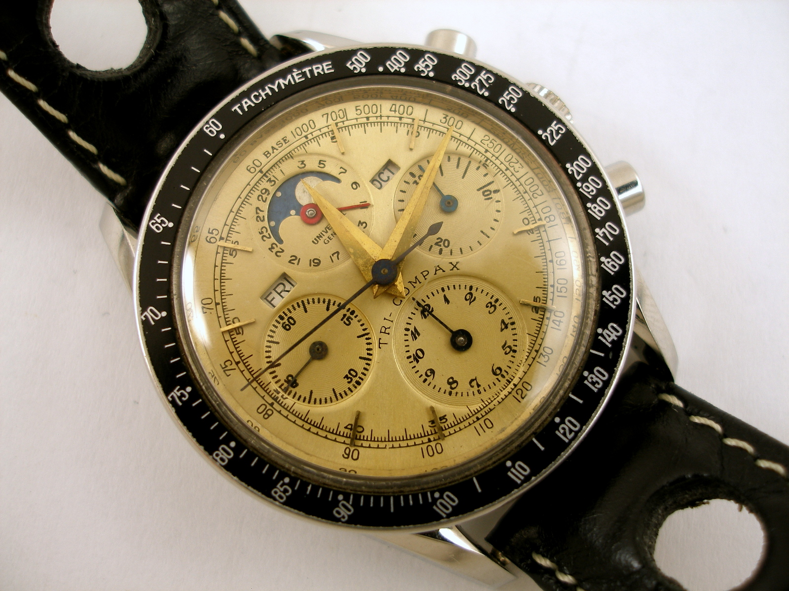

  1. mbirtch Oct 11, 2013
    58
    5
  2. LouS Mrs Nataf's Other Son Staff Member Oct 11, 2013
    6,713
    18,260
    Redial, no doubt in my mind. Also, not a correct dial for this style of case.

  5. Brent7928 Oct 16, 2013
    120
    120
    I agree a redial but am not sure about it not being the correct dial blank. The pattern is completely wrong but I would guess the blank is correct.
  6. LouS Mrs Nataf's Other Son Staff Member Oct 16, 2013
    6,713
    18,260
    what about those metal hour batons?
  7. Brent7928 Oct 17, 2013
    120
    120
    my gold 281 has metal batons as well as an all steel one that I used to have. however, neither of those came with a bezel. It looks like some one either added the bezel or swapped the dial but the blank of the dial looks like it could be authentic to me.
  8. woodwkr2 Oct 17, 2013
    1,366
    819
    Looks like they took a dial off an older rectangular pusher tri compax and had it redialed (horribly) for the later model case. The hour, minute, and seconds hands are also incorrect for the case. Likely all taken from the same donor watch.
  9. woodwkr2 Oct 17, 2013
    1,366
    819
    It'd be interesting to see if they have a correct casing ring to house the 285 caliber movement in that case... The rectangle pusher versions usually had the movement fit to the edge of the case, while the later versions require the casing ring to hold things down.

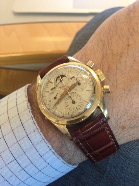

  10. Brent7928 Oct 17, 2013
    120
    120
    hard to see on these two pictures but all that I have with me at work. Here is a gold 281 tri-compax with the same hands and dial style (not print) as the one above. It appears that the one above is a frankenwatch of original parts with a bad redial - in my opinion.

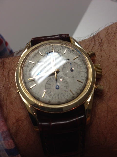

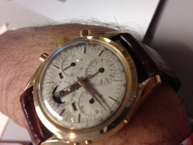

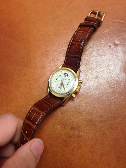

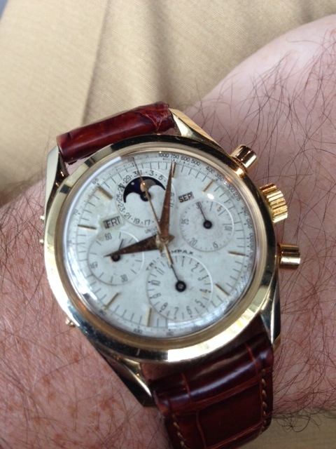

  11. Brent7928 Oct 18, 2013
    120
    120
    I decided to wear the gold one today and took a few more pics. sorry they are not crisp but my dial is a little rough. It is original though so could be a good reference so you can see what I am talking about. The first photo I held in the light to show the reflection off the gold batons.
    The second is of the dial so you can see the hands as well.
    To me it looks like the watch was probably the steel version of my gold one, redialed and then maybe had a bezel added. I have seen several steel versions with bezels over the years. They may have even come original on certain models but I don't know one way or another.
  12. woodwkr2 Oct 18, 2013
    1,366
    819
    Love that gold one. :rolleyes:
    You can't "add" a bezel to a case that isn't designed for one (short of soldering/radically modifying the case). The original watch in question is a franken that had a donor movement and dial added to the steel case.

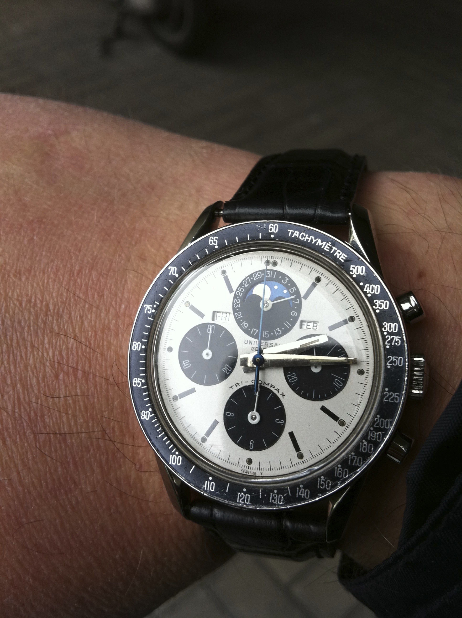

  16. Brent7928 Oct 21, 2013
    120
    120
    I agree with Lou on that. I think they wear even better on a strap - for some reason that makes them appear larger.

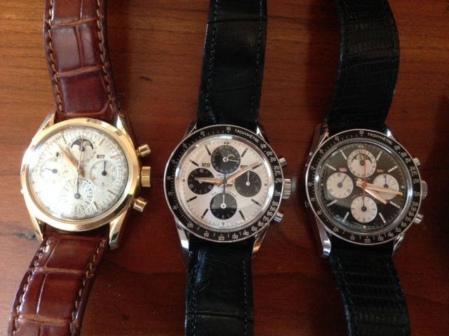

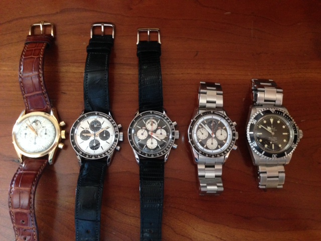

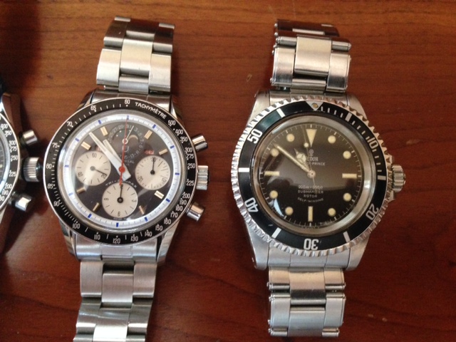

  17. Brent7928 Oct 21, 2013
    120
    120
    here is a pic of my collection of tri-compaxes next to a submariner so you can see the size differences. You will see straps and bracelets that show you how they look on both as well as a comparison with a 40mm vintage sub. While smaller, I still like to wear them. In today's large watch world I think they kinda stand out some because they are a little smaller and unique - a little more elegant than some of today's offerings

  18. Brent7928 Oct 21, 2013
    120
    120
    sorry, here are the pics. I hit post too quickly.
    Group photo:
    on straps
    Size comparison:
