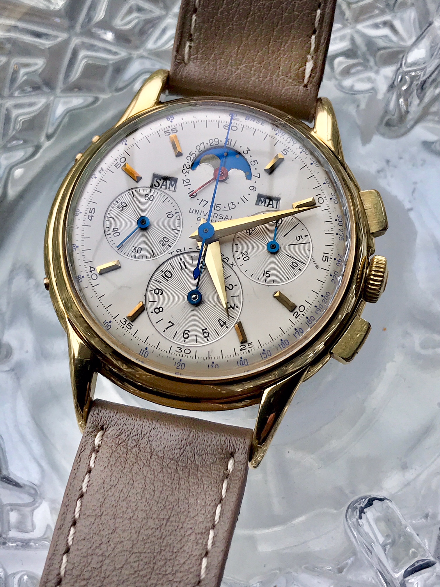

Here are some dials that seem to not have the SWISS signature at 6:00 (it is possible they do all have SWISS signatures that are hidden by their bezels):
img_5983-jpg.590794
The right side of the moonphase aperture is funky on this one ^

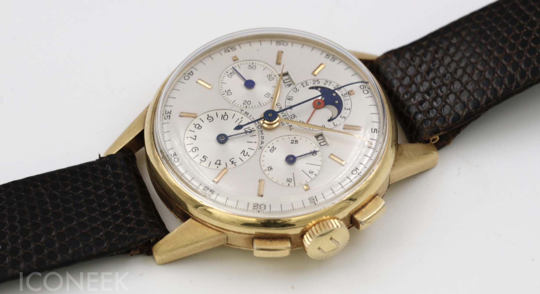

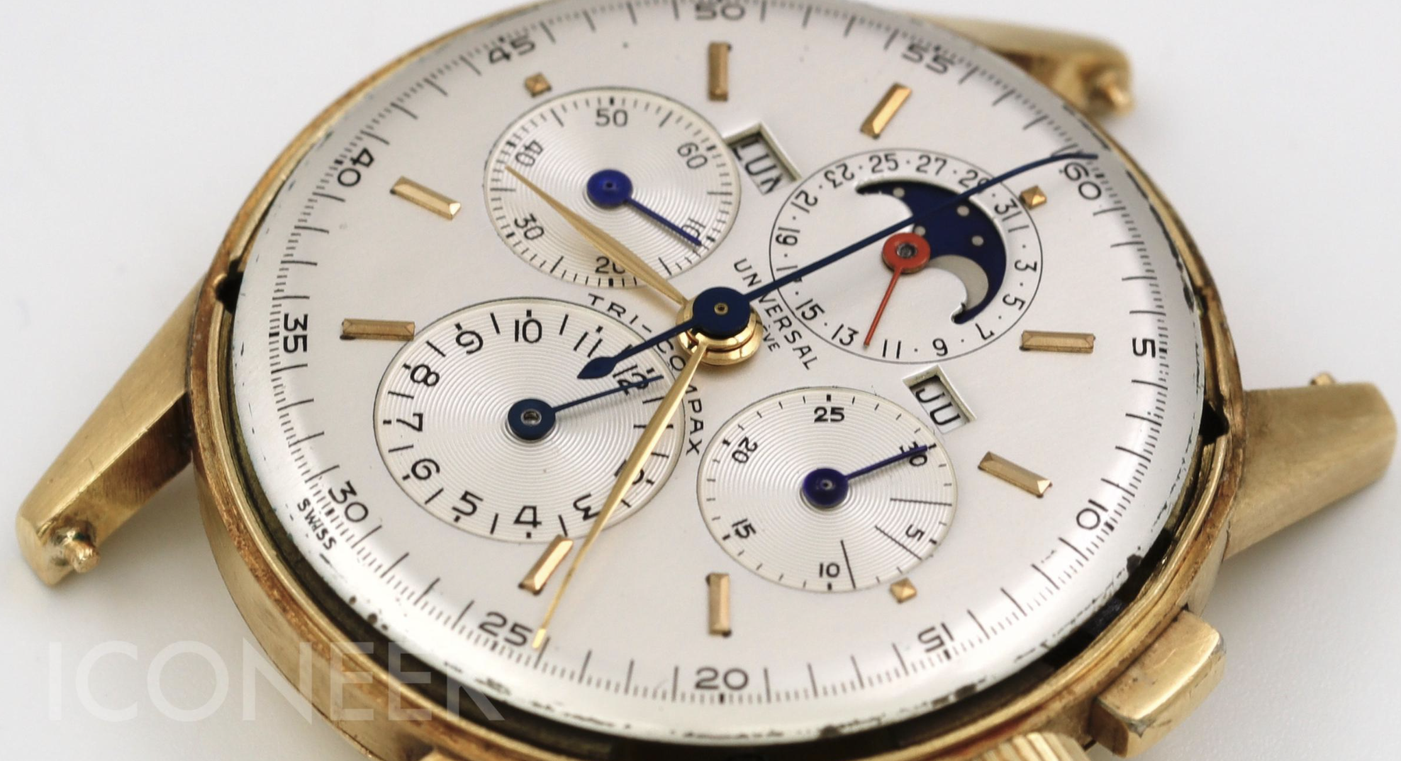

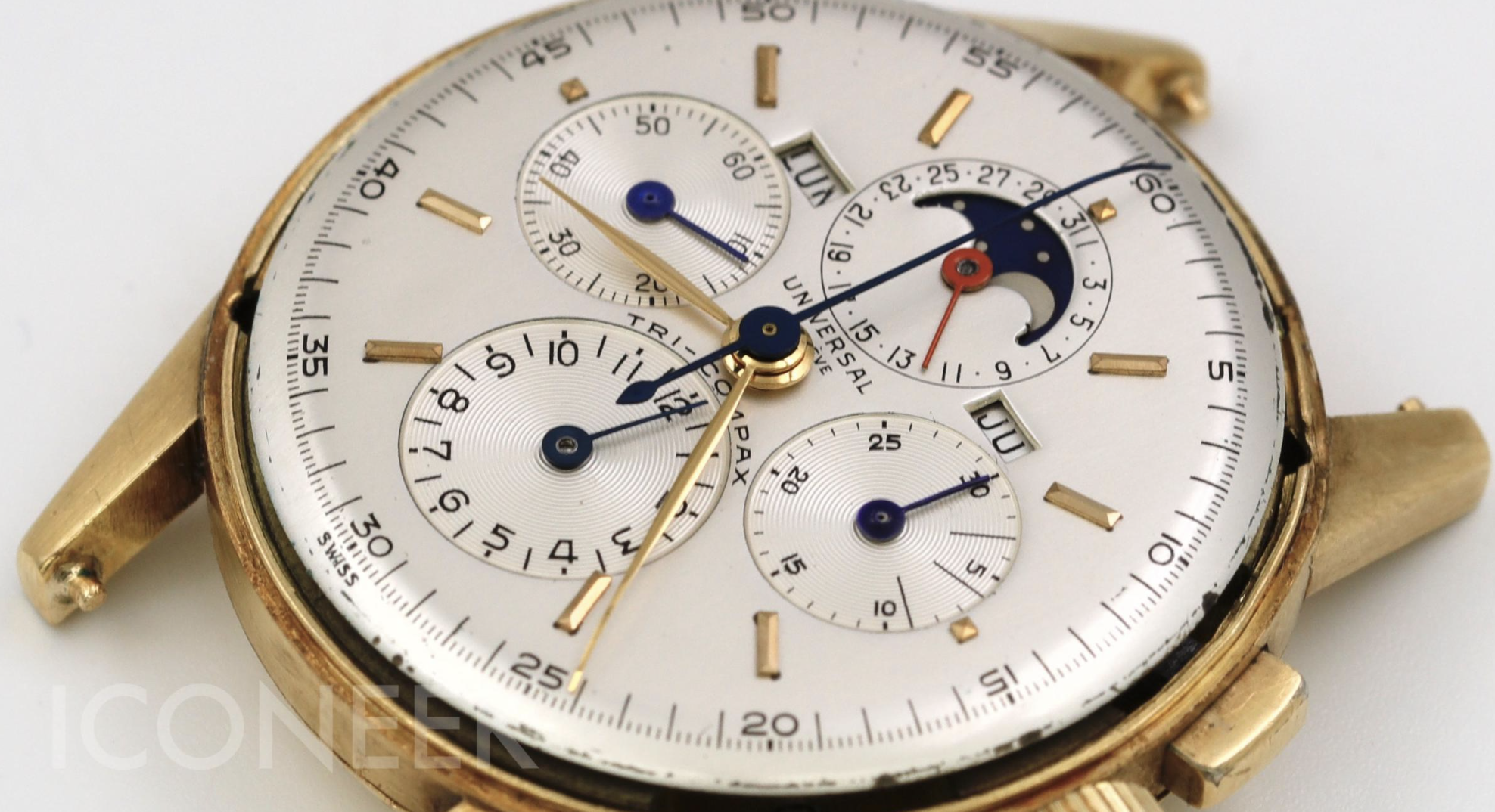

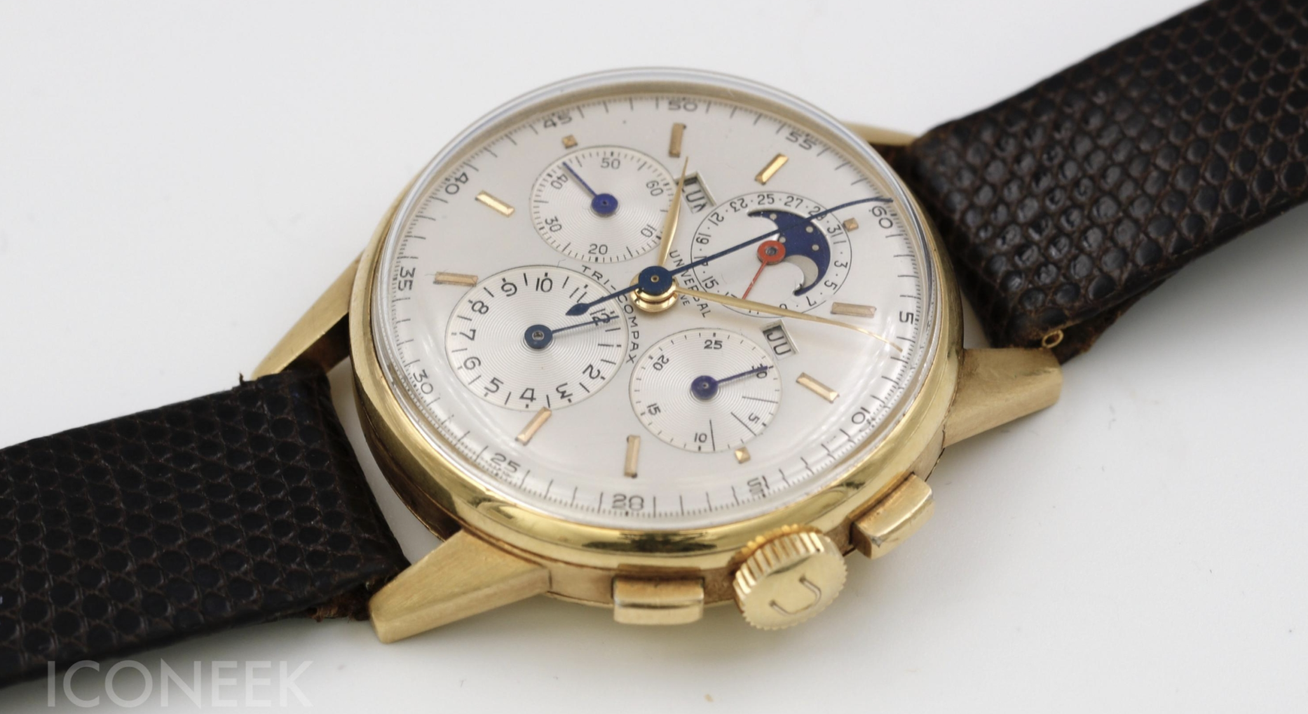

Here's one where the 'SWISS' is basically invisible until the bezel is removed:
https://www.iconeek.com/universaltricompax12253/

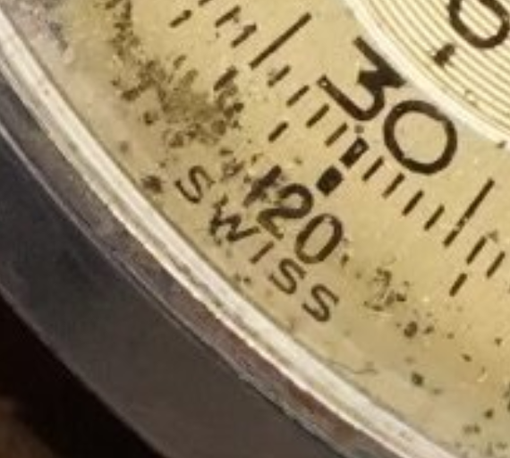

Made a little progress here:

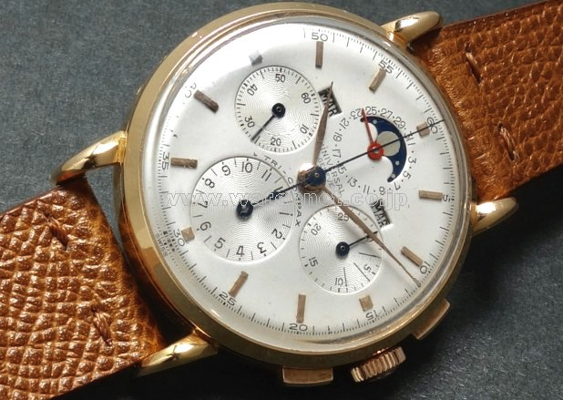

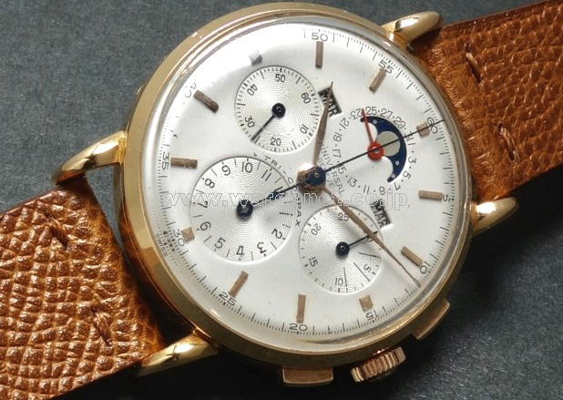

I found a dial that appears to match that of the 12552 from Christie's perfectly. It clearly has a 'SWISS' signature. I know where the Christie's watch ended up, so I will work on verifying that particular watch has a 'SWISS' signature as well.
https://www.watchnet.co.jp/en/item/view/2018

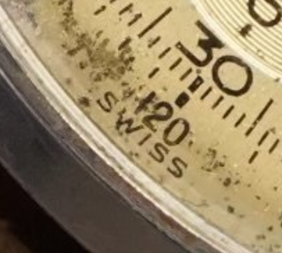

In addition, I found a photo markthetime posted a while back that shows the 12268 also has a 'SWISS' signature.
https://omegaforums.net/threads/uni...-french-cased-who-can-help.72680/#post-917418
I'll keep looking for exceptions to the rule.

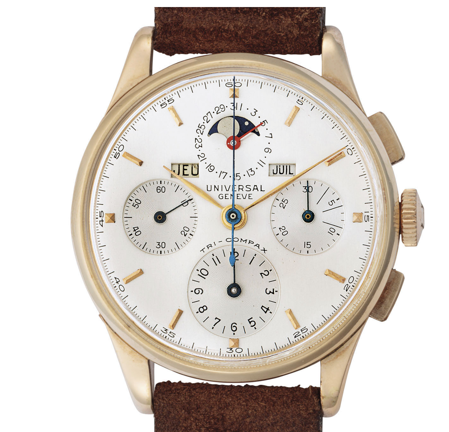

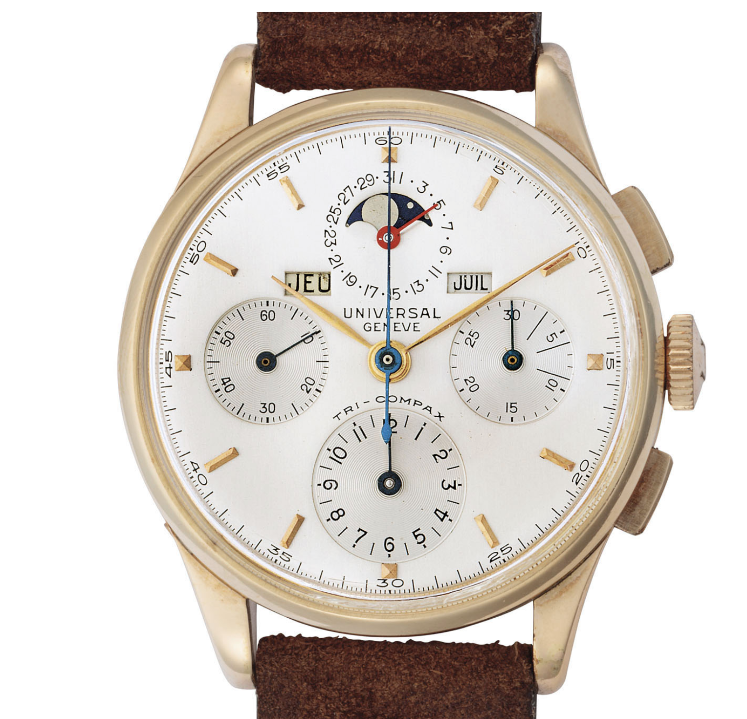

Interestingly, the Christie's watch does not have a SWISS signature hidden under the bezel.
Another irregularity with the dial is the semicircles at the bottom of the moonphase aperture are bent inward. I haven't seen this feature on any other tri compax dial--I wonder if anyone else has.
If you look very closely, you can see where the dial has made contact with the moonphase disk, leaving a streak. This is definitely due to the semi circles being bent inward.
FWIW I showed this watch to a few watchmakers I trust and they all immediately said it was refinished.
IMO given how nice the printing is, it is difficult to say with certainty it's refinished.
