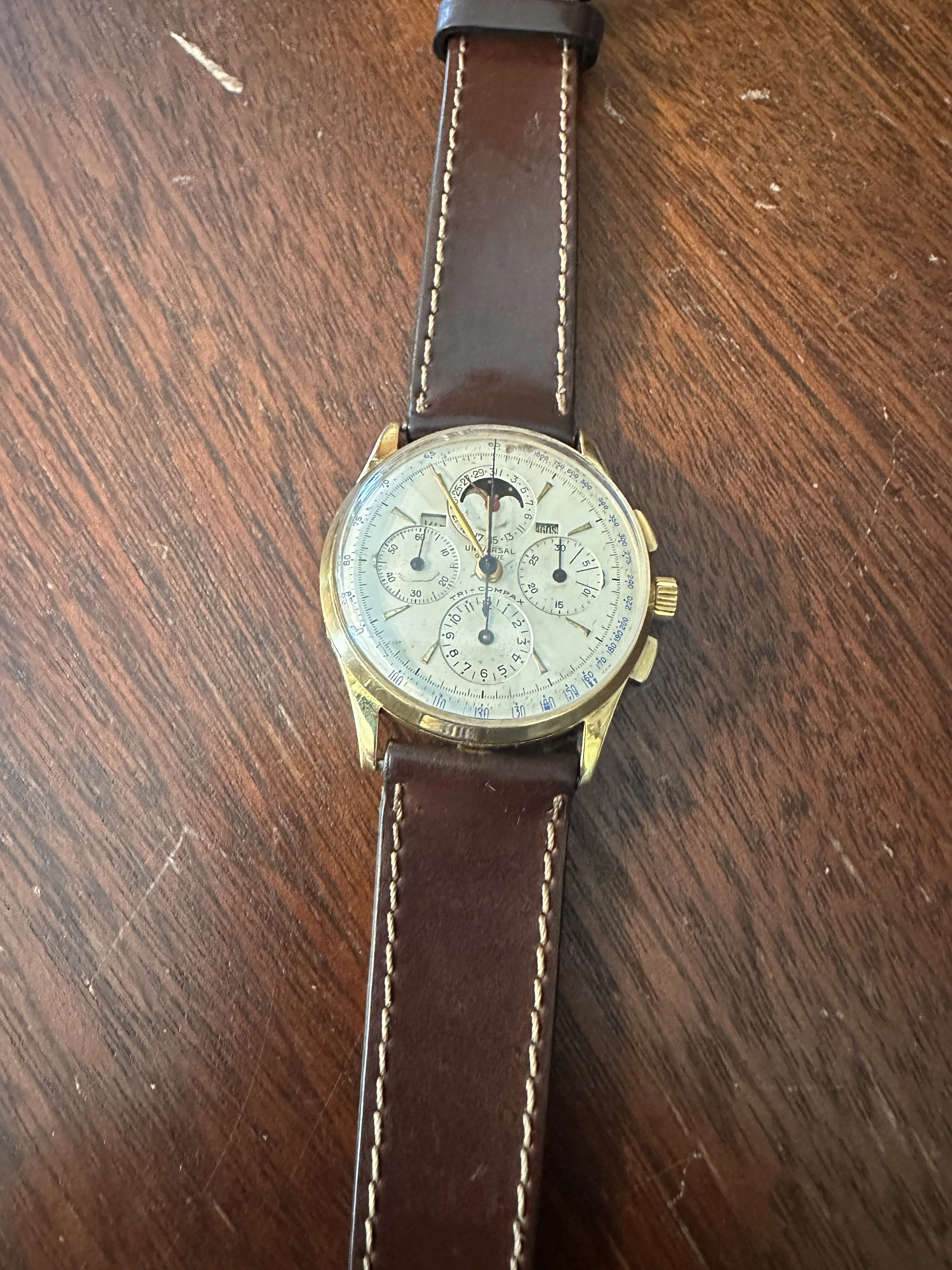

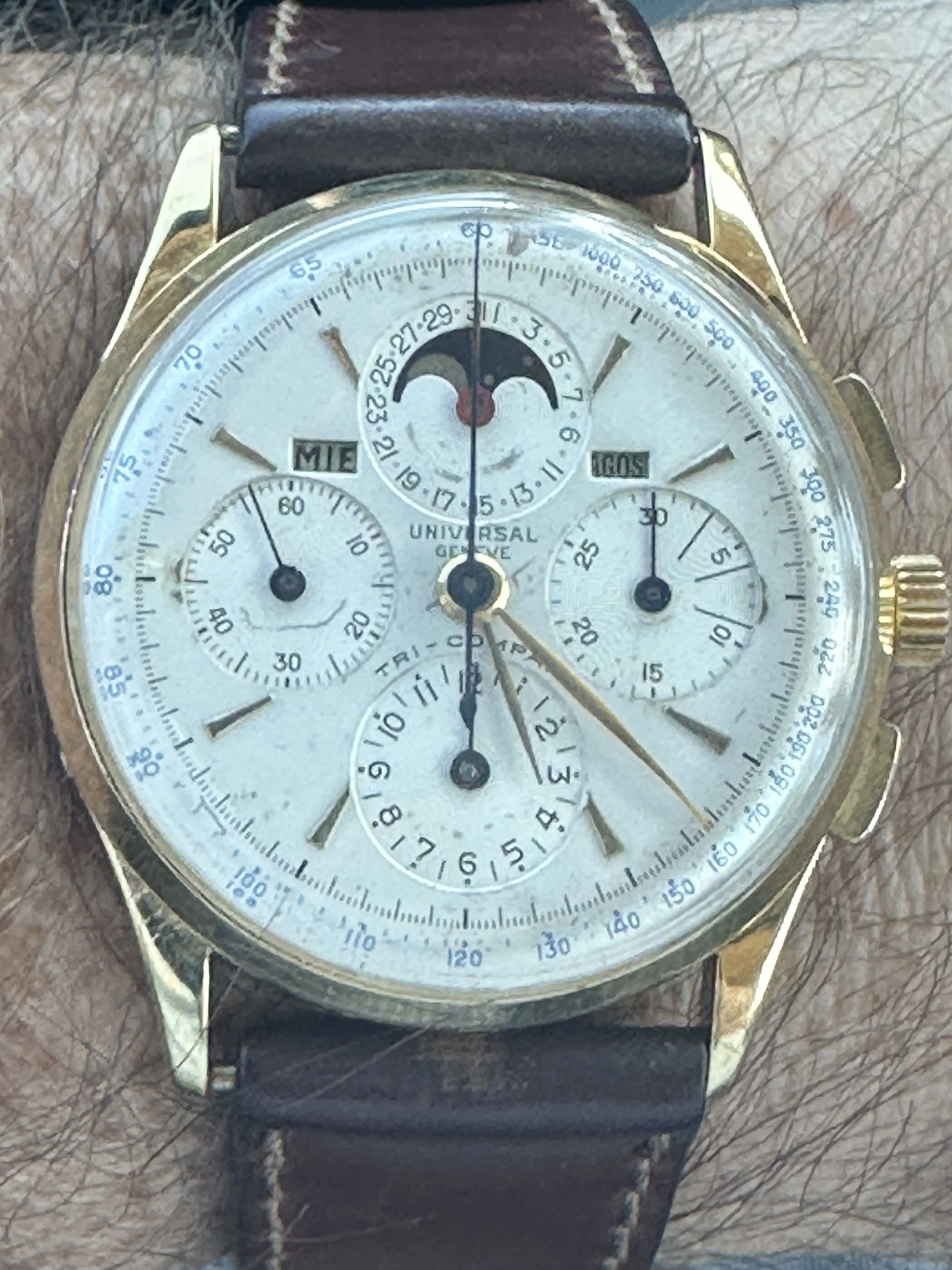

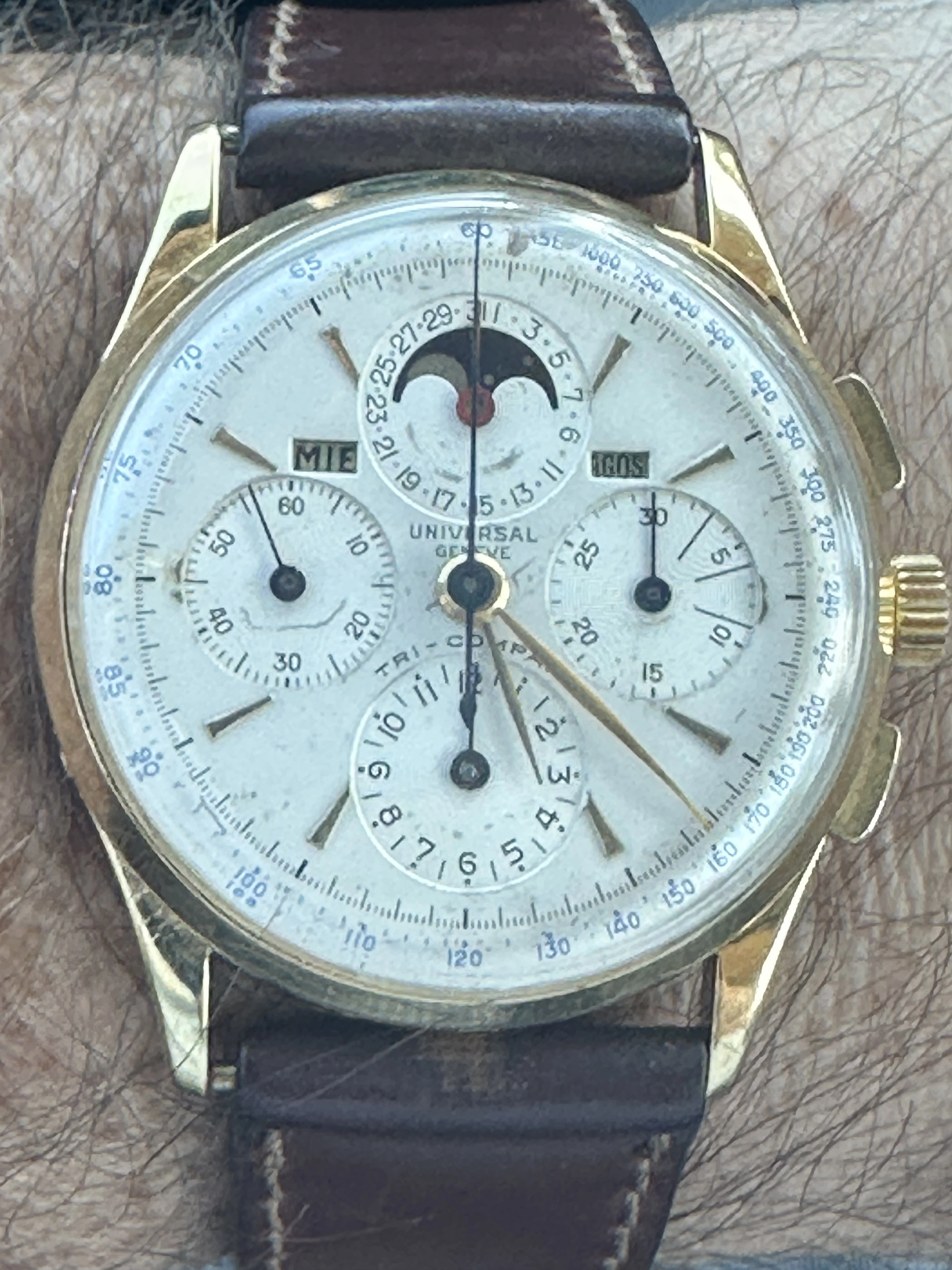

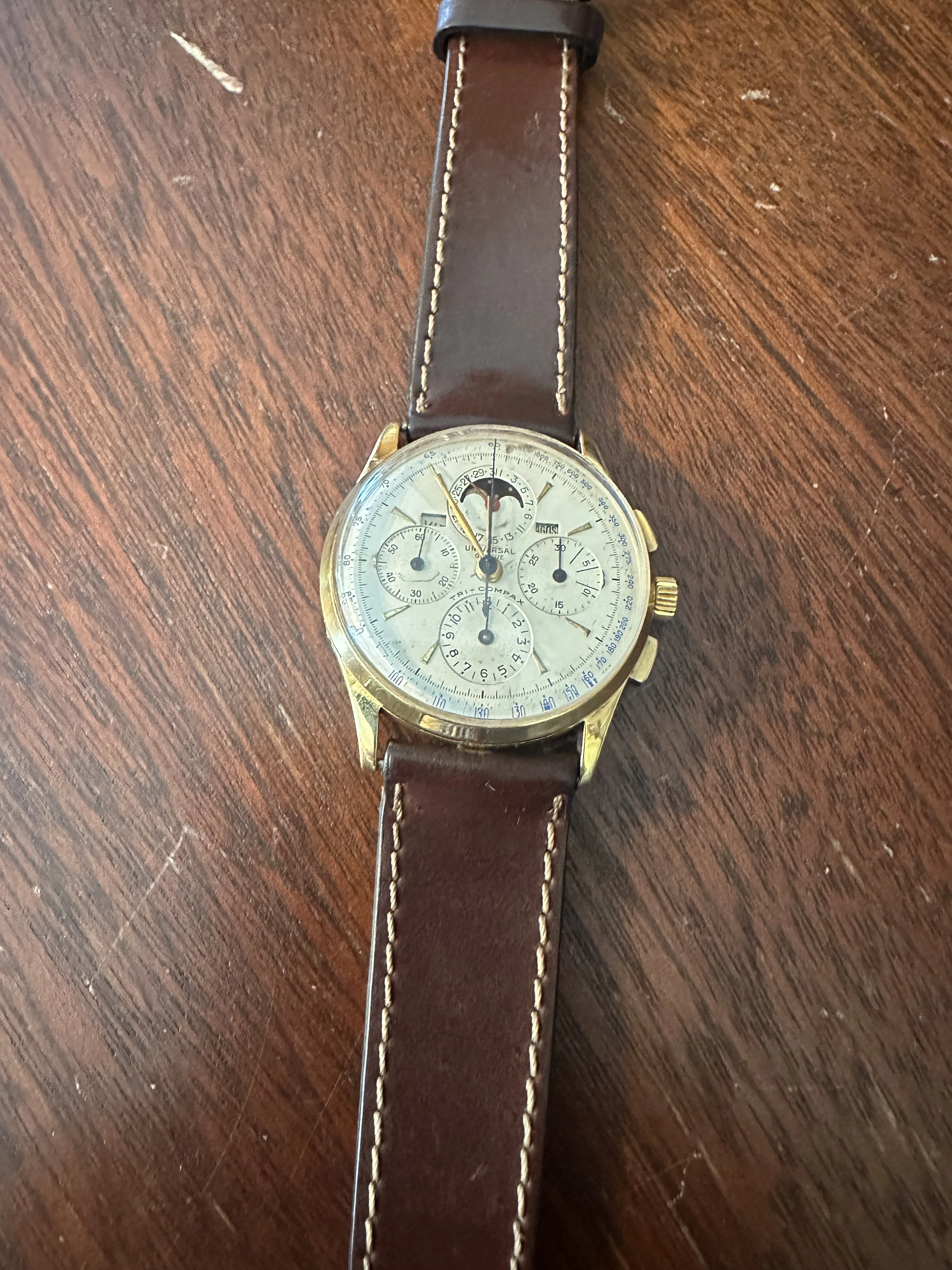

Here is mine. Do t have it on at work so pulling from files. Also, was sold to me as rose gold but I think it is more yellow.
13,740
53,616
There is nothing wrong with the hands. The reference # only refers to the case. Just because you may have seen a pic of this ref in Sala with Dauphine hands does not mean that someone changed them. My guess is that this watch has the leaf hands it was born with. You will do more harm than good. The odds of you finding a crown might be slightly better but there is danger there. If there is a problem you will destroy the stem. (I’ve been there. Bought a flat foot for my 2998-6 speedmaster that turned out to be cross threaded. Result, destroyed the earlier and attractive service crown and stem. It now has brand new Omega parts. I did get my money back but not the cost and fee from my watchmaker.) A better solution might be for a watchmaker to find you a flatter more appropriate one. Don’t forget, crowns and stems were wear parts so any thing you buy used is suspect.. Yes this reference is yellow gold. It’s hard even for a good restoration watchmaker to find UG parts these days.

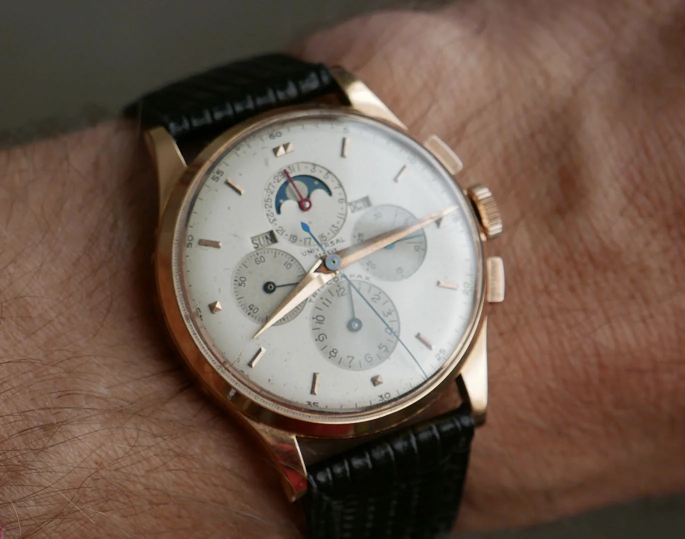

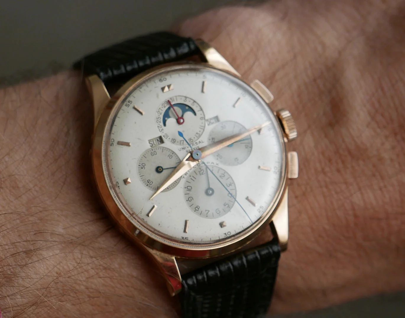

Good luck with the hunt. Here's a rose 12296 I used to have.....

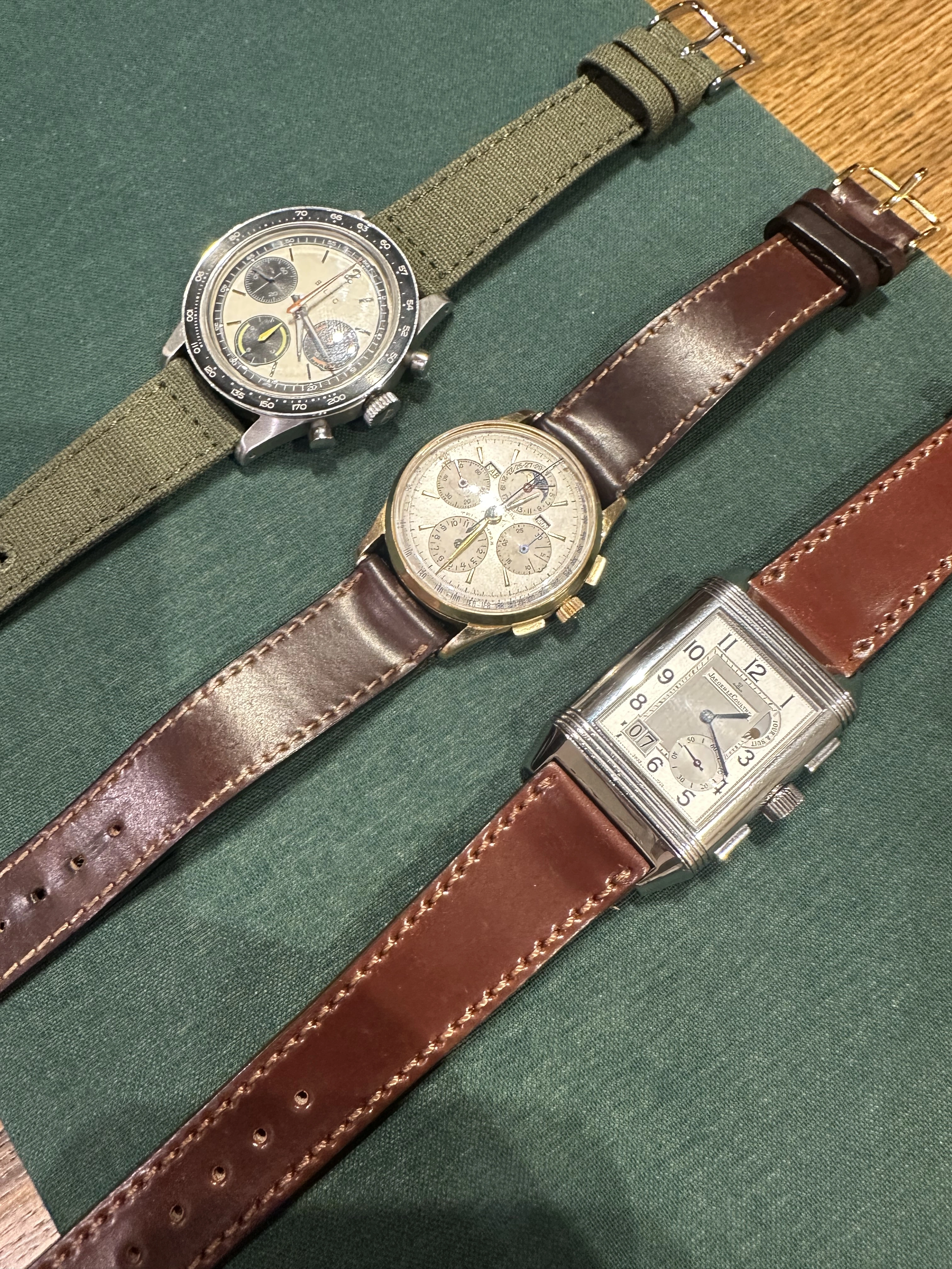

PS … we have same taste in watches . I own a grand reverso and a Baltic Tri.
