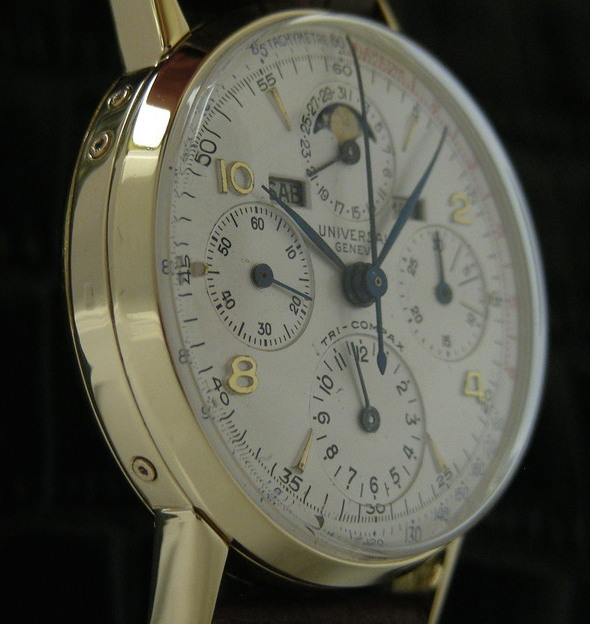

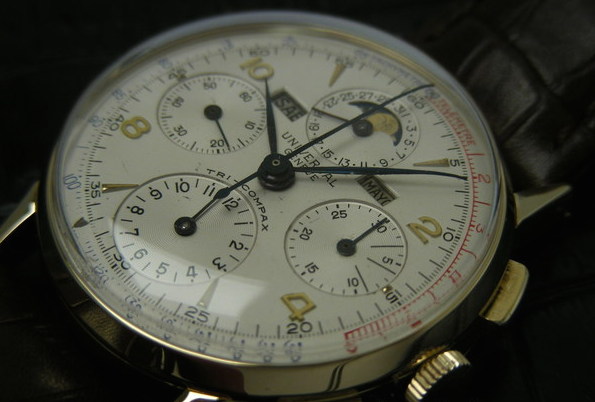

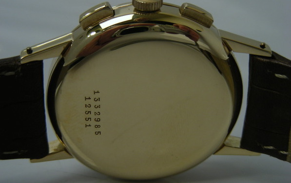

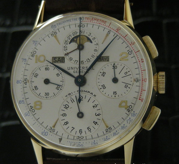

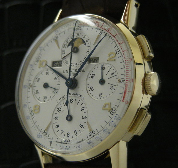

    Hi Guys- saw a 36 mm UG Tri-Compax ref number 12551 case number 1332985 in yellow gold with what seems to be a hallmark on its side (see picture below).
    I don't know anything more about this watch including year of manufacture etc. however, the dial is very different to what has been posted on this forum or found online & I was wondering if you think it's a redial?
    Any information,views or advice on this would be appreciated as I am a novice to the Universal. I can tell you the vendor is asking for a sizeable sum for this : (

    What do you find so atypical about the dial?
    BTW I believe it to be original. My objection to this watch would be the case. It has lost a lot of definition from polishing.

    Thanks for the swift reply! I was a bit concerned by the dial as I hadn't seen this style before but as it was faded enough it led to some confusion.
    don't own the Sala reference book so it was difficult to investigate this model further & find its date of manufacture etc. Also I noted a faded hallmark but wasn't sure if it was a gold plated model or gold ( as I don't have any interior photos) but presume it would be a standard 481. cal....?
  4. LouS Mrs Nataf's Other Son Staff Member May 6, 2014
    6,713
    18,260
    Case references beginning with the number "1" are 18K gold. I'd expect this to have a cal 287 inside. I'll also point out that the ref 12551 is the so-called 'Truman' case - http://omegaforums.net/threads/universal-genève-tri-compax-ref-12551-truman.8103/
