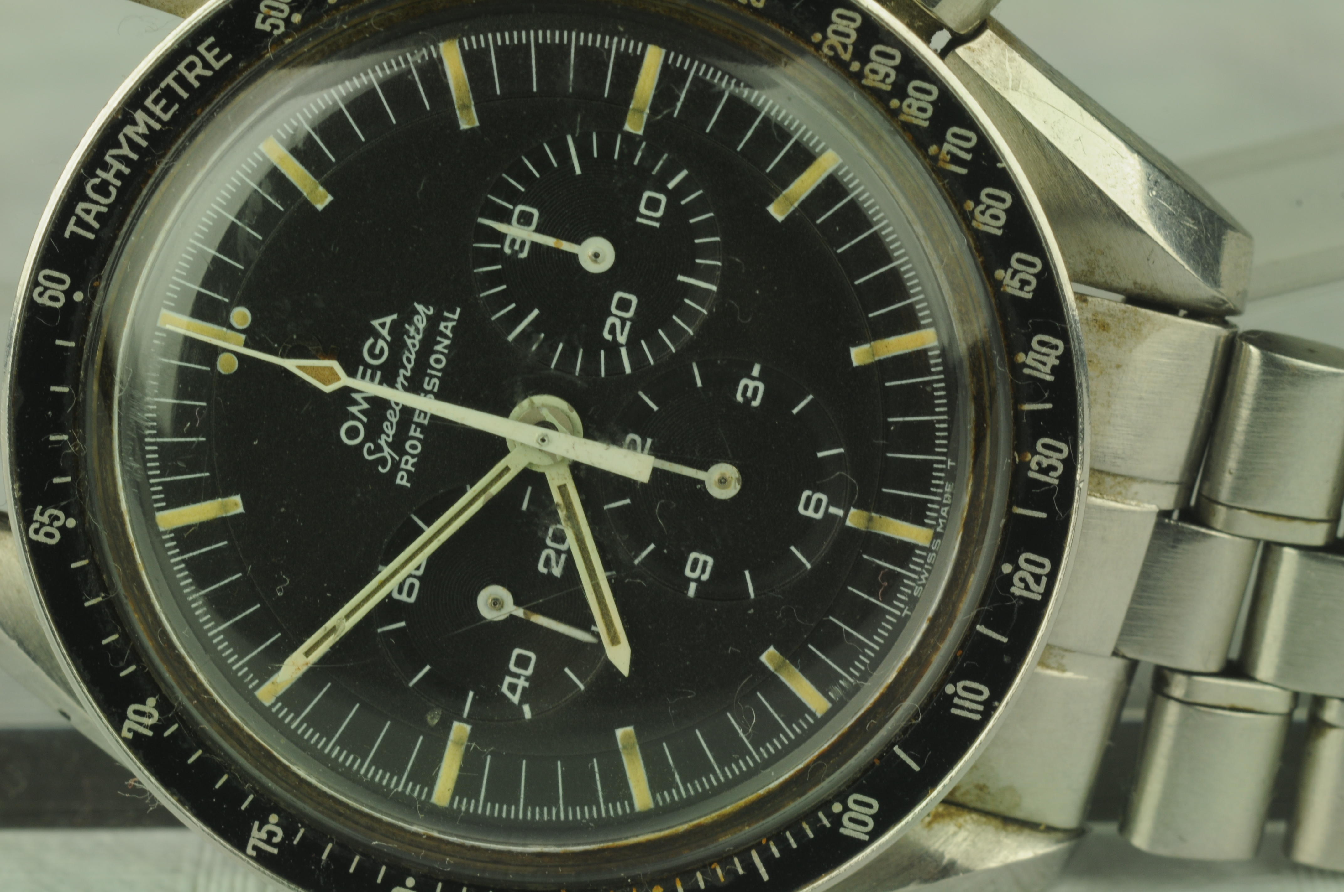

Hi Everybody
I´ve just purchased a very nice 145.022 transitional, with applied logo , step dial and papers. (The bezel is not DON)

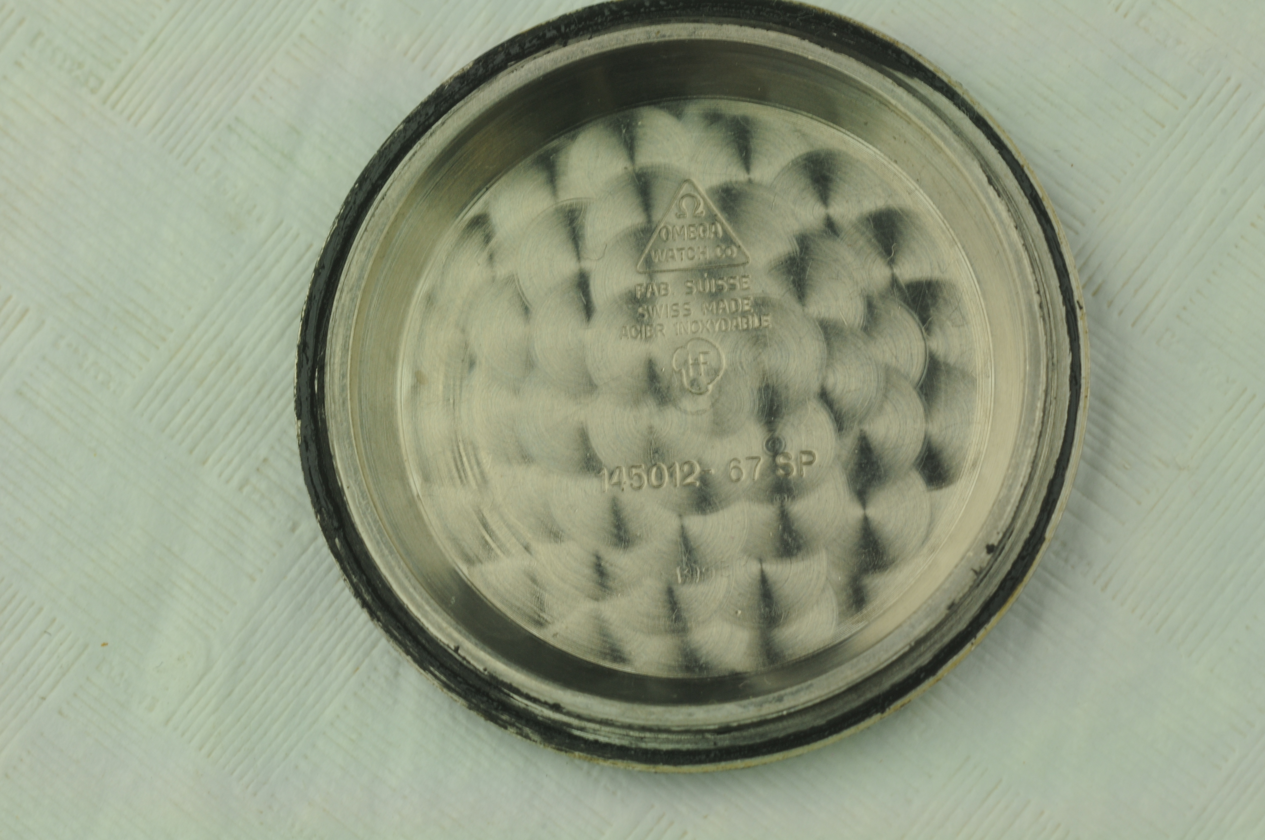

I let it open today by my watchmaker, the movement number matches the papers, but to my surprise the casebook is stamped 145.012
I was reading that with transitional models not all 145.022 68 and 69 were released with the DON bezel for example (Fratello watches reviews).
Is it possible that this watch left the factory using a caseback from a previous reference?
Attached are 2 pictures with both sides of the paper I´ve got with the watch
Thanks

No, very unlikely.
What year is in the case back 145.012-68 or 145.012-67 ?
It had a DON bezel originally.

Hi!
It is stamped 145.012-67

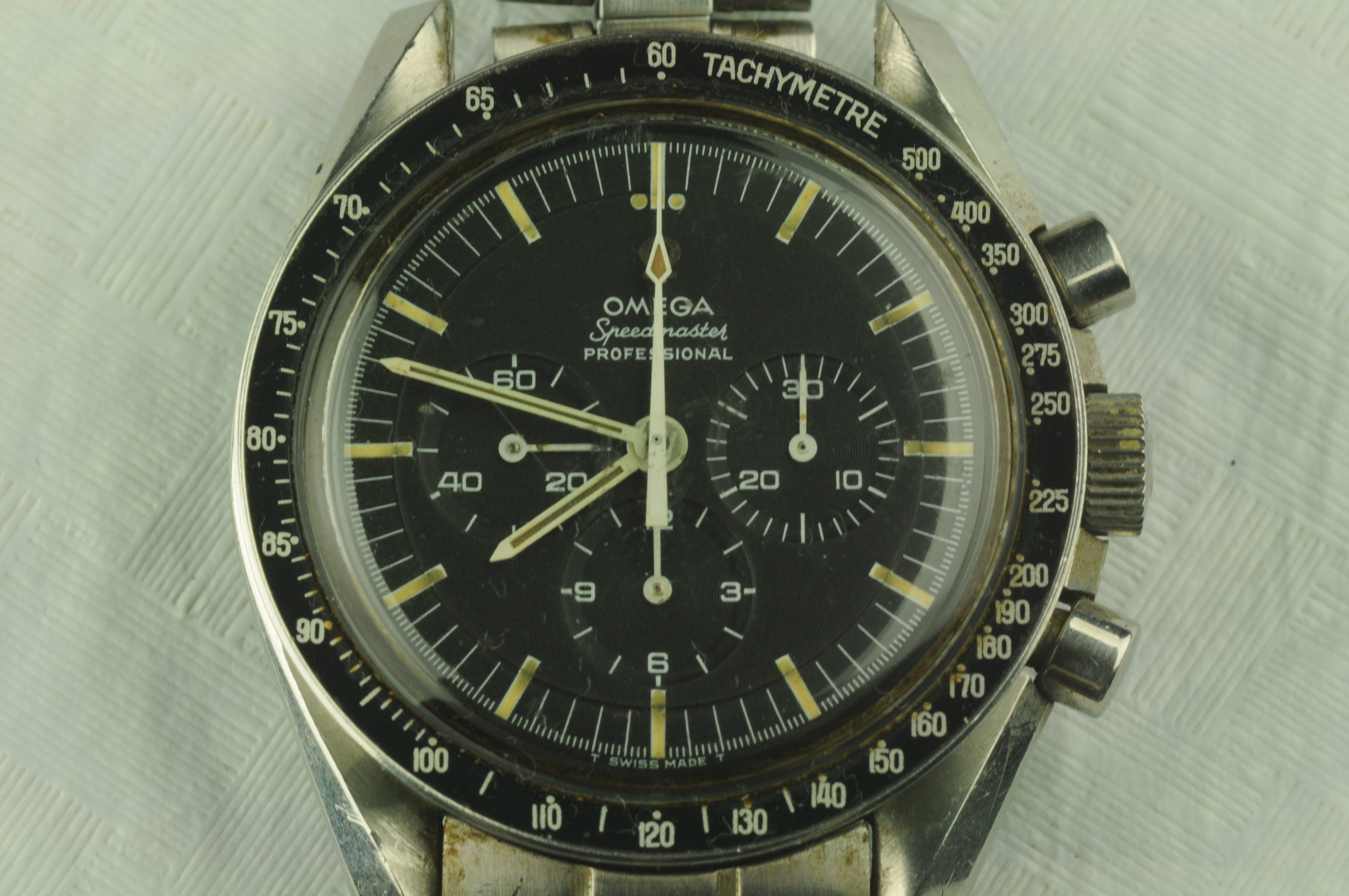

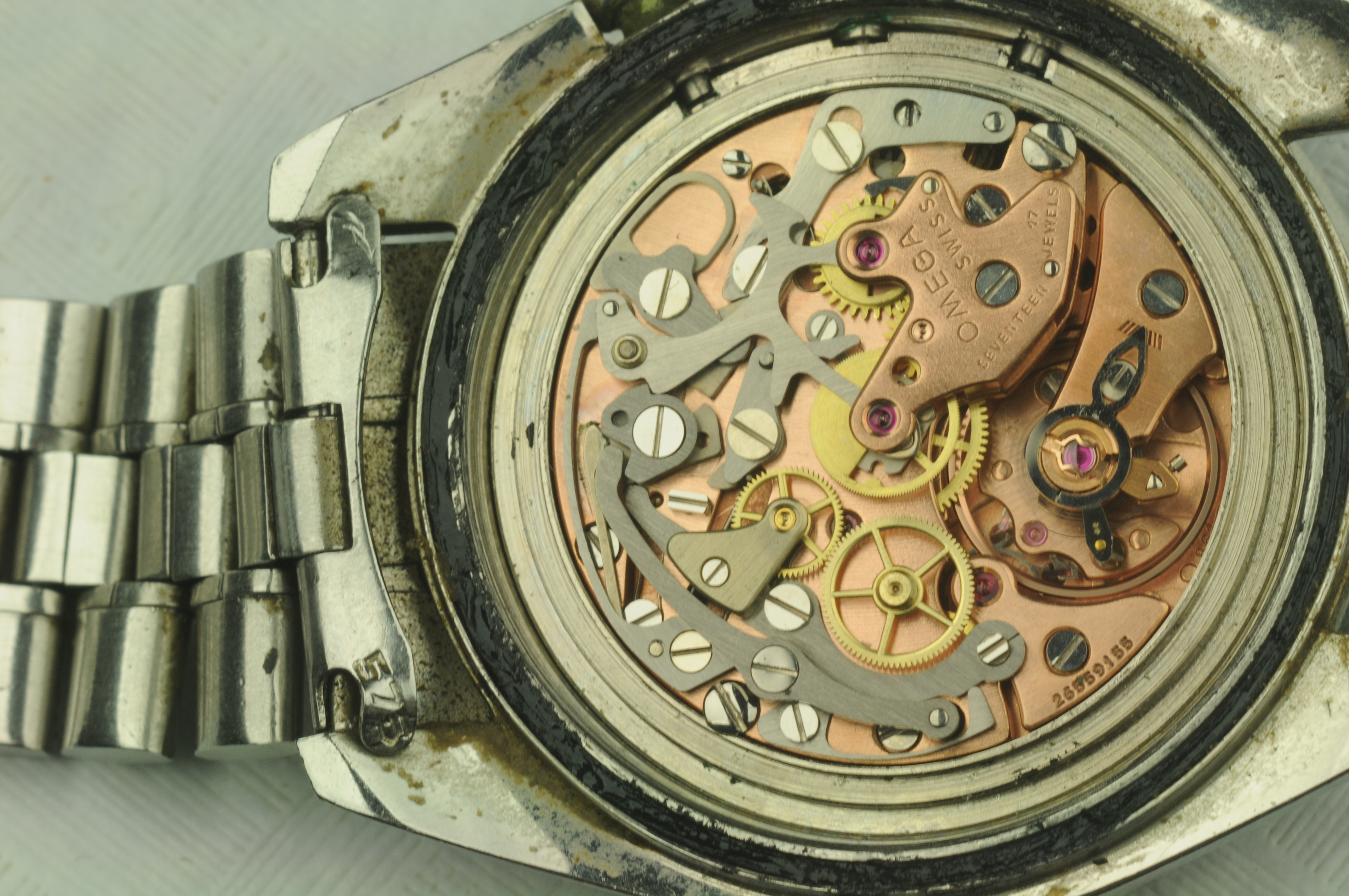

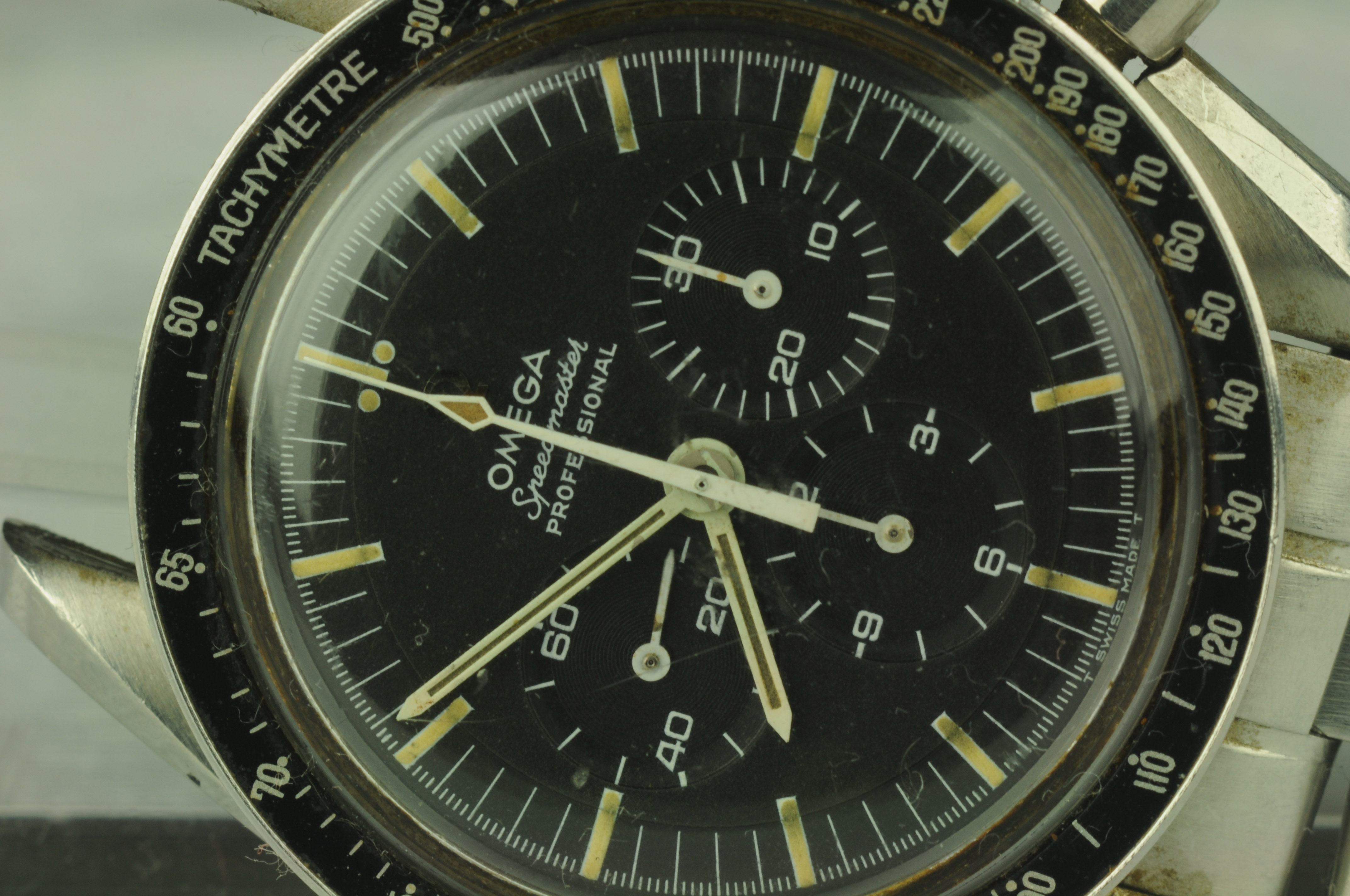

Pictures of the movement and serial number?
dial pictures also?
otherwise can’t really tell you what you have or how the mismatch came about.

Well, if the bezel has been changed, it's not shocking that other things were tampered with over a 50 year period.

I agree, I assume that the bezel has a lot of wear over time, and may be the previous owner made a service and they replaced it with a new one.

We could help you more with photos, there are so many questions we need to double-check with you otherwise. The serial number would be helpful. Also, I know this seems obvious, but can you confirm that it is a cal 861. When you request an extract, you don't give a case number, you give a reference number, and if it's a cal 861, the reference must be 145.022.

I´ll make the pictures in a couple of minutes, thanks

Making the pictures right now. It is 861
24,836
55,255
It is 861 movement, serial 26,559,xxx
Sounds good for a 145.022-68 based on what I've read previously on the forum.

Should I try to get a new caseback with the reference 145.022 68 on it?

That's purely a personal decision, but if it would make you feel better, then go ahead. Unfortunately, they are quite rare. I think you should come close to breaking even when you sell your current case-back.
