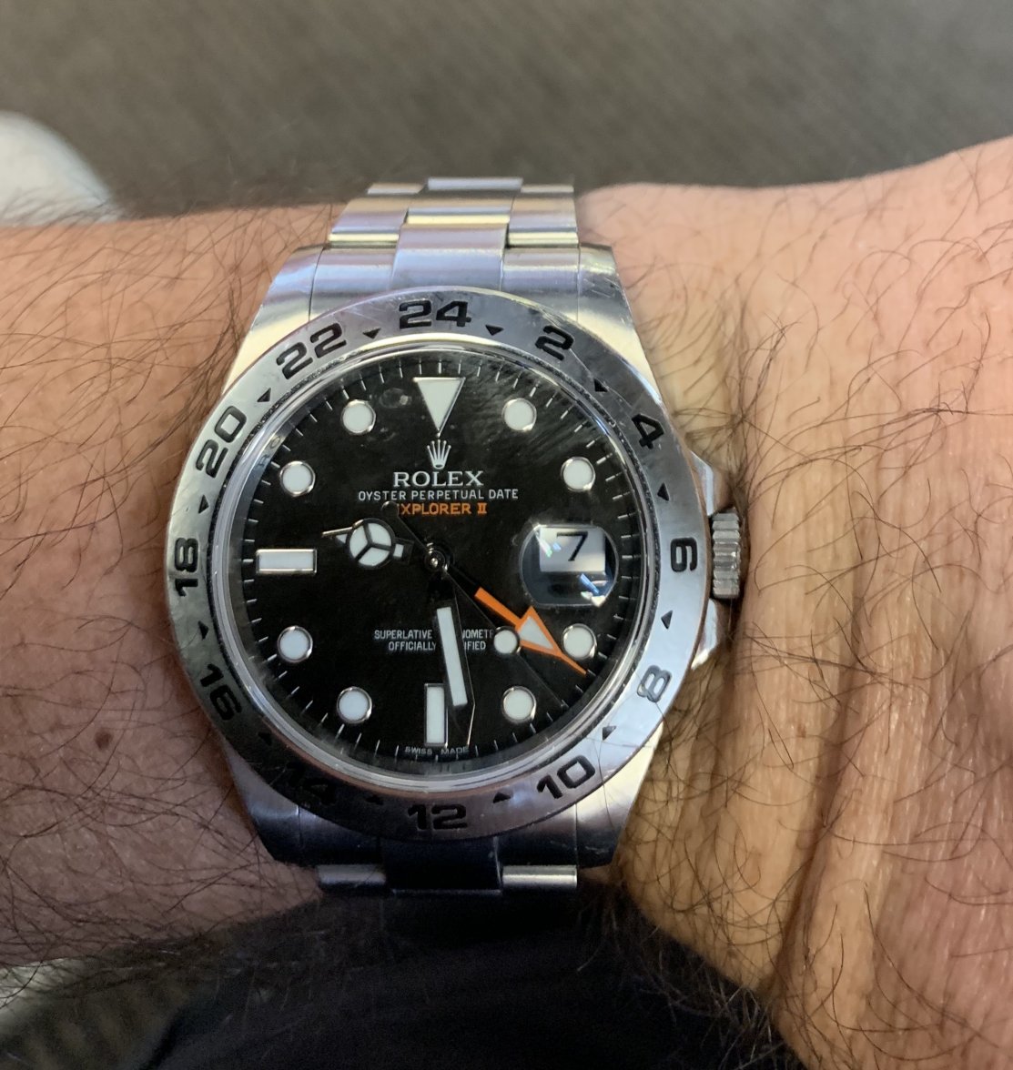

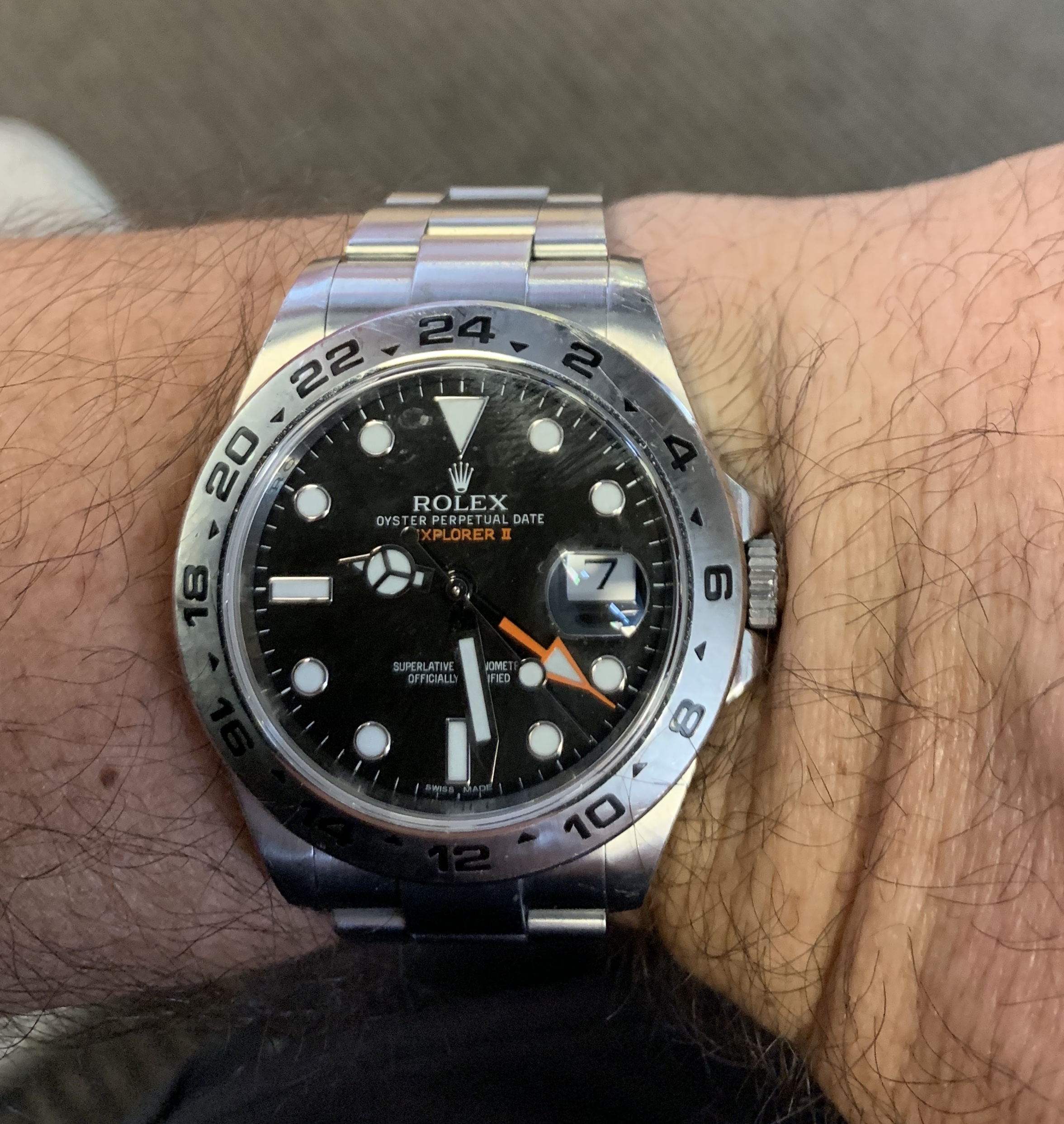

1. I have 2 watches I wear 90% of the time.
a) A Rolex Exp II (new in 2015) that will be serviced every 5 years at a cost of about $800 CAD.
b) A Seiko 5 SNZF (new in 2018) that will be worn until it stops keeping time, then replaced with a new equivalent.
c) the rest of my watches are not worn frequently and so will be serviced based on how often I end up wearing them. I have them all serviced when I first get them so they are in perfect condition. My plan is to service them after I’ve worn them 100 times, or 20 years, whichever comes first.
2. I consider myself someone that takes similar care to those who have a relatively small collection (<20) and tend to keep all of their watches. I consider myself far above average from serial flippers who wear and sell as is without even thinking of servicing them during ownership as there would never be a payback.
I expect my average cost of service to be about $700 CAD per watch. Based on my maintenance plan, my annual cost is budgeted at approximately $1000 for those in my collection, and another $1000 for new ones I add.
3. I explained my mindset in #1, but if I had 30 that I cycled daily, it means I’d have worn each 100 times after about 8 years and I would have it serviced then. There is no real scientific proof that this makes any sense, but it’s my plan and works for me.
My thoughts won’t match that of many others, and it isn’t intended to judge or criticize anyone else. You wanted to poll others, so there’s my plan.
Since every thread is better with photos, here is my daily EXP II on my wrist as I board a plane for a week in China.
